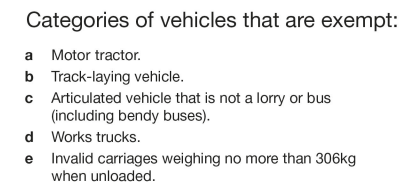

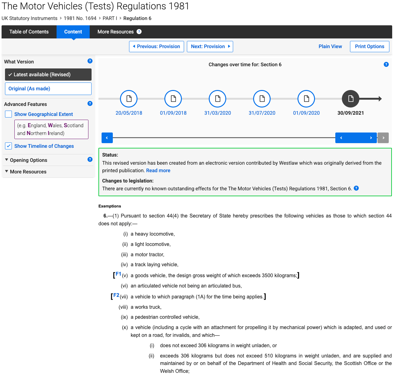

LightBulbFun Posted March 16, 2025 Posted March 16, 2025 47 minutes ago, Faker said: You are flogging a dead horse Talbot… it really isn’t that difficult to subtract one number from another chief but show me where that is legally defined? show me where it explicitly says for example "a vehicles max towing weight, regardless of actual laden weight of the towing vehicle, is defined as the Max Gross Vehicle Weight subtracted from the Max Gross Train Weight as shown on the vehicles ratings plate" for example I can state, that an Invalid Carriage weighing no more then 306kg does not require an MOT regardless of age etc and someone could call bollocks but I can back up my claim by the V112 form, which states such https://assets.publishing.service.gov.uk/media/6761486f1ca3ec0a49e18fa0/v112-declaration-of-exemption-from-mot.pdf which I can then further backup/prove by going to the source for that, which is Section 6 of The Motor Vehicles (Tests) Regulations 1981 https://www.legislation.gov.uk/uksi/1981/1694/regulation/6 which states Quote Exemptions: (x)a vehicle (including a cycle with an attachment for propelling it by mechanical power) which is adapted, and used or kept on a road, for invalids, and which— (i)does not exceed 306 kilograms in weight unladen, or (ii)exceeds 306 kilograms but does not exceed 510 kilograms in weight unladen, and are supplied and maintained by or on behalf of the Department of Health and Social Security, the Scottish Office or the Welsh Office; ergo its an *indisputable* fact when I say "an invalid carriage weighing no more then 306kg is an MOT exempt vehicle" this is what I and @Talbot are looking for with regards to this whole towing thing, and additionally im looking for what the rules n regs are for old vehicles which pre-date the whole "ratings on the chassis plate" thing

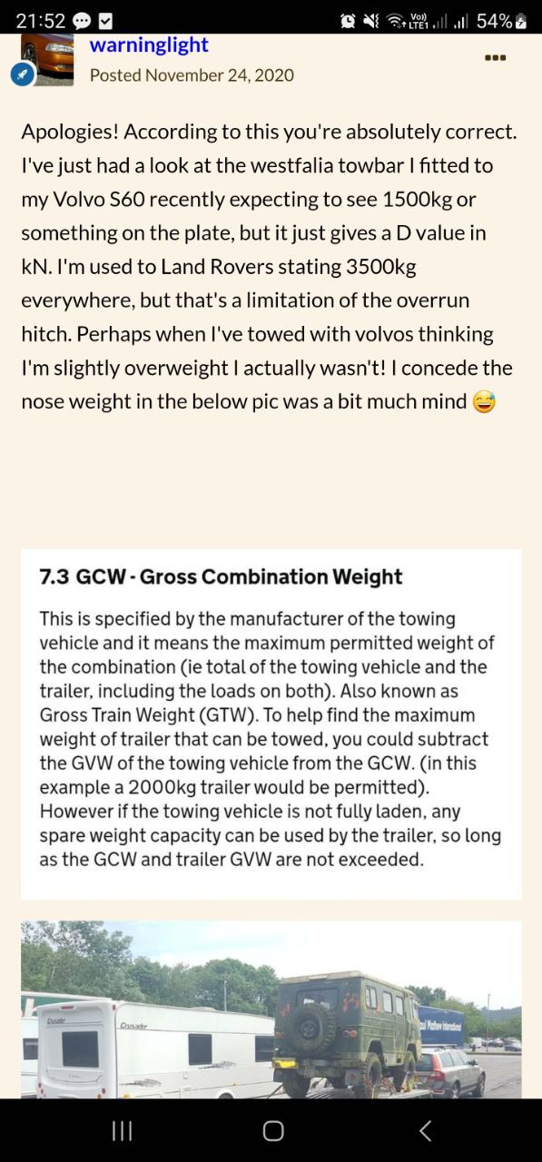

warninglight Posted March 16, 2025 Posted March 16, 2025 I remembered having a similar chat a few years ago, linked above. I managed to find this snippet on gov.uk, I'm sure it'll be searchable! Talbot and The Old Bloke Next Door 2

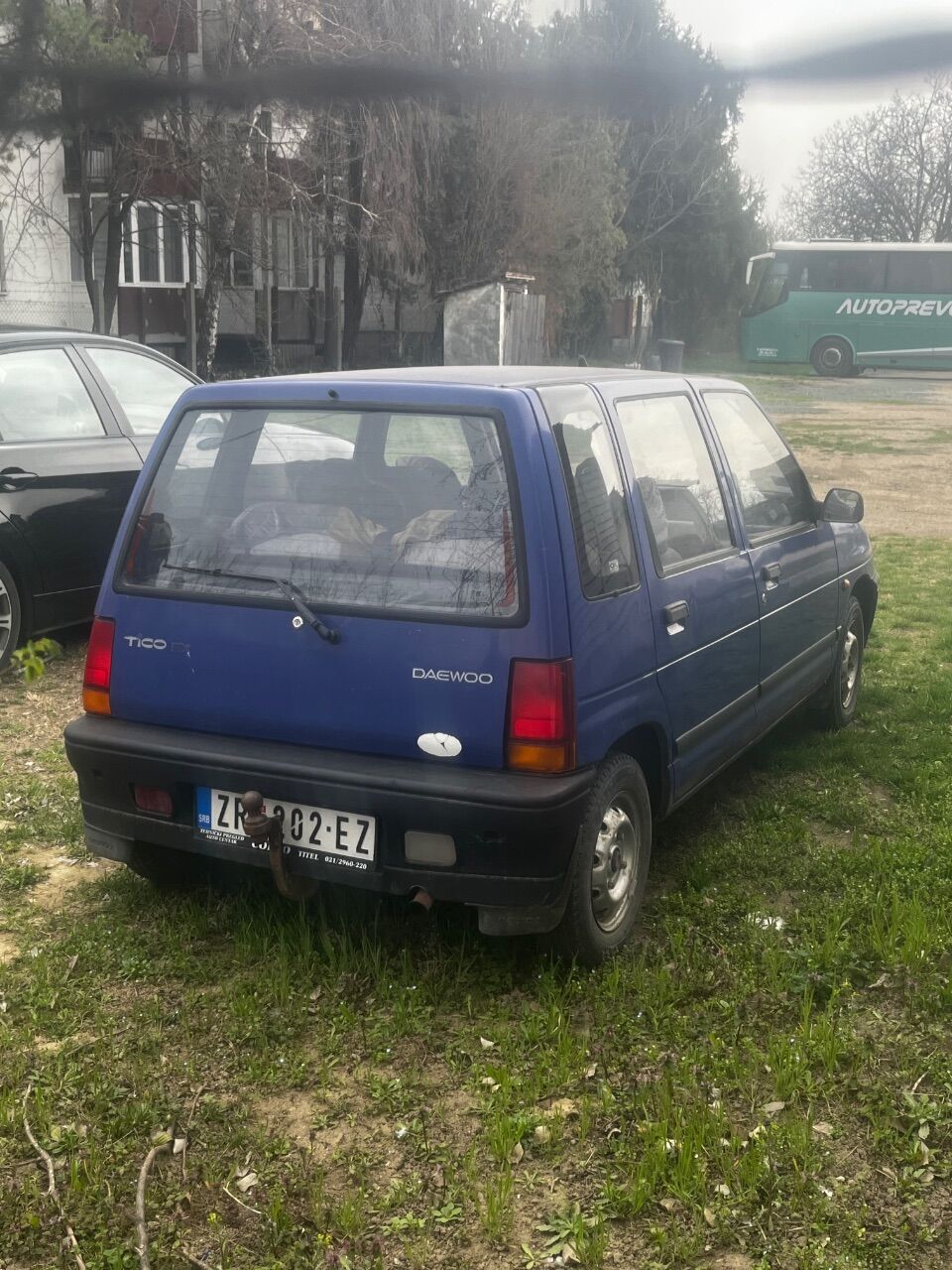

sdkrc Posted April 11, 2025 Author Posted April 11, 2025 That Daewoo is fucking amazing. Dyslexic Viking 1

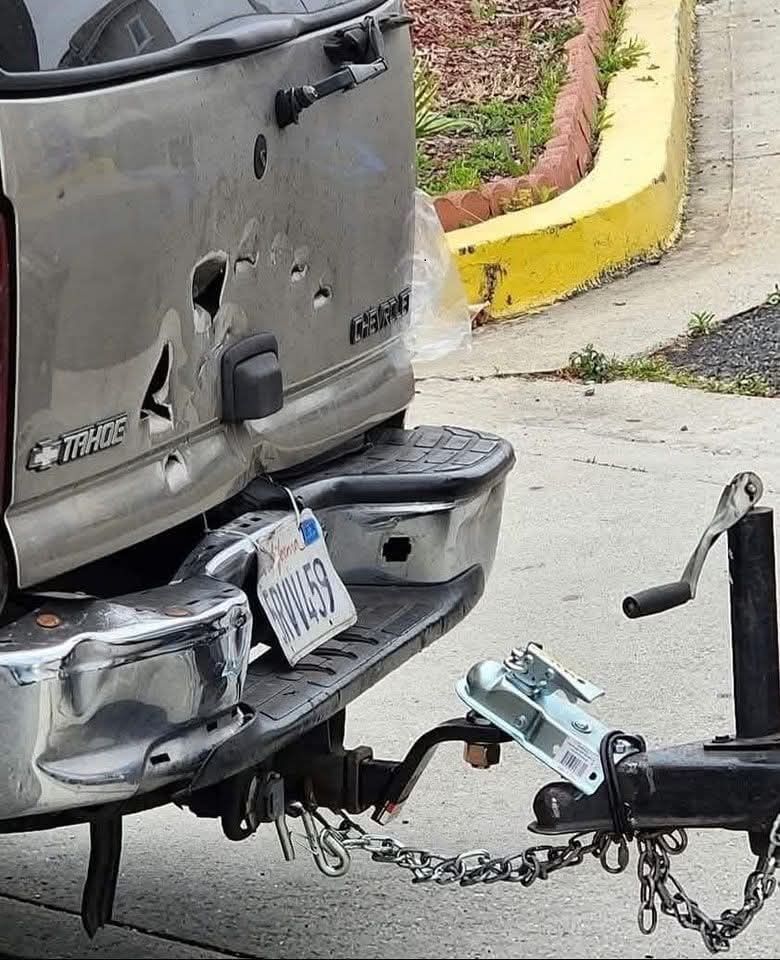

D.E Posted May 29, 2025 Posted May 29, 2025 Land of the free, yet you're not even allowed to tow a trailerpark home with a Ford that looks like it's already been through a few laps on the oval track! Barry Cade, sdkrc and Dyslexic Viking 2 1
