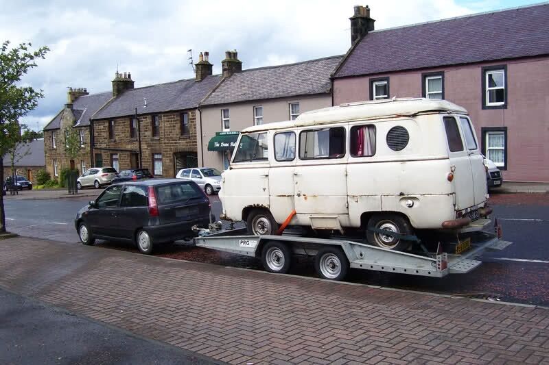

leakingstrut Posted March 14 Posted March 14 I remembered this from an another forum many moons ago and managed to find it on google... It's even more impressive if you recognise where the photo was taken.

High Jetter Posted March 14 Posted March 14 1 hour ago, leakingstrut said: I remembered this from an another forum many moons ago and managed to find it on google... It's even more impressive if you recognise where the photo was taken. A swollen Thames Trader in Ireland?
leakingstrut Posted March 14 Posted March 14 14 minutes ago, High Jetter said: A swollen Thames Trader in Ireland? On the way way back down the hill after climbing Soutra.

sheffcortinacentre Posted March 15 Posted March 15 1 hour ago, High Jetter said: A swollen Thames Trader in Ireland? Trader is the lorry . That's a 400e 12-15 cwt. High Jetter 1

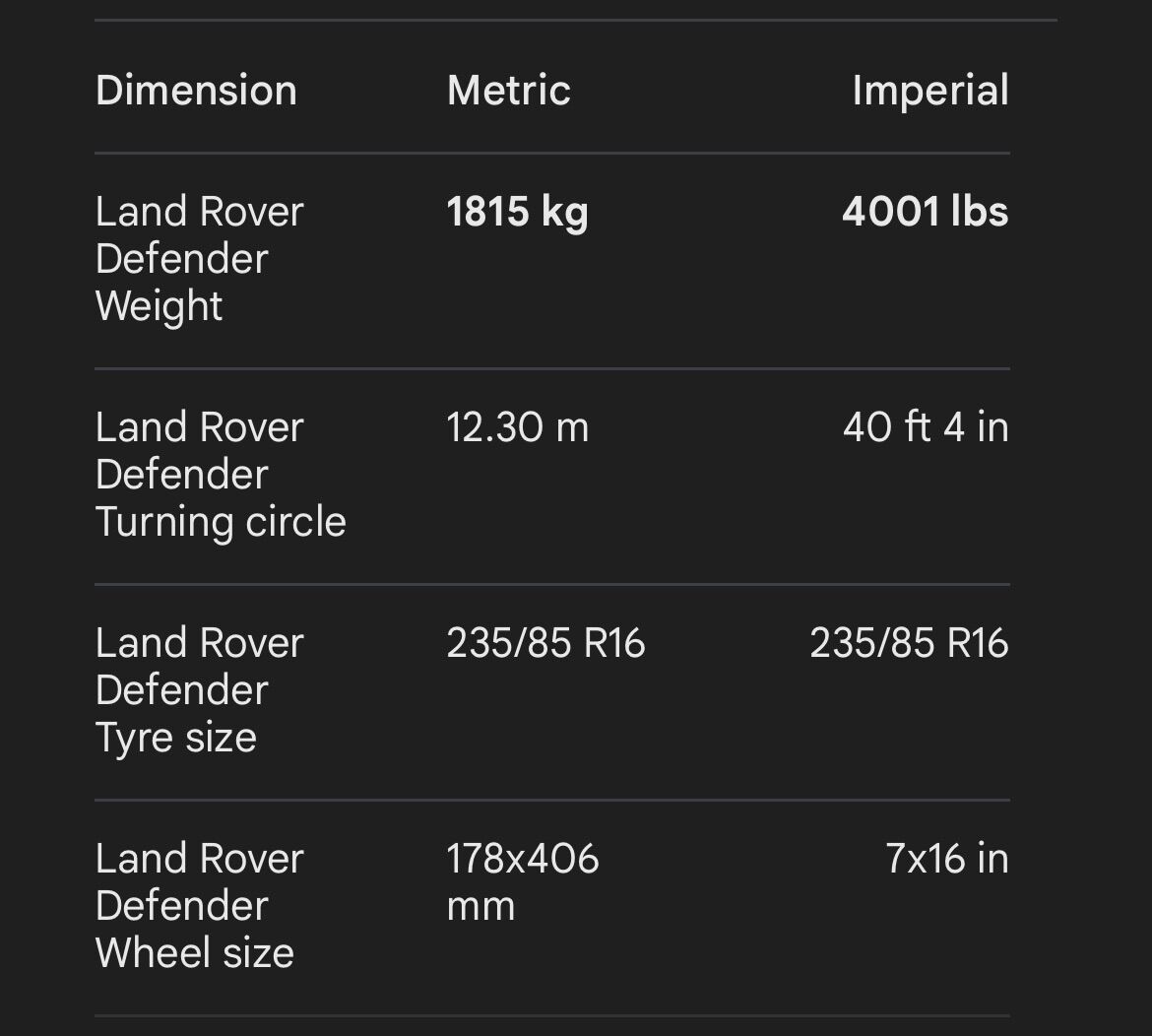

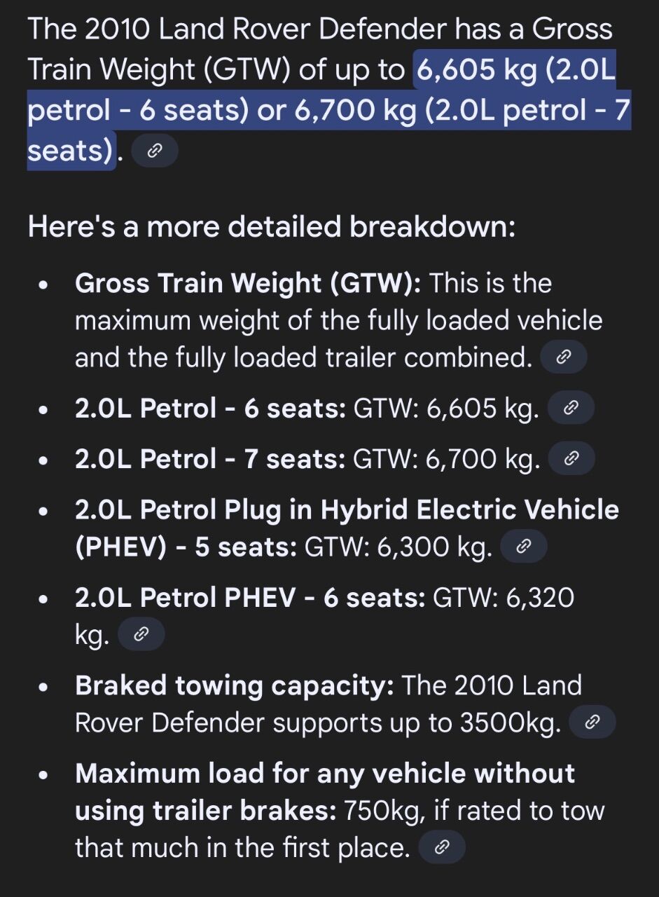

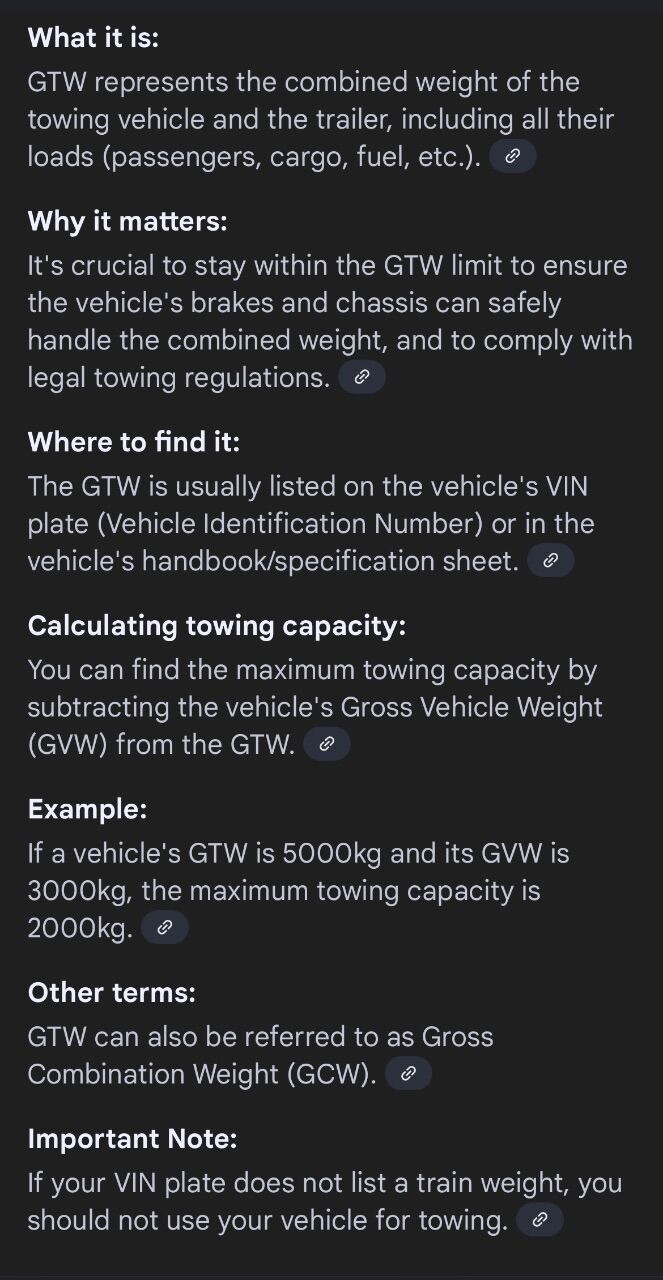

Faker Posted March 15 Posted March 15 Let’s look at talbot’s example with a different vehicle 2010 Land Rover defender. Has a documented 3.5t towing capacity The 2010 defender has a gross train weight of 6.3 to 6.7 ton, depending on the model. For this example we will use the lightest - 6.3t, which still has a towing capacity of 3.5t the 2010 defender has an unladen weight of 1815kg. 1815kg + 3.5t = 5.3t 6.3t GTW minus 5.3t leaves 1t spare so to speak, as the full potential maximum weight for the defender isn’t being used. Talbot is saying that you can tow more than what’s provided or documented as the maximum towing capacity, so long as you don’t exceed the GTW. In theory tow more than the 3.5t limit as there’s available weigh from the somewhat unladen defender. That’s simply not true. YOU CAN NOT exceed the maximum documented towing capacity of a vehicle as per manufacturer determination, regardless of what the GTW is.
LightBulbFun Posted March 15 Posted March 15 8 minutes ago, Faker said: YOU CAN NOT exceed the maximum documented towing capacity of a vehicle as per manufacturer determination, regardless of what the GTW is. yeah I get that part if theres a plate on the vehicle that says "do not tow more than 2000 kg" then yeah I get that, *but* if a vehicles *does not* have such a statement then as far as I understand it, as long as you dont exceed the max train weight and axle weight the vehicle is rated for, the trailer can be any weight so to speak to use your example does it say on its ratings plate that it can only tow up to 2000kg? On 12/03/2025 at 21:39, Faker said: Hi Talbot. This is largely correct to a certain degree… I have an ix35 with a kerb weight of 1675. With 5 people and some luggage, it can have a gross weight of 2300kg. Now it has a GTW of 4300kg… meaning with a full compliment of occupants it can still legally tow 2000kg on a braked trailer. Now whether the tow car is empty, or full to the gills… it can only ever tow up to 2000kg. The plated towing limits never change. or does it just say that its max train weight is 4300kg? as I think there is an important distinction to be made there
Faker Posted March 15 Posted March 15 I do understand how this is confusing… but it is a fact that you subtract the maximum allowed mass or Gross Vehicle Weight for the tow vehicle, from the gross train weight, to get the maximum towing capacity. It really is that simple.
LightBulbFun Posted March 15 Posted March 15 2 hours ago, Faker said: I do understand how this is confusing… but it is a fact that you subtract the maximum allowed mass or Gross Vehicle Weight for the tow vehicle, from the gross train weight, to get the maximum towing capacity. It really is that simple. but whats the source for that?, can you link me to the relevant legislation at https://www.legislation.gov.uk that states that "this is how the max towing weight of a vehicle is calculated" as I understand it "gross" in this context, (ie gross Vehicle weight, or gross train weight) is when something is laden, so gross train weight GTW, means that the whole combination of vehicle+trailer cannot be laden to a total weight more then that stated figure, (and gross vehicle weight, means that the vehicle itself cannot be laden such that its total weight is beyond xxx stated figure) but nowhere do I see in that or anywhere else does it state *how* the Gross train weight can be achieved again if the vehicle does explicitly ave a max trailer weight rating, im not disputing that, if @Talbot's Mercedes says in its handbook or on its VIN plate that "maximum braked trailer weight 2100kg" then im not going to say it can tow more then that, but otherwise if the only figures given is the GVW and GTW, then I cant see how the trailer itself is limited in weight, unless there is some specific legislation that states otherwise? and I am still wondering how the weight limits work for pre 1998 vehicles, 5 hours ago, sheffcortinacentre said: I was led to believe when unknown your not supposed to exceed the tow vehicles weight IE a cortina weighs roughly a 1000kg so I've always stuck to that as only very late mk4's & mk5's have it on the I'd plt .but I think there rated at 1100 kg. see thats kind of what I have been thinking, but I realise I am not sure I have ever actually read that in any legislation or the such like, so I would like to try and see if I can find it or whatever the actual rules are, written in law so to speak

Faker Posted March 15 Posted March 15 54 minutes ago, EyesWeldedShut said: GTW is what it is - the vehicle gets a tow weight calculated and then they plate it up by adding that to the GVW/MAM (see Reg 4 in the link) - there's not usually a trailer weight on the chassis plate, that just gets worked out backwards by GTW minus GVW Excellent 👍

Talbot Posted March 15 Posted March 15 12 hours ago, Faker said: What Talbot is saying is… you can tow more than what is stated as the vehicles towing capacity limit, so long as you don’t exceed the overall gross train weight…. Which is incorrect I have yet to see any legislation that indicates what you're saying is true. All it states is that you must not exceed your vehicle GVW, and you must not exceed the overall GTW. There is not a "towing limit" for most vehicles (unless it's 3.5 tonnes, and that is a license issue, not a C&U issue) I've run these numbers many times, and found information to back up my take on this. I can't find it at the moment, but have definitely read that any "unused capacity" in the vehicle's GVW can be placed on the trailer as long as you do not exceed the GTW. If "towing weight" were a thing, then that figure would explicitly be listed on a vehicle's VIN plate. However, it isn't. You get GVW and GTW and nothing else. I, equally don't want a mud-slinging excercise here, but I'm fairly sure you've interpreted the regs wrong. Many people do on this point.
Faker Posted March 15 Posted March 15 2 hours ago, Talbot said: I have yet to see any legislation that indicates what you're saying is true. All it states is that you must not exceed your vehicle GVW, and you must not exceed the overall GTW. There is not a "towing limit" for most vehicles (unless it's 3.5 tonnes, and that is a license issue, not a C&U issue) I've run these numbers many times, and found information to back up my take on this. I can't find it at the moment, but have definitely read that any "unused capacity" in the vehicle's GVW can be placed on the trailer as long as you do not exceed the GTW Ah good luck chief! You alone have interpreted the wording to satisfy your own needs or ends. Every single towing body online use the guidelines I have shared, along with clear indication on .GOV own website for MAM and GTW. But to profess your own stand alone interpretation, when the E Class Mercedes has a documented maximum braked towing capacity of 2,100kg, and offer guidance that goes against ALL credible advice and actual training, deserves to be challenged. GOV website states GTW is fully loaded car and fully loaded trailer - and must not be exceeded. Doesn’t state anywhere that someone can use a half loaded car with overloaded trailer = to reach the same GTW, and permits exceeding vehicle documented towing capacity. When I get the chance I will get document clarification and share.

Talbot Posted March 15 Posted March 15 16 minutes ago, Faker said: GOV website states GTW is fully loaded car and fully loaded trailer - and must not be exceeded. Doesn’t state anywhere that someone car use a half loaded car with overloaded trailer = same GTW True, but it also doesn't state that you subtract the GVW from the GTW to get the towing capacity. Yes, many websites do say this, but that is not what the .gov website says, and it doesn't state that there is a towing limit. There's just two weights you must not exceed. loserone 1

Talbot Posted March 15 Posted March 15 from here: https://www.barlowtrailers.co.uk/the-basics-of-towing-a-trailer-or-van Quote 7.3 GCW - Gross Combination Weight This is specified by the manufacturer of the towing vehicle and it means the maximum permitted weight of the combination (ie total of the towing vehicle and the trailer, including the loads on both). Also known as Gross Train Weight (GTW). To help find the maximum weight of trailer that can be towed, you could subtract the GVW of the towing vehicle from the GCW. (in this example a 2000kg trailer would be permitted). However if the towing vehicle is not fully laden, any spare weight capacity can be used by the trailer, so long as the GCW and trailer GVW are not exceeded. This company has it right. Most other trailer websites make the statement about GVW and GTW but are very wooly on the matter @Barry Cade The argument is thus: Vehicle has a 2310KG GVW and a 4410GTW rating. my argument is that as long as both of these are kept to, then there is no issue. If the car was laden to 2000kg, you could tow a 2400kg trailer if you wanted to. @Faker's argument is that by subtracting 2310 from 4410, you get a trailer weight of 2100kg and you must not exceed that under any circumstances. I believe he's wrong, and that the 2100kg limit is ONLY when the vehicle is laden to it's GVW of 2310kg. Even the .gov website is not clear. I believe that if the law stated that the maxiumum trailer was indeed GTW-GVW, this would be made very clear, and it is not. All they do is state that GVW and GTW must both be adhered to. In my example above, the vehicle would be 2000kg, and hence under the GVW. The combination weight would be 4400kg, and you would be (just) inside the GTW, and hence legal. With all the other bollocks online about the 85% rule (which some websites claim is law.. it isn't) and the 100% rule (trailer should not exceed the weight of the car, also not law) it is very hard to find the exact legal situation. It's an interesting debate, and not the first time this has come up. I'm particularly invested, as I irregularly do tow a trailer of about 2500kg on my W210, but ensure that both the GTW and GVW are not exceeded. I believe this is legal.
LightBulbFun Posted March 15 Posted March 15 7 hours ago, Faker said: some light reading 🤣 I’ll dig it all out if I get a chance those weight stuff which you have stated from the construction and use act generally are referring to the maximum weight, any *class* of vehicle is allowed to tow, as in lets say you had a magical motor car that itself was plated for 100 tons GTW, even tho *itself* might be able to do that, it would not be legal for it be registered as being able to do such because it exceeds the weight limit set by the C&U act that a Motor car and trailer can be https://www.legislation.gov.uk/uksi/1986/1078/regulation/76 https://www.legislation.gov.uk/uksi/1986/1078/schedule/11 which you can find in the charts above for example its along the same lines that if certain Lorries or buses are too wide they cant be used on UK roads but said legistation does not clarify what me you and @Talbot are trying to figure out here
Faker Posted March 15 Posted March 15 To be fair to talbot - that’s a decent and coherent reply, which clearly clarifies that has assumptions are his opinion. Credit there fella. But…. Leave it with me…
Faker Posted March 15 Posted March 15 10 minutes ago, LightBulbFun said: https://www.legislation.gov.uk/uksi/1986/1078/regulation/76 https://www.legislation.gov.uk/uksi/1986/1078/schedule/11 but said legistation does not clarify what me you and @Talbot are trying to figure out here Yeah the C&U stuff requires a lot of delving with dozens of subsections etc. I will get to the bottom of it. the legislation lightbulbfun has documented refers to HGV vehicles etc. check out the axle weights 😉 I do enjoy a good debate!!
