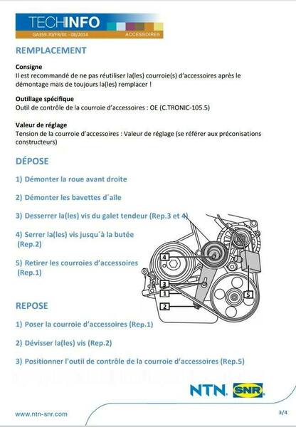

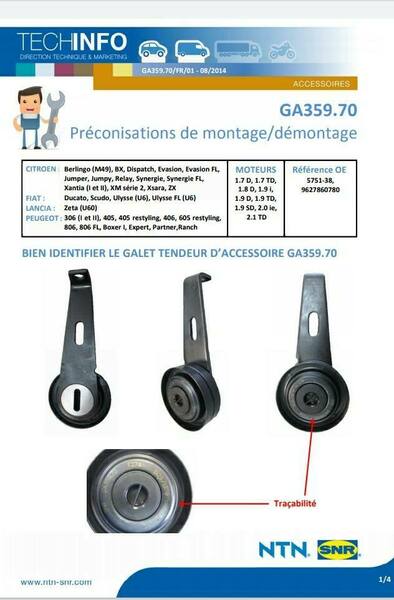

lesapandre Posted July 11, 2021 Posted July 11, 2021 I've retrieved this off the web. I'm not absolutely sure this is what you are working on...but I am home waiting for the football so though I would have a look on the francophone web. It at least gives a clear diagram I think... I will translate 3/4 and 4/4 3/4: 1) Remove the front right wheel 2) Remove the wing flaps 3) Loosen the tensioner screws 3 & 4. 4) Tighten screw 2 to the stop. 5) Remove the belt 1. Reverse: 1) Fit the belt 1. 2) Unscrew the screw 2. 3) Position the tool for checking the accessories belt 5. 4/4 4) Tension the accessories belt until the value 115 + 10 SEEM is reached. 5) Remove the tool for checking the accessories belt 5. 6) Fully tighten the screws 3 and 4. 7) Turn the motor two turns in the direction of motor rotation. Position the accessory belt inspection tool 5. 9) Check and correct the tension of the accessory belt. 10) Remove the tool for checking the accessories belt 5. Recommendations: Always make sure that the plastic cap is in place to ensure sealing Observe the manufacturers' assembly procedures as well as the tightening torques indicated. I'm assuming you are working on 4... loserone, wesacosa, mercedade and 2 others 4 1

wesacosa Posted July 11, 2021 Author Posted July 11, 2021 thanks @lesapandre. That is the auxillary belt tensioner ( which will come in very useful when I get to it, as its supposed to be a fiddly set up) but struggle is cambelt tensioner Plan of action for tomorrow is to see if I can file a couple of flats on the stud and use some mole grips
