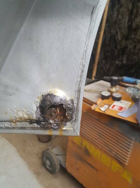

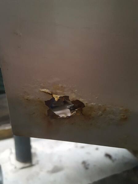

Do i get a new door shell from RIMMERS at £276 or shall i just weld it.... Decisions decisions...
188781328_2615939265380061_877482884231255314_n.thumb.jpg.58cb25b388c70f51ab9ad2da562c1e37.jpg188820963_159084182829841_237037101859058042_n.thumb.jpg.fcbd7eeae9b57f64a808f3df7225ec0b.jpg

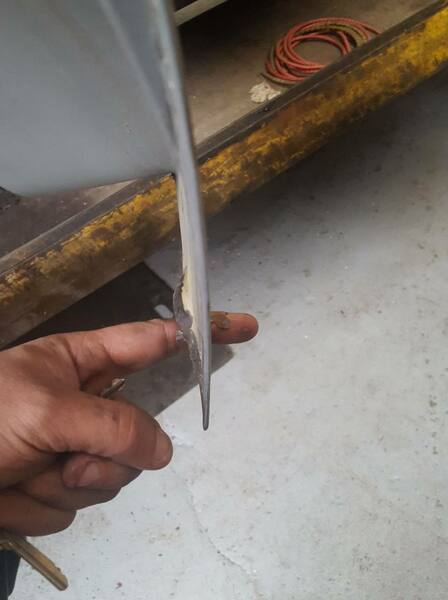

Had to amuse myself slighty because if you dont laugh you cry....
187749381_267424461441141_3815959318607149973_n.thumb.jpg.c48470be29b563a9196899cec658c91c.jpg
G'wan, have a go welding it. Be sure to put in a drain hole at the bottom so it doesn't happen again though.

Are you able to do the prep and stripping? If you are you should be looking at nearer £1500 for the painting.. Loving the sd1 and one on my bucket list.. Regards the door, easy repair but feel along the whole lower flange (great word, flange) if any sweating I'd be going for the door (or skin) if it's available.. What's the the others like?

That is literally the only rotten/rusty bit on the car believe me i have checked and checked again... Ive been incredibly lucky with it.
I cant prep or strip but the black panels on the car so both front wings bonnet and doors are new primed but not painted parts from Rimmers.
In fact the rear passenger door boot and front valance are they only pieces of outer bodywork that are original it would seem... Everything else has been replaced.
I'd be tempted to let metal into that hole. The problem with cars of this vintage is if you start spending £££ it sucks the fun out of it and you start feeling a tad resentful. God knows I have.
Are you saying weld it rather than replace the door?
Would appreciate your advice and expertise as i know you've owned a few 👍
Yes. Take the hole back to sound metal. Make a cardboard template the shape of the hole. Transfer the template to a piece of steel. Trim repair section. Weld it into the hole slightly lower than surrounding area so you can cover it with a skim of filler.
