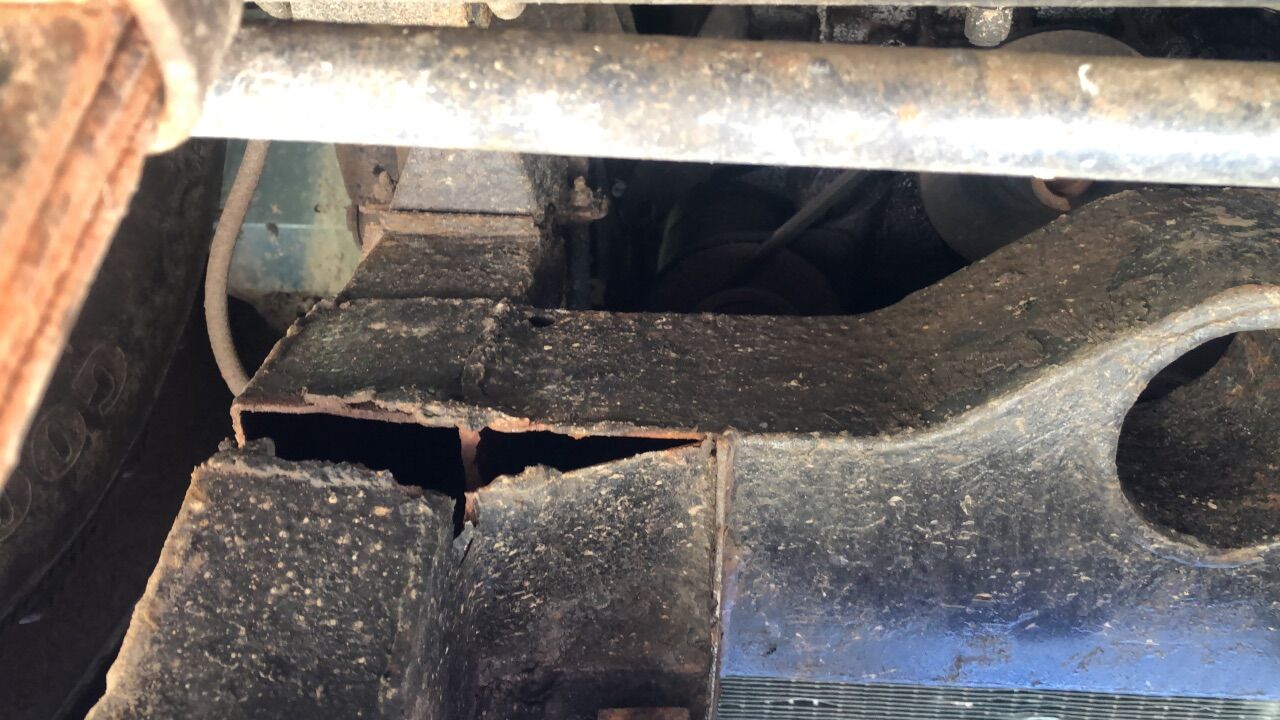

Sadly, after 30 odd years in my possession, and another 20 owned by my dad the old Landy finally met its maker today.
61 years isn't a bad innings for any car, especially this one, which took a fair amount of hammer off road, and went all over the country in my ownership. Not absolutely sure I'm going to replace it, old Landrovers are so expensive these days, and I'm not sure I can really justify it.

That's a fair thickness of metal to snap. Looks more like it's cracked through metal fatigue more than rot...
Looks a straightforward welding repair or invest in a new chassis, after 50 years getting rid of it would be like loosing a family member to me.

I've assessed the situation it may not be as dire as I first thought.
You can get a repair section which provided the chassis legs are ok behind the front crossmember would be a fair cheap fix. The tricky bit is extracting the steering relay from the old crossmember after six decades rusting itself into position (although replacement relays are available and not too dear).
I suspect the front propshaft is buggered too but that's ok because It was looking a bit buggered before this happened and they're reasonably priced too. Be a good time to fit new front springs as well.
It was damaged during the accident a few years ago, wonder if straightening the chassis legs stressed the metal too much.
Who repaired it previously? There’s like zero penetration on those welds
looks a lot worse than it is
probabily look at replacing the front half of the chassis from the shock absorber mounts forward with a pre made section

That was repaired during the early 90s so it’s done alright really. But there does look to be good metal left to weld to. The repair piece start’s behind the front crossmember and has extensions so it would be enormously strong once repaired.

Go for the repair section - my 1968 88" broke one leg just in front of where yours has gone - both sides had previously had the spring extensions redone and one of those repairs had given up the ghost - we did a bit of tapping/scraping/drilling and found good metal right down both sides of the engine but everything to the front of the crossmember was spit thin.
Rather than just go for another dumb iron, I went for the front repair section, new steering relay and had to spring for a new radiator (as just moving the old one broke it - badly - just chucked in a Ser 3 rad). This was about 1996 so the steering relays may have been relatively cheap back then.
Once you get the front wings out of the way there's loads of room to cut and weld. It was mooted that removing the engine was needed but you can get around that by judicious use of a trolley jack, blocks and wedges (after undoing the mounts) if you need to move it over a bit. That can still  leave the inner weld a bit hard to get at - I guess if you pulled the engine then you could justify a new clutch and an engine crane (if you don't have one).
We 'jigged' up with various bits of wood, rod etc etc and the end result looked square and drove square.

Cheers, Bear in mind that I will be completely removing the front crossmember so chassis damage and access won't be an issue should it need cutting out. But I'll try removing in situ first.

I don't mind removing the engine, I have access to an engine crane but will probably use my mini digger. All the front end came off a few years ago so should be easy to remove. I wouldn't mind sending the engine for a rebore actually, it breathes a fair amount and is a bit down on power, there's a bloke in the village who does this sort of thing, even if he could do the cylinder work I could reassemble with oversize pistons and rings.

I'd go for that then. Do the @The Old Bloke Next Door's relay trick (where was he 29 years ago  - not writing for LRO magazine that's for sure - that, and a Haynes, was 'it') then pull the engine. Bolt the two chassis rails in place to each other with some steel stuff then cut/weld/vicarious pictures for AS?

I would advise against removing the front crossmember unless it is absolutely neccessary to complete the repair/restoration.
In my opinnion its the most safety critical part of the chassis, great care and expertise is required to reinstate it to a suitable standard.

Looking at that crack there's alot of sharp edges. You'd think they'd have done some gussets.

The front of the front crossmember has failed though, its cracked and is peeling away. I am looking to replace the front chassis with one of those replacement sections with extensions that weld back to the chassis legs.
There are two versions available, with differing lengths of chassis extension but both have those flaps to attach to the chassis rails so the welded area is massively increased. If the chassis legs look a bit ropey at this point I may have to consider a new chassis.
It might be worth plating it in position with some 4mm steel and saving up for a galv chassis. That would be my choice direction

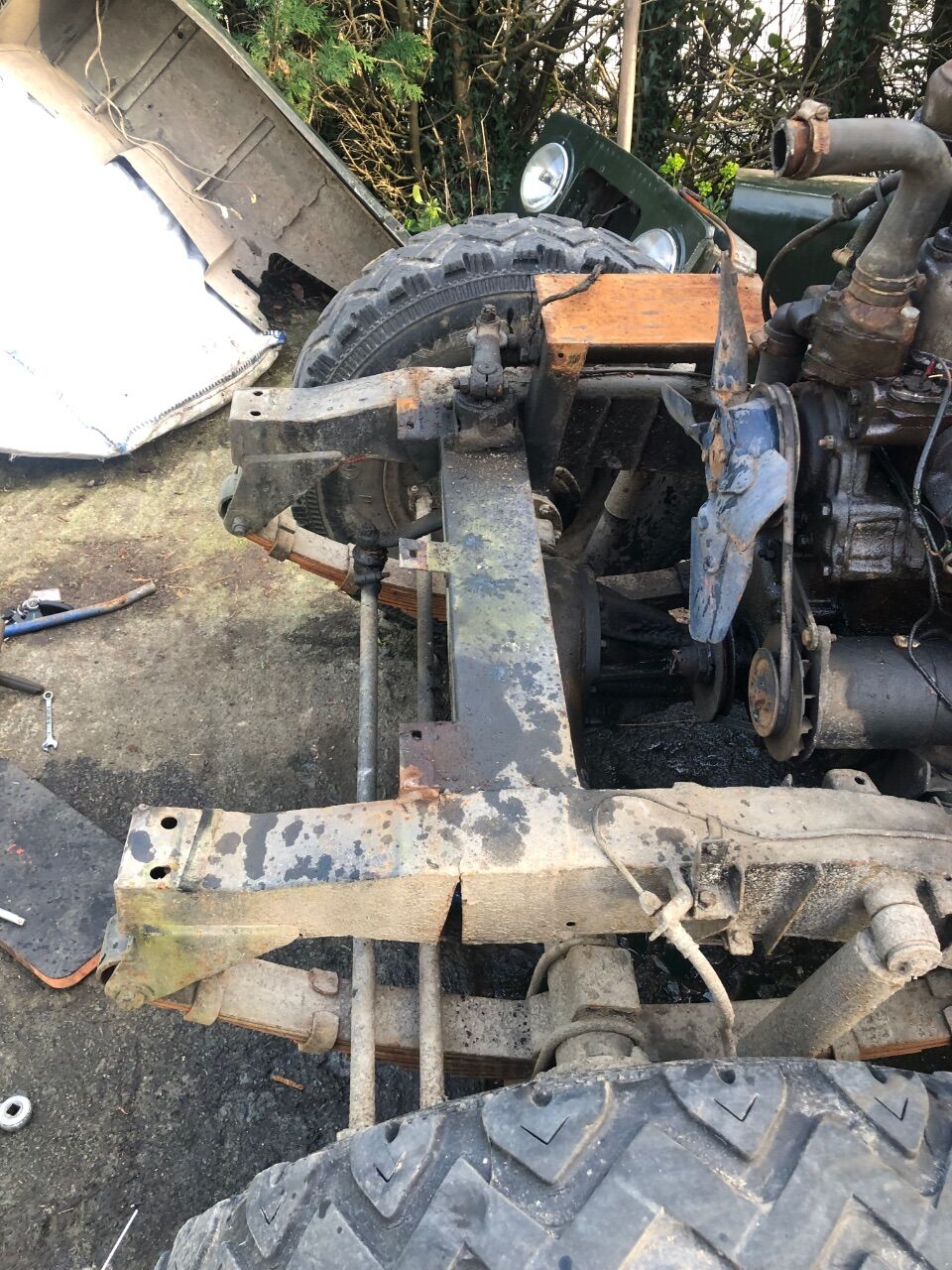

Here’s the damage
The crack on the left hand side (bottom photo) has torn the front off the crossmember adjacent to it. The radiator panel (250 quid) was pretty rusty but has broken at the bottom.
