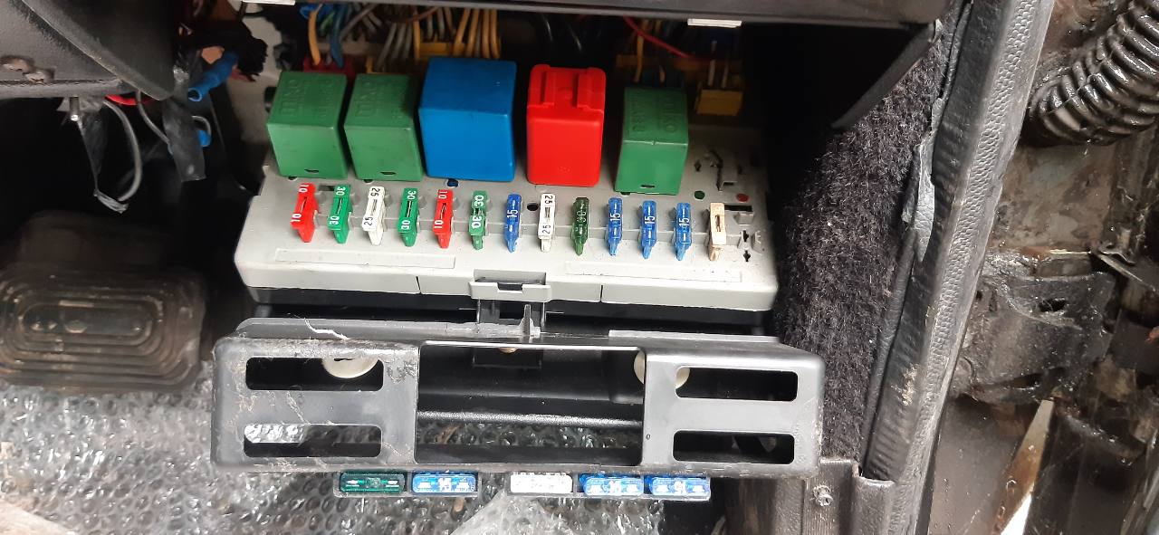

Tadhg Tiogar Posted April 9, 2021 Posted April 9, 2021 22 hours ago, bezzabsa said: ...Any one had experience with LED in Indicators?.... I've always used LEDs in indicators; currently have them in both the CX (with a change to LED-specific flasher relay - red one in the photo) and the diesel Borat (which needed a modification to the original flasher circuit, which is built into the hazard switch) chaseracer and Minimad5 1 1
