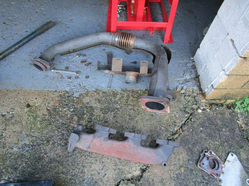

Justwatching Posted December 28, 2022 Author Posted December 28, 2022 Only got the crossover pipe and driver side manifold off! Boss battle next: the passenger side manifold. Dave_Q, danthecapriman, Popsicle and 6 others 9
Justwatching Posted December 29, 2022 Author Posted December 29, 2022 Passenger side manifold off. As expected, it was a pain in the arse. No snapped studs though, so I'm chuffed with the result. As you can see, clear evidence of leakage from the rear cylinder. I'm pretty certain now that was the ticking noise. mk2_craig, Popsicle, mercedade and 8 others 11
