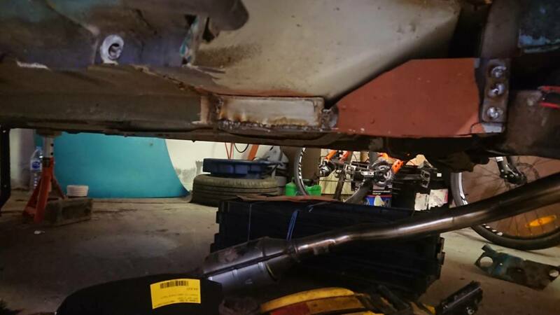

Had another welding session at the Corsa.
Manged to buy some new outriggers. So on with those first.
Then finished off closing in the rest of the chassis rail.  Followed up with a tidy up session with a flappy disc and the powerfile to neaten the job.
With a good dose of Buzzweld Rust Encapsulator to protect it all. Inside of the new panel was coated with R.E and Buzzwelds WAR undersealer to hopefully keep it solid for another lock of years to come.

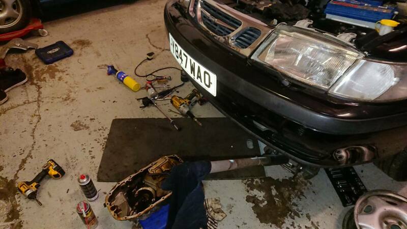

Sump out.
Just a simple five minute job*.
Was worth dropping it. Typical B205 fashion, there was crud in the pick up pipe.
Should be another simple 5 minute job* to get it back in.
*Funny lies you tell yourself*🤪
Wish I had known (or I had bothered to ask) this before ordering the parts 😂
Never mind.
Got the sump fired in and used the correct sealant.
Found by removing two subframe bolts and jamming in a small bit of wood, I was able to sneak the sump back in.
Once I had thrown back together and removed the fuel pump relay. Just so I could wind the engine over to build up oil pressure.
Then started up and we're all good. No leaks and no weird noises.

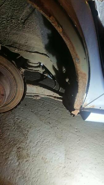

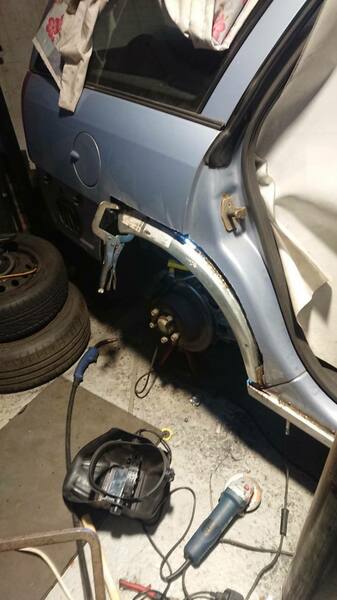

Now that Vectra. Knew it needed some work about the back arches. So let's get the grinder out.
Oh. That's not too bad. I'll just keep nipping at it.
Ohhh.... Hmmm...
I packed it up and went home. For a think. Thankfully I planned ahead.
It's getting fixed. I just need to plan where to make a start from.

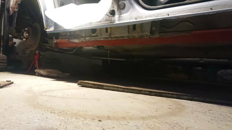

Inner sill edge and that centre sill thingy are all now soild.
It'll be all done in red oxide (Bonda rust killer stuff) just shortly.
Just to remove the remaining sill at the front. Clean that area up and on to a trial fit of the new outer sill.

Bit more done with the Vectra.
Trial fit of the sill.
Then the tedious task of drilling holes in for plug welding the sill on.
With a good coat of red oxide primer after and spraying parts that I couldn't get to afterwards in buzzweld WAR.
Plug welding done. Time to do the upper edge. Small tacks all along, still blew through. Got there after a while.
Didn't take many photos as I wasn't sure if it was worth it. The last photo was me starting to grind back the welds.
Wished I used the whole sill instead of how I had done it.
As a first time doing a sill however. It's actually turned out better than expected.

Car has an new inner arch on now.
I chopped more of the outer off after taking this photo. Which improved access for welding the new inner arch on.
Still a little bit more to do. But that's no biggie, I have actual good metal for welding an outer too now.
Yay!
