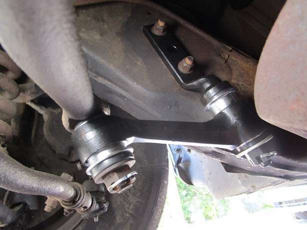

Justwatching Posted March 28, 2023 Author Share Posted March 28, 2023 4 hours ago, PhilA said: Correct. Ford didn't use gas pressurized shocks at that time. They should offer a decent amount of resistance in both directions but there's a good chance they're pretty worn out. New ones never hurt. Weak resistance, so still the correct decision to replace, even if arrived at through faulty logic. PhilA 1 Link to comment Share on other sites More sharing options...

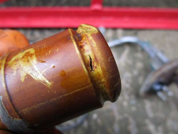

Justwatching Posted April 1, 2023 Author Share Posted April 1, 2023 Replaced the coolant header tank today as the original had perished with age. Unfortunately, the only available replacement is stainless steel. This is a common theme with aftermarket DeLorean parts - everything must be stainless! It adds unnecessary expense and weight to everything. It's even less functional as I can't see the coolant level without removing the cap. Better than letting the original go pop I guess. Right, onto the Ford. The fuel gauge stopped working last summer. Got the sender out of the tank today and found a pretty obvious cause - the float doesn't float. I've ordered a plastic replacement. It was for a Triumph or something, but should be the same size. danthecapriman, Scruffy Bodger, Dyslexic Viking and 10 others 13 Link to comment Share on other sites More sharing options...
Justwatching Posted April 2, 2023 Author Share Posted April 2, 2023 New dampers installed on the LTD today. They were listed as the heavy duty/improved handling option. Apparently 25% more damping effect than original equipment. Can't drive it yet as the fuel sender is still out awaiting a new float. danthecapriman, Scruffy Bodger, Popsicle and 4 others 7 Link to comment Share on other sites More sharing options...

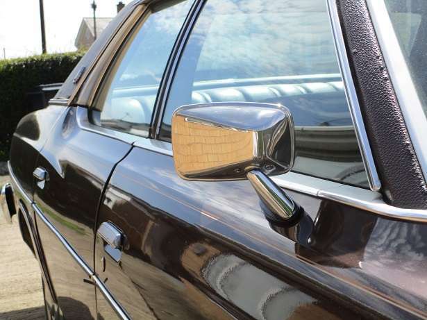

Justwatching Posted April 9, 2023 Author Share Posted April 9, 2023 Installed a passenger mirror on the LTD. It's not exactly the same as the OE mirror on the driver's side, but close enough at first glance. Thought it would make the LTD easier to park/manoeuvre, but it's basically a magnifying glass that gives a postage stamp field of view. Brake light out on the DeLorean. Not had the rear light clusters out before. Easy enough - six external screws. I don't get the obsession with concealing nuts and screws on modern cars. It makes the car fussy to manufacture and repair, and doesn't really add much aesthetically. The DeLorean's rear end looks great, and uncovered screws don't detract in the slightest. Anyway, back on topic. The lamps are mounted to a PCB clipped to the rear of the cluster. I tested the brake light circuit on the PCB and lamps for continuity. All fine. I probed the connector to check for voltage when pressing the brake peddle. Also fine. I messed around bending the connector pins for better contact and swapped out lamps with known good ones, but still nothing. Finally, I swapped the PCB from the passenger side to the driver side and got brake light illumination. So, despite not being able to see or find any problem with the driver PCB, its the only component consistently associated with the issue. I've ordered a new one, so we'll see if I'm right. bunglebus, Popsicle, scdan4 and 10 others 13 Link to comment Share on other sites More sharing options...

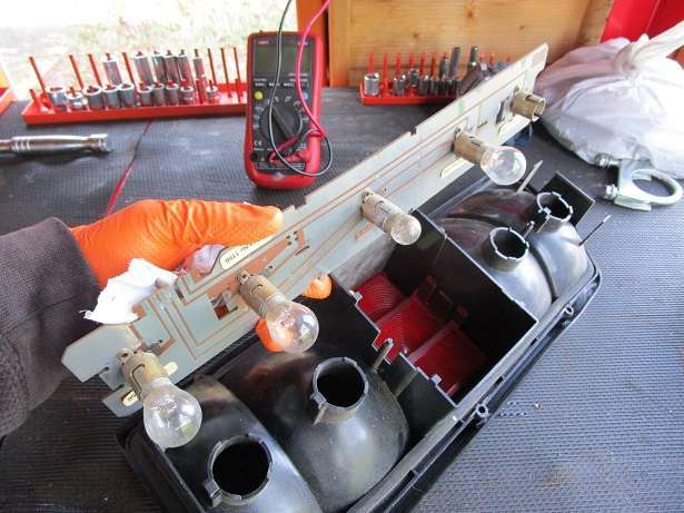

Justwatching Posted April 12, 2023 Author Share Posted April 12, 2023 Minor update: a new PCB arrived for the rear light cluster. It fixed the brake light issue, which is what I expected, but also still kind of confusing. I don't get how the old circuit can have continuity but still not work. The parts supply for DeLoreans is amazing. Not only better than any classic car I've owned, but better than most moderns. I can actually get more spare parts for my DeLorean than my Saab 9-3. Scruffy Bodger, JMotor, LightBulbFun and 8 others 11 Link to comment Share on other sites More sharing options...

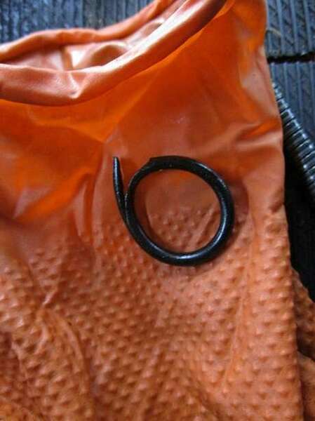

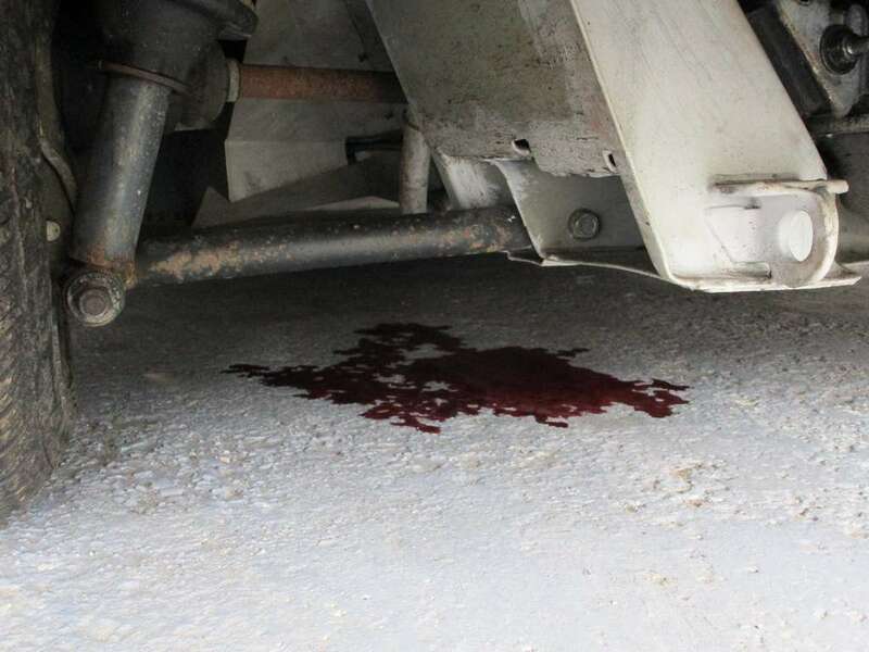

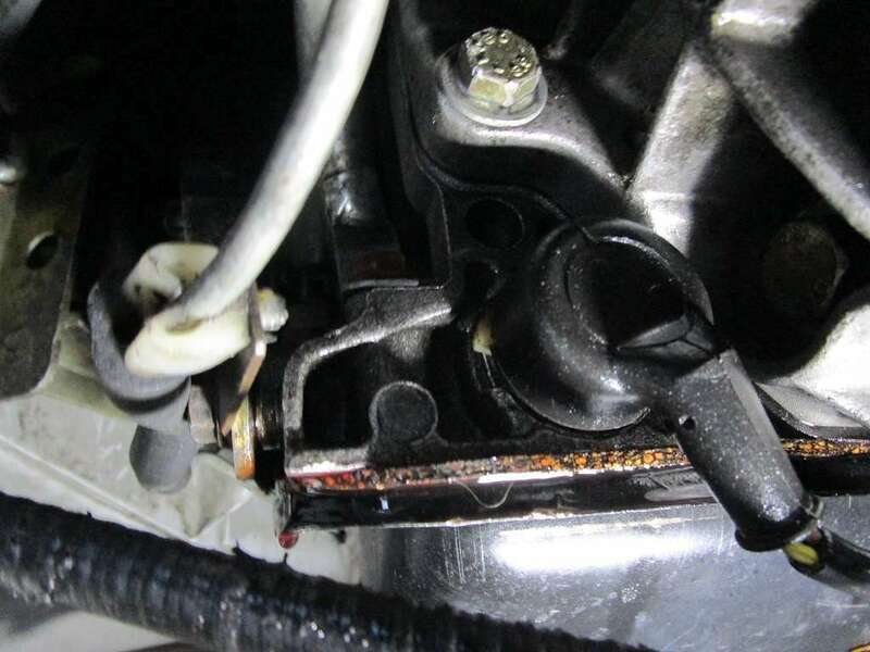

Justwatching Posted April 17, 2023 Author Share Posted April 17, 2023 Day off ruined by finding this. Yes, that's a puddle of ATF under the transmission I had professionally* rebuilt just four months ago. My first thought was the sump pan gasket as everything above it looked dry. Re-torqued the sump bolts (all of which were a good 2/3 of a turn under spec.), but no improvement. Used a mirror and flash light to get a top-down view and spotted a bead of ATF around the base of dipstick tube. The o-ring is definitely knackered, but that could have happened when I pulled the tube out. I'll replace it and cross my fingers! JMotor, djim and Dyslexic Viking 2 1 Link to comment Share on other sites More sharing options...
Justwatching Posted April 24, 2023 Author Share Posted April 24, 2023 Replaced the dipstick tube o-ring. Thing is, the anchoring point was mostly stripped out, so it wouldn't tighten down enough to seal. More butchery by The Automatic Gearbox Company. They used the wrong bolt (too long) with no washer. It probably bottomed out and then stripped. That's my theory, anyway. Using the correct bolt and washer, I threaded it slightly off square. It managed to get enough bite to tighten down. That will do for now - no more leak. The alternative (read: proper fix) was re-threading the transmission casing. Also changed the thermostat to address a cool running issue. It was somewhat involved as you have to remove a "w" shaped section of the intake manifold. Didn't make a difference! Saw it coming when I fished the old one out and it was closed, not stuck open like I was expecting. I felt a bit dejected, so thought I'd change the handbrake cable for an easy "win". Big mistake. The handbrake cable pulls on an arm which pinches brake pads on the rear disc. The connection between the cable and arm had broken on the passenger side. The cable passes under the transmission, through the sub-frame and into the cabin where it connects to the handbrake lever. You have to remove the driver seat to get sufficient working room. You lift the carpeted box around the handbrake lever forward and up to gain access to the mechanism. I poked the cable through from under the car. Problem is, it passes through a hollow and needs to turn between going through the first and second hole, all of which is done blind. Attaching the cable is also awkward; you have to get just the right angle while pulling on the cable to slot it in the top of the mechanism, and then the cable for the driver side comes out the bottom, so you start again... Routed the cable all the way back to the start point to find I couldn't get it into the adjustment bracket. Deep Joy. I got there with brute force in the end, but I think I must have installed it in the wrong order or something. The whole thing took about 4 hours and fought me every step of the way! Asimo, Dave_Q, Dyslexic Viking and 8 others 11 Link to comment Share on other sites More sharing options...
somewhatfoolish Posted April 25, 2023 Share Posted April 25, 2023 Buy a not-a-helicoil thread repair kit and fix it for about £25. Link to comment Share on other sites More sharing options...
Justwatching Posted May 1, 2023 Author Share Posted May 1, 2023 On 4/25/2023 at 1:13 AM, somewhatfoolish said: Buy a not-a-helicoil thread repair kit and fix it for about £25. I ordered a thread repair kit, but bodged it out of boredom while I waited for it to arrive. Cross-threading worked surprising well and it's stayed dry for two weeks now. I'm minded to leave it alone unless it starts leaking again. somewhatfoolish 1 Link to comment Share on other sites More sharing options...

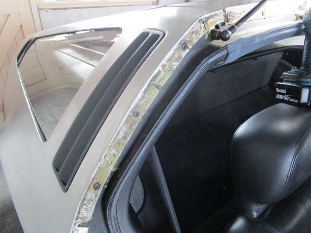

Justwatching Posted May 20, 2023 Author Share Posted May 20, 2023 Pulled the old door seals out of the DeLorean, removed the old adhesive and cut the the replacements to shape/length. I used duct tape to hold the outer seals in place while the adhesive set. The inner seals just push on and seat with a mallet. All went great until I tried to close the door...and couldn't. Many door slams and much lubricant later, the doors are now usable, but it's taken two weeks to settle in to that point. The doors still need a very deliberate shove to close properly. I hope they get better, but I fished the originals back out of the bin just in case. Took the Ford to Mavericks car meet on Tuesday evening and kept getting whiffs of raw fuel when I had the window down. The car only does 15 miles to the gallon, so I really can't afford to be dropping any! Got it up on ramps and found the fuel return line was leaking just above the pump. Luckily the split was right at the end and I had enough slack to just trim it off and re-fit. I've brought the off-cut indoors with me to figure out what internal diameter I need to replace the whole section. Also noticed the car wandering around at speed, needing small but frequent steering corrections. I started tugging steering components while I was under there to see if any of them would confess. The idler arm had loads of play where a chunk of the bushing had fallen out. Rusty parts always put up a fight, but it wasn't a bad job; 30-40 minutes. Should have painted the area while I had it out, but it was Friday evening after work and I just couldn't be arsed. CreepingJesus, LightBulbFun, Tickman and 5 others 8 Link to comment Share on other sites More sharing options...
