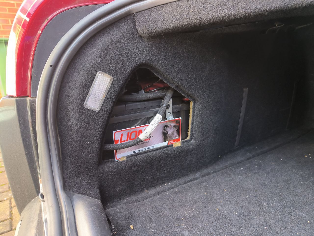

The battery location, however, is bollocks.  The "access hatch" looks like this:

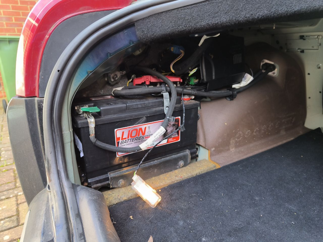

Which is like trying to do keyhole surgery without the right tools.   A lot easier to have the side panel off to gain access:
IMG_20260228_121048_390.jpg.1780040903587c527b5dbbf394405f17.jpg8
And you can see the absurd distribution board which is entirely held on with the positive battery clamp.  Ah well, fixed now.

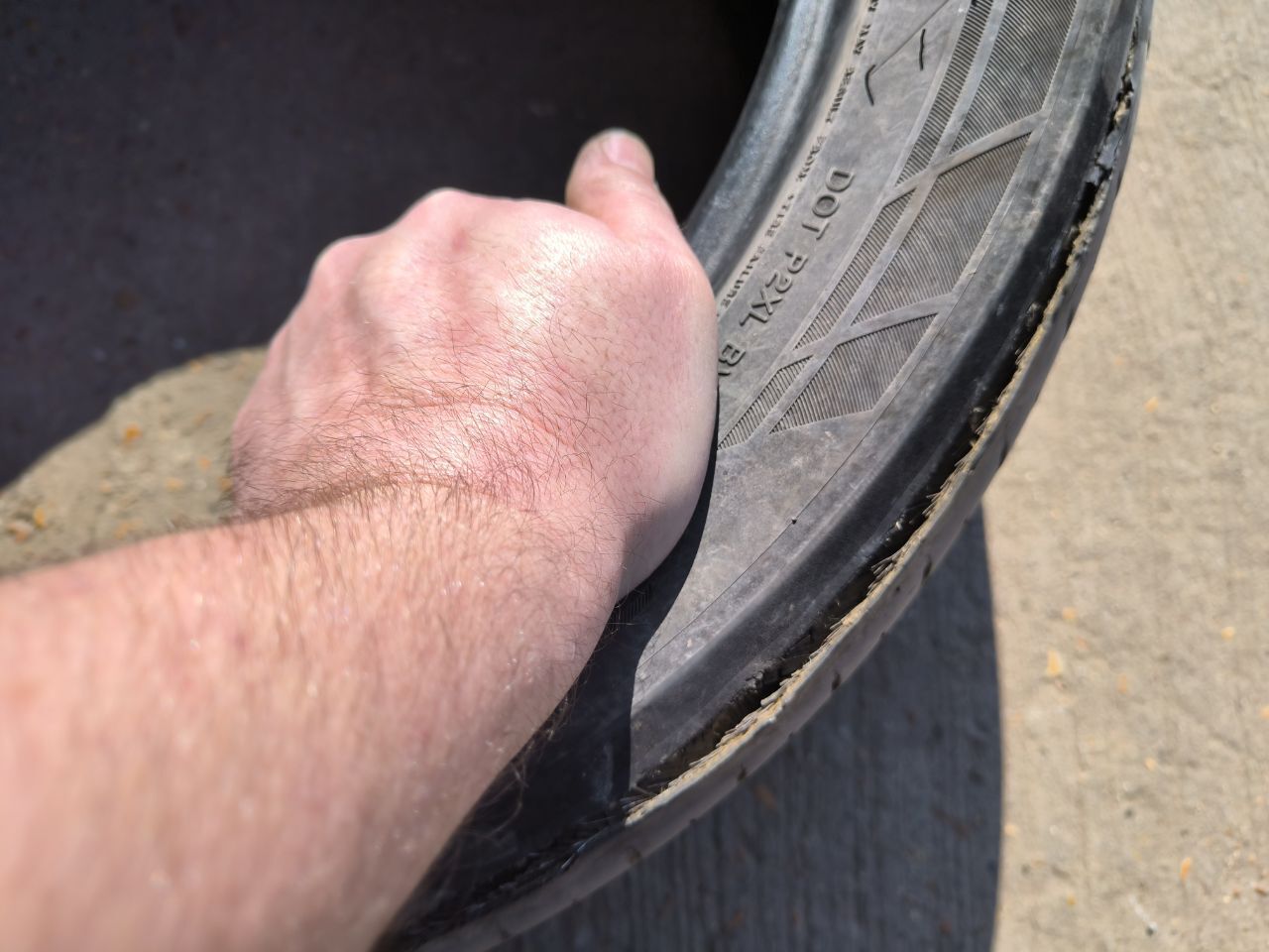

Anyway.. having now done about 4k miles in this, it seemed like it would be a good idea to put some rears on it.  So I had a look at them, only to find that both rears were through to the cords (And beyond) on the inner edge, and were about to de-laminate quite badly.  Ah shit.  OK, well that's two tyres needed.  What about the fronts?  Well, they're both very close to the wear markers, and beginning to go through to the softer compound on the edges, as the tracking was out when I got it (since fixed) and they're pretty crap.  OK, so 4 tyres needed.
Ordered 4, and spent an afternoon at my tame mechanic's garage changing all 4 tyres.  Which is quite a bit of work when you're as unfit as I am:
Oh dear:
Oh dearie me:
Oh shit that is quite bad:
Holy shit that was lethally bad:
Err... you didn't see that and nor did anyone else.  Ahem.
Probably for the best that you changed those 🫣
The combination of that particular brand of tyres (I have experience of them -and very much not good experience) and them being old was potentially a very bad day waiting to happen.
