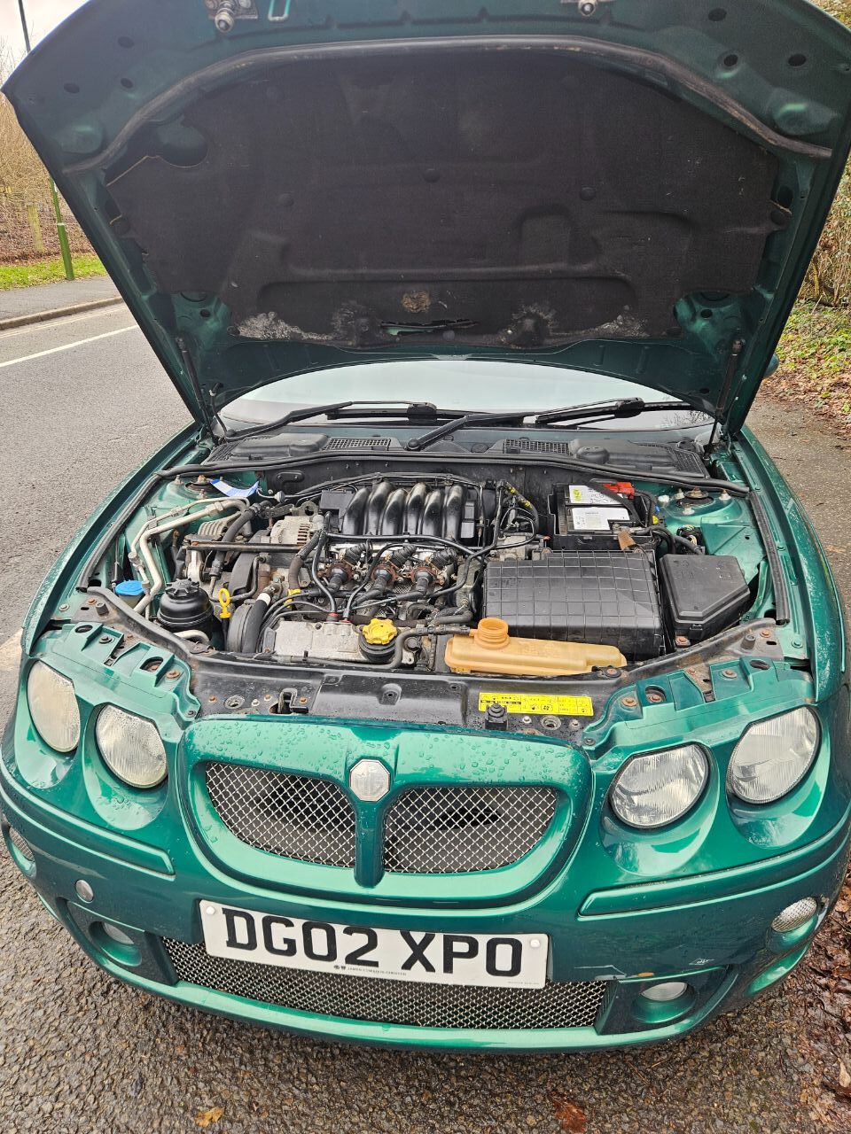

The latter, I can't work out where it's going, unless it spat so much the first time that I've not got all the air out yet (hardly been driven since the incident, the fuel rail only arrived a week ago).
Doesn't overheat and the heater is red hot so that seems OK, but when revved it pushes a lot of water out the expansion tank with the cap off.
I'm going away for the week so I'll see what's left in it when I come back.

Right, earlier I topped it up, ran it for a bit, took it for a 20 minute drive, seemed okay.
Just gone out to it again now it's cooled down, and it's drained the header tank again.
I guess the day when it's absolutely pissing down is not the day to diagnose a water leak. It can sulk until the ground dries out.
  • Crackers changed the title to Cars of Crackers - Fuck all cars, forever
How nice does this look after a wash and clay bar?
Mechanically though... It's looking shit. It's gone through 2 litres of water in an hour.
That can't be anything other than HGF, surely. I'll try and diagnose once I'm back from my work trip, and if it's true, then I'm utterly done with cars.

A few things to try. I know its had stuff done but it is possible for parts to be faulty/mistakes made.
1) Water pump. What temperature is it running at? Have you put the car in diagnostic mode? That will tell you exactly what temperature its running at. Air could be getting drawn in via a nick in a seal (I accidentally put a fold in the gasket once when fitting a WP, causing a big leak!) Google will tell you the procedure as its a while since I've done it on mine.
2) Sniff test. Have you done one. This will rule out exhaust gases causing the coolant to push out. Tenner from Amazon if you didn't know.
I'm definitely for putting it to one side and forgetting about it for a bit. You'll get bored with a 'normalish' car, that's what stops me doing that.  If you're nearby Ron Saab Leeds, he has a few very bargainous 93s for sale, in good condition and with a bit of come back too.
Both of these to check when I get back from Das Germany. Just ordered a sniff test kit so hopefully that will be conclusive. Hoping for some dry weather so I can attempt to spot any water leaks too. 🤞
How does the ZT otherwise run, coolant loss aside? Does it drive as if it has 190bhp?
It could be HGF but while it’s not unknown in a KV6, equally it isn’t the most common fault.

TL:DR - Coolant caps can be shit.
Had a similar problem with 1.8 K powered ZT. I replaced the seals in it, but the car was sold before I knew if it had worked.
Might not be the actual fault. But it's cheap and easy to do.
