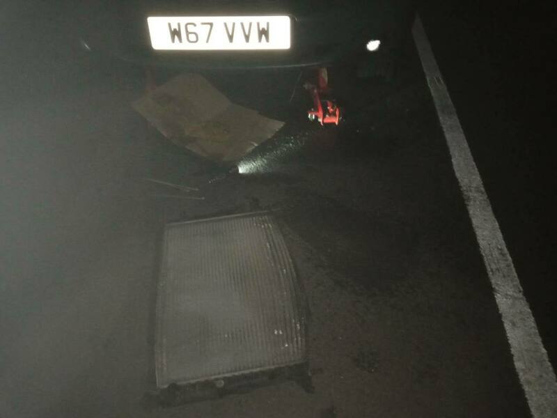

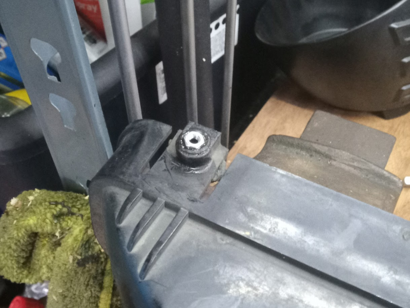

The glamour of life at 32 - when a wild night out means, err, pulling the radiator out of a Mondeo at quarter to eleven at night.IMG_20211001_223520_8.thumb.jpg.48b661e23a39e1ab207dc8c229c66170.jpg
The collapsing on the bottom is pretty impressive...
Two of the mounting bolts sheared off in the hole, so that's to be drilled out tomorrow. New nuts and bolts all round I think. M5... Oddly small.

Fan unit out, looks in good order. Bottom brackets have sheared off screws inside captive nuts with very little access, so they need somehow destroying to replace with a new nut and bolt.

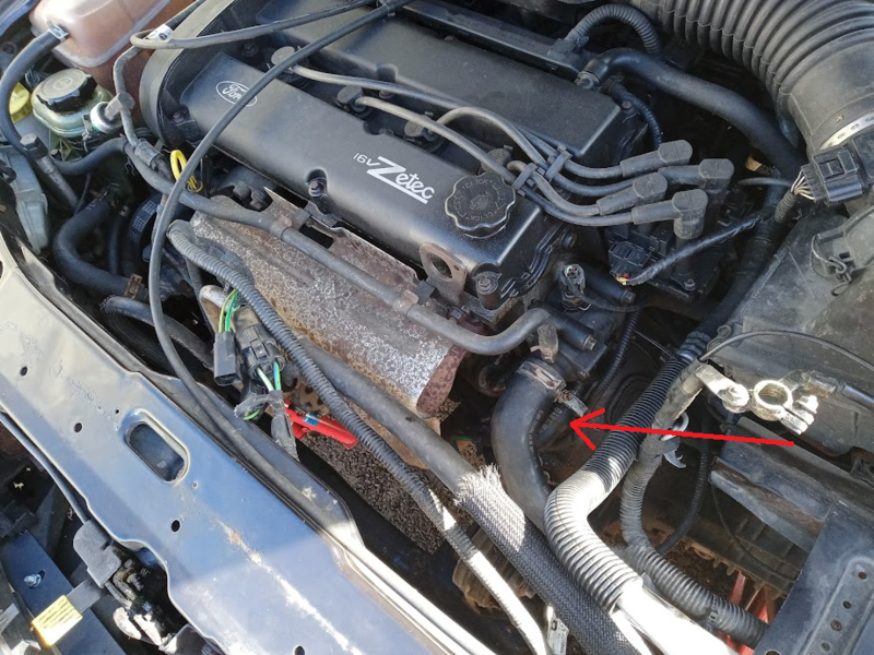

Meanwhile, sorting out an existing thing in the engine bay. The indicated coolant pipe blew back in December and I replaced it with a suitable-ish merc one from the 'random hoses and pipes' box of the local garage. Today I trimmed it down to size properly and tidied up the fixings. It's satisfying to do these little bits and pieces.

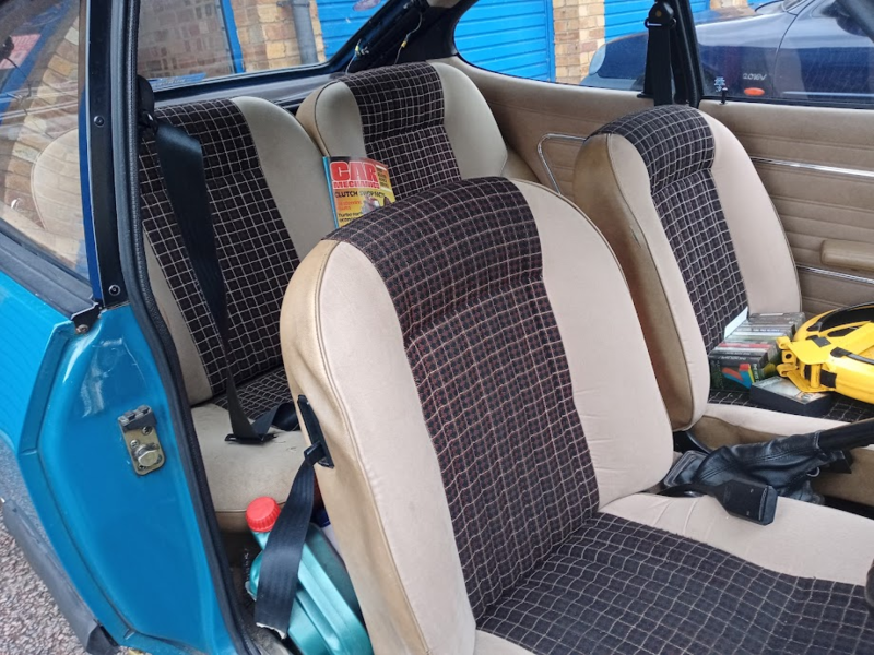

This week began with a need to send photos of the Capri to the insurers for the agreed value. You can tell the difference between the re-covered front seats and the original rear seats in this picture... although I'd like to get the rear ones done one day, money prohibits for now.

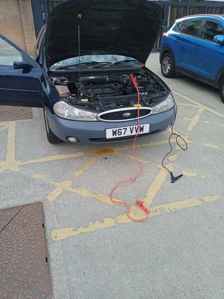

Tried jumping, no luck. (subsequently found my jump leads to have shit on one of the terminals which is probably the reason the quick solution didn't work).
Called Autoaid. 90 mins for a bloke to come out and jump me... not ideal, but I was safe sitting in a car park being bored and it was my own stupid fault so can't complain.

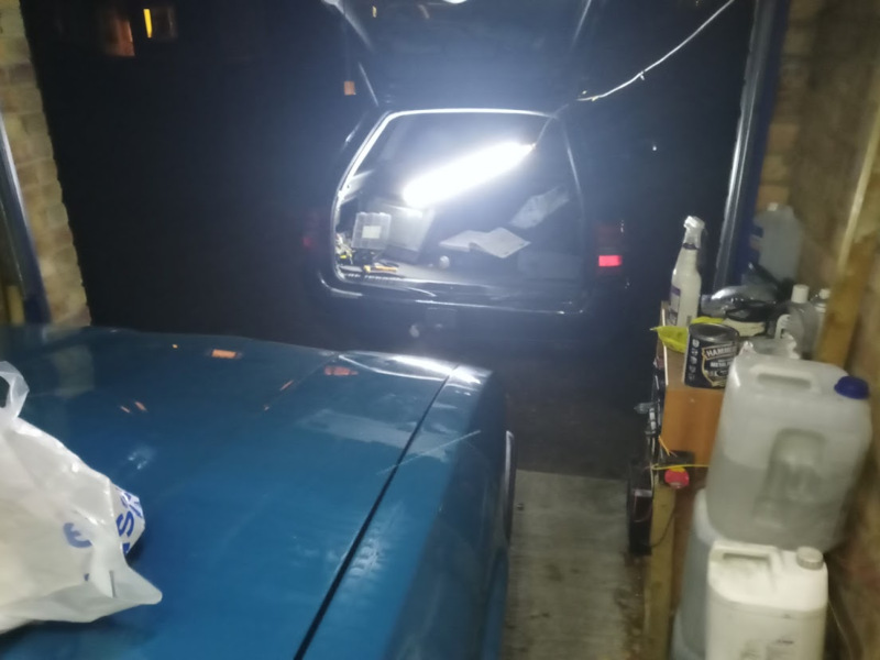

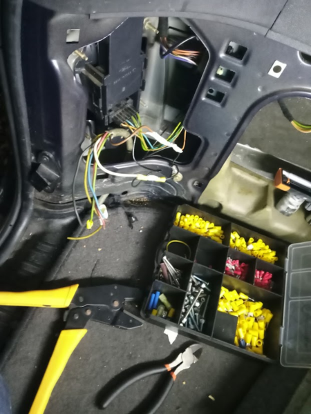

Some moons ago, a kind shiter Mr Tim E, aka @Cord Fourteener, donated a towbar that was no longer needed on his fleet. It's been fitted for about 6 months, so I decided it was time to wire it up. Where did I put the crimps.
Handy extension light that runs off the garage 'power' (old batteries).
Some farting around had to happen with tracing cable colours etc,
still need to sort the indicators, run a cable under the boot to the o/s.
