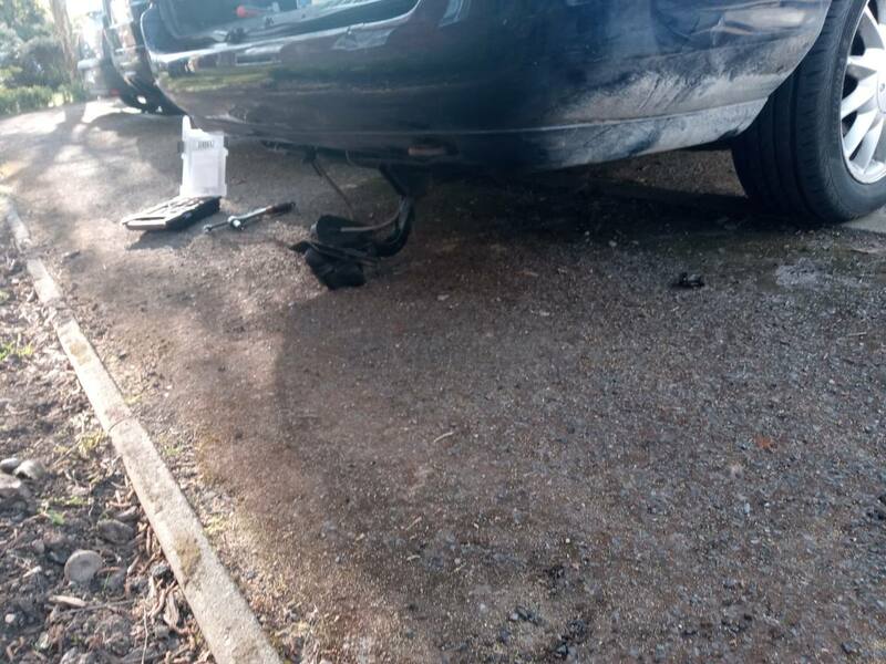

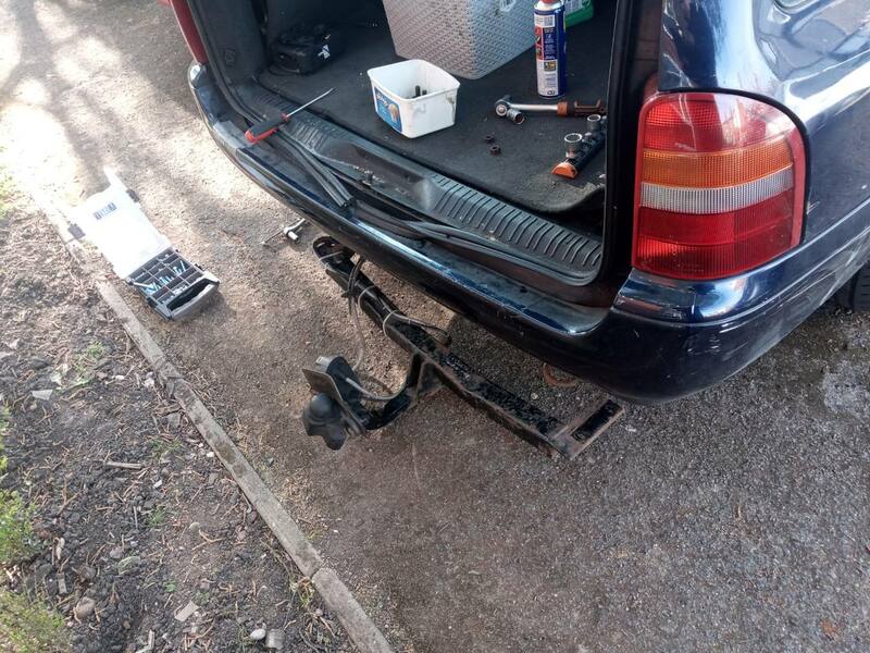

I didn't have any specific plans to tow anything with the Mondeo, and don't own anything to tow anyway. But when @Tim_E kindly offered a Mk3 estate towbar for gratis, I thought there was a fair chance it would fit a Mk2.
Flanges fitted to the rear of the underside and tightened up, time to fit the assembly itself.
I realised at this point that I'd seriously underestimated the weight of the thing, especially when manoeuvring in tight spaces. A jack or second pair of hands would have been so much easier. Nevertheless, I'd started so I'll finish. I used beefy cable ties in the inner mountings to slowly lift it up and take the weight...
... Before swinging it up and putting a bolt in. It should have M12s in, I used some long M10s to make the job easier and give me room to adjust. Even so, that involved crawling underneath, holding the weight of the thing up with one hand/on my chest, whilst getting a nut on the end of the bolt. Hefty!
A bit of fiddling later, and all seems fine.
I'm going to nip to the shop in a bit and pick up some M12 fixings, and will replace them one by one.
Not attempted wiring yet. I'm not sure if there's a connection point on these or if it's a case of manually splicing cables. If the latter, it can wait!

That's awesome. It's almost as if Ford used the same estate rear end on the Mk3 as the Mk2. Where have I heard that before...?
Anyway there's a you tube video of a guy simply splicing the wires in to your rear light cluster wires: from 8:00 mins
When fitting a secondhand towbar to my Mk2 hatch I didn't find any obvious connections or pre installed fitting kit, so it was out with the scotchloks to tap into half a dozen wires feeding the light cluster. Fortunately a fairly straightforward task!  Though somehow I managed to wire things up mirror-image on the lighting board socket itself.
Ahh fairynuff. I may break out the soldering iron, I have a fear of scotch blocks on anything critical. Maybe that's my paranoia. Sounds like a wild journey you had with the fiesta though...

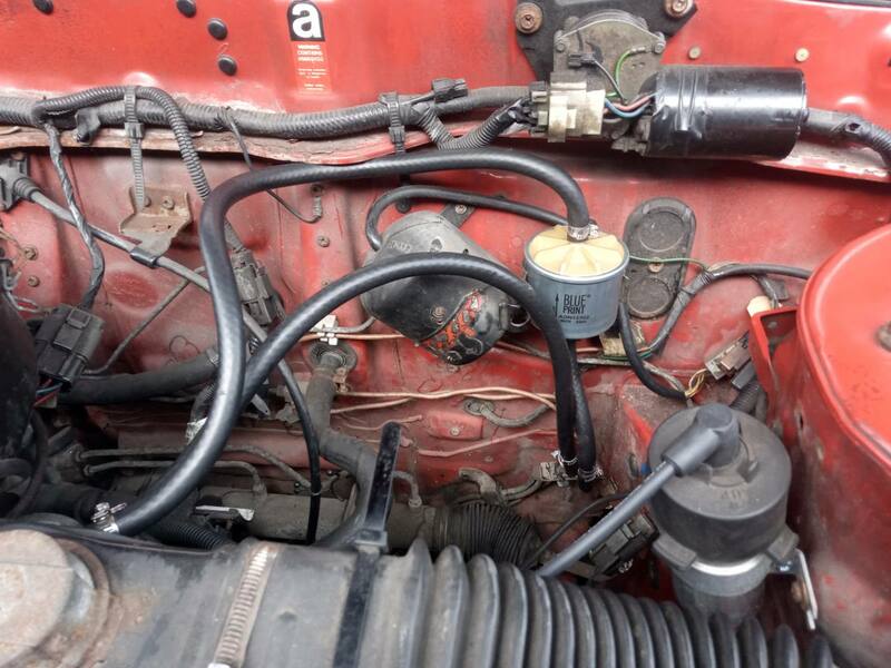

A not-so-productive few hours on the Bluebird today. Heat shield and manifold back on, all good. Took the fuel filter off to get the numbers to replace it, also will do the fuel lines when this comes.

New fuel filter came for the Bluebird on Friday, so I fitted that and new lines/clips today. IMG_20210509_145604.thumb.jpg.bb2e35c4949ea8d396849cbf1579617d.jpg
Slight brown pants moment when I realised one of the connections I'd made was slightly loose and weeping fuel, now nipped up. Phew.There's the remains of a 90s alarm system under the bonnet, but it no longer does anything.

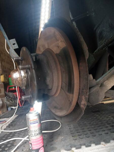

The ungrateful sod started making a scraping noise from the osf when out this morning. Wheel off, I think it was the mud shield from the back of the discs which seemed to be slightly bent. It's been persuaded back a little. Pads cleaned up and everything given a clean. Fingers crossed that'll be it. IMG_20210515_124302.thumb.jpg.e9b7a4b723338146e2692d9e3943755b.jpg
I was wrong. Noise started up again. Wheel off, pads out, brake pedal pumped... one caliper sticking. Great (!).
Seemed to be intermittent as it worked fine when inspected yesterday.
Anyways, caliper fixing bolts soaked in WD, one will loosen now, left the other to soak overnight.
Do factors do repair kits or is it easiest to send it off to a specialist? Probably best doing both at the same time.
Spoke to Burtons today, they do recon units on an exchange basis. They're closed at the moment sadly and only doing main order, but luckily, they will dispatch ASAP and charge you the surcharge and then refund it when your units arrive back posted. That saves a bit of time at least. One ordered up for each side.
I managed to get the bolts both off today. Steering lock helps... as did a large quantity of WD and a blowtorch.

Bit late now, but those calipers are Girling type 16PB. Piece of piss to rebuild. You will need new pistons but they're dirt cheap. Kits readily available and cheap.

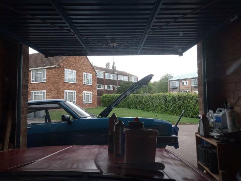

What a perfect day to be bleeding brakes... Can only get to the furthest nipple (NSR) by going outside!
Thoroughly frustrating. New calipers on, everything reassembled, all good. Brakes bled, despite rain, good.
Went for a test drive on a loop around some roads I often use for testing post repair. Brakes could do with further bleeding at the front - not to worry we'll do that tomorrow - go to turn around and what do you know, the scraping noise is still there. Only on turning left with brakes released. Frustrating, since I could have sworn it was the caliper which was definitely sticking.
The only sensible course of action is to pack away and come back tomorrow, I know I'll end up getting more frustrated and totally screwing something up otherwise.

Capri scraping noise continued to elude me, so I popped to the garage and got it up on the ramp. Much fiddling, prodding and theorising happened. Eventually, we reckoned the dirt shield was the problem, so figured removing that would help. So off came the hub.
And what do we know, there's something been scraping the face of these bolts.
That something being a loose bolt from inside the hub, presumably from when the garage changed the bearings pre-MoT in September.
All reassembled and... Beautiful.
So that's a new set of calipers for nothing - well they were sticking when inspected I guess so would have needed them anyway.
