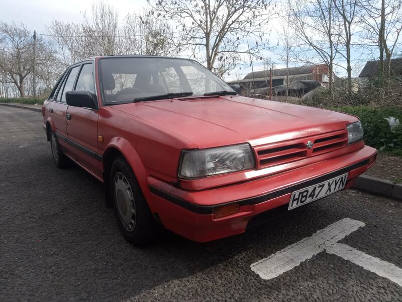

Bluebird has been a pleasure to drive for a good week or so.
However, it's now jumping out of first gear alarmingly. Happened a couple of days ago, then once this morning, then several times at lunchtime. Fingers crossed it'll get home without too much hassle.

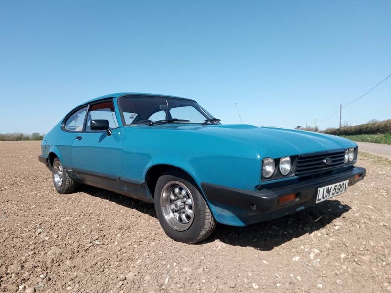

Capri has been touched up this morning. It'll probably not look great from close up, but my intention is to get the scuttle and A posts welded later in the year anyway, so as long as it looks reasonable for the summer...
A trip to see the Capri. Masking removed and pinhead used to touch up one bit. Certainly some way behind perfect.
Good excuse to see if she'll fire up though...
Bluebird has gone into the garage for them to drop the gearbox and investigate those issues. First gear almost impossible to select now.

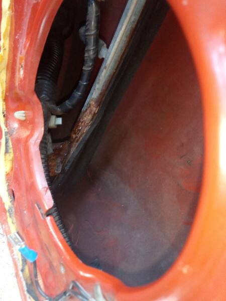

Taking advantage whilst the garage wait to look at the gearbox, I'm sorting out a few Bluebird odds and ends. This runner had become detached at the bottom which I think is why the window originally went out of alignment. I know epoxy isn't the cure for all evils, but maybe this one...
Epoxy seems to have worked, hurrah. Window reassembled and hopefully will stay on the correct plane.

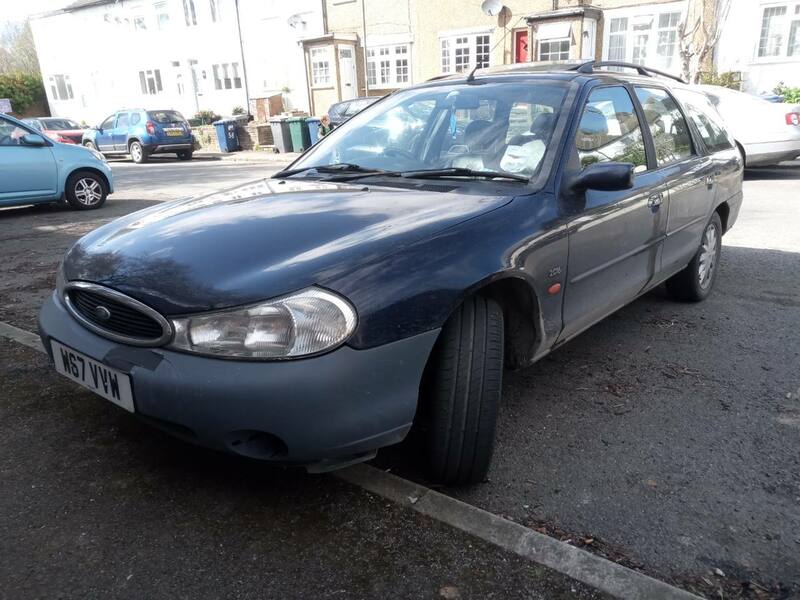

Modern portion of the fleet is on coordinated hissyfit at the moment. The Mondeo clutch is slipping, which came on within a few miles - suddenly came on and became pretty much undriveable after about 10 miles. Fortunately it's now home, and will hopefully be changed on Tuesday.

Bluebird still has difficulty getting into first gear, but is providing transport over the weekend. It will, with careful and gentle clutch action, go in. Or start off in second. Whilst this will undoubtedly ultimately knacker the clutch on this too, it'll be getting replacement when the gearbox gets dropped soon.

Progress. Mondeo clutch apparently a bastard as everything is rusted into place and their factors can't get a new clutch till Monday... But fingers crossed be done by Tuesday morning.
Mondeo gearbox out. IMG_20210412_152150.thumb.jpg.ffcad1a56e1fd319c42713ebe5f774b9.jpg
Going to order up a new bumper that I can pre fit the fogs to, that'll definitely be easier.

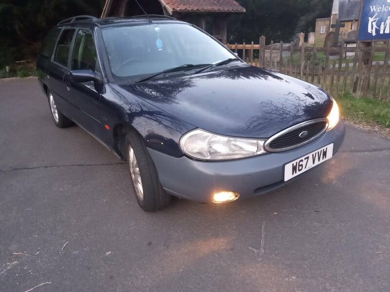

That done, back home and the new bumper for the Mondeo arrived. Frustratingly I'd cracked the one I fitted in October soon afterwards, but new pattern ones aren't expensive. I guess they were a consumable with Mondeos of this era.
This is also an ideal juncture to fit the fog lamps that have been kicking around the flat for god knows how long, so I've got the bumper in the living room and screwing them into position now. Lucky I'm single really... IMG_20210415_205919.thumb.jpg.d4e4cf33f7129d06fe0d7f6431ebccad.jpg

The Mondeo returns today after the clutch job at the garage. As well as doing said clutch, they also dealt with a few brittle wires and a perished brake servo hose.
I'd had a new bumper waiting ready to go on sitting on my dining table for a week or so. Fog lights that I never fitted after the last bumper job ready, and this time I hope to get more than 6 weeks before splitting the new bumper.
In stripping down I managed to knacker the undertray, and a couple of the fixings were a bit fiddly, but got there.
And the fog lights work... Although the ns headlight doesn't which I only spotted just now.
