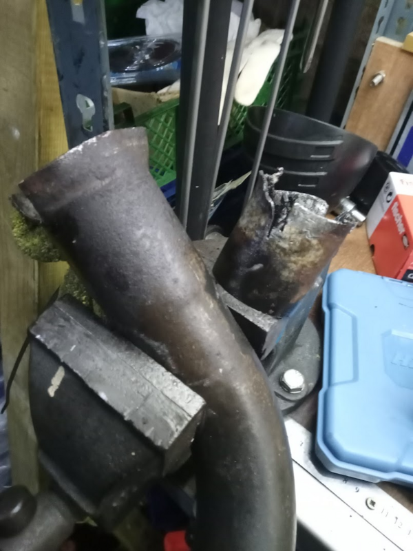

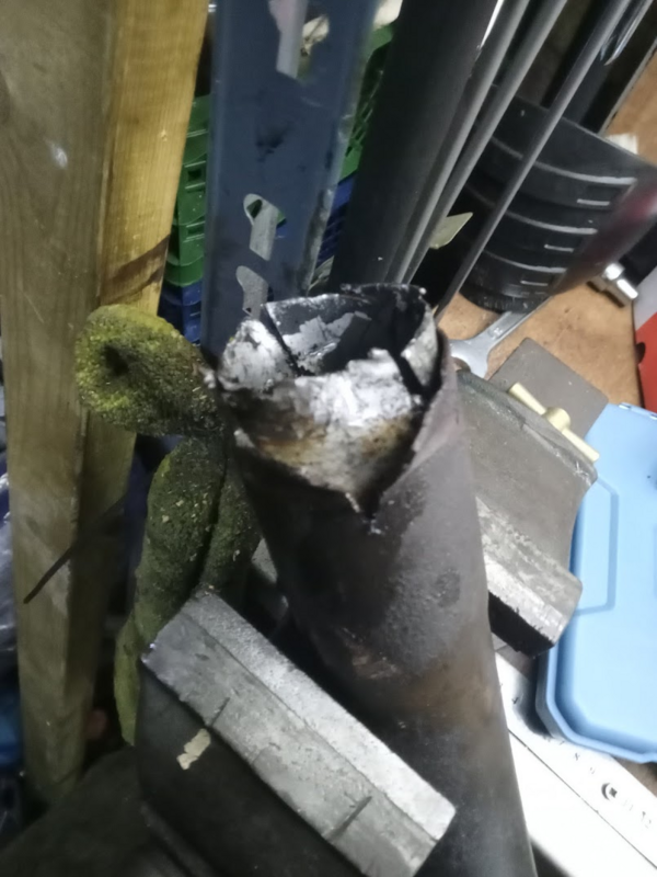

When taking the exhaust off I was utterly stuck separating the manifold and centre section, which needed separated to come out. The manifold was in worse nick with some corrosion in quite a few places so I decided to sacrifice that and the angle grinder made light (ish) work of it.
This left the centre section with about 2" of manifold jammed in it.
Picture was after the flanges(?) on the centre section had been opened up, and the whole thing liberally sprayed with penetrating oil. It was not for budging. I got a small flathead screwdriver hammered down the side a few times to allow more penetrating oil to be sprayed in. I carefully cut grooves in the stuck section so that a claw hammer could get some grip and eventually allow some lateral movement. I was then able to use the claw hammer to "scoop" it up slightly (very slowly).
Some quite significant time and swearing later.
Centre section "flares" left slightly enlarged for now.
Back section needs rubbing down and a repaint, manifold to be in the next (final? hm not sure) parts order.
