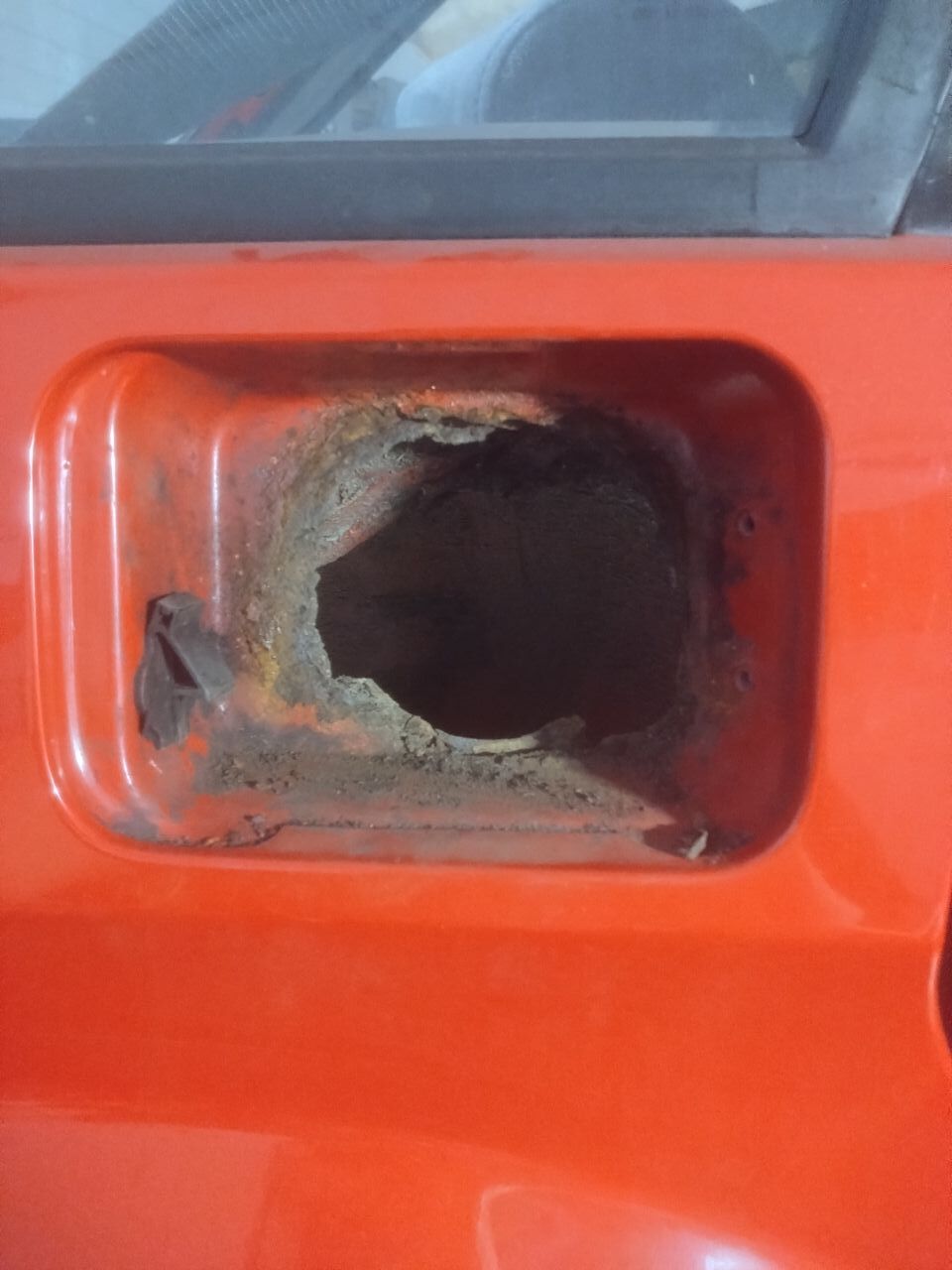

Fuel tank and filler neck removed.
Fuel filler pocket was as expected 😬.

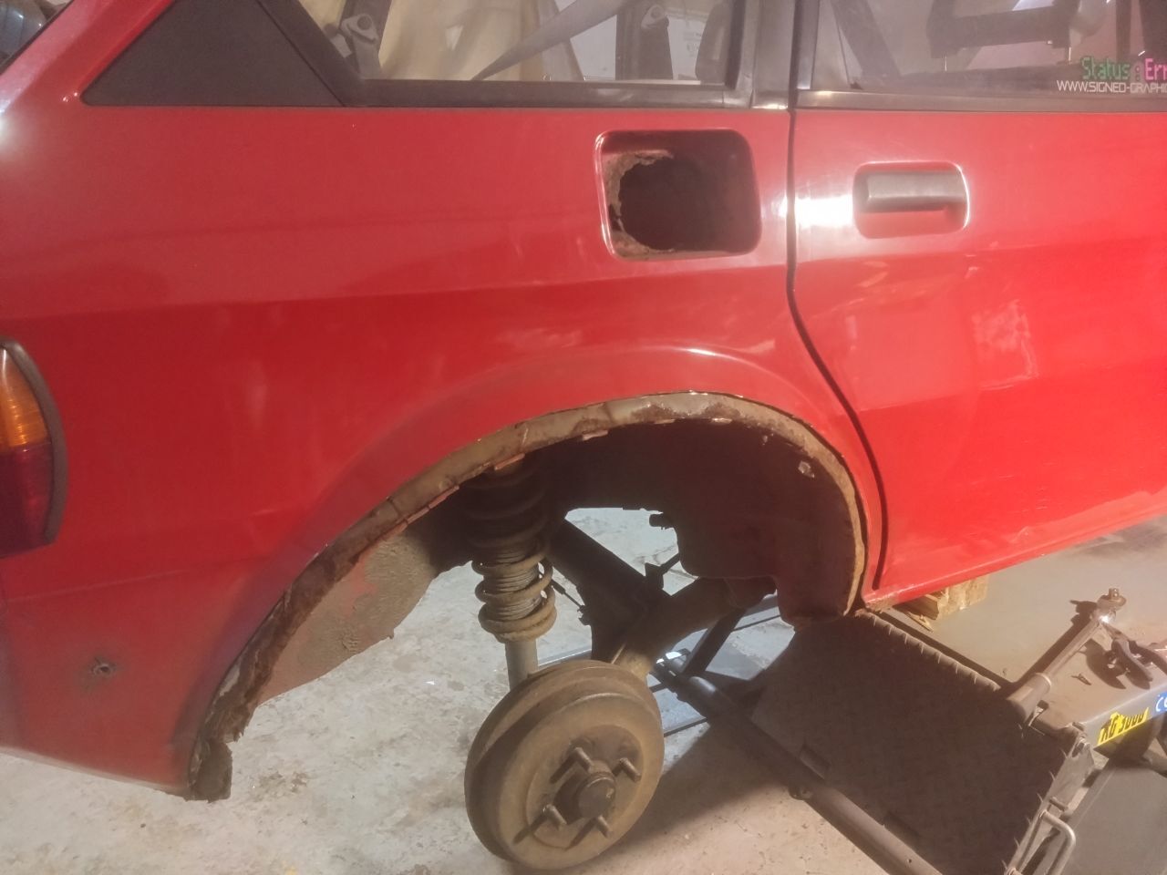

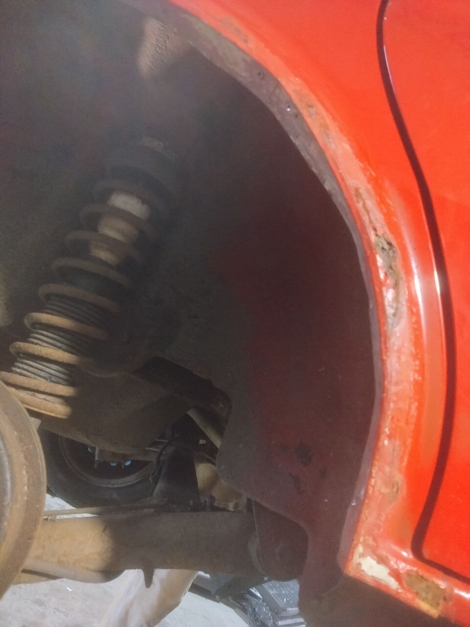

Started picking the arch apart.
It's about the same for rust. Maybe slightly better than the nearside. Still needs work anyway.

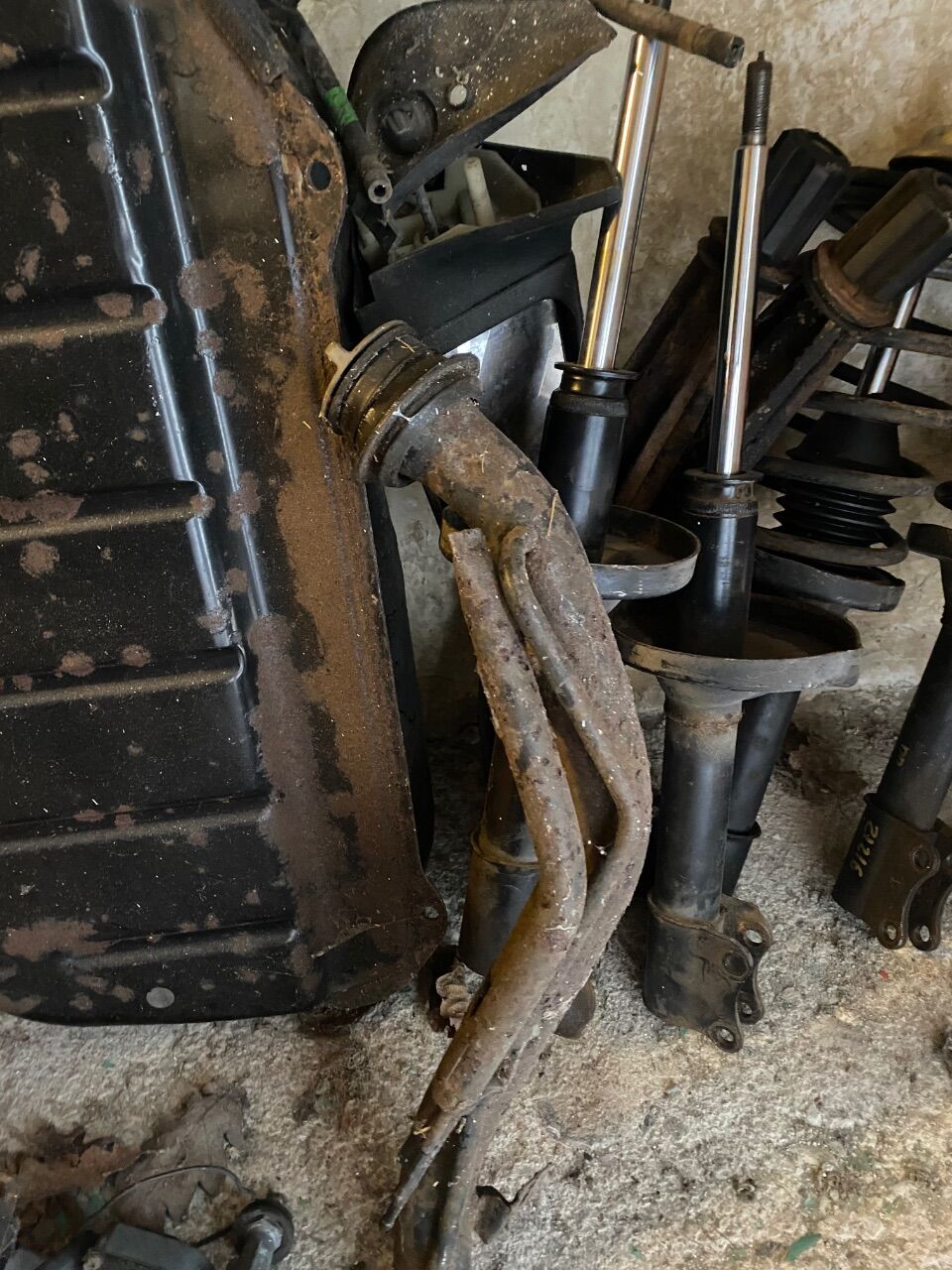

Oh and also check the filler neck... They go, obvs, and are NLA, obvs.
Another group buy of replacements I missed by a few months on the FB Monstro page.
Mine is by some sheer miracle is in one piece.

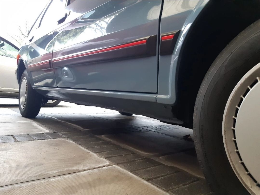

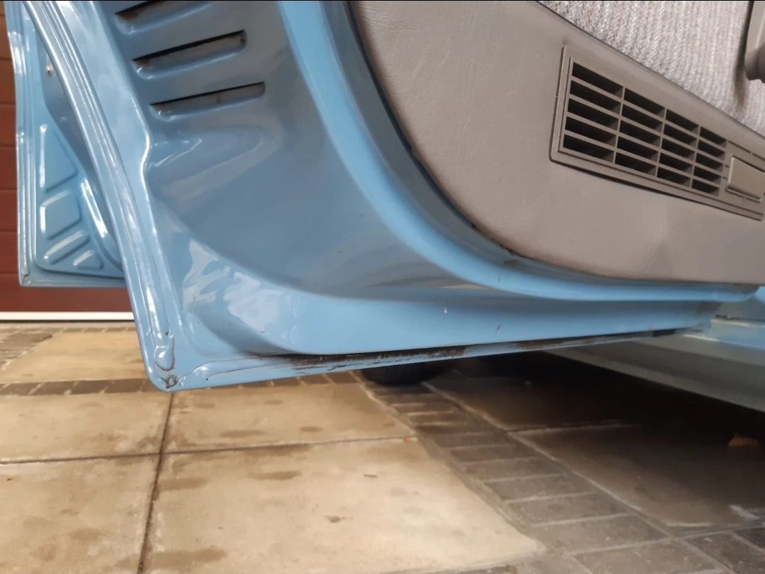

This one that @Cavcraft found is a little beauty, check out the doors and sills. It's enough to make a grown man cry
https://ebay.us/m/6Z6yvW

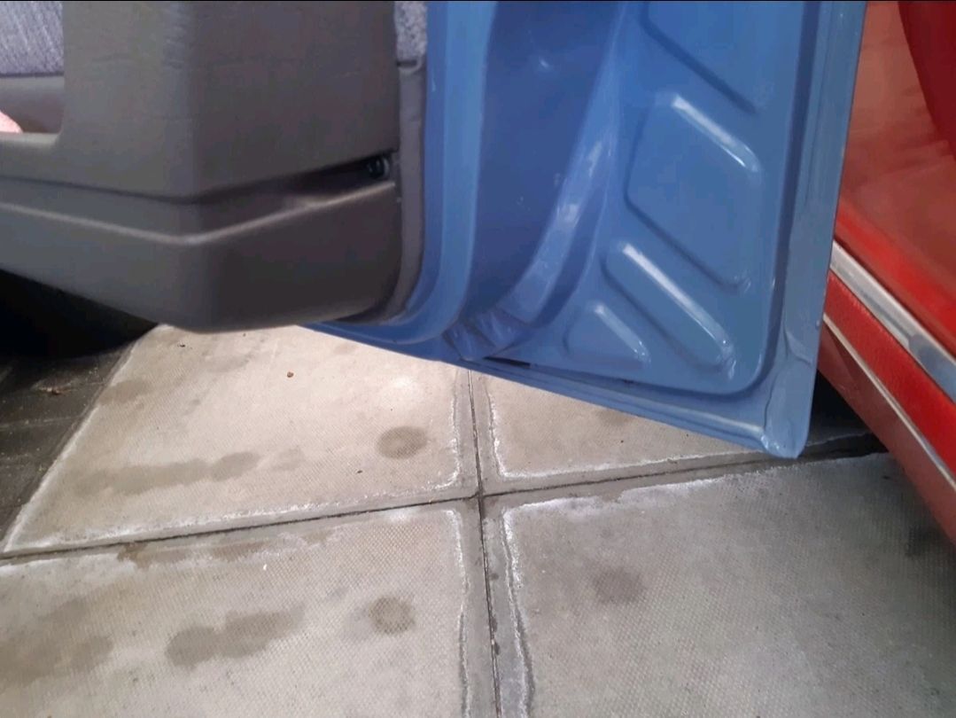

Those door bottoms....

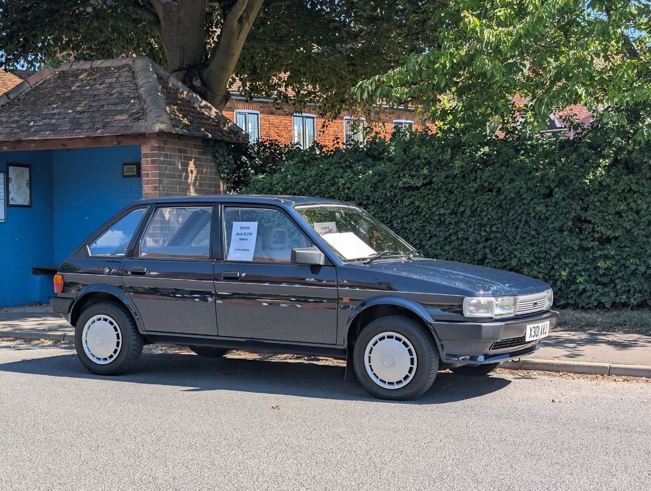

Friend on FB clocked this beauty at the weekend.
5100 miles and looks damn clean. All yours for the bargain price of 6k.
I do think this car was sold by OMGWHITEBACKGROUNDSUPERLOWMILES KGF a while back.
Who dis!?

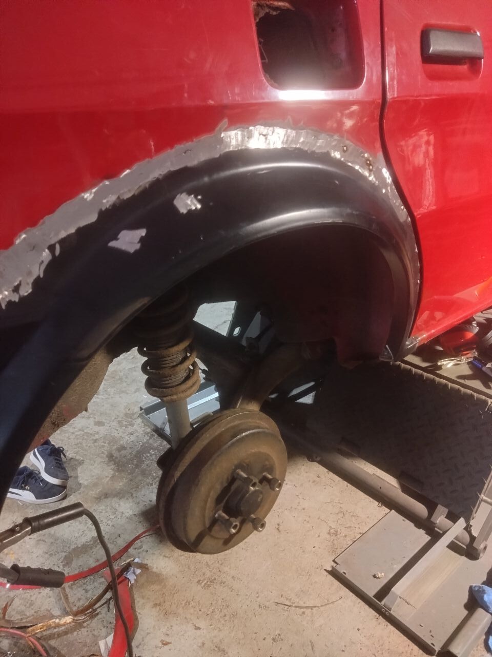

Smoothed welds down on the inner arch and chopped more car off.
I'm at the stage of getting ready to fit the outer arch. It's also GREAT fun to chop up a rather expensive panel. Same as T' other side it was drowned in primer.
Going further up this time and will tweak both quarter and panel for a better fit before welding it in. The inner lip is still to finish on the arch to rear valance area. Having the new arch fitted tells me where I need to go.
I used to stress about this stuff. Now it's almost boring to have the new panel on and off multiple times. I'd rather do it this way, I've done myself over too many times chopping too much off and making more work for myself.

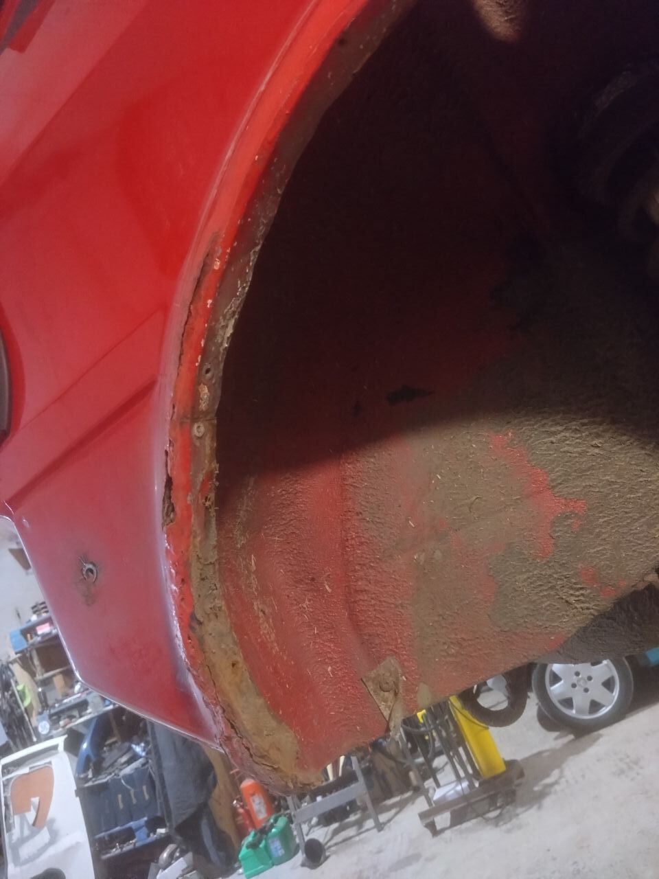

Today's work.
Can now say the car is all metal in the back arches now.
Even this wasn't too terrible.
Sadly it wasn't all good news. Firstly. The pressing of the arch is horrible! I'll need to further tweak it to look better. That can wait though.

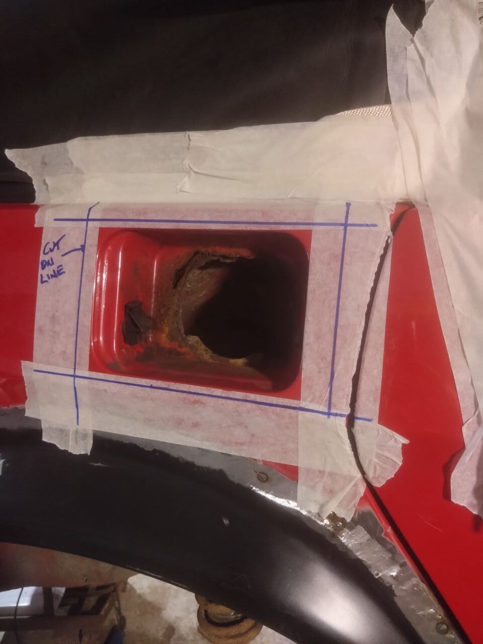

I've left the arch for now. Switched to the fuel filler pocket.

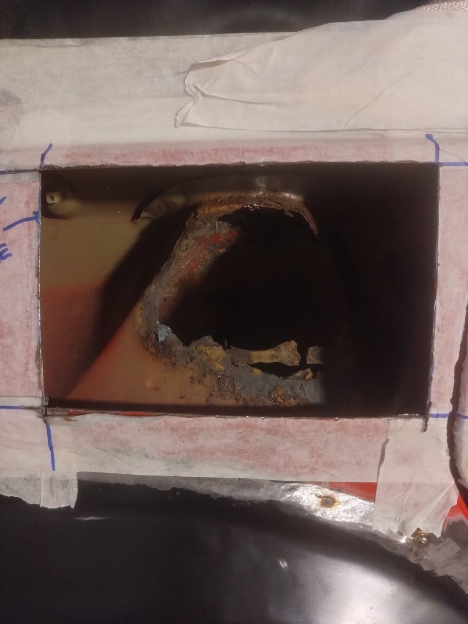

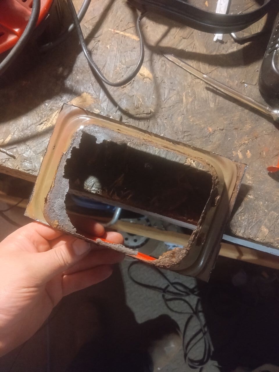

Marked it off and then plunged the slitting disc in. Here is what I discovered.
Welp. That went as expected.
Tomorrows job will be to make a start repairing either the inner quarter or the filler pocket.
Be daft to give up now anyway.
Ha! Another boot tae tha baws.

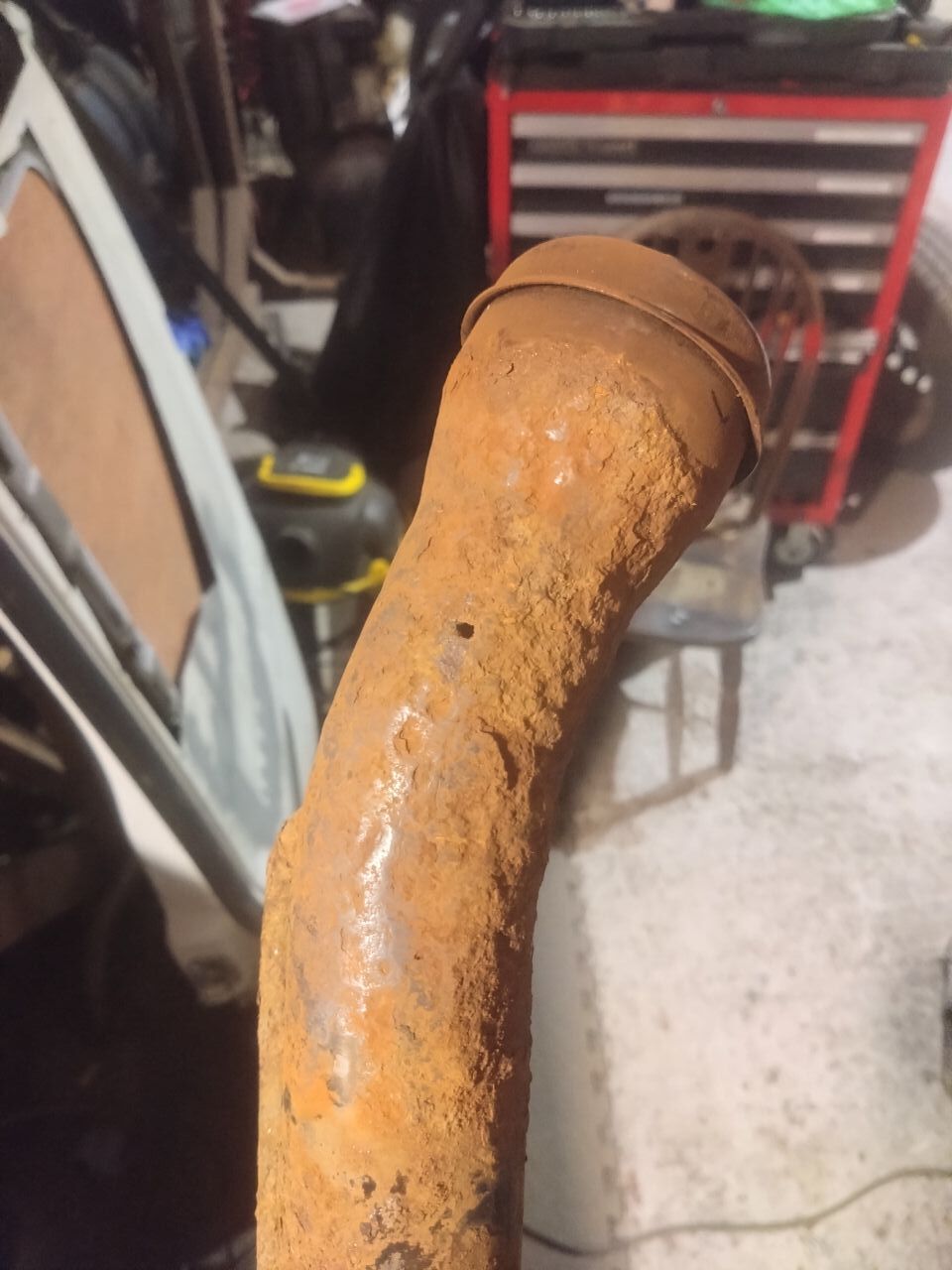

The actual filler neck is rotten too. Great! 🤣
Bollocks to this. I need a beer.

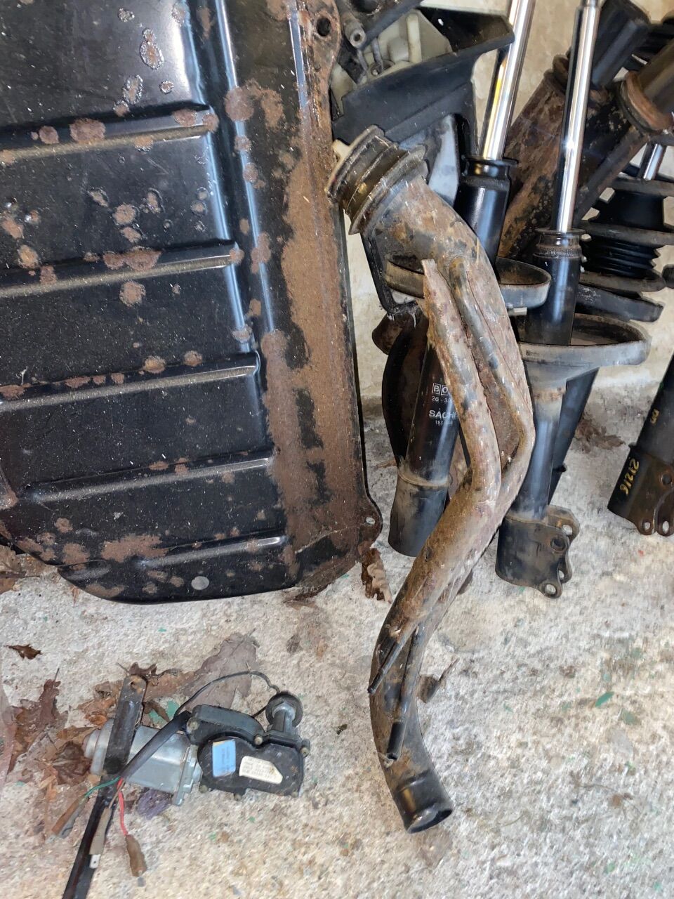

Excellent stuff as always 👍
Just wondering if a late diesel filler would be the same as yours?
Apologies for the crap pics, this one is available if you need it, along with the other maestro spares as seen behind/around
Thanks 🙂.
It's been very satisfying to rid the car of the grot and shite.
As for that filler neck. If it doesn't I'll make it fit!
Aye I'm interested. To how much would one like for it?
This place etc etc 👍
