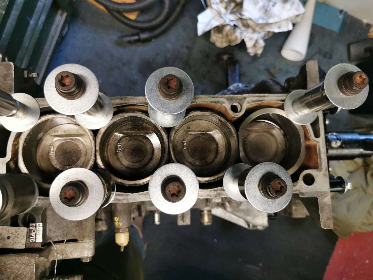

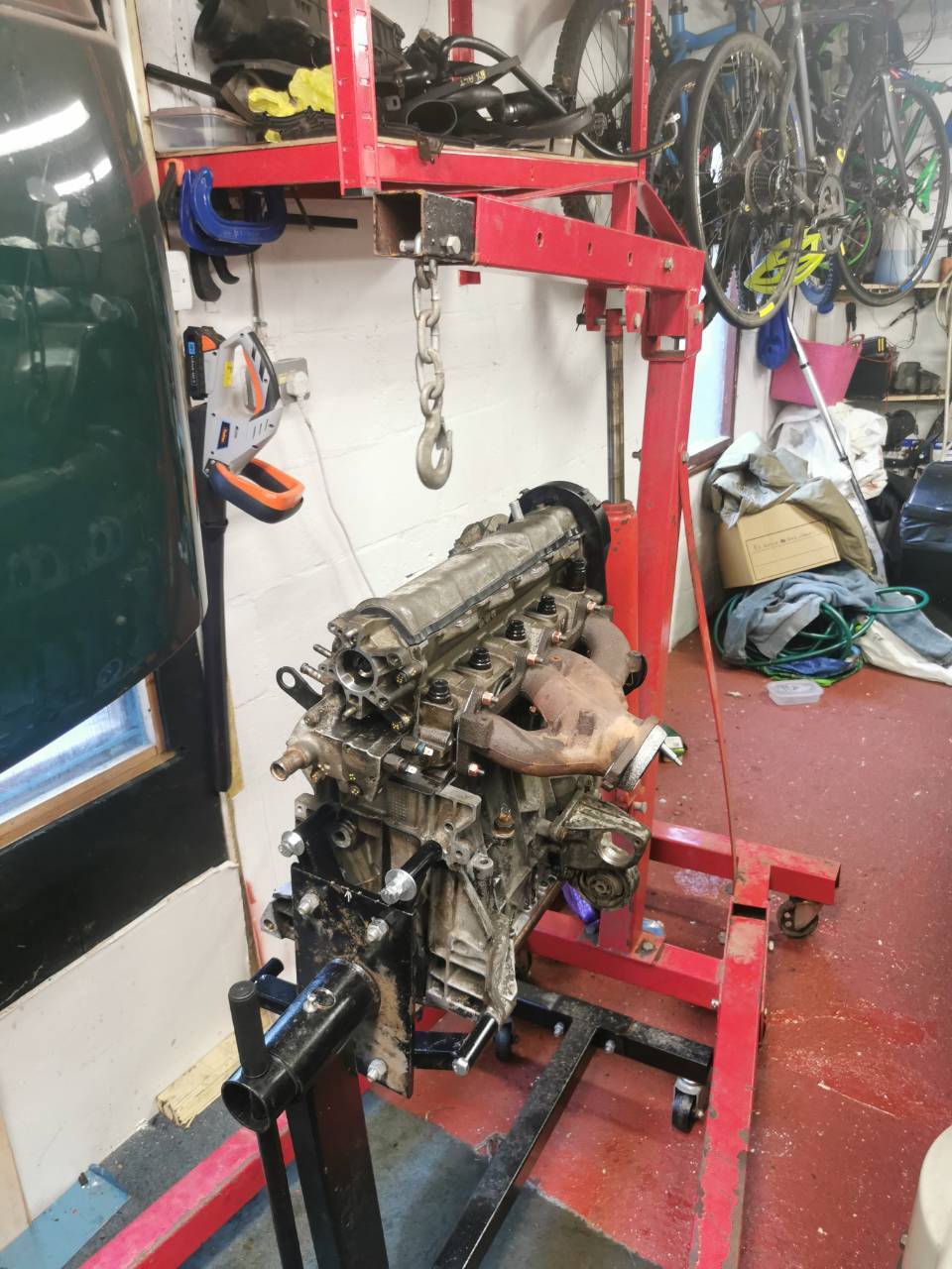

Final piston and liner went in with minimal dramas.
Then, the oil pump, chain and sprocket.

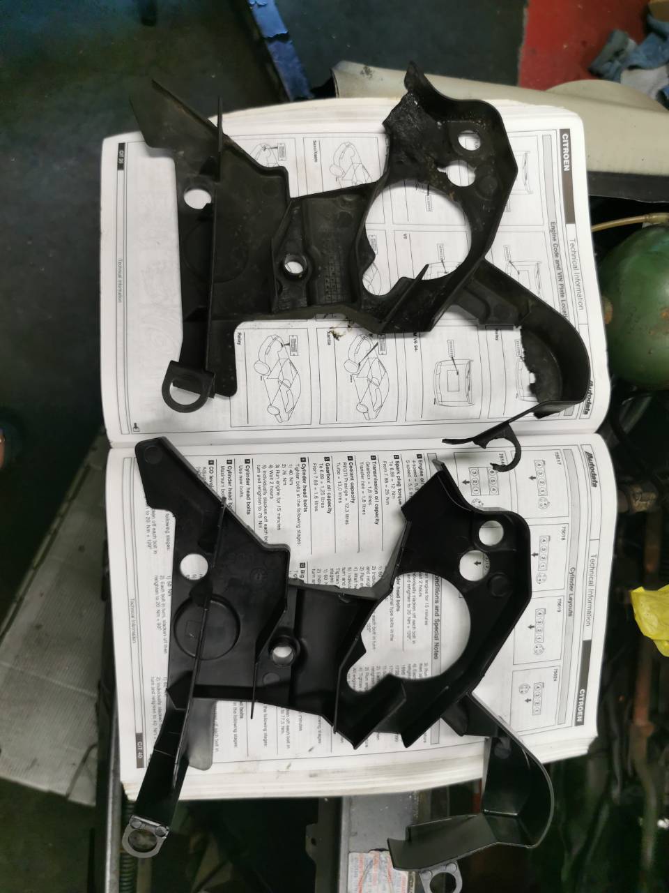

I finally test fitted the new middle timing belt cover, and discovered it needs a little bit of modification with a pair of snips and a file to fit nicely.
The front crank plate and seal were fitted, this got a smear of hylomar around the contact areas.
Marking the layout of the bolts on the way out made reassembly a LOT easier.
With everything done on the bottom end, the sump was refitted with a new gasket - the sump had a smear of grease applied to it to prevent the gasket sticking to it in future.
Next up, the cylinder liner clamps were removed
The new head gasket laid into place:
And the cylinder head lowered into place. This was the job I was dreading the most as it had the biggest potential to go wrong - was very glad I picked up a breaker bar this afternoon to help make this work a bit more bearable.
The threads were cleaned up following advice from Phill (cheers), who suggested grinding two slots in an old head bolt and running it through each bolt hole.
Mercifully, the torquing down went without incident, which was a massive relief - the helicoil did its job excellently!
Once I'd stopped sweating about that, I fitted the timing belt and gave it many revolutions to check it was all good 😁
Fitted the timing belt covers and engine mount.
And fitted the exhaust manifold - it's getting harder to rotate that engine in the stand now, it's bloody heavy!
And that's where I've left it for the night, very pleased with what's happened today and hopefully tomorrow will be equally productive!

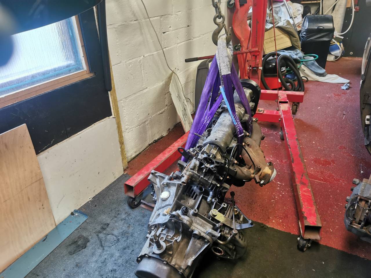

Started off okay, I set up the engine crane to get it off the stand.
Finally, it meant I could install the rear crank seal - this was the second attempt, as the first one went too far in - luckily I ordered 2!
Clutch and flywheel went on.
And the gearbox was fitted.
Then, MrsH was roped in to help me get the engine and box into the engine bay.
This turned out to be an absolute dick of a job, not helped by the area we had to move the crane around.
Eventually, we admitted defeat, and whipped off the gearbox and exhaust manifold in order to make it a much smaller package for lifting and manoeuvring.
With the engine bolted into the mounts, the gearbox went on after a bit of a fight, and the mounts tightened.
Annoyingly, I didn't notice I had looped the nylon lifting sling around one of the mounts - knowing how much agro it was to get the engine in position in the first place, I elected to cut it off and throw it in the bin.

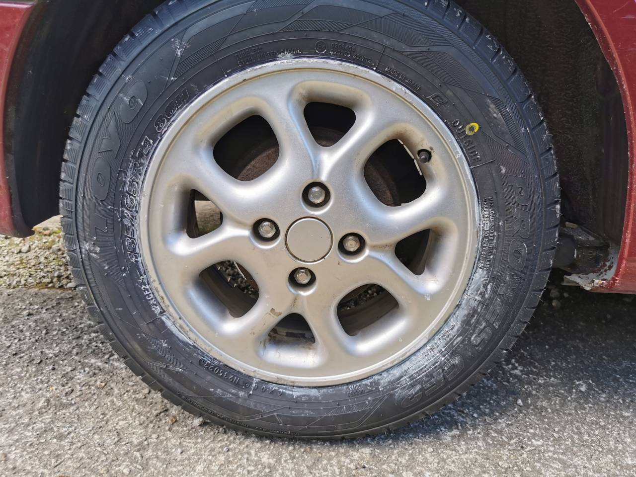

Demon Tweeks had a decent chunk off Toyota Proxes CF2, and with the front two on the Laguna being very low on tread, and showing sidewall damage on a rear one, it made sense to get all four done in one hit - the one remaining good tyre was fitted to the spare wheel to replace the 16 year old rock hard Michelin. Tyres cost about £170 delivered for all four which was a bargain.

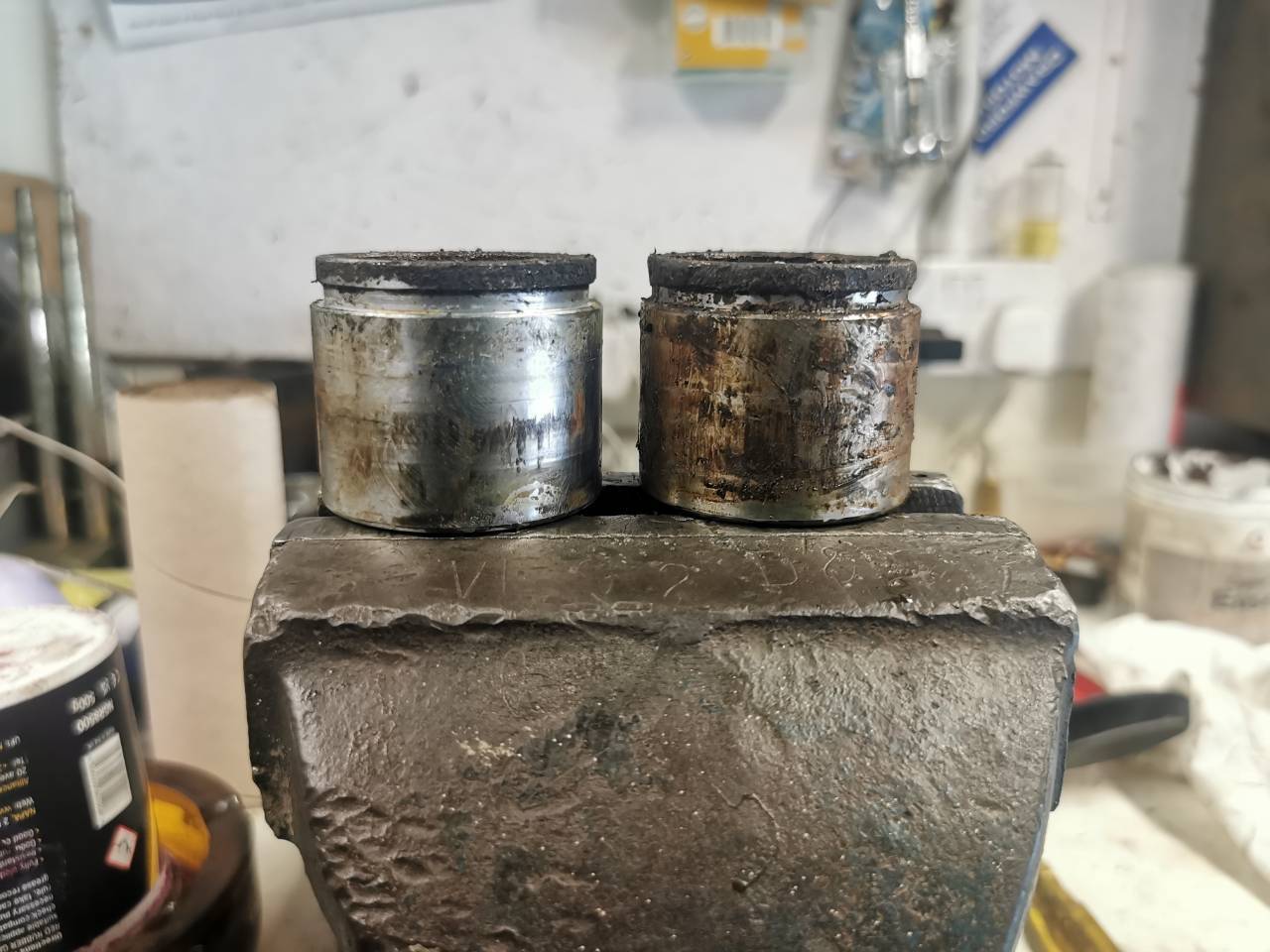

And got the caliper on the bench.
A new caliper refurb kit including pistons only cost £32 from Bigg Red. I absent-mindedly managed to catch myself when removing the pistons with compressed air
But that aside, it was really rather pleasant to put back together.
Got some new EBC Ultimax pads due to the massive difference in old pad thicknesses on each side, fitted and bled the caliper.
The other side was a bit grottier than the other - I think there's been some moisture in the system!
It all cleaned up lovely though and the caliper went back on nicely. The pads did need a bit of filing on the paint to allow it to move smoothly.
The old pistons - one cleaned up okay, the other was pitted.
Popped the cover back on and will arrange the retest for next week.

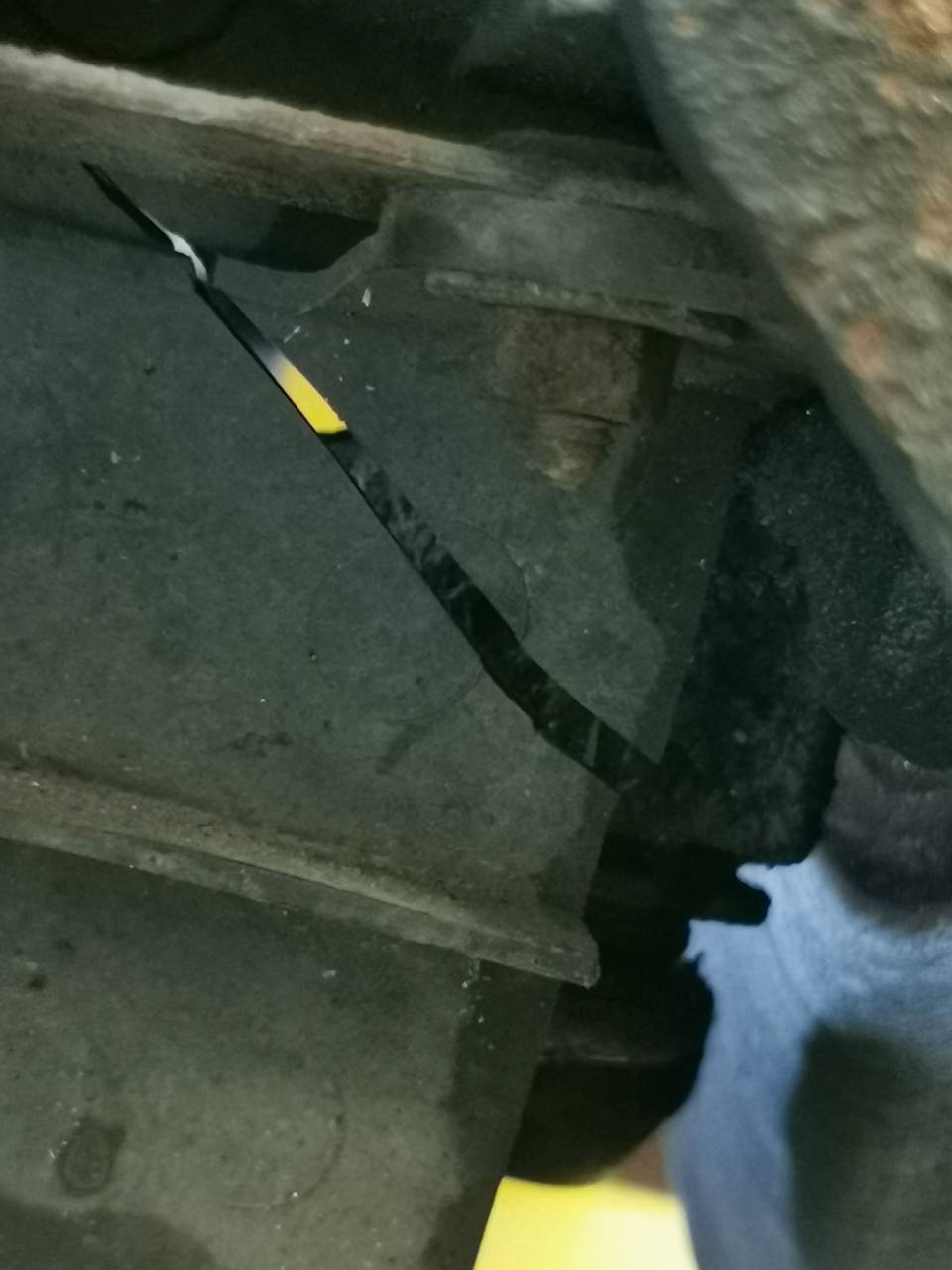

It didn't take me too long to figure out what went wrong with the clutch fork.
A tab had sheared off the clutch release bearing. I've refitted the box and put it back on the transmission mount as parts are going to be a bit of a pain to source, as this is a bearing for a 1988-1989 BX, despite the car being a 1992, fingers crossed the right one turns up!

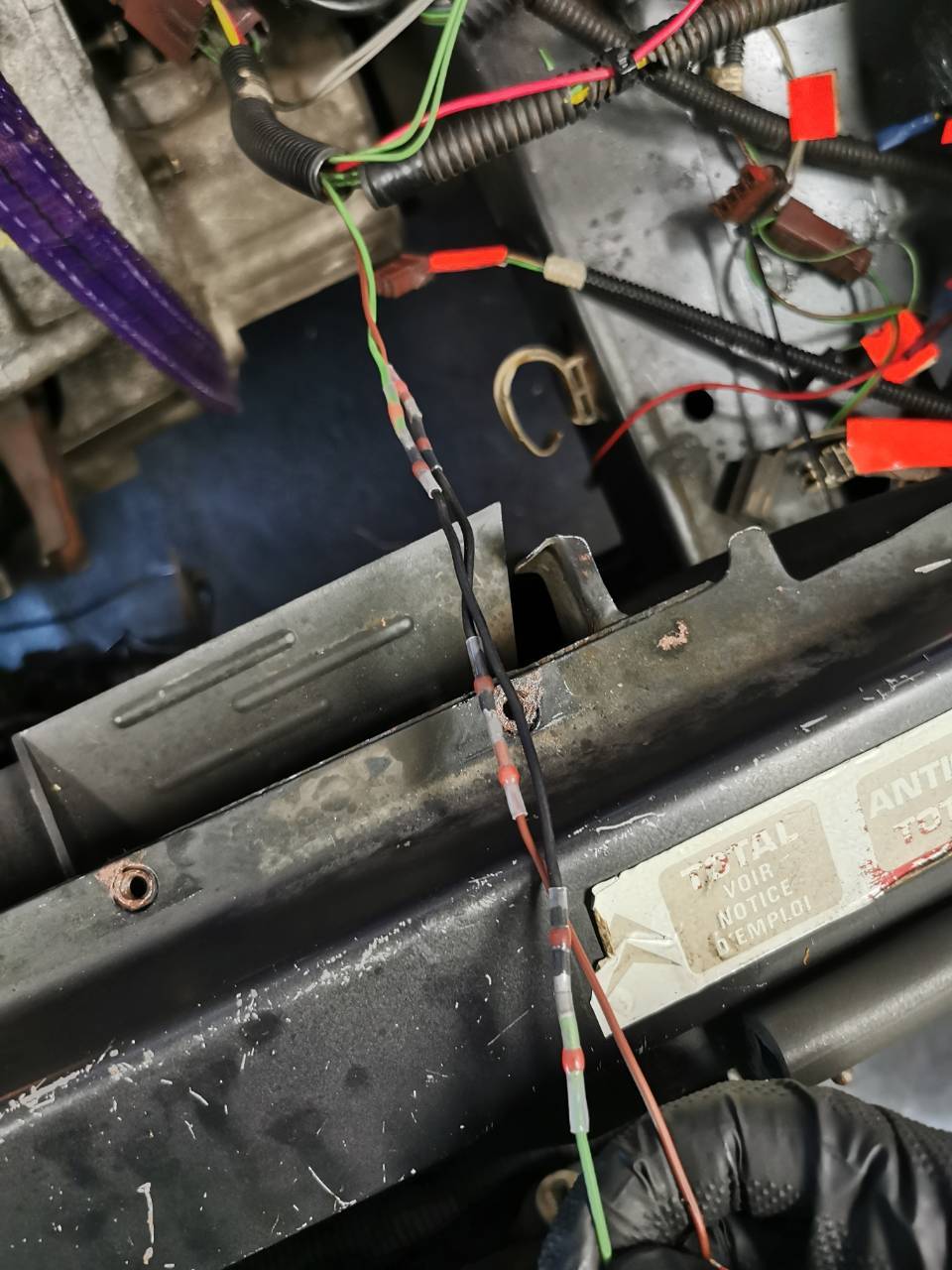

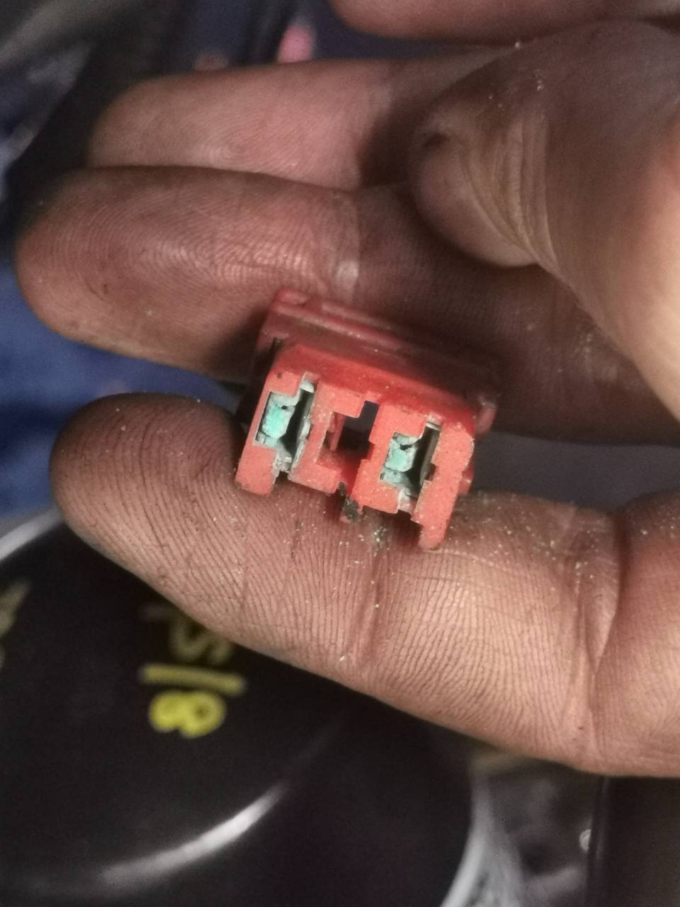

Whilst waiting for bits, I finally got around to repairing the coolant temperature warning light switch wires - these had been pinched in between the bellhousing and the engine when we got the car, so they had been getting crushed for at least five years.
Chopped the duff section out and solder sleeved replacement wire in.

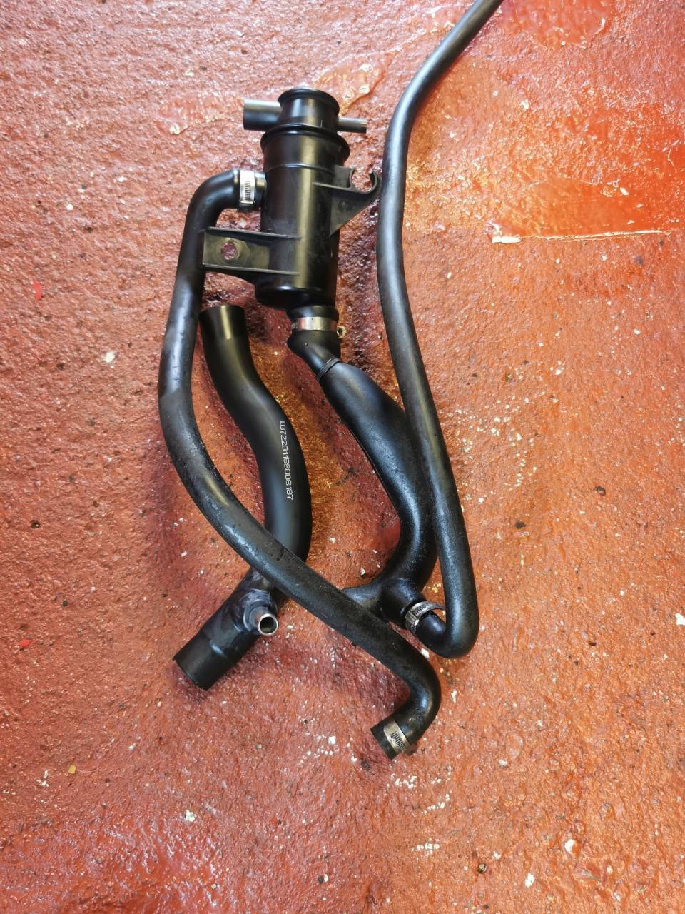

Replaced the oil filler pipe that connects to the bottom of the block - the old one had collapsed and tore apart with just my hands.
Didn't take any photos but there were several heavily perished coolant lines, so I replaced them with new sections of fuel line. Some of this had been previously bodged during the conversion to manual choke, such as this really rather fetching attempt at joining two sections of hose together:
Yep, that's an airline fitting, ground down. This was then shoved into the open pipe ends and clamped with jubilee clamps. Bodgy as hell, but it never showed any signs of damp or leaking, so it clearly worked.

A quick up and down on the suspension was promising, although the 'STOP' won't clear as the coolant level sensor was saying it was empty, even though it's full.
The connectors are filled with verdigris corrosions.
And the clean up was quite fiiddy.
I think these might be beyond saving, but I'll investigate further when I get more time.

Is it worth measuring the width and buying 100 sleeveless female crimps whilst you've got it de-pinned? You only a squeeze away from all new ones then.
Sterling work though!
Yeah, that'll probably be my next job.
