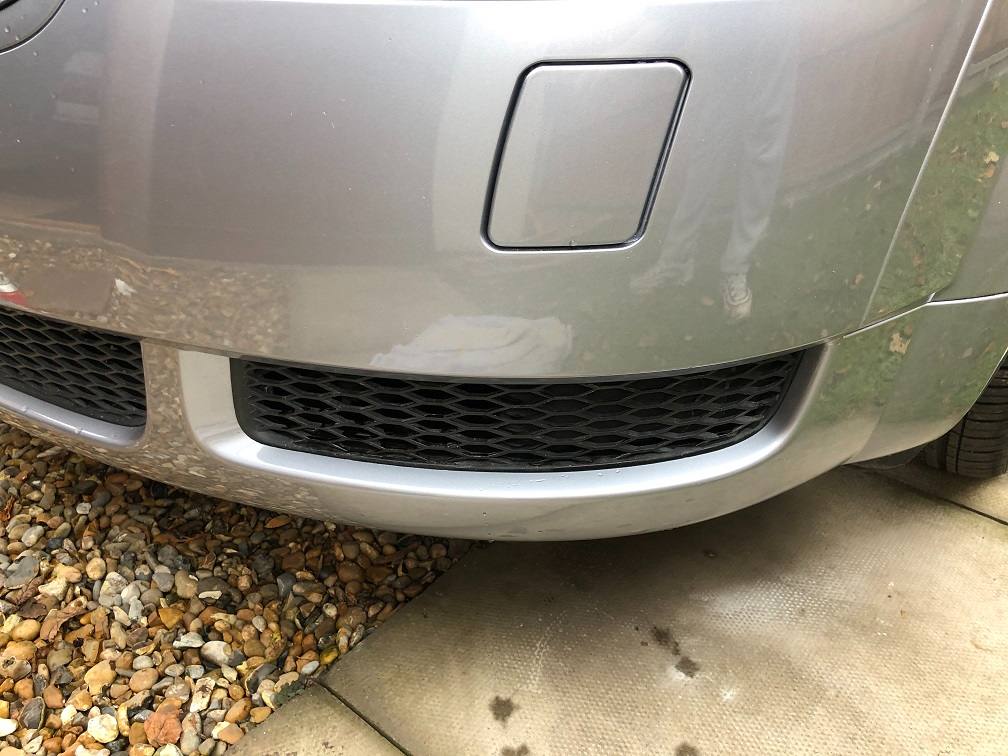

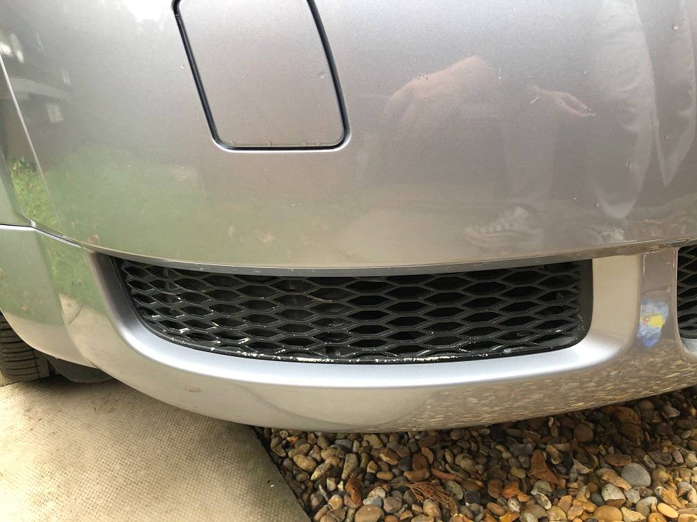

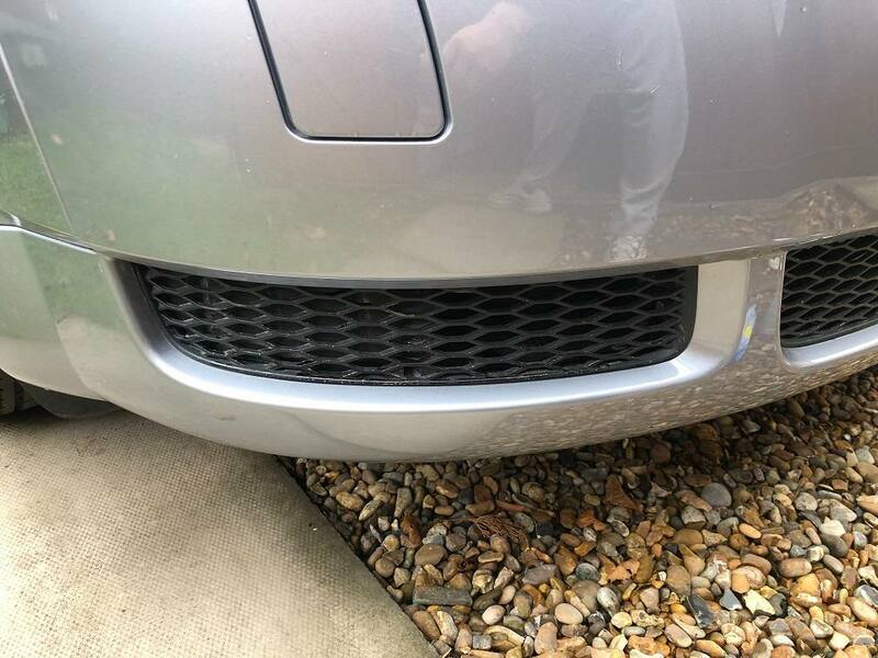

The black grilles located along the bottom of the front bumper were chipped and ideally need removing and respraying.
For now, I've just touched them up with black paint.

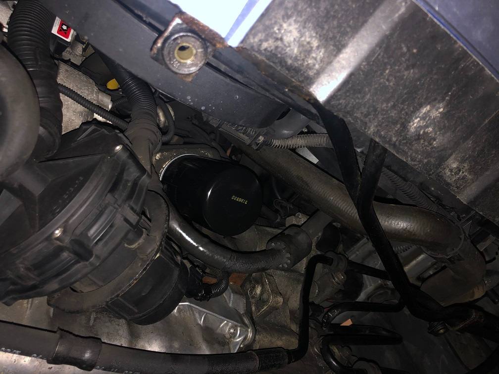

In between other weekend chores, I wanted to replace the engine oil on the TT today. How hard can it be? I got a Bosch filter and Shell oil from ECP, for a reasonable £46.
I started by taking the undertray off. Whilst it was dirty, there was no evidence of any significant oil staining. The underside of the engine also looked clean and dry. So far so good.
I removed the sump plug and allowed all the old engine oil to drain out. The oil filter is located to the front of the engine / behind the radiator. From the top, it is inaccessible. From the underside, it is visible but equally difficult to access. To make life easier, I removed a hefty bracing bar. To remove the bar, I had to dismantle some more plastic undertrays.
With access improved but far from ideal, I tried to remove the oil filter with my trusty old chain wrench. Having tried to twist the old filter off by attacking it from every possible angle, all I managed to do is deform it. The bloody thing wouldn't budge. I eventually gave up and popped over to my local ECP and bought a suitable removal tool.
With the correct tool to hand, the old filter came off in 10 seconds. Putting the new one back on was nice and easy. Well done ECP for supplying the correct part. It doesn't happen that often!

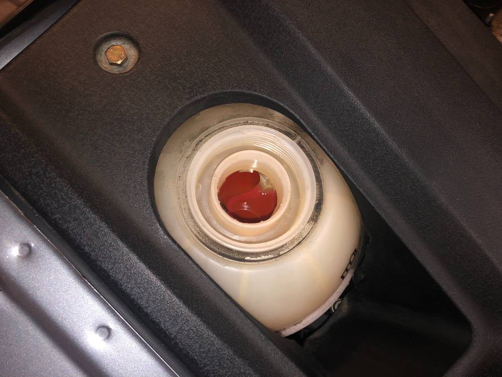

With the bonnet up, I checked the condition of the coolant (nice and pink, looks fresh) and there is no evidence of any leaks. Perhaps I've bought a good 'un? Shame that today's oil change had to take 4 hours.
