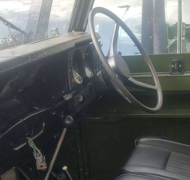

You can maybe make out in this photo a map light (not functional) on the underside of the dash, and a universal choke cable. The light is stopping the steering column cowl from seating correctly, and also stops me from fitting a choke cable in the usual place.
I've since fitted a Metro/Rover 100 cable, since it has an integral switch - and I had one spare!
This illuminates the original 'cold start' lamp, albeit in a different way than designed. Note I've added a couple of discreet USB sockets to fill the hole left by the old choke cable. An interior light was high on the list, which is now fitted and triggered both by the usual dash switch, and also decadently with a door switch.

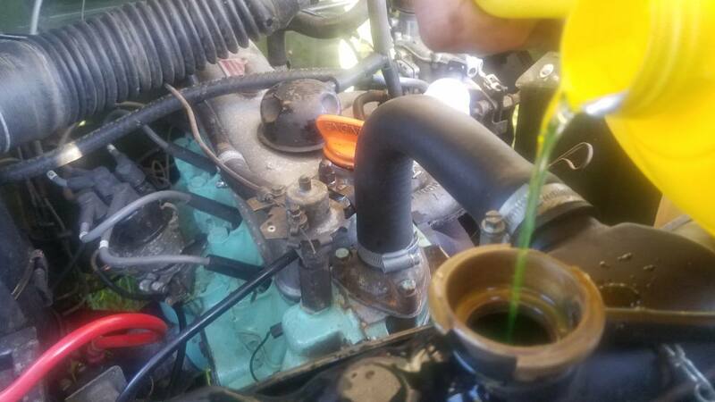

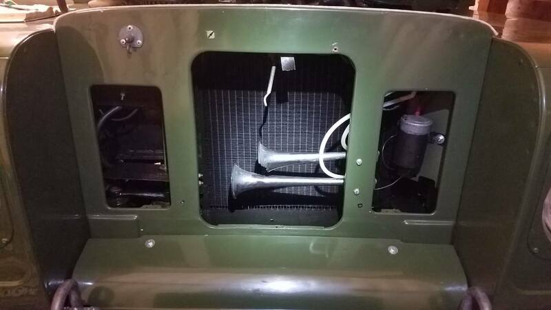

I bought an updated 4 row radiator from the single place I could find selling one, and fitted that this week.
It's so easy to work on! Apart from the bastard bonnet catch, which I keep banging my head on. It must be a LR thing, as the Discovery one is just as bad! I replaced this dodgy looking hose too, while the system was drained.
With that done, I flushed the system and filled with coolant.

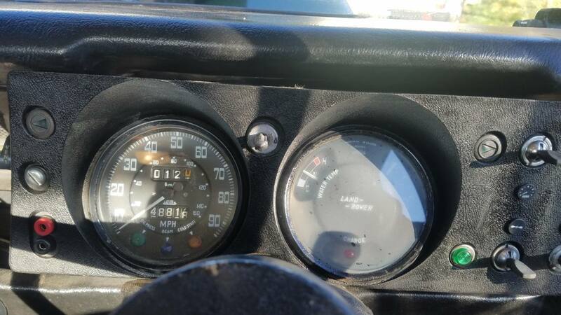

A test drive up some long hills, and I couldn't get the needle to budge from the N of normal, so I'll take that as a success!

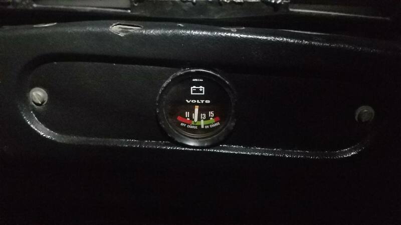

Last job was to install a second-hand voltmeter in the hole already cut in the dash - the first photo shows a non-functioning hazard switch hanging out of it.
Unfortunately I've swapped one useless item for another, as this doesn't work either! Oh well, it fills the hole and does at least light up :-)

Minor, enjoyable tinkering to be done. I've found a working voltmeter, so installed that.

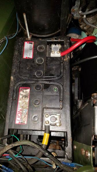

Replaced the battery clamps, which were a little too small.

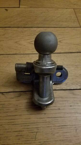

And made a start on tidying up a tow hitch. I've dipped it to remove and corrosion.
So the next job is to zinc plate it. My last attempt gave rather a dull finish, which is likely down to the current setting being too high. This being a bigger surface area should be hopefully less sensitive and fingers crossed will look better.
