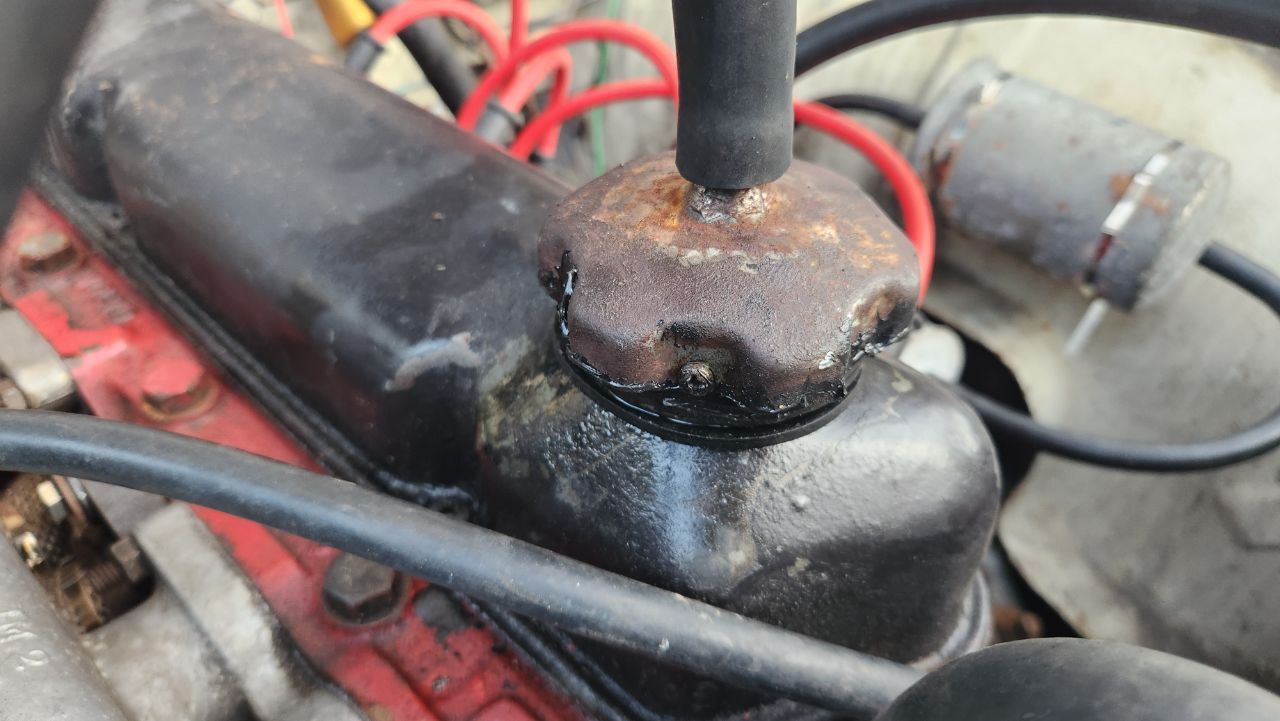

Had to top up the dashpots with ATF as it wanted to stall when floored.

I've had trouble with the dash pots overflowing after using nitrophyl floats. Put the originals back and all good. Could that be the source of the fuel smell?
ATF? Mebbe a bit thin?

I'm using richer needles, I felt that anything thicker created a rich spike and it bogged down.
The throttle response is instant which suggests it's close enough.

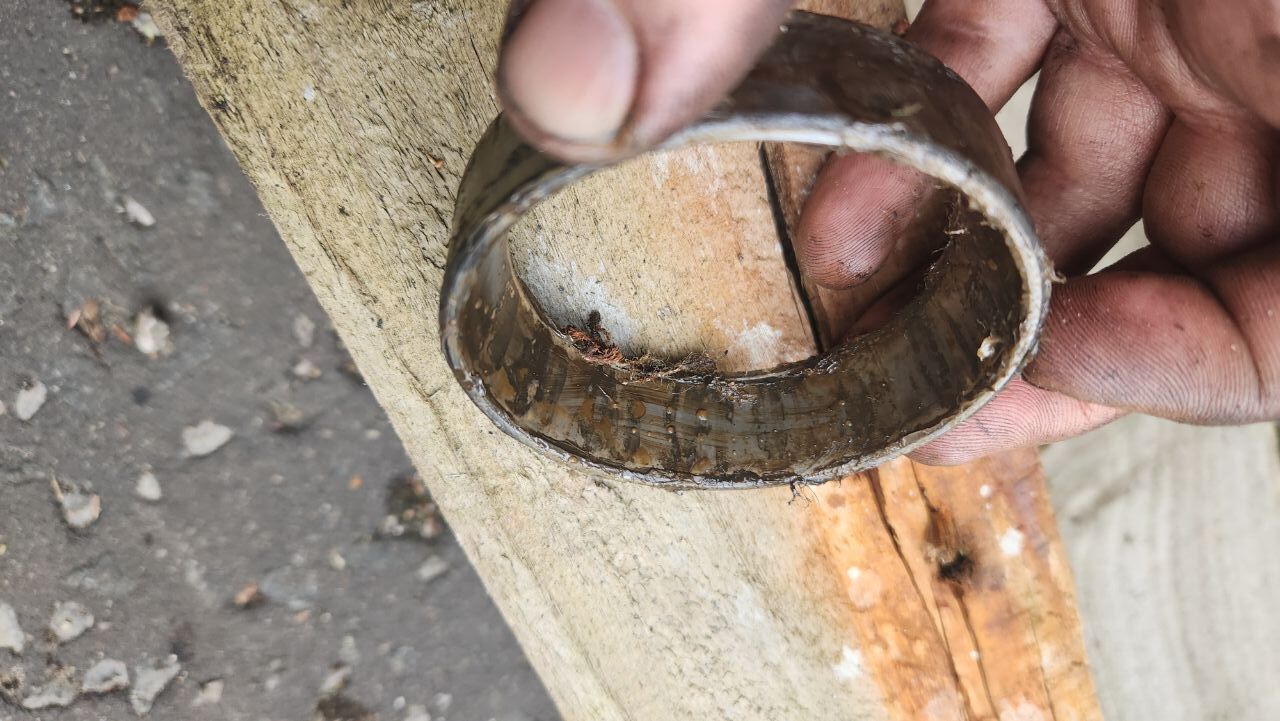

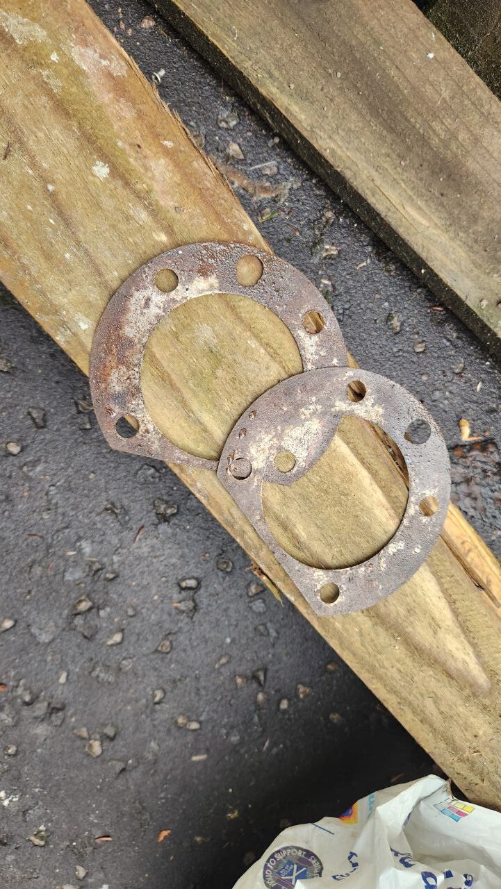

The scraping noise turned out to be a wheel bearing.
Turns out the brand new seal I fitted in autumn last year has already failed and let water pool in the bearing.
While I was in there I noticed the new wheel cylinder is leaking fluid as well.

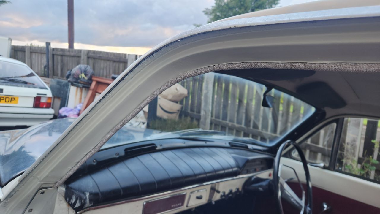

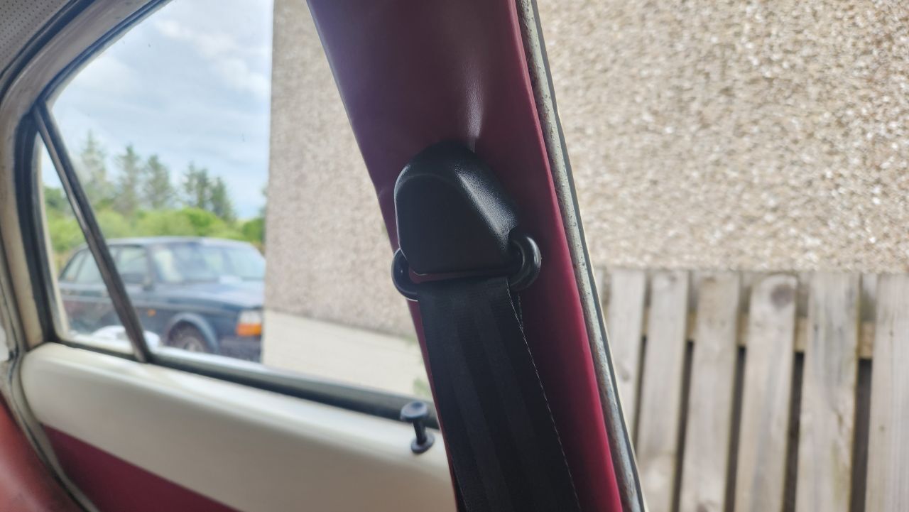

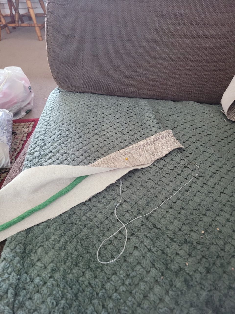

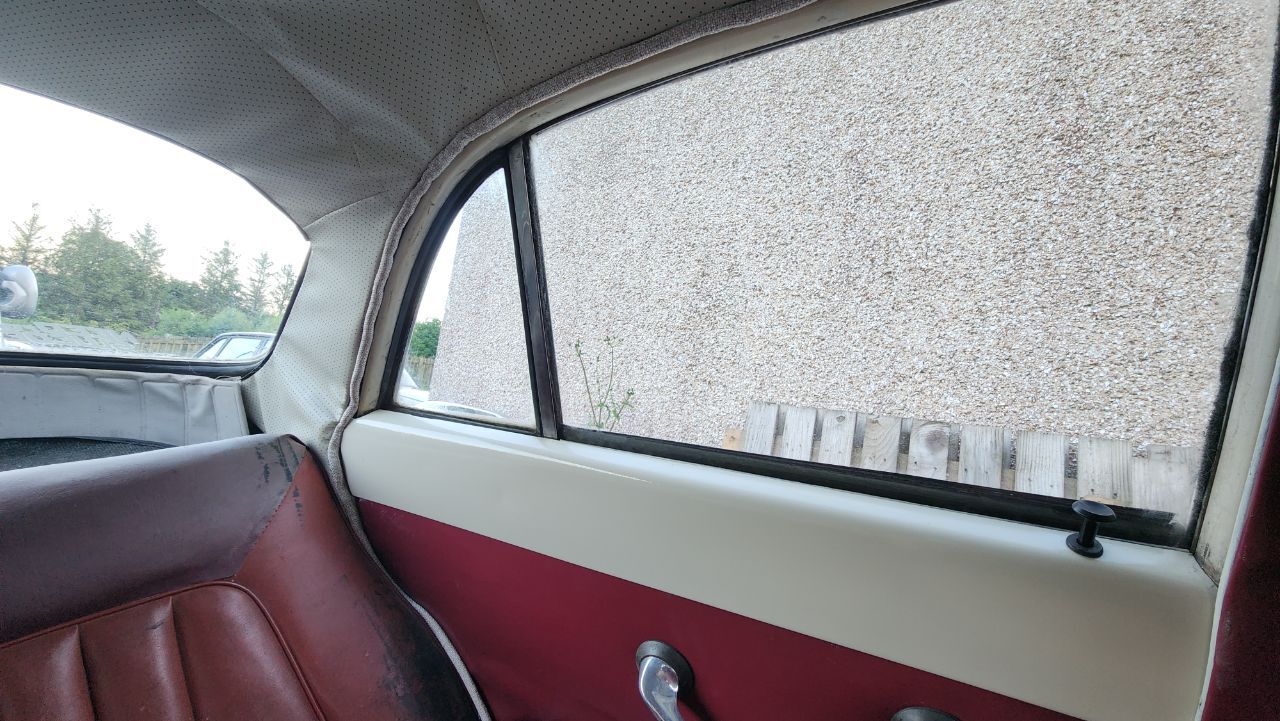

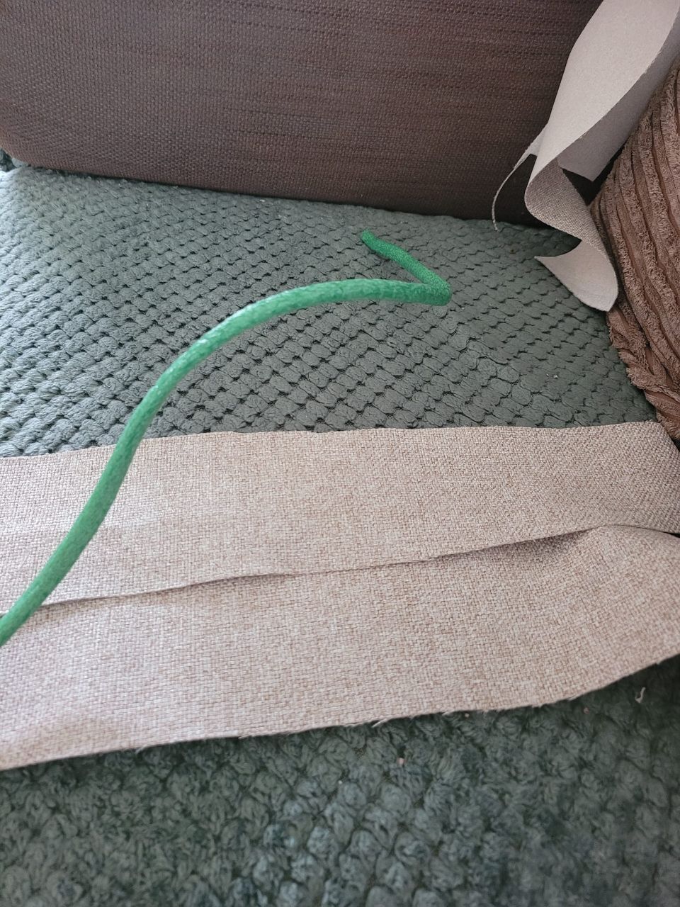

@MrsJuular finished one side of the windlace and it looks amazing.
One of those things that really makes a difference to the feel of the interior being complete.
It's made from foam garden tie and a short length of upholstery fabric. Total cost for both sides is about £10.
I don't think there's anything lacking from that in comparison to the £200 off the shelf trim.

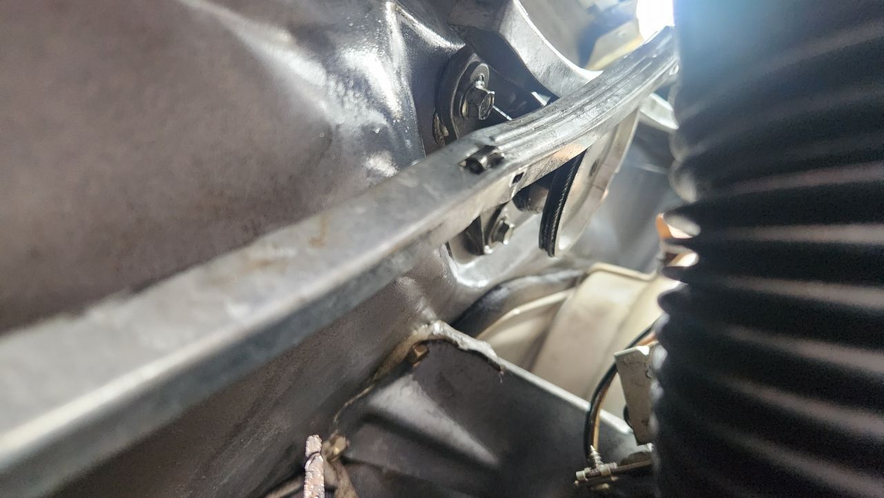

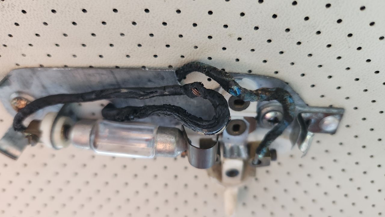

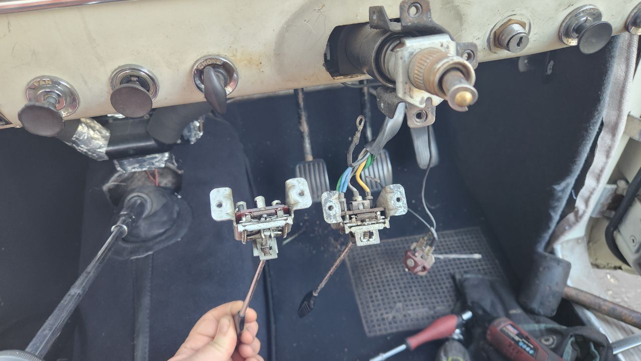

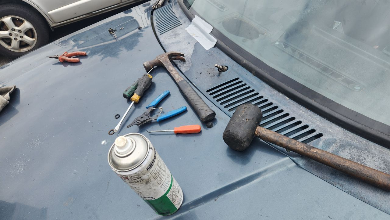

Last week I noticed the wipers were getting slower and creaking from the linkages.
The left spindle that goes up through the bulkhead is seized to the point it's blowing fuses.
I tried to remove the assembly from behind the dash. It's an absolute pig of a job.
Sadly after unbolting it the aluminium plate crumbled to pieces and the wiper spindle was still jammed solid.  I even put it in the hydraulic press to see if it would come out, and that couldn't shift it either.
It needs a new spindle but they seem to be no longer available except for LHD cars.
Not sure how to sort that one.
Is there any chance that the LHD part can be adapted to fit RHD?
Surely the obvious answer for someone of your skills is to convert the whole car to LHD, and move to a drier country?
The 144 in the Bellshill breakers still had its wiper arms. I've no idea if the linkage/motor was present, or if any bits are 240 compatible though. They could also be burnt beyond repair...

Unfortunately the 140 linkages are more like the Amazon design - in other words sensible, reliable and more like industry standard.
Whoever designed the 240s linkages was high the entire time.

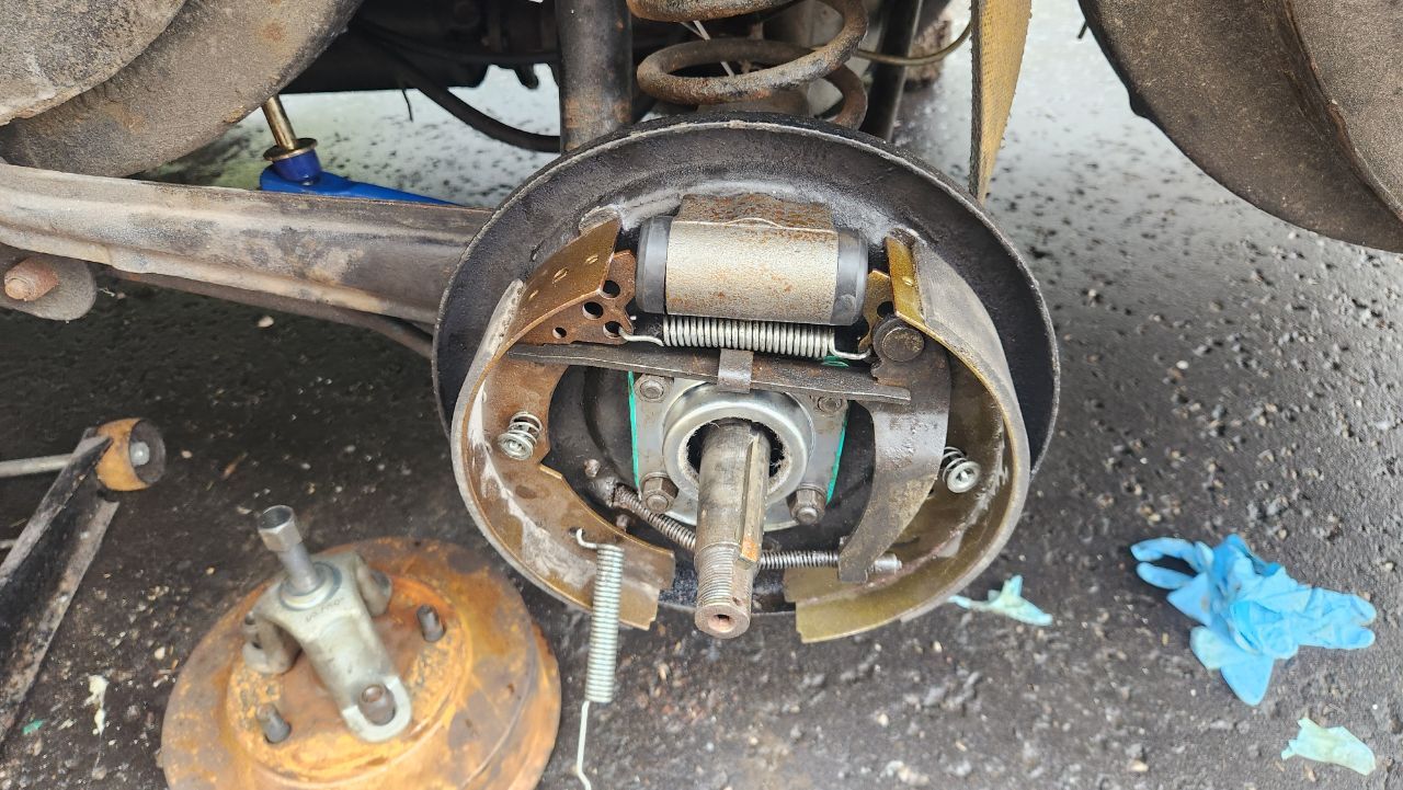

The stuff to do the wheel bearing and brake cylinder arrived, and I got to this point having started to put everything back together.

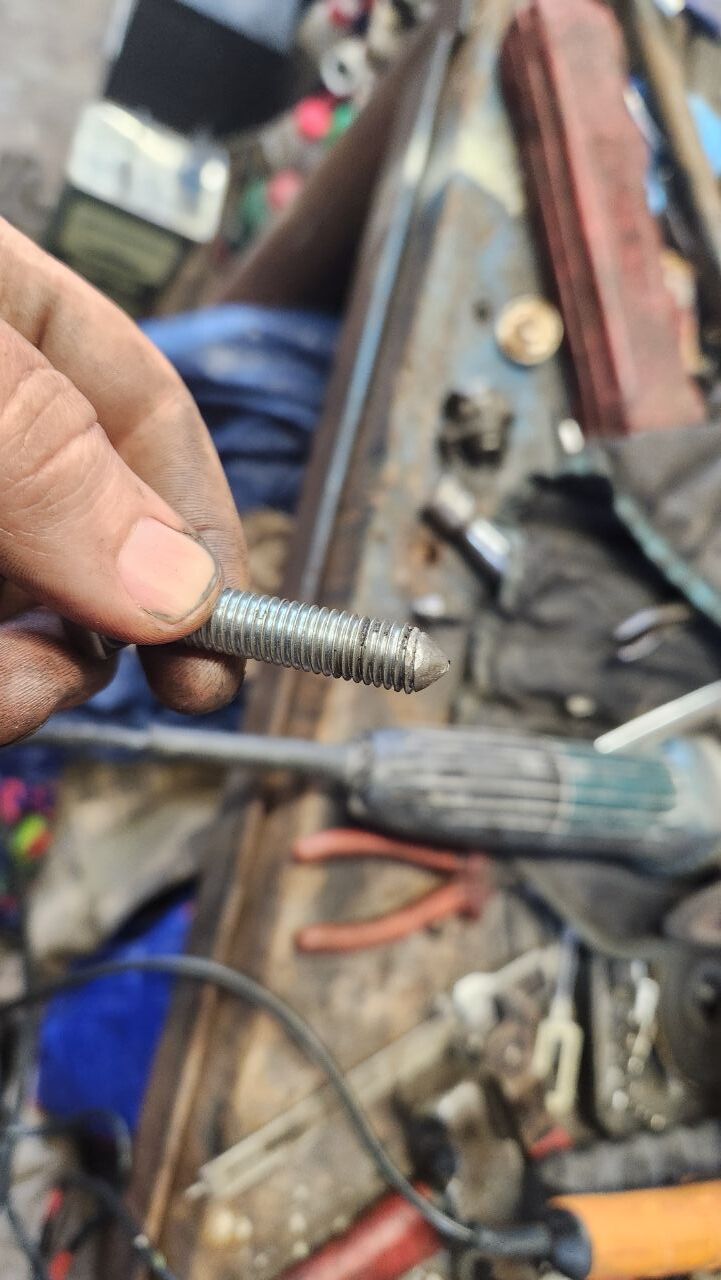

Then my heart sank as I went to install the brake adjuster and the adjustment screw simply fell out.  The threads had stripped clean off.
These aren't difficult to get but it did mean waiting another 4 days for parts.
Sitting there in the pissing rain with tools strewn everywhere and covered in oil and bruises, I had a bit of a moment.
At this point I am not afraid to admit I had a bit of a tantrum, threw all the tools in the garage and went in to drink gin.
The next morning I woke up with an idea.

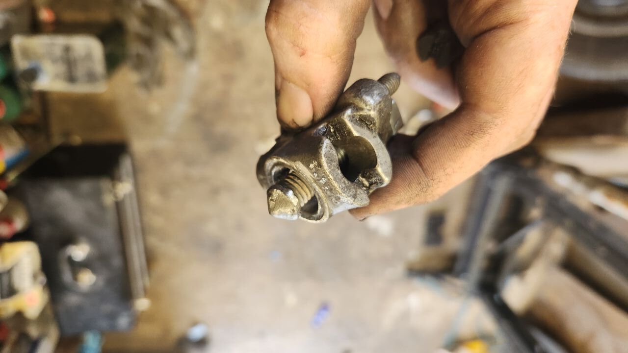

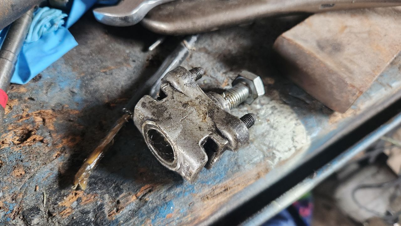

This is the brake adjuster.
This is how it works.  The screw pushes the cone in, which pushes the other two parts out against the brake shoes. You screw it in to adjust the shoes up to the drum.
I threw the screw / cone away and set about making some kind of replacement.
Firstly, the housing got tapped out to an M10 thread.
I then filed an M10 bolt into a conical shape.
I thought this would work, but it's not chunky enough to give much adjustment range.
I decided to build the size of the head up with weld.
Then file that down into a cone shape.
This worked better than expected. Not only does it replace the stupid square drive screw with a nice chunky 17mm head, it has just enough adjustment range to deal with the brake wear you'd normally expect.

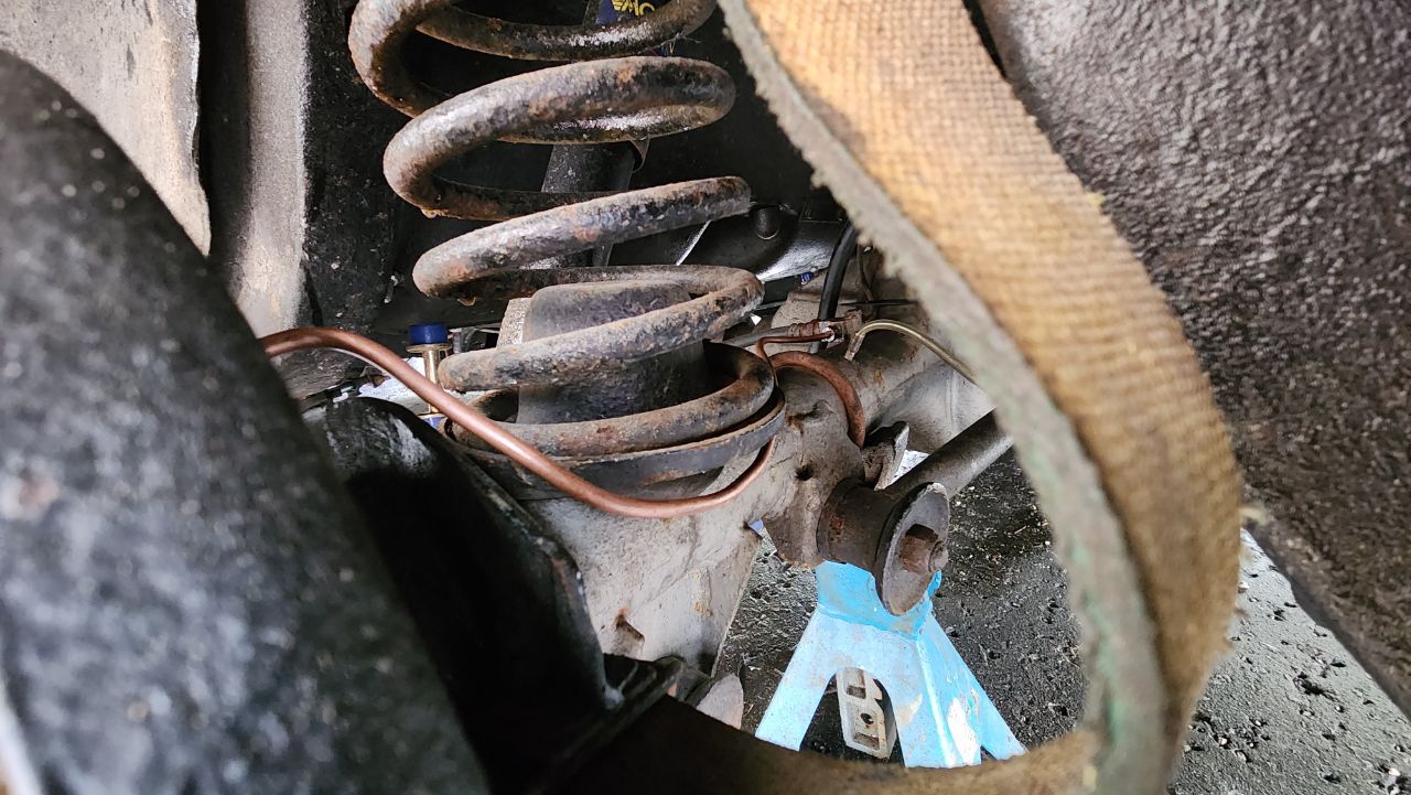

Doing the bearings, I had to work the brake line a lot to get the brake backplate off and I felt I'd started to work harden it. For the sake of ten minutes I'd rather not lose my brakes.
It was just a short bit, so I replaced it.

Is the option there to replace the 240s wiper mechanism with something completely different?
I was contemplating upgrading the Mantas wipers and it just so happens the distance between the spindles is the same as my Kangoos🤔
It's an idea worth exploring. The 240s wiper mechanism is a bit of a liability as almost none of it is still available in RHD form. I'm already using a wiper motor from another car hacked to fit.

Volvo themselves must’ve decided the 240 wiper mechanism wasn’t great as it was completely different for the 740, much simpler.
There must be used replacements around from the banger racers considering how many get raced these days?

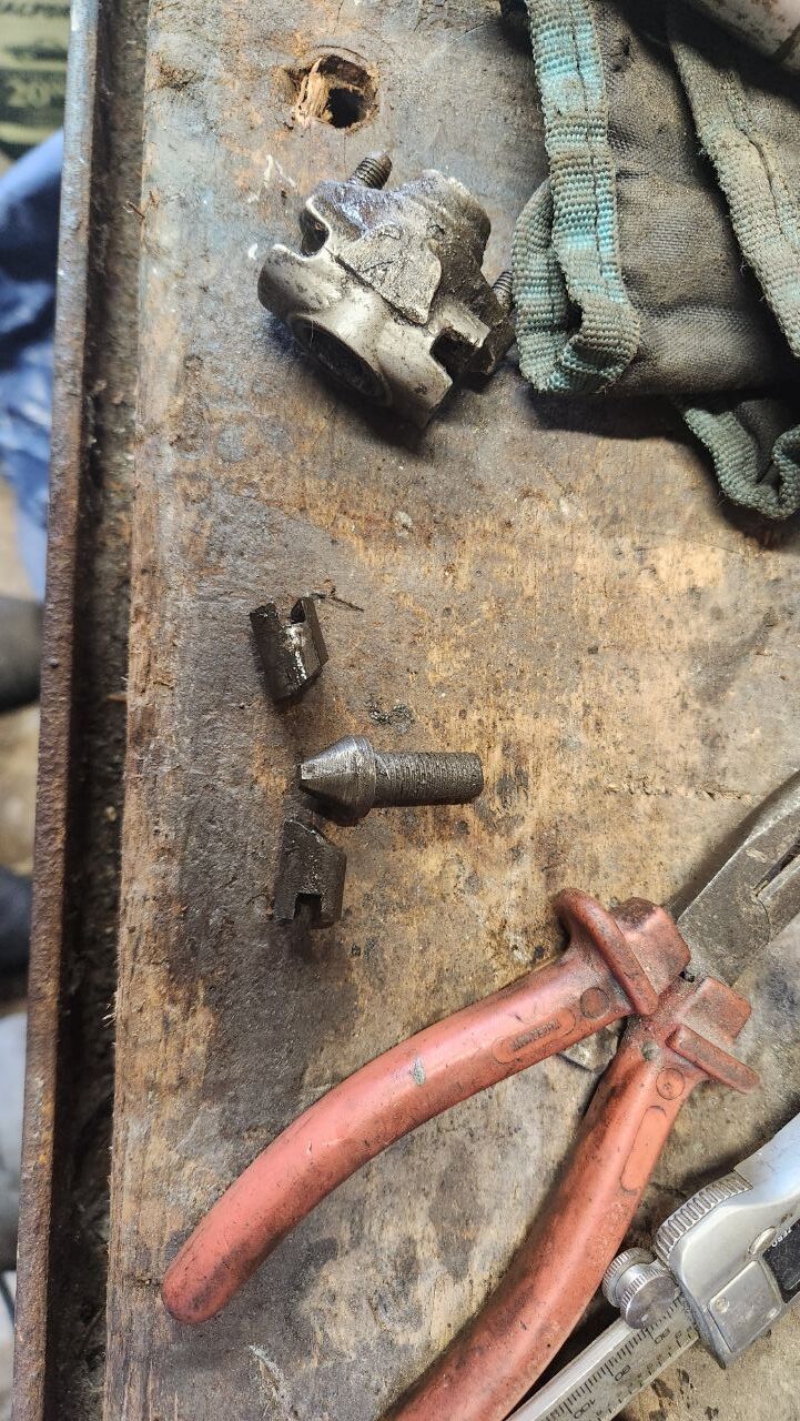

One of the nicest things about working on older Ladas was the rear brake adjusters, with a nice solid 17mm hex head instead of a flimsy square that rounds off for almost nothing. A useful upgrade.

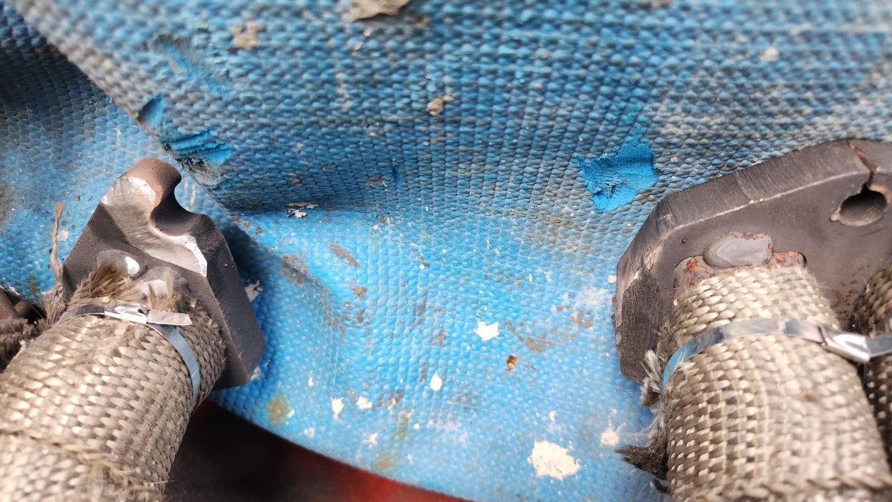

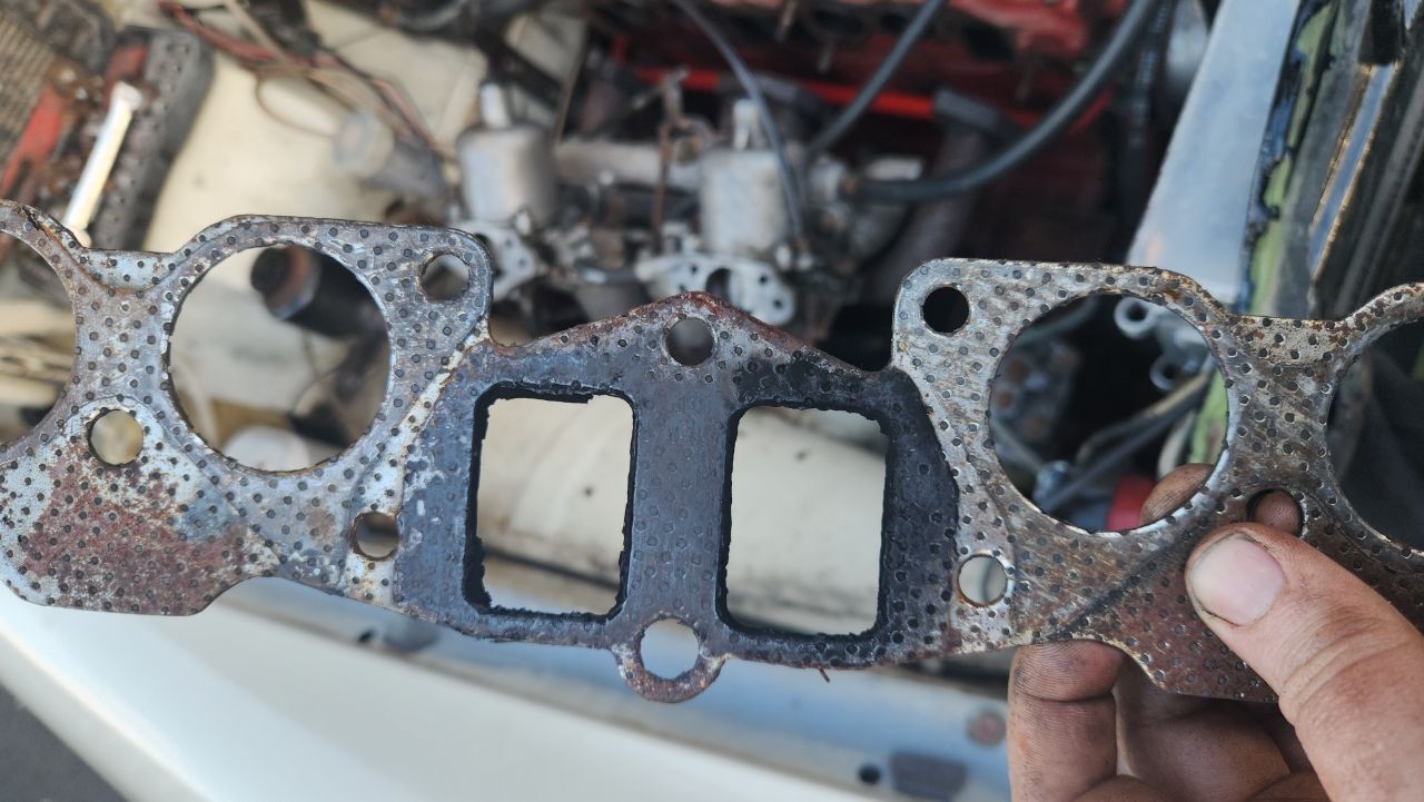

Must've had a premonition or something as a manifold gasket plopped through the door on Saturday.  I'd ordered a 240 one last week and tagged an Amazon one on the order just because.
Clear to see the leak from the middle.

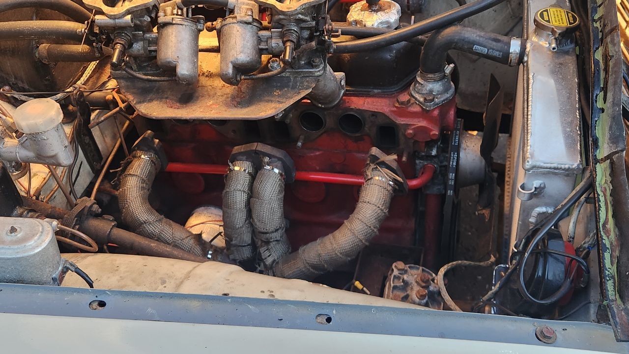

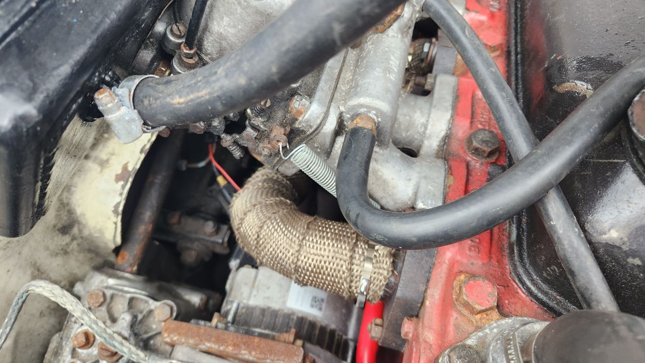

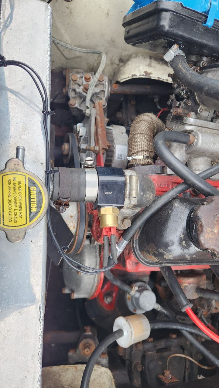

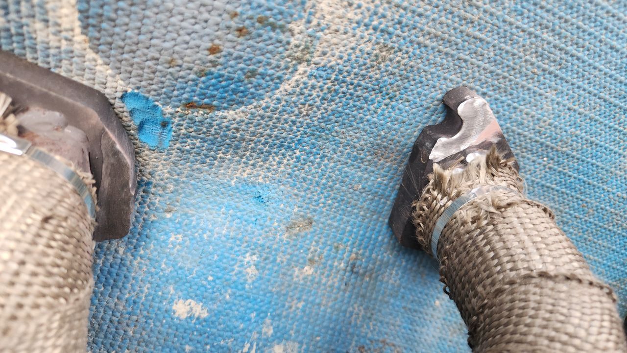

Upgrade to rayscaur with some exhaust wrap.
This is mainly to protect the alternator which is very close to the exhaust, and to try and prevent the float bowls getting too hot.
I think I found why the gasket was leaking in the first place.  The upgraded 4 branch manifold's flange is about 1mm thicker than the intake manifold and so neither were being clamped properly.
I set about sorting that with a power file and vernier caliper.
In the process I knocked the heater pipe which started pissing water from the daft seal that goes into the water pump. A smack with a rubber mallet and tightening of the bolt seems to have sorted it.

Last year I modified the oil cap by welding a tube on top and closing off the vented areas with foil tape, redirecting any oil vapor into the air filter.
The foil tape was a temporary thing to see if it worked but that temporary has now caught up and the foil has started to gain a few holes, so some blowby is definitely getting out.
So I've now plugged the cap vents with some polyurethane sealant.
The cap is packed with a dense mesh so there shouldn't be any way of loose sealant getting into the valve cover.
I've also given the bulkhead seals and bonnet seal a good going over, gluing and repairing bits where necessary.
The bit where the steering column goes through the bulkhead is always a problem. The bit of foam I glued here keeps coming off, so it's time to stop asking nicely and screw a new bit of foam on.
I also gave the exhaust manifold a nip up and wrapped a couple of joins further back with foil tape just to see if it made any difference.

I knocked the noise killer insert out of the back box a couple of months ago and this has proved it wasn't exhaust drone.  The exhaust is actually quite nice sounding now as well.

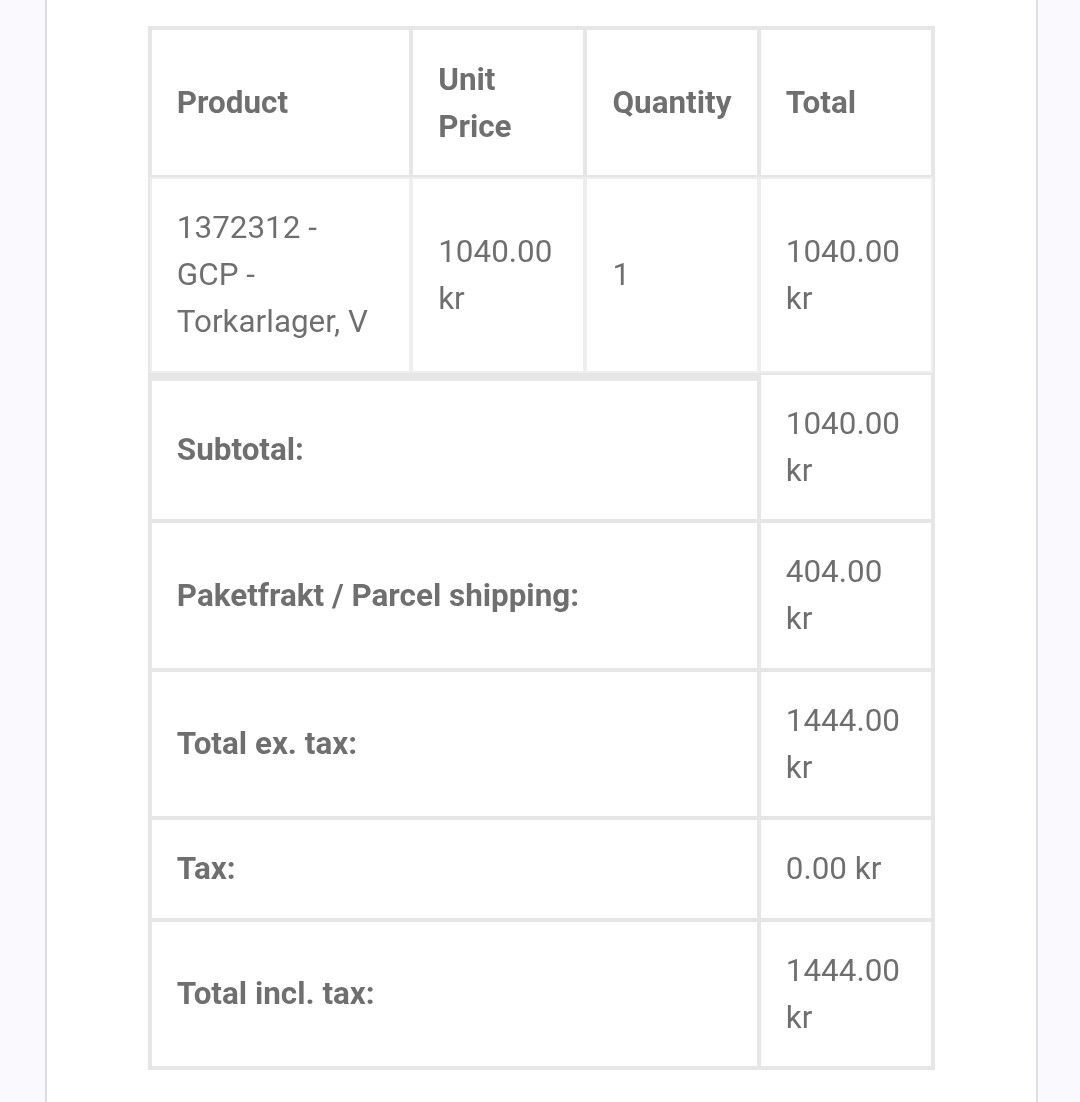

In other news I have a plan to fix the 240. A RHD wiper spindle was sourced from Sweden.
Those are big numbers but it translates into about 112 King Chuck Tokens which isn't bad.  Will just have to see what bill customs send me.

Pottering about in Swedish scrap Vol. #892.
A number of ups and downs in this episode.
Finally fitted the replacement indicator switch that was donated by @captain_70s
Was getting a bit annoyed at having to hold the right indicator on while going round roundabouts. Apparently TADTS and the usual fix is just to buy another switch. However amongst the three donated switches one was perfect.
Hard to explain the deep joy of being able to make right turns again.

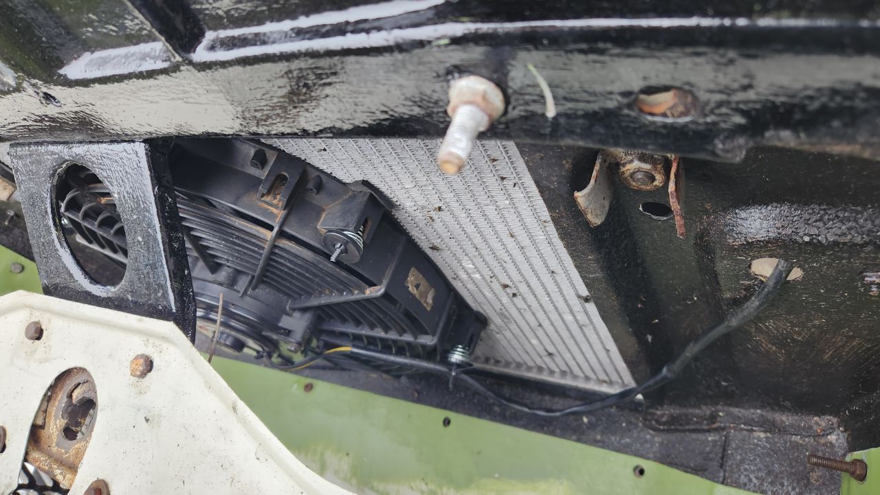

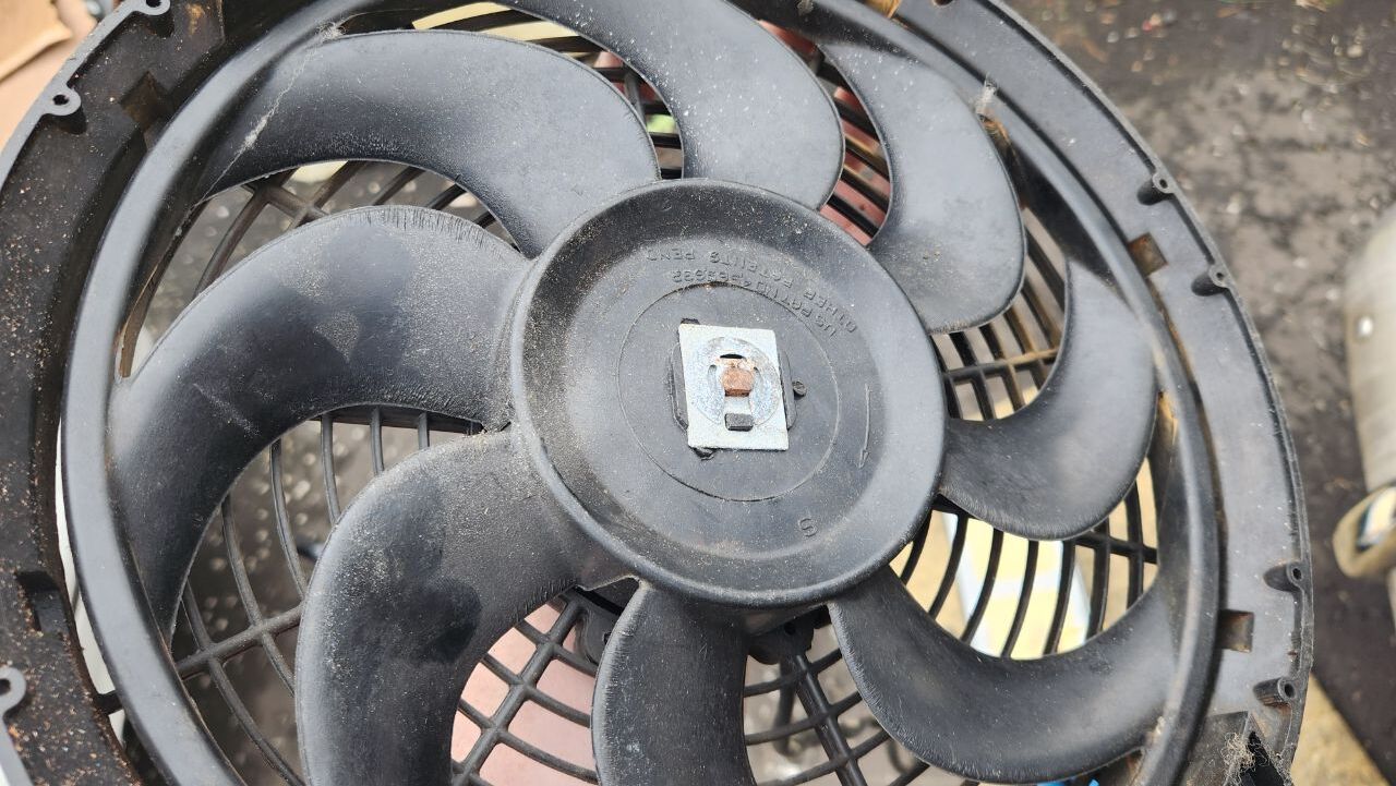

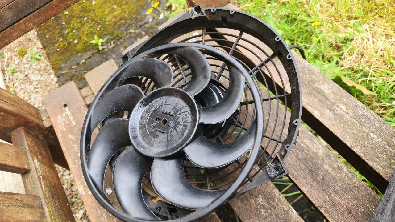

Next donated item was a Kenlowe fan from @MrsJuular which was a leftover from upgrading her Toledo's radiator to a Dolomite Sprint version.
I decided this was a worthwhile upgrade given the weather we're starting to get.
Only issue is this was a puller fan and I needed a pusher, as there's no room next to the water pump.
That's thankfully simple enough to convert by pulling off the clips.
Yanking off the blades (eventually!)
Then flipping them and reinstalling the clip.
On it goes. I'm sceptical of using the ties through the fan method so this may be upgraded at some point.

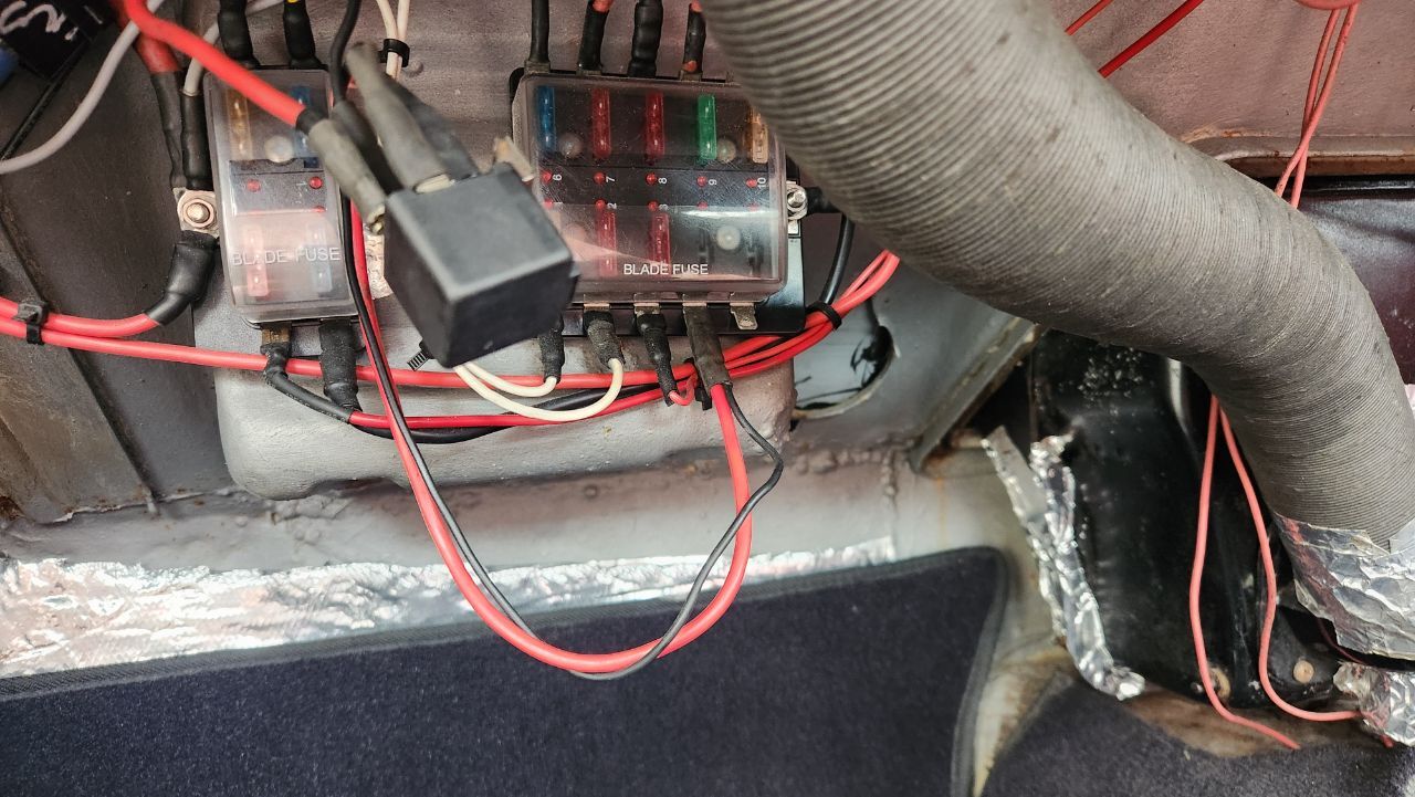

Then a temperature switch added to the top hose.
Then a relay and wiring added to a new fuse position.
Deliberately added an oversized cable to the loom, so that I can run a double fan setup in the future if I want.
Well, it sort of works. I've added a bypass switch so I can run the fan in an overheat emergency. I've also shorted the temp switch to test the system and it's all good.
However, it has never actually kicked in by itself.
There's a number of reasons, the first being that these engines don't have a huge problem with overheating even in traffic and the weather predictably cooled off a lot after I fitted the fan.
The other is that the aftermarket Aluminium radiator seems to be doing a cracking job of shedding heat.
The switch is a 95C on, 85C off and I'm running a 91C thermostat.
Almost tempted to ditch the fixed engine fan and see how it goes. Might get what, a couple of horsepower out of it?
Anyway, another small malady occurred when I installed the wiring in that I noticed the fuse for the internal light had blown.
Oh.
That got isolated pretty sharpish. A problem for the future as it needs new cables run up the A pillar.
Another minor catastrophe in that I was driving along, heard a pop and then the engine wanted to idle at 2000rpm.
Pulled over and confirmed my suspicions that one of the throttle return springs had buggered off.
An attempt was made to buy springs of some description from a shop while we were out. Turns out actually buying small parts like this in real life is basically impossible and even places like B&Q and screwfix are order-in only.
Anyway a solution has been knocked together for the moment - these are the springs that hold water bottles onto cages for small pets.
So there you go, best place to fix your 1960s car is Pets At Home.
