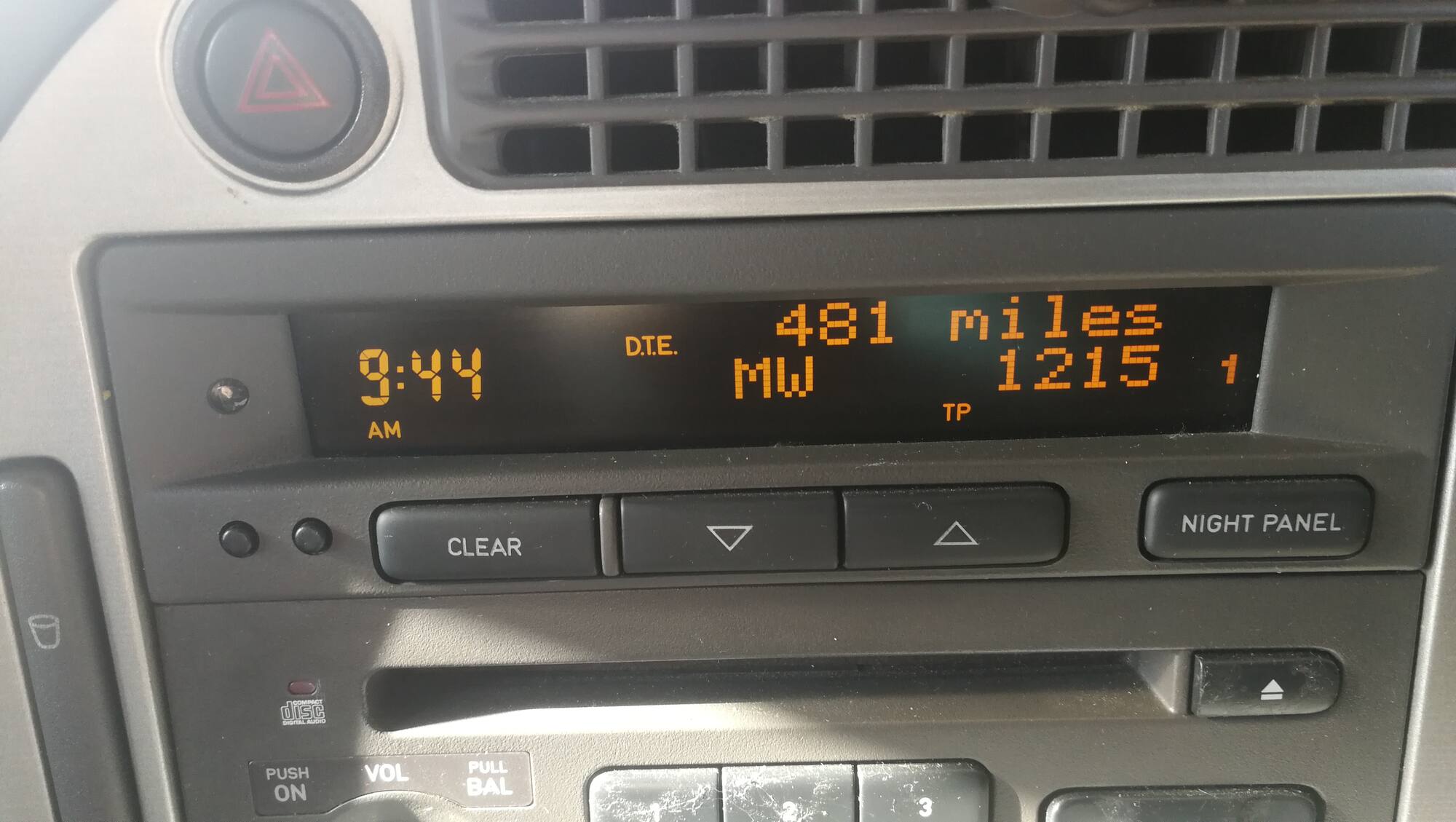

Filled this up today before heading through to the Unit to tinker..IMG_20200829_094417.thumb.jpg.755eaf4eafd2176f0f64da31d46c82d6.jpg
How close to 481 miles do we reckon I'll get? 70L tank.
Place bets now!

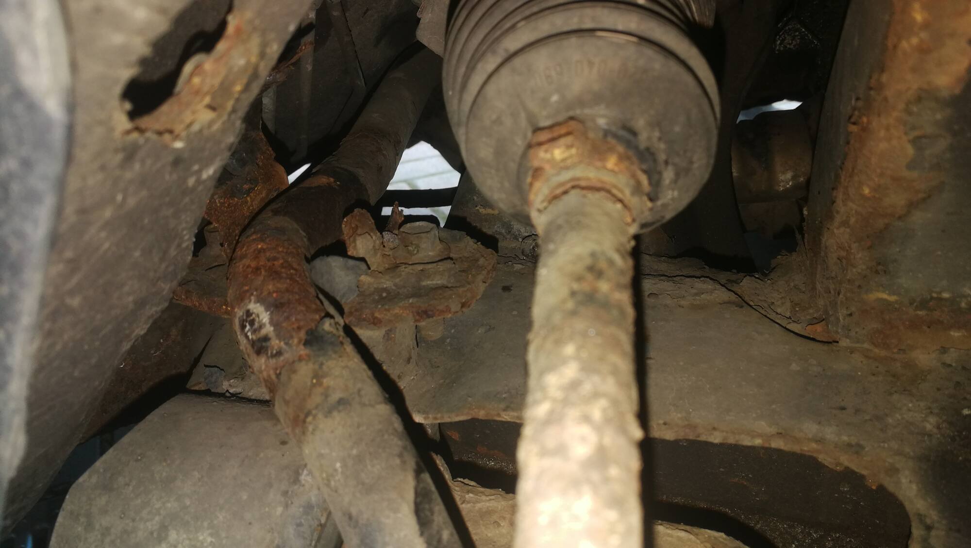

Once at the unit, the plan was to find out what the rattle was from the drivers side front - I got all set up
Then got a call from my dad saying he had a puncture - so I had to load back up and head out to help him.
Once back and jacked, the fault was obvious - the anti-roll bar bracket has rusted away and the rubber bush has disappeared.
Hopefully it's an easy enough fix.
Nearly 500 on this tank full so far.

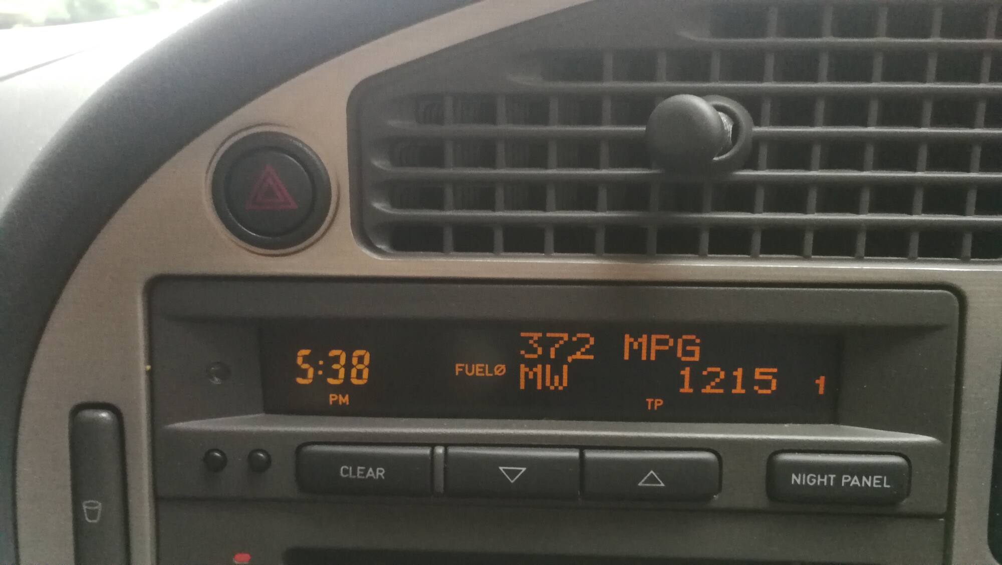

Took a bimble down to Peebles for some coffee and cake.
Now  190miles into the tank, and the OBC says 37.2mpg..

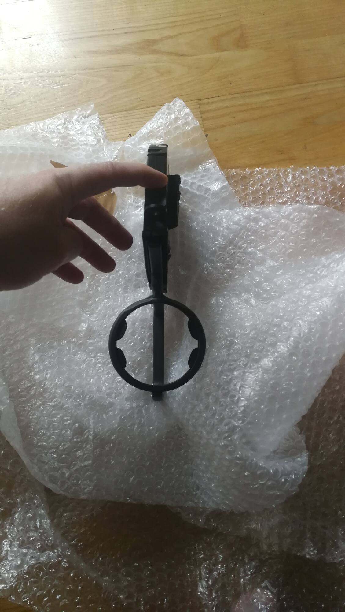

Thanks to the generosity of lancer778544 on Pistonheads, I now have a free working cupholder to fit to the car..

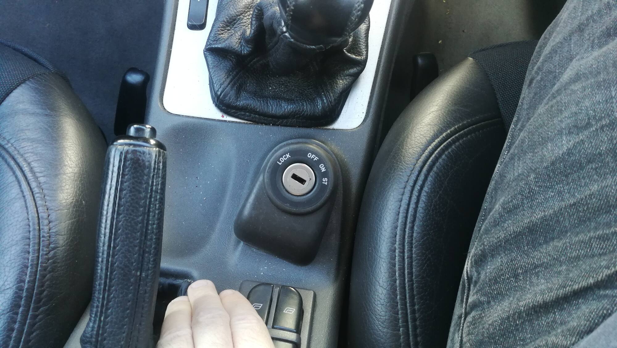

First up was an attempt to fix the ignition issues. The car will not always fire when the key is turned - there is a knack involving pulling the key up and wiggling, but in all honesty it's a pain in the cunt.

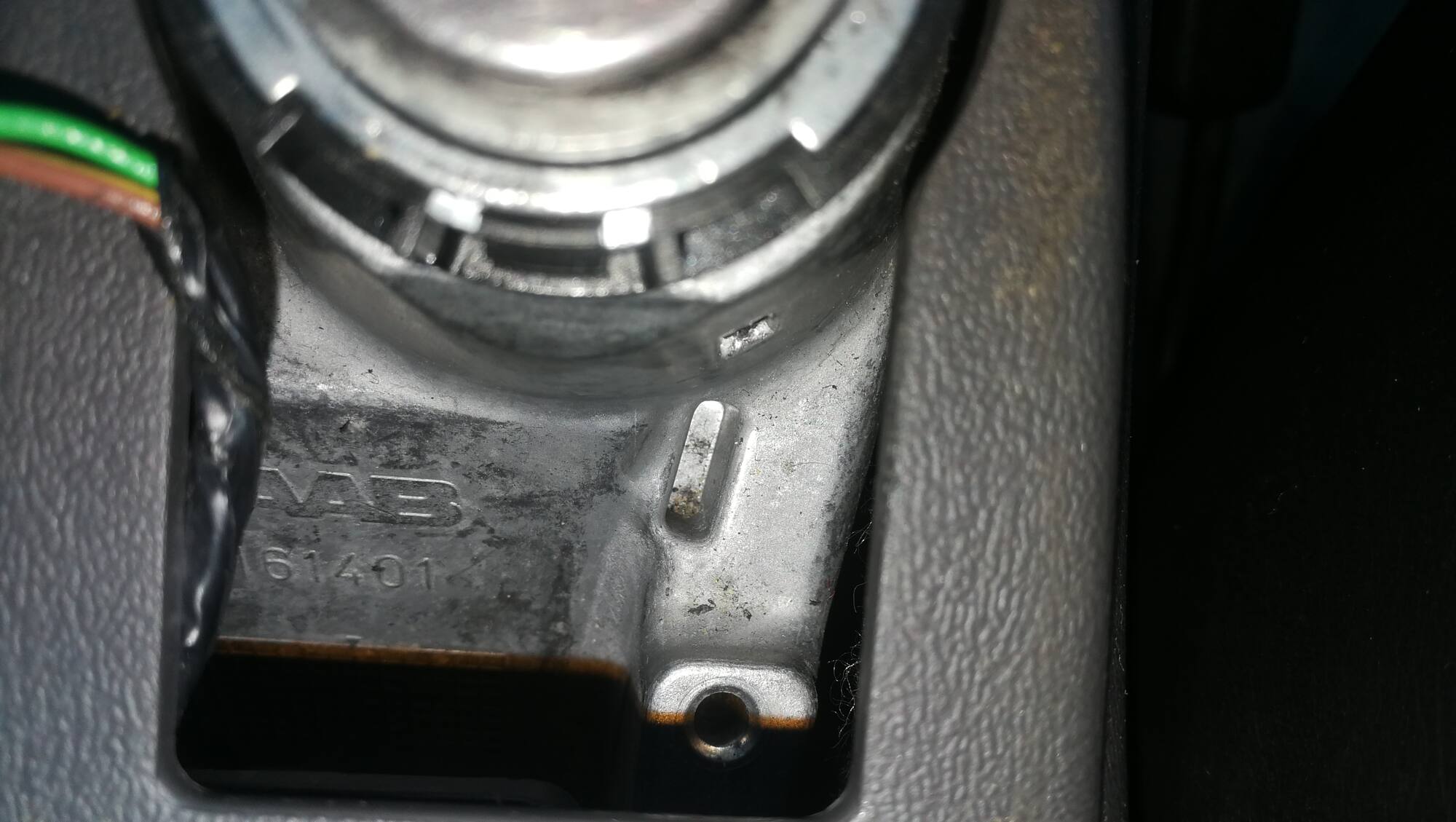

First, the chip reader/immobilizer ring was removed - twist to the left and pull up.
Then a rudimentary tool was fashioned from a nail to release the barrel
IMG_20200905_112937.thumb.jpg.4d9ecef2c0b8d9d2784b3d73efc74954.jpgIMG_20200905_113000.thumb.jpg.66e9748805c08e86544440e1b6546f6e.jpg
then the plastic cap was removed and the spring and washer taken out.
Everything was cleaned as well as possible, and some lubricant applied.
A refit was completed, and it fired first turn!

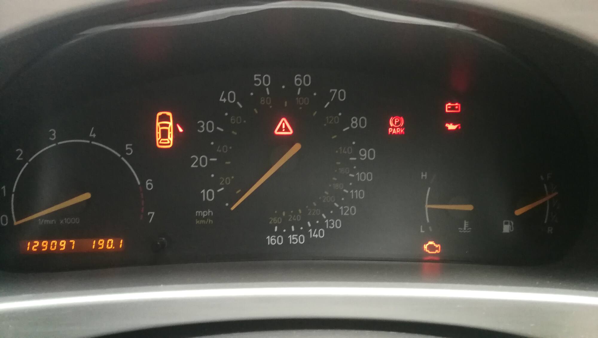

Off,
On...
 On..
Oh FFS, still the same issue.

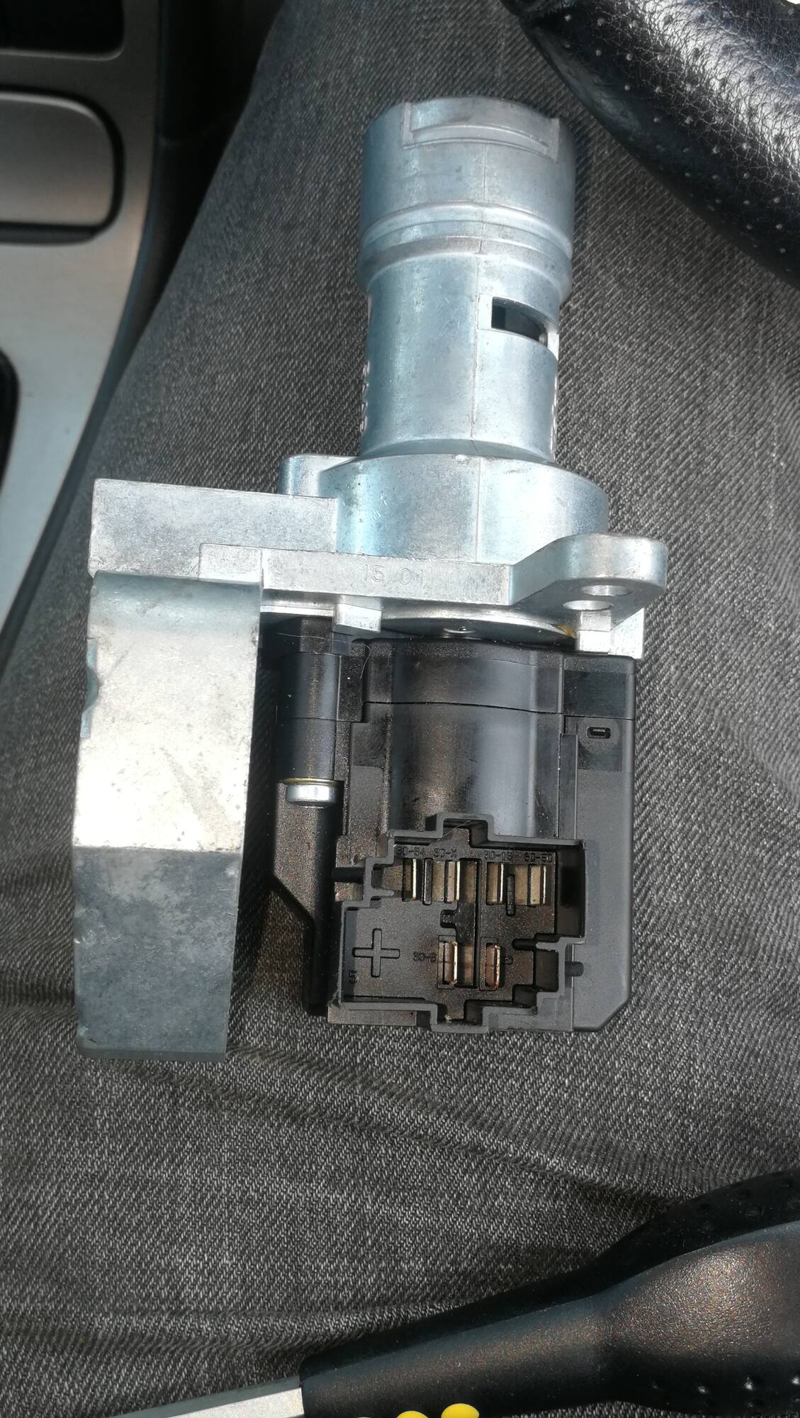

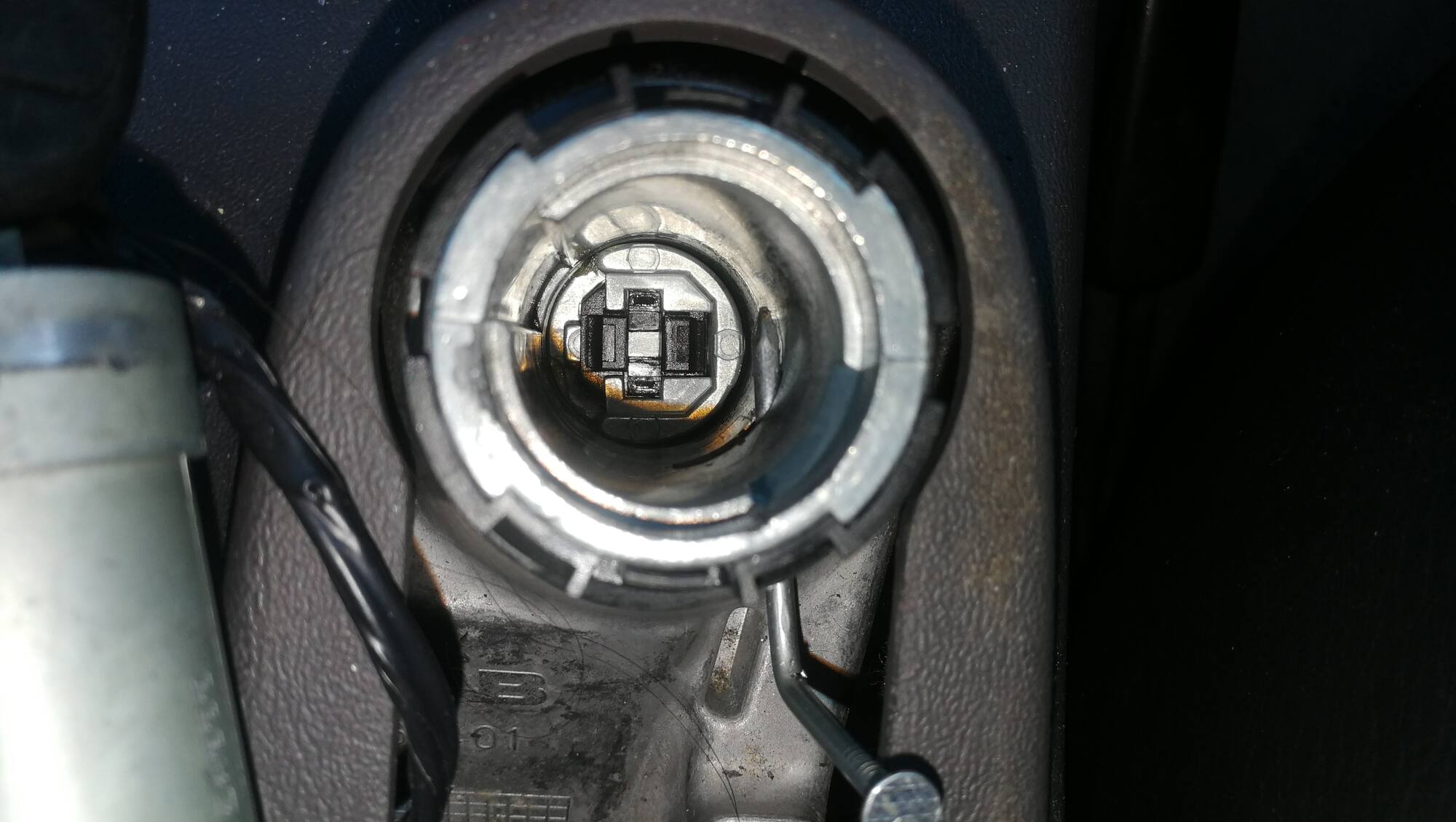

Time for plan B - I had a spare module, key and barrel available.
I pulled the lock out and attempted to start the car with a screwdriver - with the key and barrel in the immobilizer ring.
It only started sporadically.
I had a look at the replacement part. You can see how the barrel turns the switch that makes the contact.
IMG_20200905_120529.thumb.jpg.886552c18fb7de0f02e9ed5fe5518400.jpgIMG_20200905_120552.thumb.jpg.9f98ccc213c26c4093f099757709264c.jpg

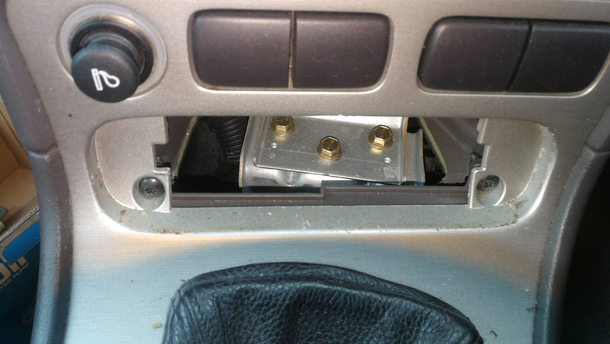

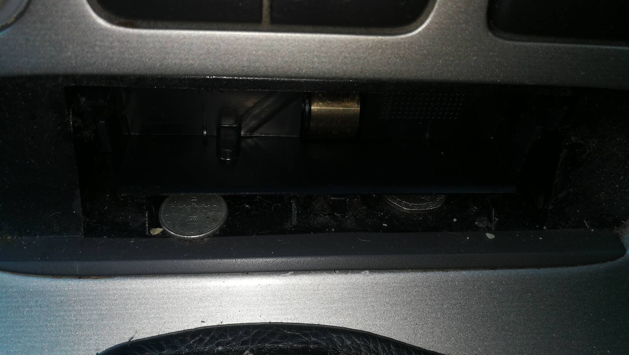

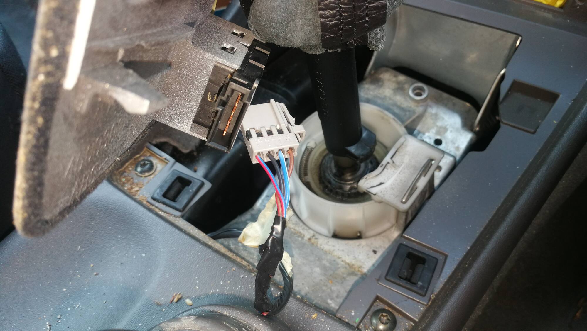

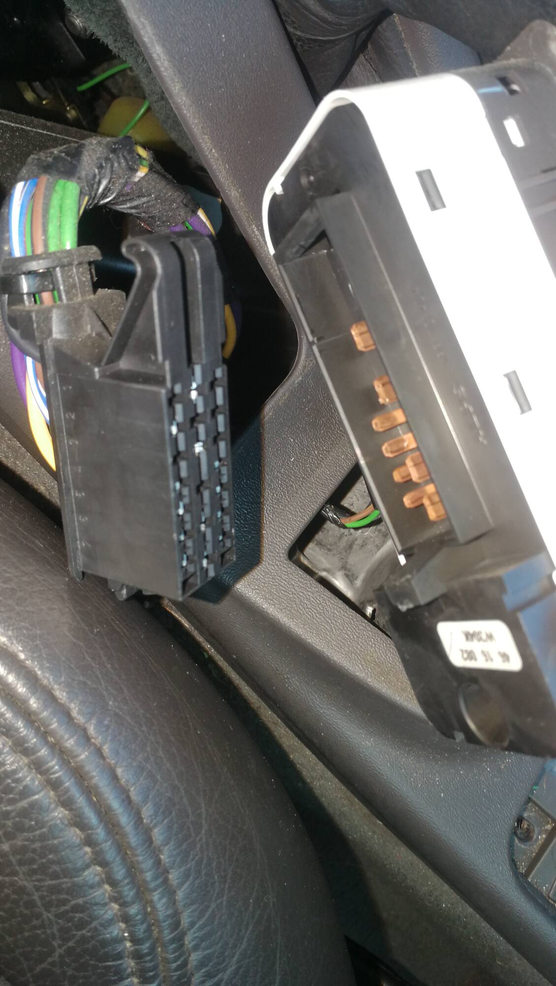

time to tear out the centre console then!

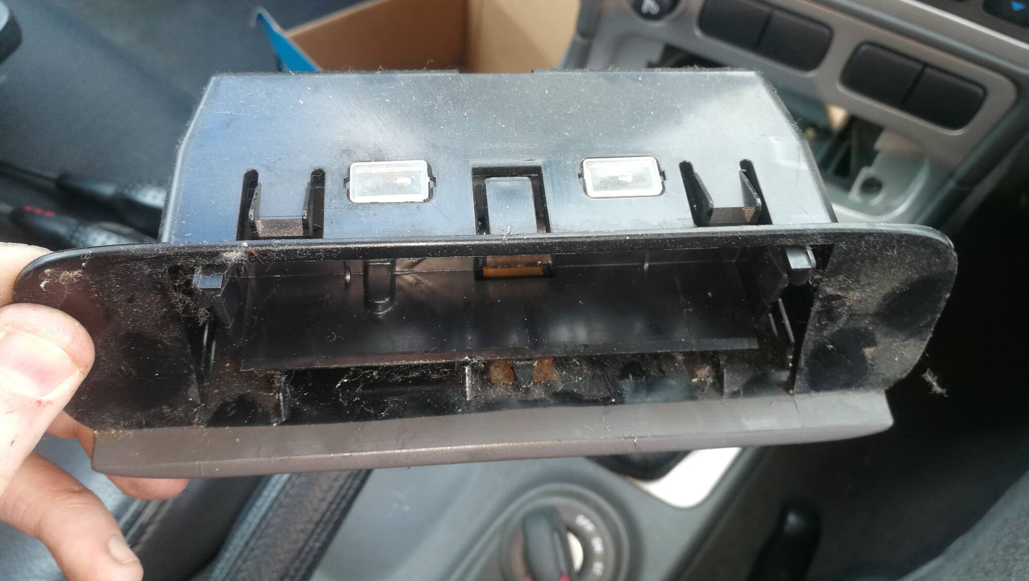

Ashtray pulled out and 25p found!
The ashtray surround was jimmied off
This reveals 2 bolts
This lets you pull the gear surround up.
Some plugs need removing
Exposing another 4 bolts (2 front, 2 rear)
Then there are 2 bolts at the rear under the back seat vents
Lastly, some plugs (locking switch and the window switches) need removed.
Windows
Locking switch
All that done and about to lift it off to continue dismantling..
It looks like the whole switch units are different :(
i think the spare is from a 2001 car, so pre facelift.
I put it all back together and moved on..

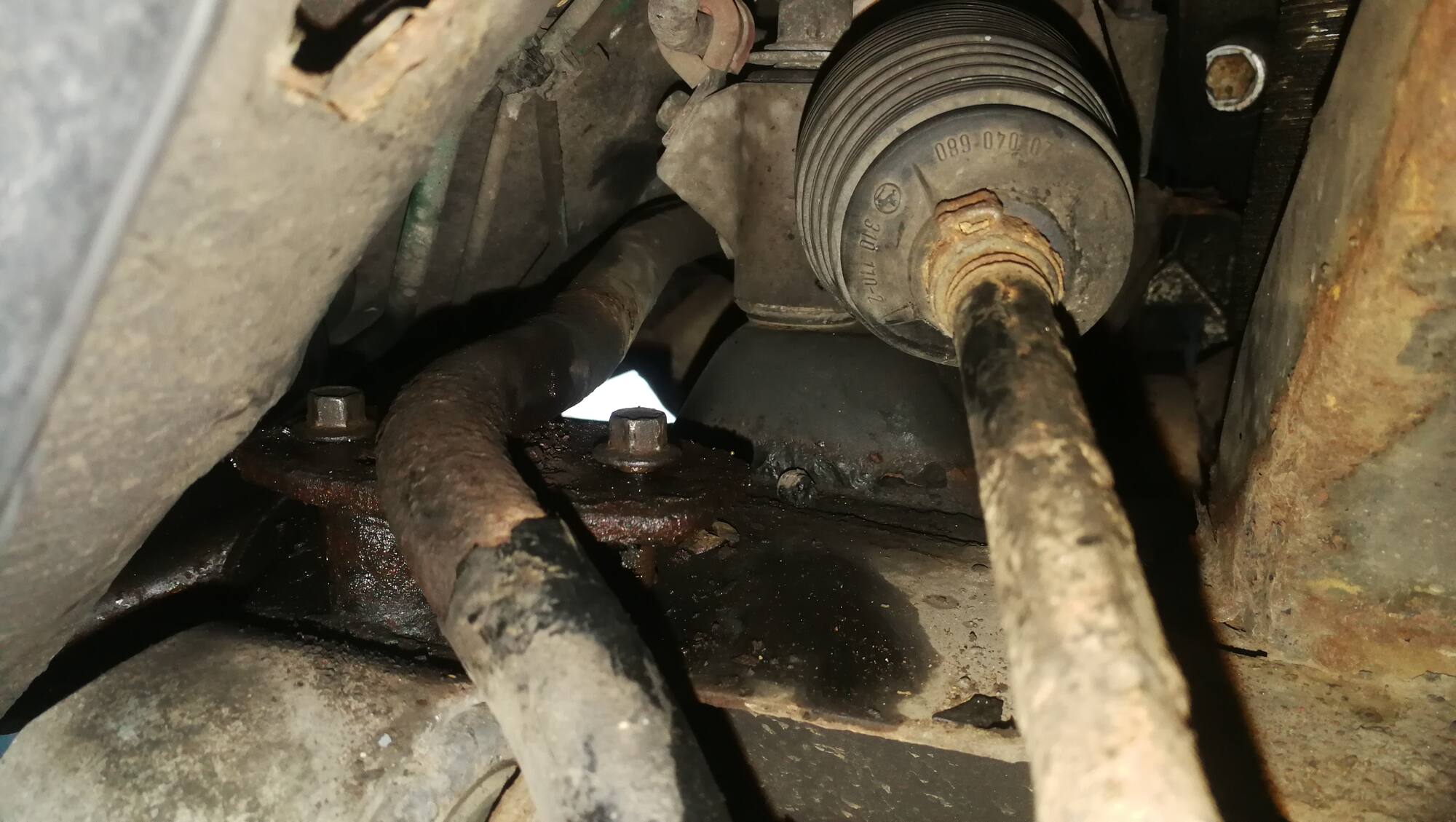

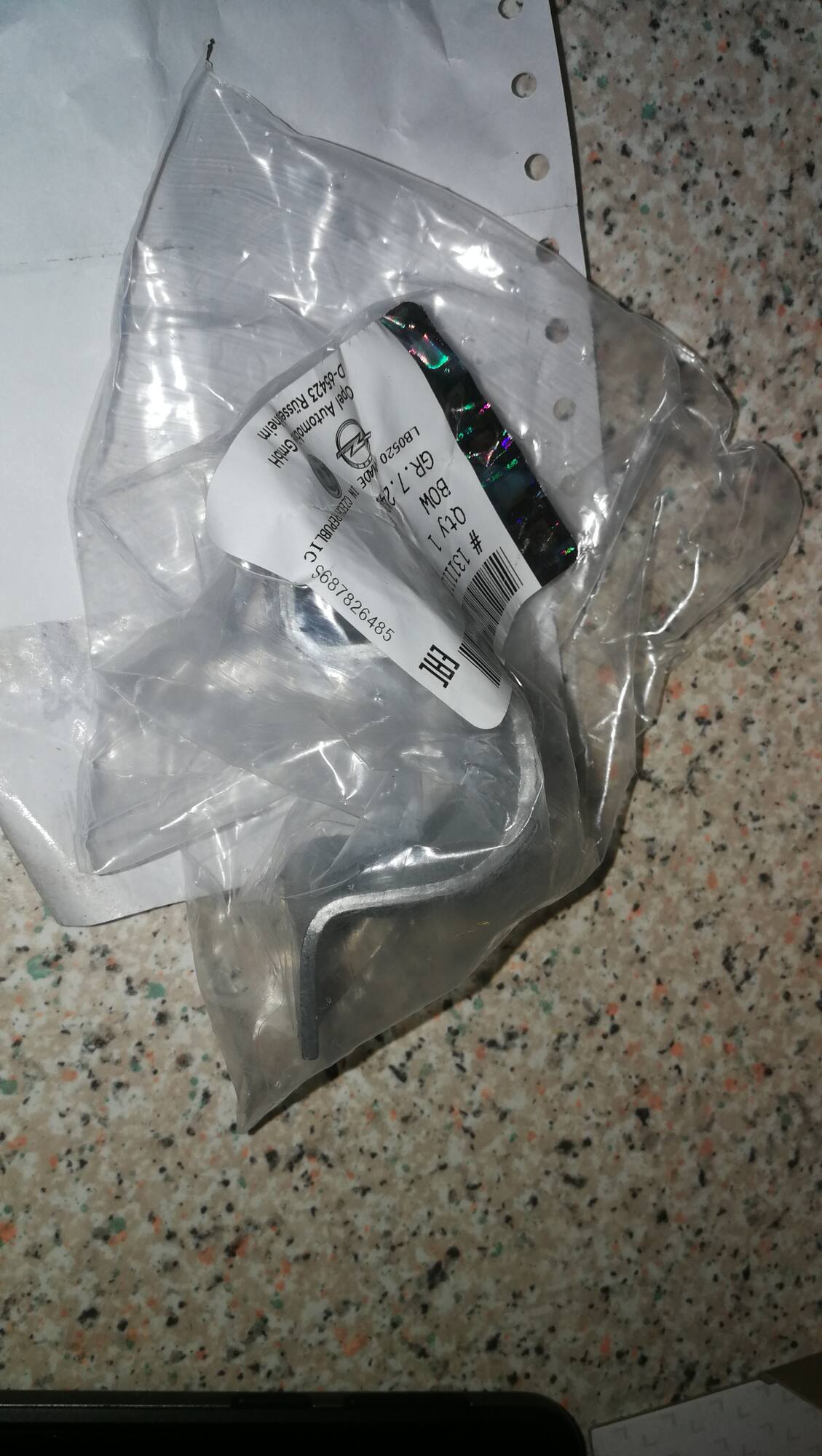

Critical thing to do is the ARB Bracket.
Screwfix's Remonstrating fluid was deployed and a 10mm socket and 3/8th ratchet applied to the front bolt.
top tip, turn the steering wheel to move the track rod and get the bellows out the way.
After 43million turns, the front bolt came out.
A similar process on the rear bolt (after bending the burst bracket forward to allow the socket on) resulted in a successful old bracket removal.
The two bolts were cleaned up and refitted to their holes ready for the new bracket and rubber to be applied.
The bracket had arrived when I got home
IMG_20200905_180341.thumb.jpg.067570d05c2a7209cdd527469cec2690.jpgIMG_20200905_180355.thumb.jpg.224942b5dcc3a0c1181242fa10e2cccc.jpg

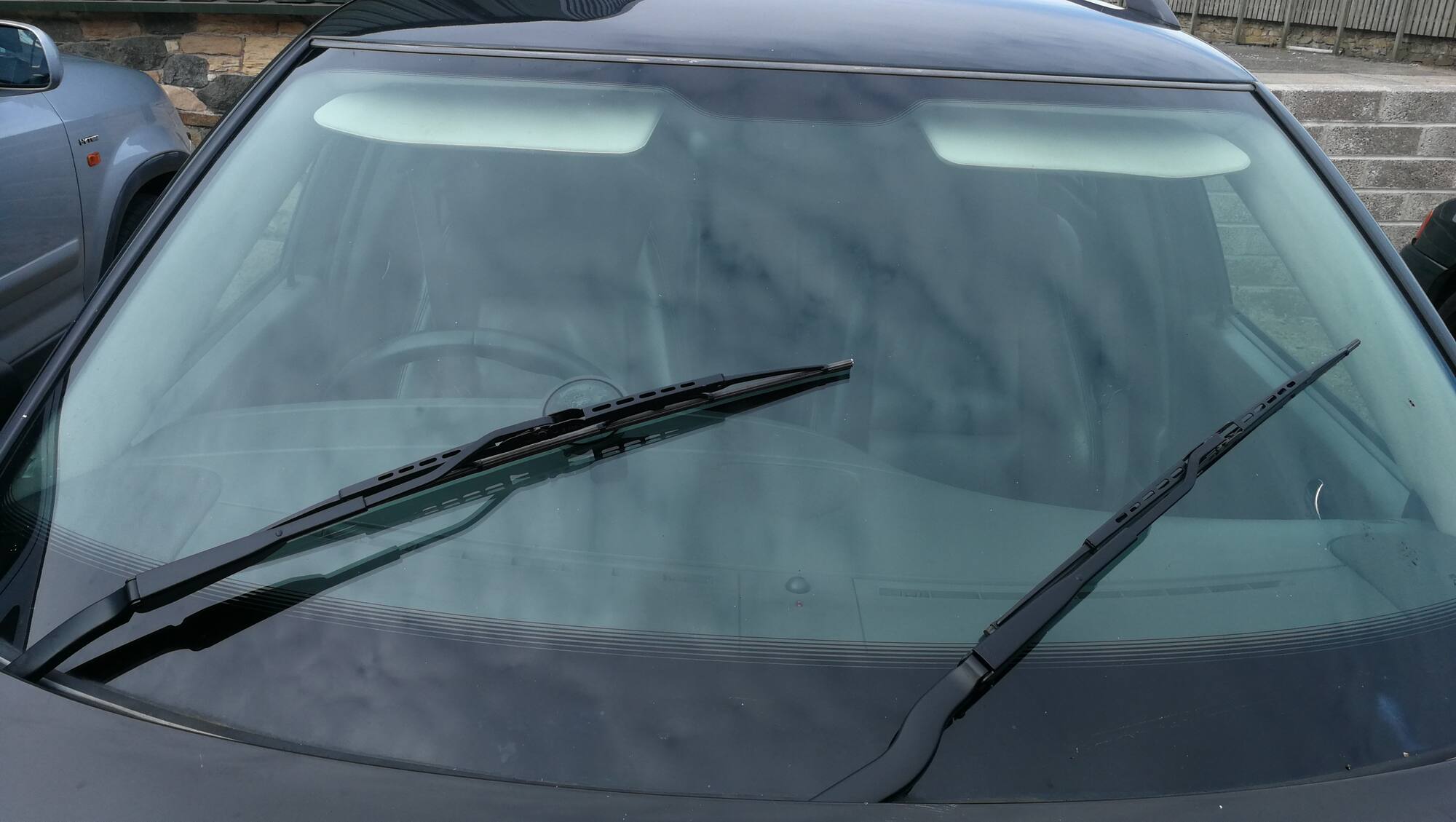

lastly, time to do some serious work..

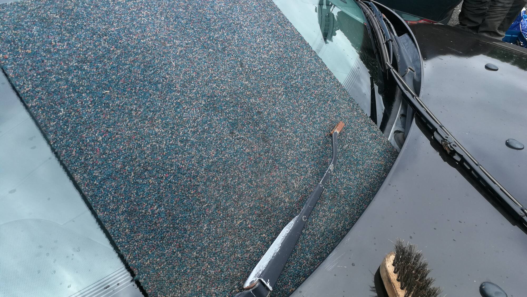

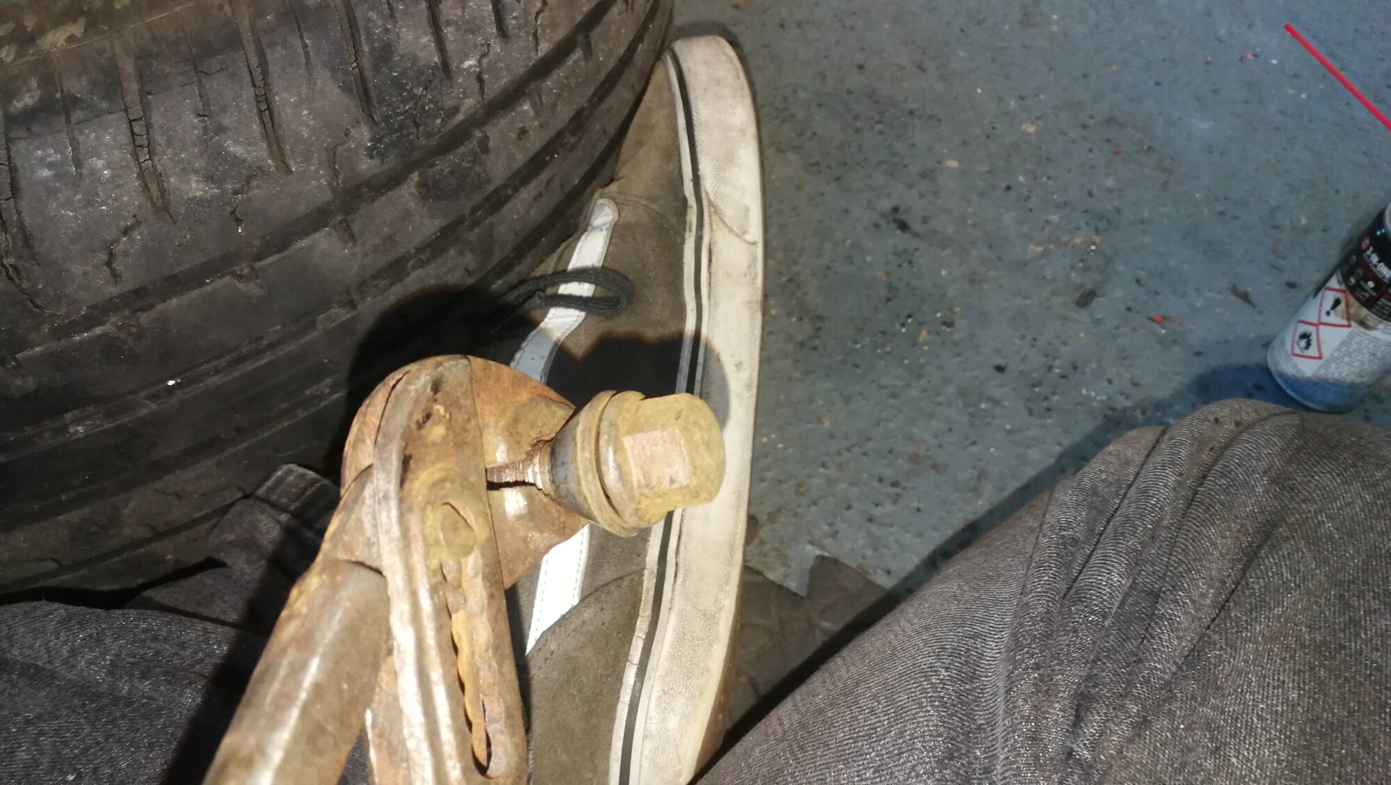

Wheelbolts were scabby
The wire brush fixed that.

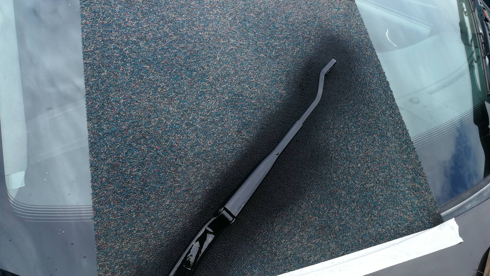

It was also deployed on the wiper arms
And some satin black was skooshed.
IMG_20200905_151540.thumb.jpg.a72e0fcae3d673ee9105fbc38cfa2b20.jpgIMG_20200905_161359.thumb.jpg.2dcbe82777845216f9051fd1068af798.jpg
Grotty wiper arms rip my knitting, I have no idea why. So grand work all round. Pity about the ignition switch!
Ed China taught me everything I know about satin black. It's a fix for everything.
Does yours honk out blue/black smoke at random intervals?
Maybe that's just mine.

I’m borrowing that idea for my wiper arms, they look shit on all my cars and that is a simple and elegant way of avoiding taking them off
