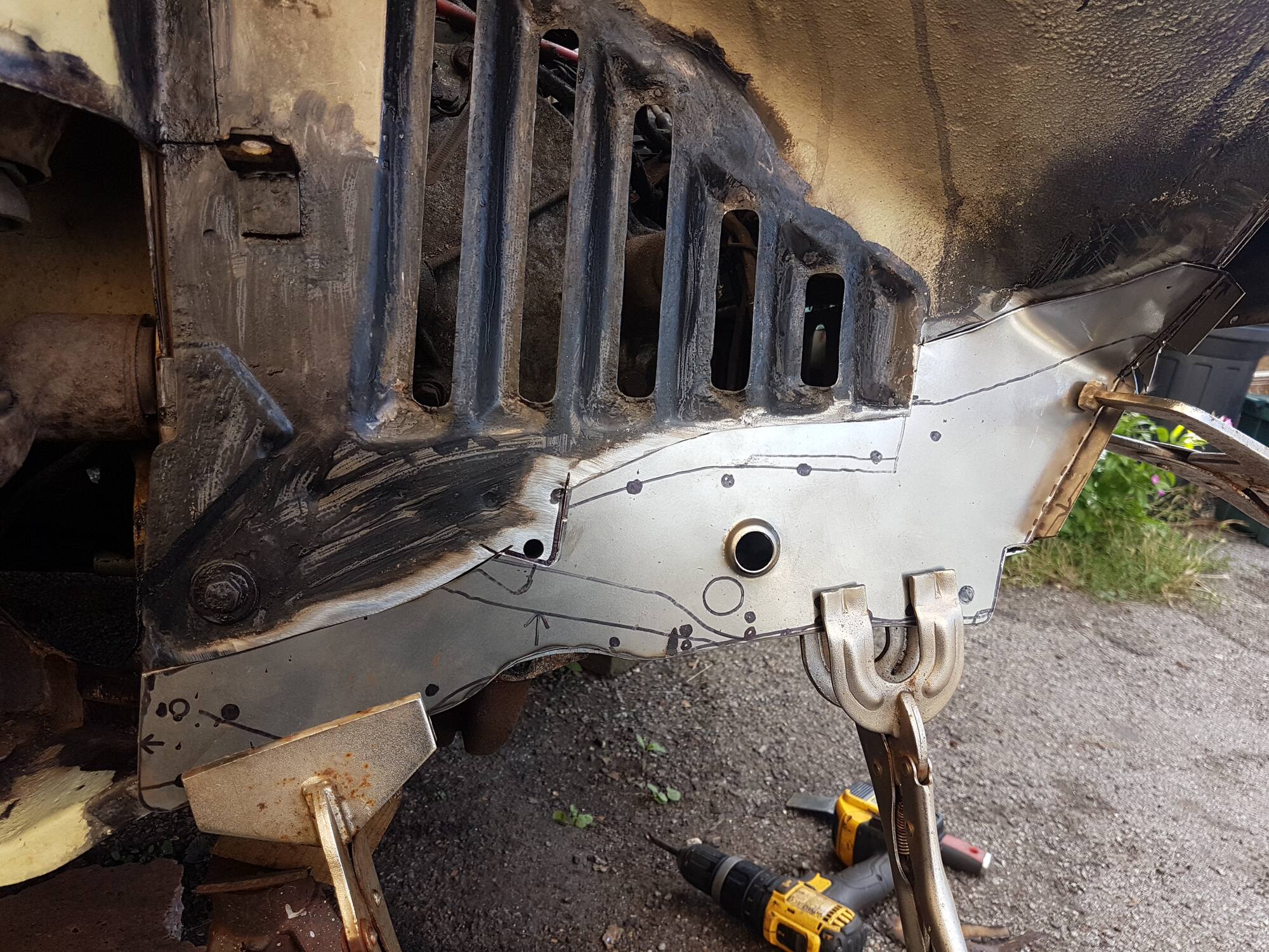

Some may have seen that a bought an Allegro that needed a little bit of welding, well as it often turns out with such things that little bit of welding turned into quite a lot of welding,  the right hand side has pretty much turned into a pile of ginger coloured dust but after hitting it quite hard yesterday I've made some progress,
Before
During
20200713_153216.thumb.jpg.91e49d163fb3864c47c405c1e70f01de.jpg20200714_134302.thumb.jpg.9c9dcf58b019204e9cd3c1a0405eb2c1.jpg20200713_153222.thumb.jpg.4c5327b999ea7a164a7278939a0ba2de.jpg20200714_184020.thumb.jpg.48821a21d8d316904d03c11b3cf10243.jpg20200720_160346.thumb.jpg.1cbb4020f3b7b4259f0479591a1ac59a.jpg20200720_190033.thumb.jpg.b39854668eefb7691c6e79e0eb4094b1.jpg
and up to date (not in anyway finished)

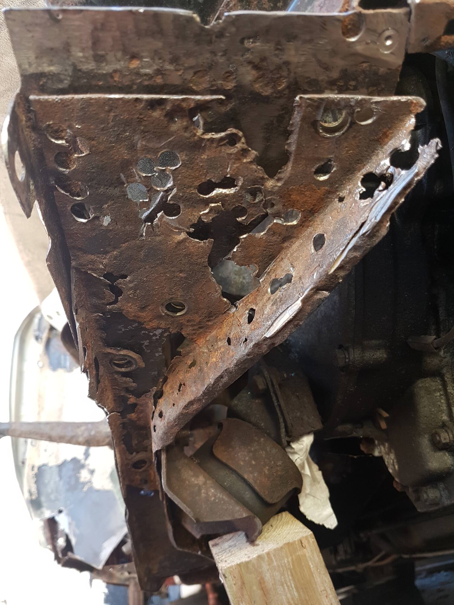

I still have a long road ahead of me, the driver's side front wing has to come off to get to the bottom of the A pillar and inner sill area as the Racing Ginger has travelled the complete length on the right hand side,  the near side is so far Solid which I'm quite happy about,  I've got to make good the front tie bar mount, again on the right hand side as it looks to have succumbed to the Racing Ginger also, will be fun working with 2mm steel
20200804_162043.thumb.jpg.744776c0df0e038caee80773bcd6fd3a.jpg20200804_162102.thumb.jpg.97369a7d76e87c17f6baa79e1f79fd2c.jpg20200804_162053.thumb.jpg.0cc03355971ad3f2efb2f3ae73d2daa4.jpg
the reason why I have to rebuild this is due to the non availability of them either new or second hand, this I have found is an issue with Allegro's, mechanical parts are reasonably easy to get but anything else is quite hard to find,

Nice job on that. Your welding and metal work is really nice and neat.
Was this the one formerly owned by @garycox and/or @barrett?  Good work so far, nice to see attention to detail with the dimples on the inner sill.
Expand
Thank you,  I'm learning as I go with different techniques I've watched people use over the year's,  all I know is you can't weld to rust so I chop everything out and go from there,  two bits of angle iron in my large Vice with a couple of clamps has really helped me to be able to make the floor panels, the side of the inner sill I used some old plywood, made the shape required twice then clamped it together and tapped away until I had what I needed,  i find it interesting finding new ways to do things

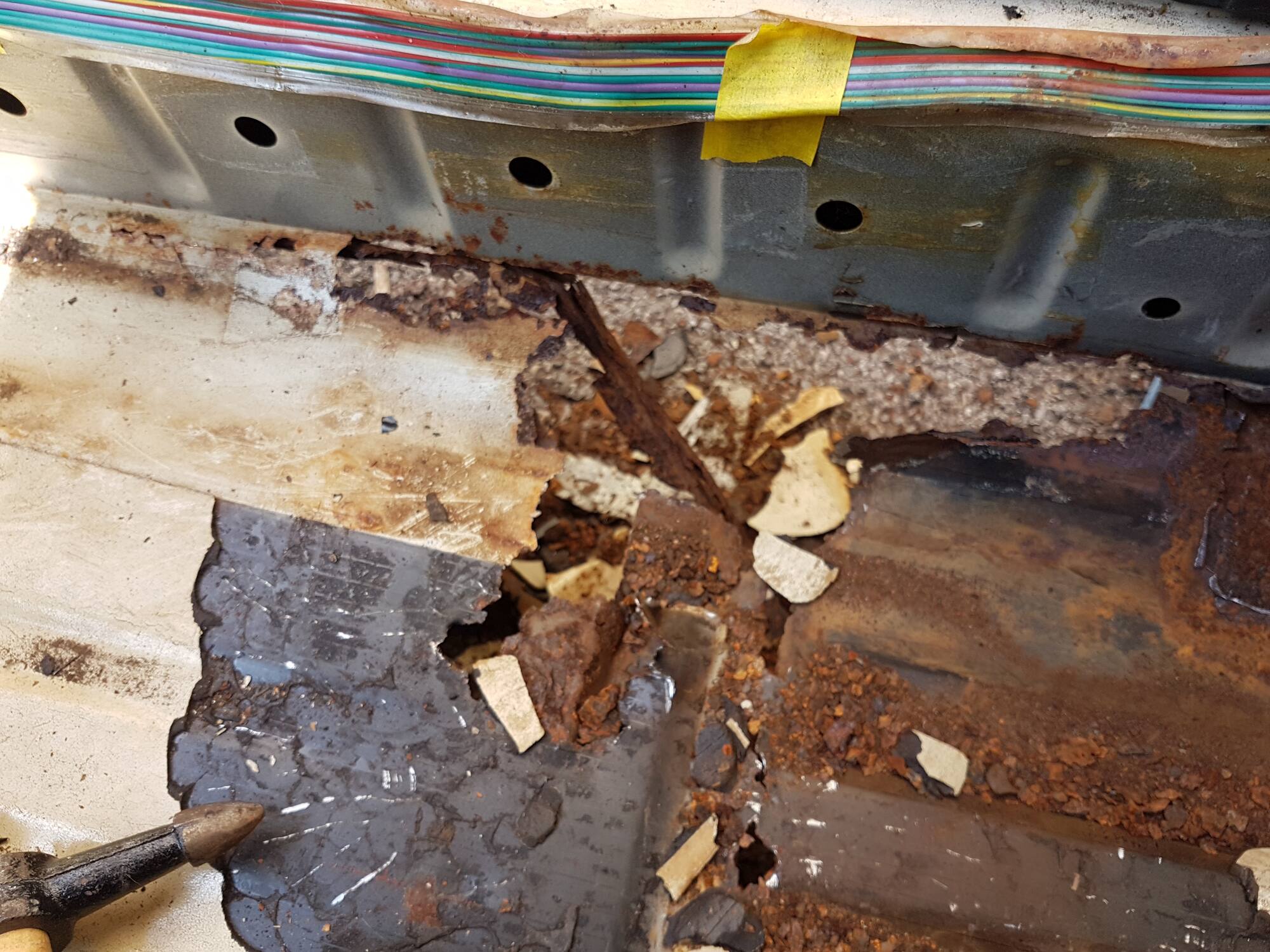

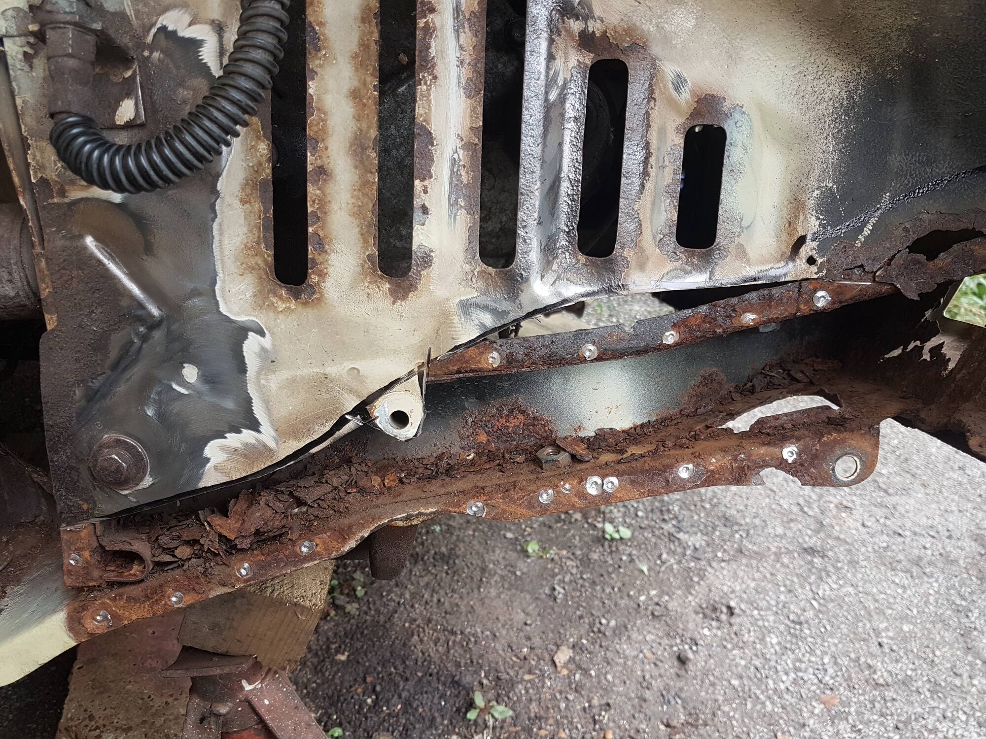

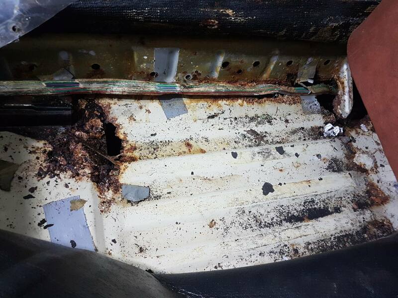

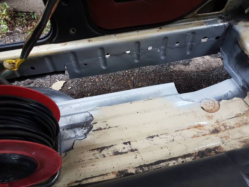

The Allegro or Rusty as I may as well call her got a bit more attention today, the floor and inner sill area is not finished yet so I decided to start on a completely different part, to recap the right hand side is rusted rather nicely from front to back, the front tie bar mount I removed seems to be unobtainable so after measuring the thickness ( 2mm ) I started to remove loose rust and disassemble it, luckily the inner parts where the rubbers and bar fit is still relatively strong so the outer part which is spot welded and Gas welded has to come off, I've ordered 40cm×40cm×2mm of steel sheet that should be enough to make the tie bar mount and some spare for the end of the chassis leg which is also needing attention,
20200830_182035.thumb.jpg.1231eea2342dce5a026f80fc7809809f.jpg20200830_182041.thumb.jpg.68d29f300c37c9810d9c3d1858759c17.jpg20200830_182103.thumb.jpg.7fe13fca77bdafd5ba381492a94a3607.jpg20200830_182110.thumb.jpg.2014d081d935b2ded3387723c53d2888.jpg
the grinding and hammering was annoying the neighbours so I went out the front to annoy a different set of neighbours, some cutting, drilling and grinding later to remove more racing ginger I had a hole,
20200829_161135.thumb.jpg.9cfb5c0b66070317878cba941d64907e.jpg20200829_161802.thumb.jpg.9d2dc4d2d0152ecf16154ce57e07d26a.jpg20200829_162036.thumb.jpg.5347735407f59d87dba2d8d99bb16b99.jpg
As you can see this revealed yet more rust although it is more surface than rotten through mostly,  the front section will need a bit letting in,20200830_162036.thumb.jpg.717180637bcc3043a6d7e0a9ae2ab5f0.jpg

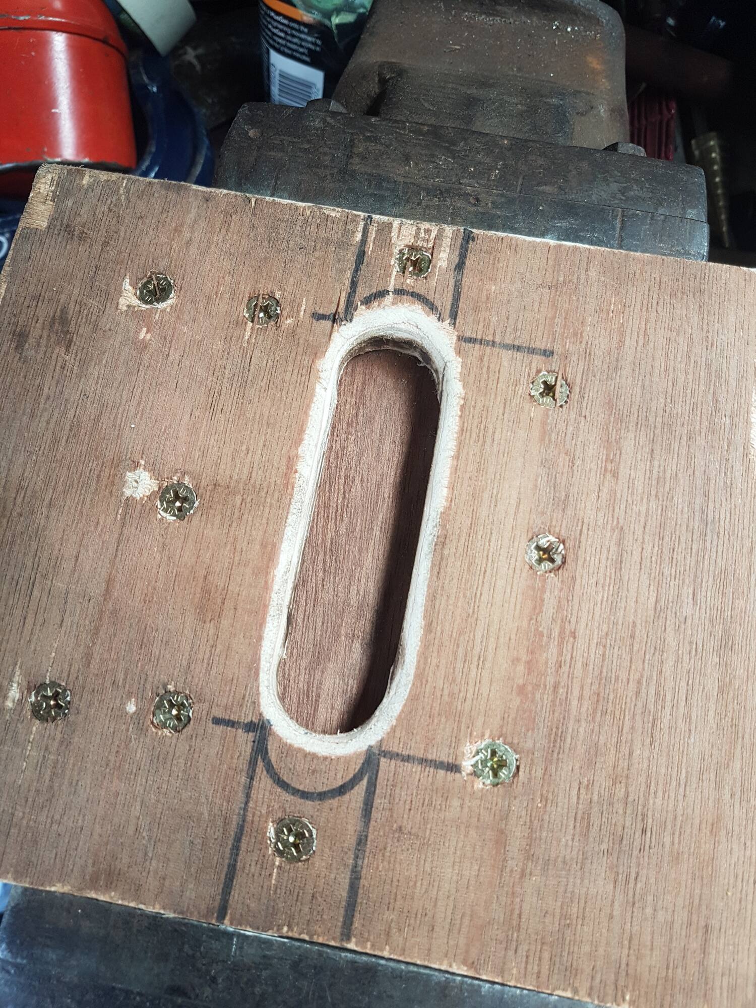

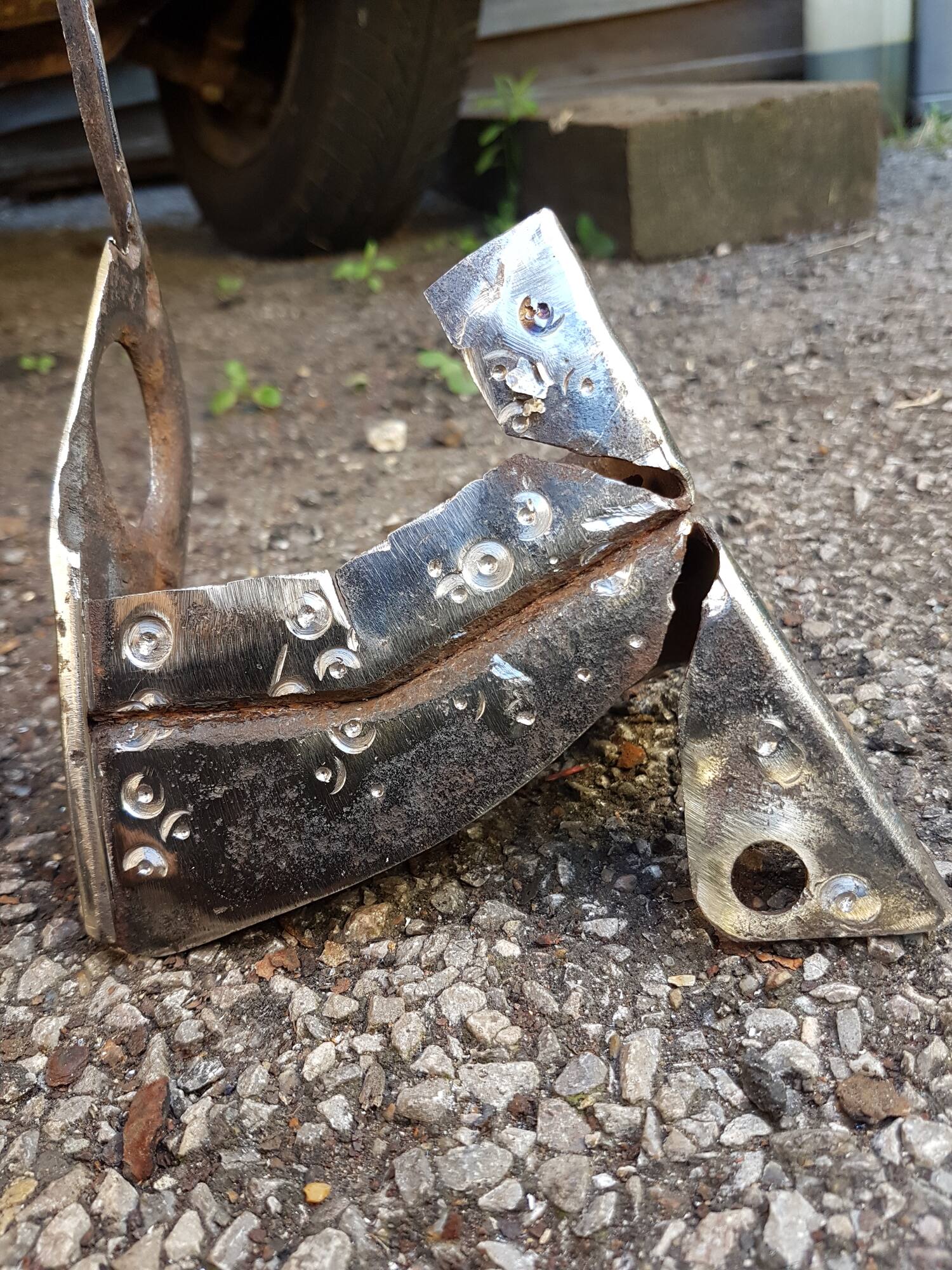

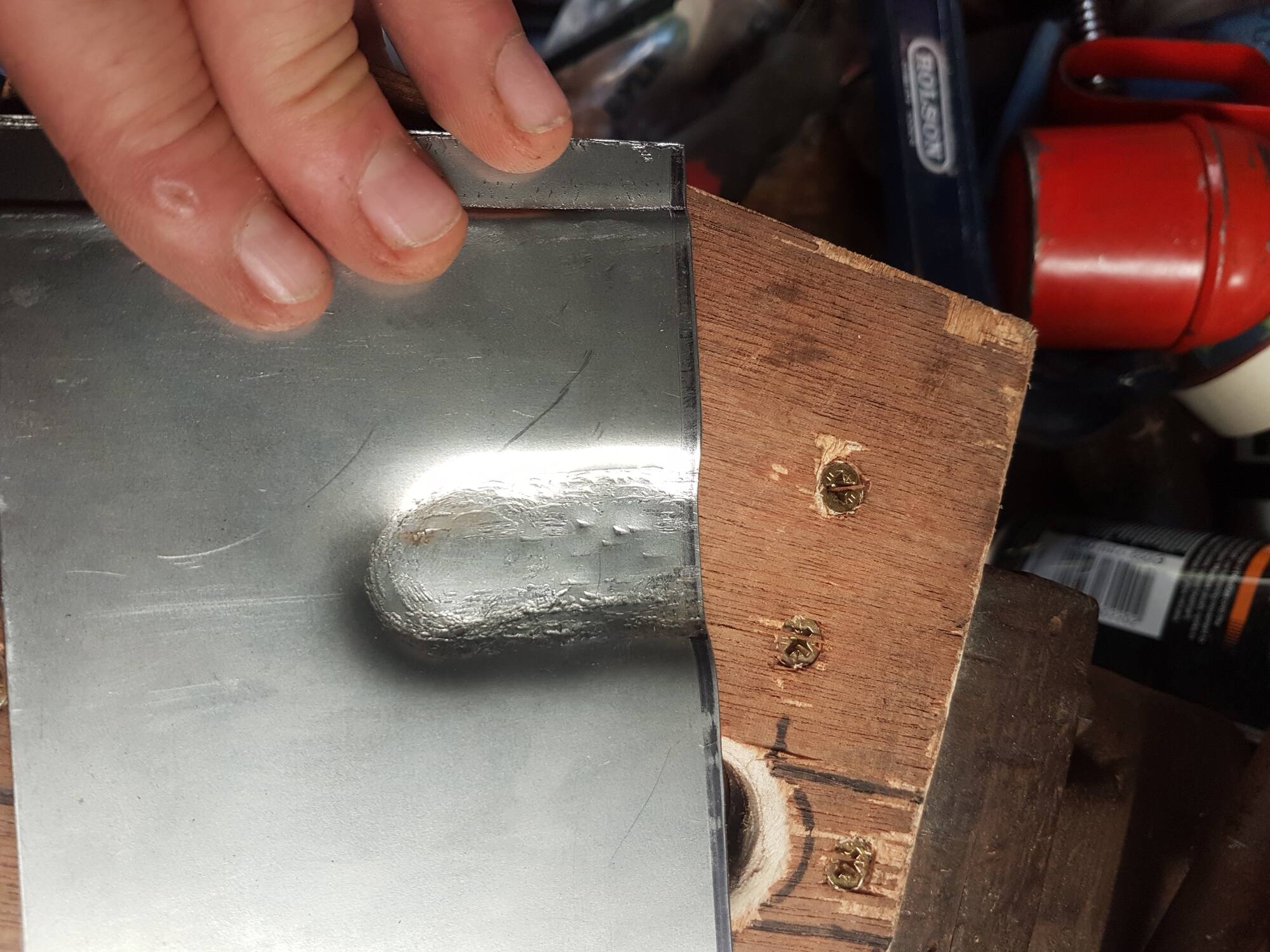

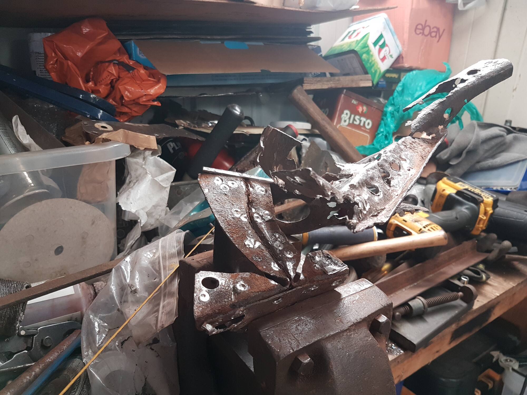

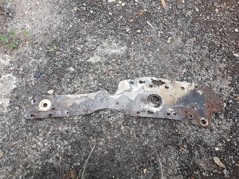

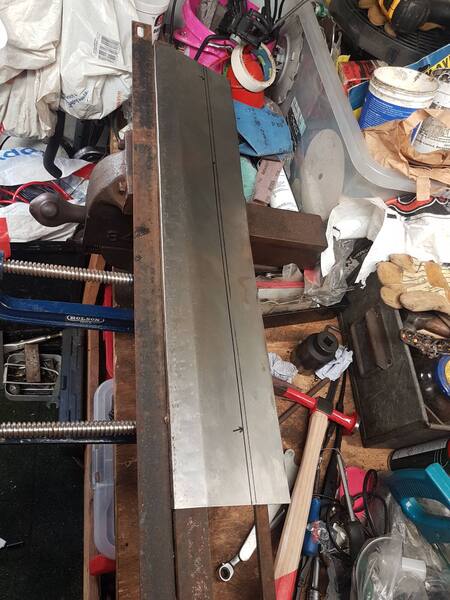

I knocked up a repair section for the outside of the chassis leg with my first attempt at a swaged hole 20200830_160145.thumb.jpg.030e2433ab5d39444ea9ce3f482a310a.jpg

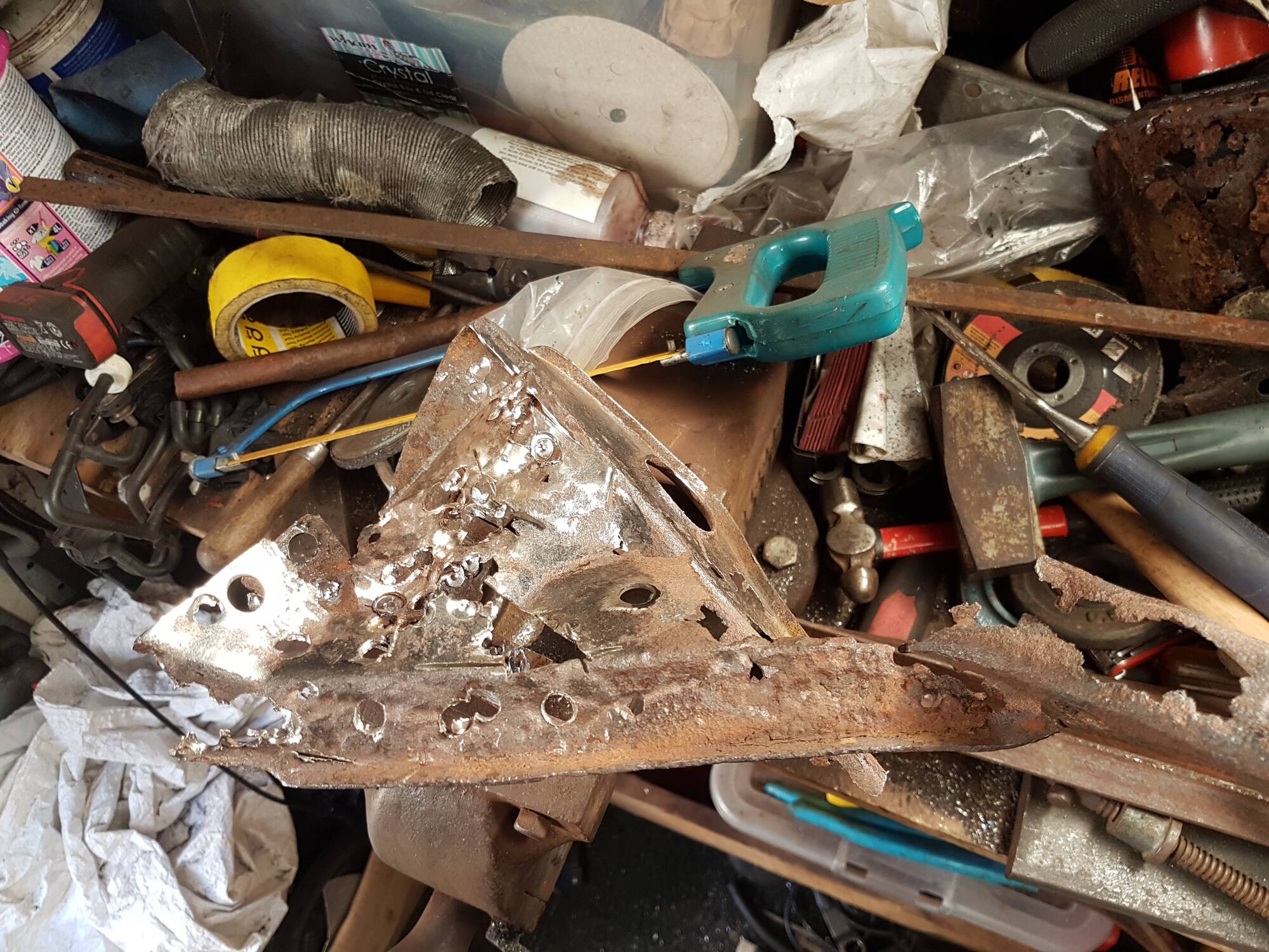

I had to chop a lot of the front right hand corner off for access to the inner skin which was..... you guessed it rusty,  the poor car is looking rather sorry for itself by the end of play, this I'm sure will upset the two bob snobs around me and will for sure be lowering the house prices too20200830_194057.thumb.jpg.7dc23fc710ef8b41d313a300f3b3e9a5.jpg
I'm looking forward to receiving the 2mm steel sheet to have a play with,  more soon .

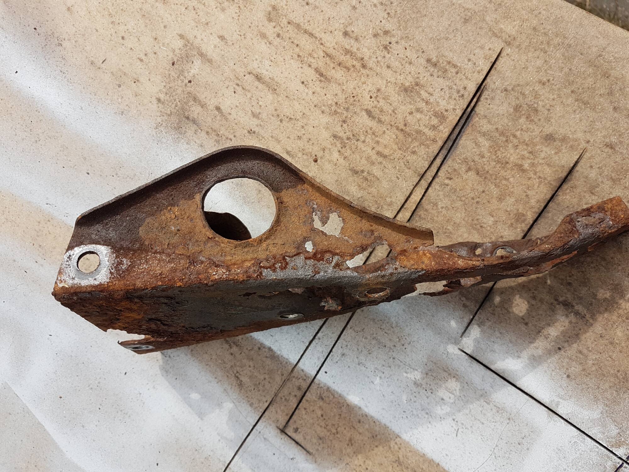

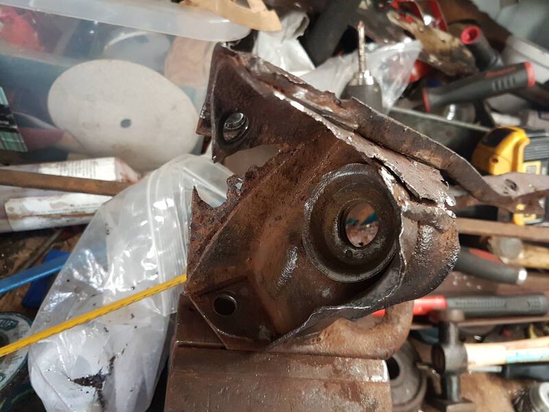

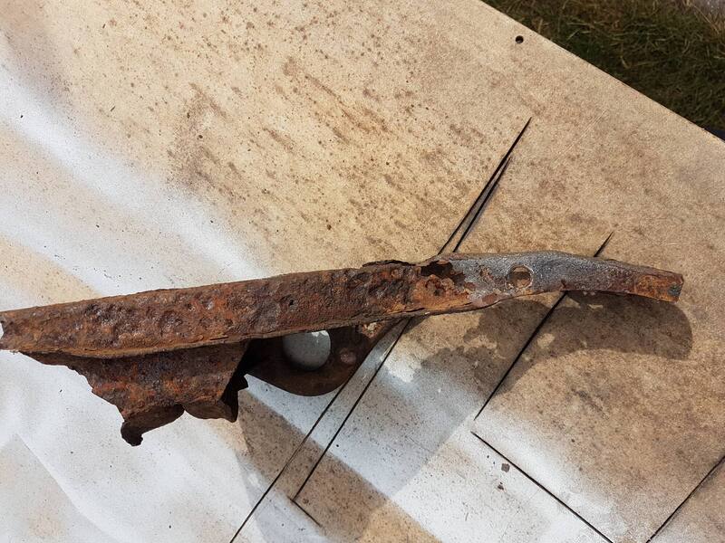

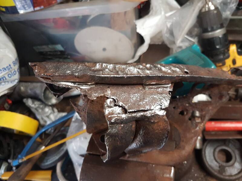

This morning I finished what I started in my last post, the tie bar mount got a good hammering and the spot drill bit used a lot, the outer part finally gave up and I could get to the inner bit at last, 20200901_114234.thumb.jpg.2ad39b99870cf26bce0e4547a6531d55.jpg20200901_114227.thumb.jpg.6dc8f80d698ba45cb41bf1ac60c40084.jpg20200901_115815.thumb.jpg.42e93d609eabea10aa17023727b5f19e.jpg
I straightened the outer part and then popped it bad on the car as I needed to know that I can still use it as a pattern 20200901_115829.thumb.jpg.b4119b6f2db3999ba05d5855909c567e.jpg20200901_123247.thumb.jpg.7c5c9cb119157b64e751ef37d70e6228.jpg20200901_123328.thumb.jpg.af4d1ec115fe2009ed3c61708b9c832a.jpg
I will replicate the holes and plug weld them,  this should be plenty strong enough plus the bracket is bolted on to the chassis leg so I can't see it going anywhere, 20200901_123342.thumb.jpg.178717d8d086631826b546590d6b00c3.jpg20200901_123651.thumb.jpg.6031f60d8a7329bb1254f517bb3c1dd5.jpg

Great work man. That tie bar mount looks a right battle, I remember they always go there and its not a spot where a shite 'repair' will do.

Those tie bar mounts have been hard to find for at least 20 years or so. I remember finding an Allegro in a breakers with a new front panel fitted and NEW tie bar mounts! Best £20 I ever spent!

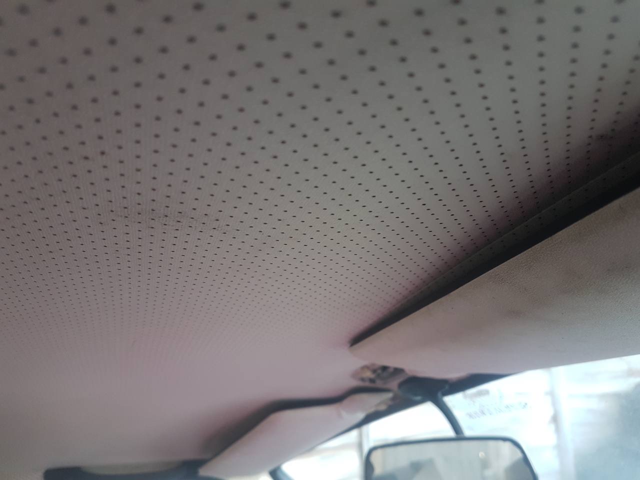

Back to the parts Allegro for a couple of hours today and noticed that the headlining is different to RPE in that one is solid and the other perforated
Parts Allegro 20201214_163219.thumb.jpg.16fe7df9730cea130ce8d189e13622b2.jpg
RPE is 1981 and the parts Allegro 1980, there are subtle differences between the two I've noticed,  the headlining in RPE is fundamentally fine but has light brown staining around the edges from the Glue behind it,  so my plan is to remove the spare car headlining and make a new one using the old one as a pattern, luckily I have a family member who owns a couple of industrial sewing machine's and is happy to sew me one, I'm not unfamiliar with fitting headlinings or removing and re fitting the screens so that's a job for next spring onwards sorted, I took the carpets up on the driver's side and this is what was underneath 20201214_163326.thumb.jpg.0aec0fd0fb994db23cacad5a9a53f455.jpg
The part in the top corner of the picture is a strengthening bracket due to the jacking point underneath, on RPE this was missing and I was going to have to make one but this one is good, the floor it was welded to has completely rotted away but left the bracket alone 20201214_163319.thumb.jpg.2c9f8f07c1aa117861aacf33cc3857ca.jpg
