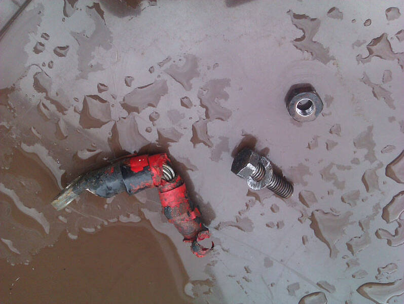

vulgalour Posted August 16, 2020 Author Posted August 16, 2020 That broken washer bottle is Unipart GWW906, as fitted to some Minis and Morris Minors. NOS one ordered for a tenner, be daft not to at that price. PhilA, beko1987, ETCHY and 6 others 9
lesapandre Posted August 16, 2020 Posted August 16, 2020 On 8/15/2020 at 8:13 AM, Angrydicky said: Numberplate looks much better! Love the old driving lamps too. I was quite surprised to see independent front coil sprung suspension under there. I was expecting leaf springs, as I thought these were quite pre-war under the skin. Just goes to show! Screen washers were bought in as part of the MoT process in the 1960's. They were obligatory - so were retro-fitted to all cars - I don't think the LD10 had them from new? Great that you have tracked down an original fitting bottle from the installation. ETCHY 1

anonymous user Posted August 16, 2020 Posted August 16, 2020 8 hours ago, lesapandre said: Screen washers were bought in as part of the MoT process in the 1960's. They were obligatory - so were retro-fitted to all cars - I don't think the LD10 had them from new? Great that you have tracked down an original fitting bottle from the installation. Screenwashers are not required if you have an opening or fold down windscreen lesapandre and Shite Ron 2
vulgalour Posted August 16, 2020 Author Posted August 16, 2020 Barker bodied cars have a fixed screen, Briggs bodied cars have an opening one. So we have to have washers (I don't mind, I like having washers). lesapandre 1
