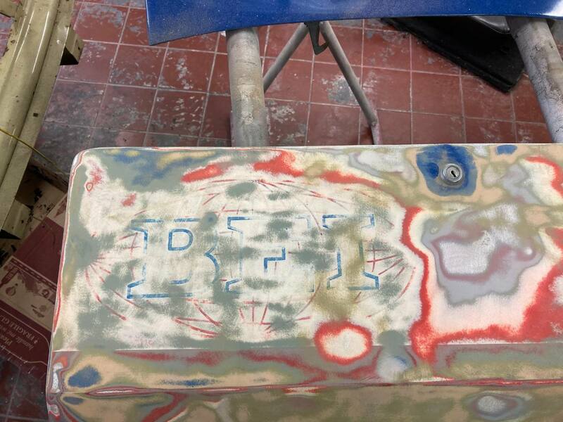

coalnotdole Posted August 20, 2020 Author Posted August 20, 2020 Well despite not really being at the front of the project queue the Enfield has had a little bit of work done to it: After much thought and procrastination I cracked out the dremel and cut the alloy rear quarter panel along its original weld lines and carefully opened out the crimped over edges around the door and window apertures allowing me to remove it exposing the steel skeleton of the car. Crusty folded steel sections which will need replacing, annoyingly they're a straight folded channel on the inside but then the outer flanges are curved so will presumably need to buy a jenny roller to try and replicate them. Rear end of sill which has suffered from water sitting between the (pointless) twin skin construction. The front opening windows on the enfield are loosely based on mk1 mini parts but assembled in such a way that water isn't really kept out of the car - in heavy rain water will run under the non sealed lower channel and flow down the inside surface of the door and dooryard before ending up in the footwell! There should be an opportunity to add some drain holes from the channel into the inside of the door as per the original mini application which I will look into when I properly refurbish the doors. However as the car is still sat outside at the moment and the window glass makes a bid for freedom every time you open the door I've shelled out and got some parts to replace the lower glass track and window catches which I have now fitted - this will all be coming apart again but at least its slightly more weathertight for the moment now. As you can see the original glass channel is in very poor condition. Original lower rail and shiny (stainless) replacement - This is a Mk1 Mini part with about 4" trimmed off the end. New rail and glass channel test fitted to door. New (expensive) window catches. Finished Job - The upper glass channel turns out to be different from the Mk1 Mini (which sadly I only worked out after spending £180 on the full mini seal and catch kit) The section is completely different and the mini seals are also too short as the enfield windows are shorter but much taller. So I now have 4mtrs of incredibly expensive steel reinforced rubber flocked channel being made to order in italy by the only people who seem to still have the tooling to produce it! Have sent out the order for 1" and 1"x2" box section for the chassis today so hopefully that will turn up at some point... Cheers for reading! Dave LightBulbFun, Stanky, cort1977 and 25 others 28
