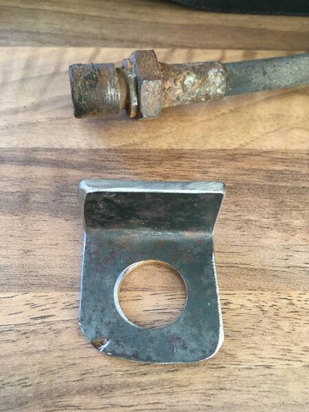

sutty2006 Posted July 27, 2020 Author Posted July 27, 2020 I’ve made a brake pipe fitting for the chassis. Had my mate drill the 17mm hole for the pipe. Welding it on tomorrow. danthecapriman, Marina door handles, Steviemillar and 5 others 8
sutty2006 Posted July 28, 2020 Author Posted July 28, 2020 Fitted. And painted. timolloyd, Skizzer, scdan4 and 6 others 9

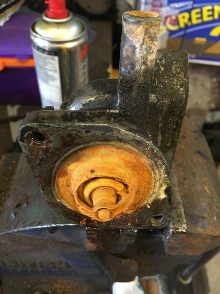

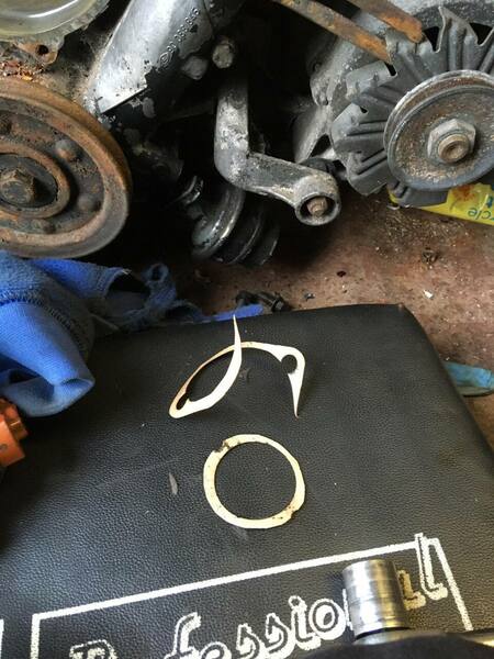

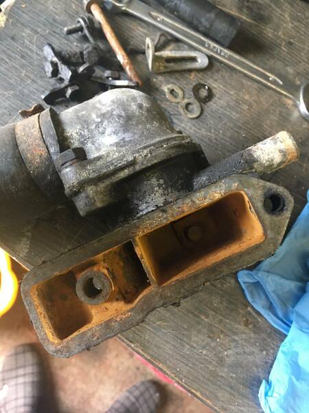

sutty2006 Posted March 9, 2021 Author Posted March 9, 2021 Not much has happened on this project. Mainly due to the car being in my unit and the landlord doesn’t want anyone up there because lockdown. But recently I was able to pick up the engine I have and bring it home to rebuild. Well, I’m not doing a full rebuild. Head and timing cover will stay put. I want to see if it runs before I start stripping it completely. This 2.0s CIH engine is early 70s, possibly from an Opel caravan or similar. I was told it’s been about a thousand years since it’s run, but it was only 50 quid so meh. I have taken the manifolds off, and apart from a bit of oil on the inlet valves (no surprise there) and the rocker cover off and the rockers look clean. It turns over pretty easy with the plugs in too. So the plan is to clean it up, replace what gaskets I can and send it in. Taken the thermostat housing off, thermotwat is brown and stuck solid. And the gaskets are shot, so a new twat and gasket is on order, along with fanimould, sump and rocker cover gaskets from Germany (which I needn’t have ordered because I found some in the shed this afternoon) ooops. so that’s all being cleaned up. while I wait for those bits, I pulled the dizzy cap off and found points. Yuk. Got an electronic dizzy in the shed of a nackered engine so I’ve put that in. Had to make a new gasket though. made from a different gasket merlin checks in occasionally and it’s in but now the struggle starts as the loom in the car is for pre electronic ignition, so I’ve either got to convert it or find a later loom. GrumpiusMaximus, adw1977, Low Horatio gearbox and 12 others 15

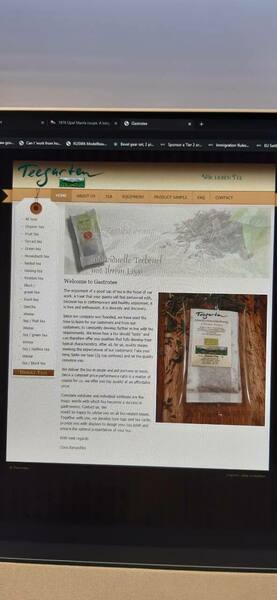

sutty2006 Posted March 16, 2021 Author Posted March 16, 2021 38 minutes ago, Skizzer said: Cherry and banana flavour fruit tea. Who knew that was even a thing? Definite ‘like’ for the Manta content. You’re on your own with the tea. Yea tasted lovely!!! I googled the company selling it but got no further due to language barrier. Teegarten.org. Kringle and Skizzer 2
Tadhg Tiogar Posted March 16, 2021 Posted March 16, 2021 4 hours ago, sutty2006 said: ...I googled the company selling it but got no further due to language barrier. Teegarten.org. Google Translate should be able to turn that into passable English
