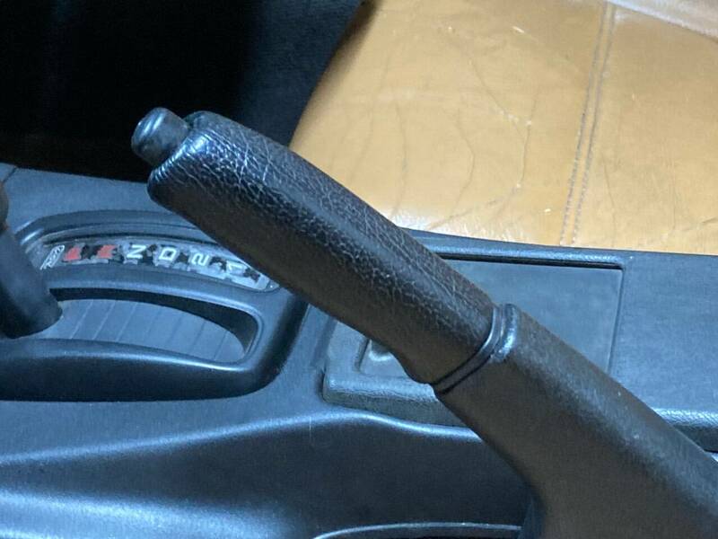

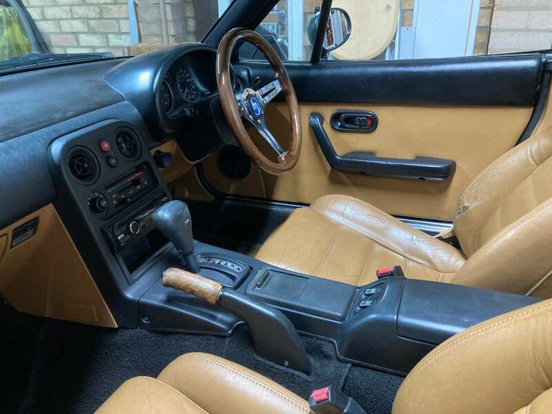

that wooden handbrake grip was looking a tad sorry for itself
a trip to the breakers and £20 later !
much smarter
ideally i would have refinished the wooden one but i’m not confident of not making a mess of it

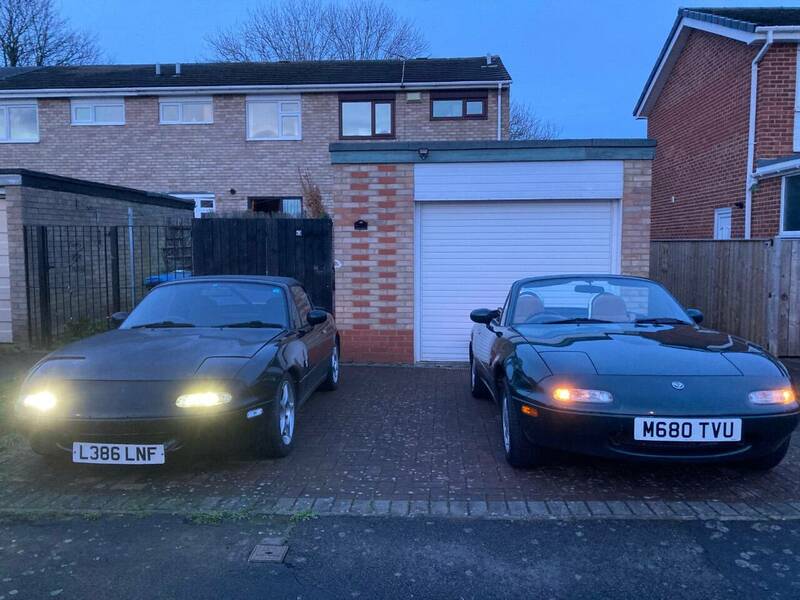

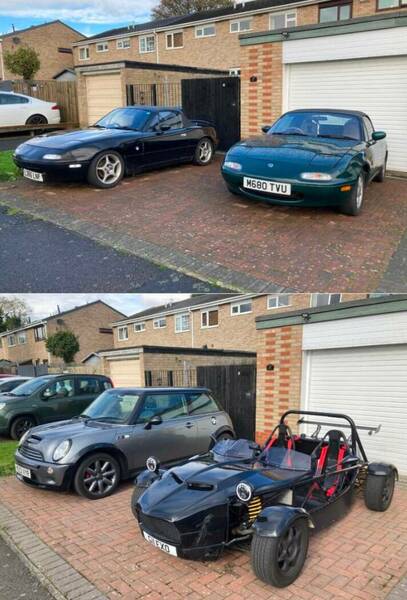

meanwhile the green monster sits tucked up patiently awaiting a new owner

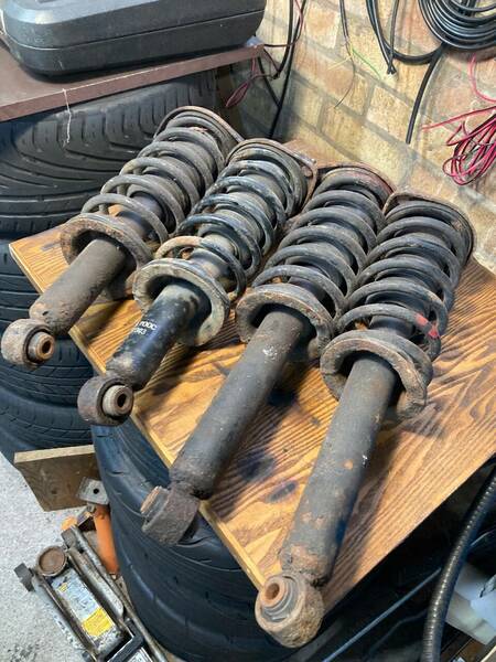

i spotted an ad on marketplace for a set of mk2 standard suspension and being as i was passing on my way to edinburgh at the weekend, it seemed rude not to.
the current suspension is just that little bit harsh
so has been replaced with

last week on the old ebay coil overs
and now as mazda intended it to look
thankfully it has settled down nicely, and the ride comfort is so much better - suits the autobox perfectly
two very different cars - but which one would you choose ?
sadly i can’t keep them both

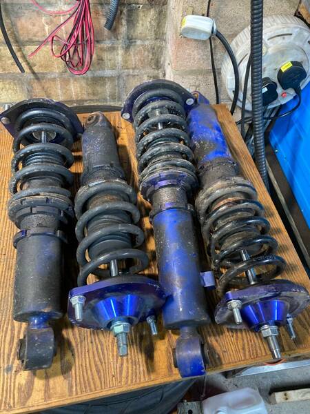

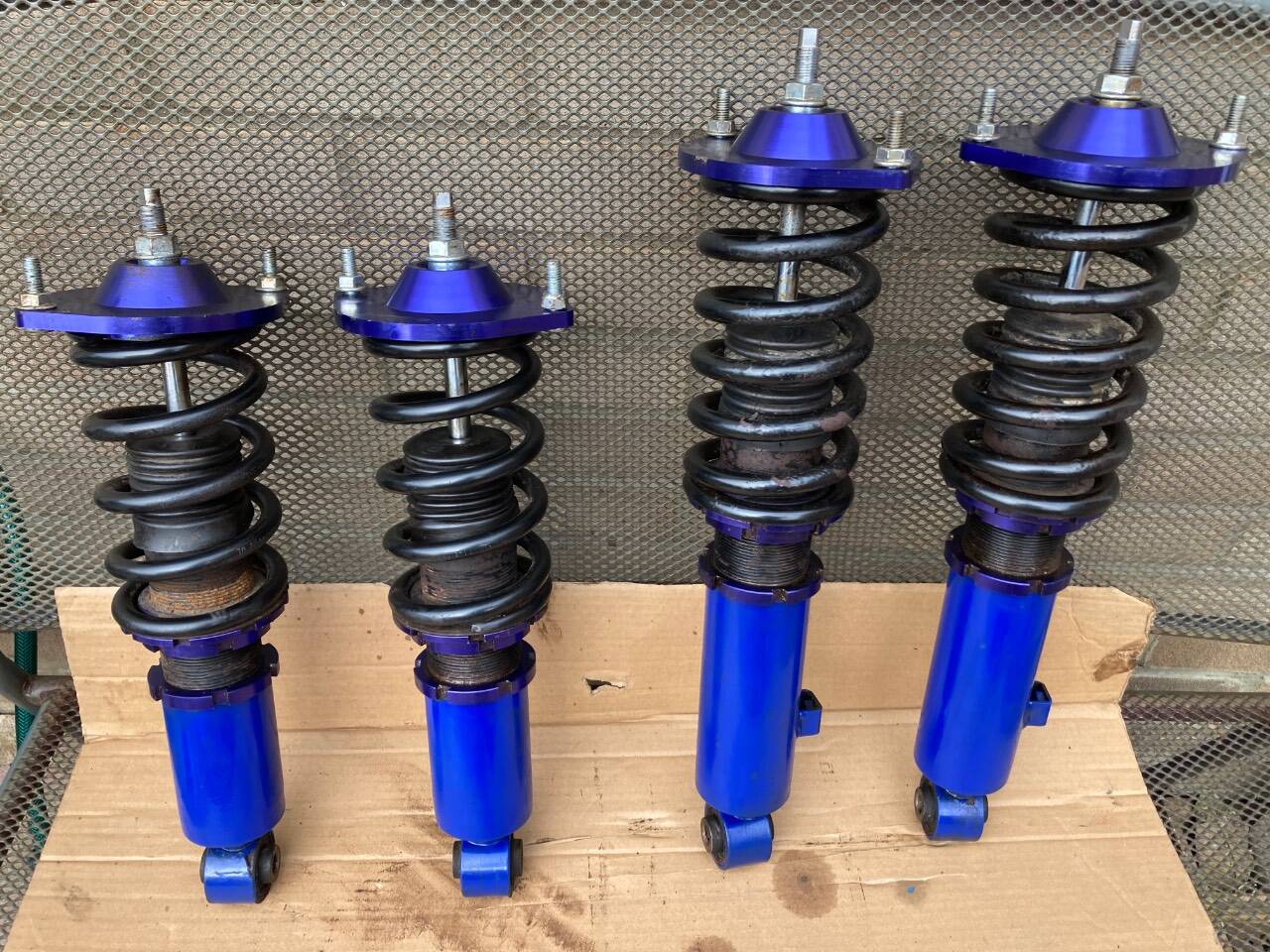

i had a go at cleaning up the manky coilovers that came off the green machine
warm water and fairy liquid did precisely bugger all so i popped out and purchased a few litres of “special organic solvent”
worked a treat :)
the downside being that what the previous owner had told me were HSD coilovers turned out to be maxpeedingrods :( the cheapest of ebay kit (i had been a little sceptical at the time)
no surprise the ride was a bit harsh.
undeterred, i stuck come photos up on fb marketplace at approx half the price of a new set and sold them within three hours !

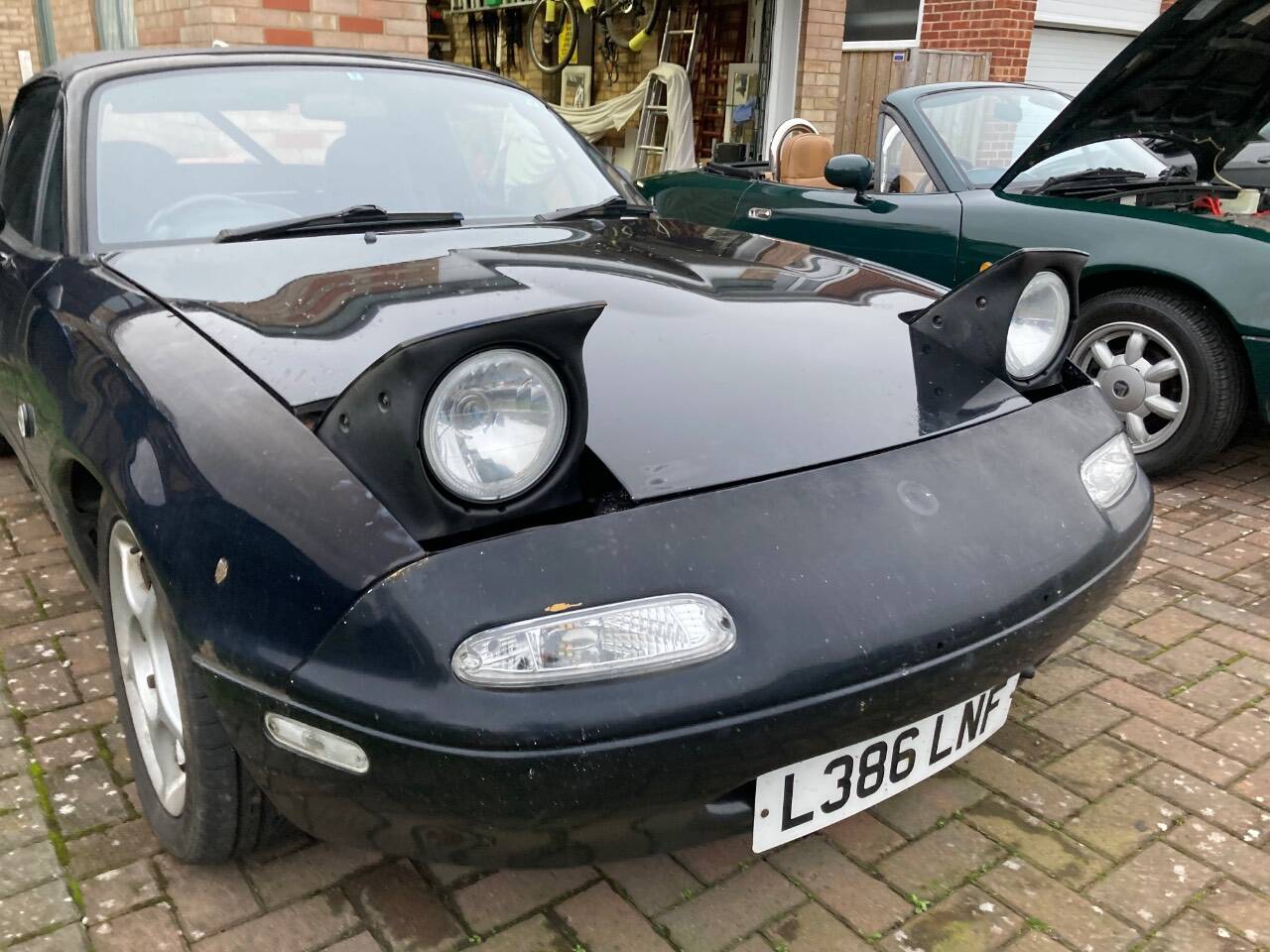

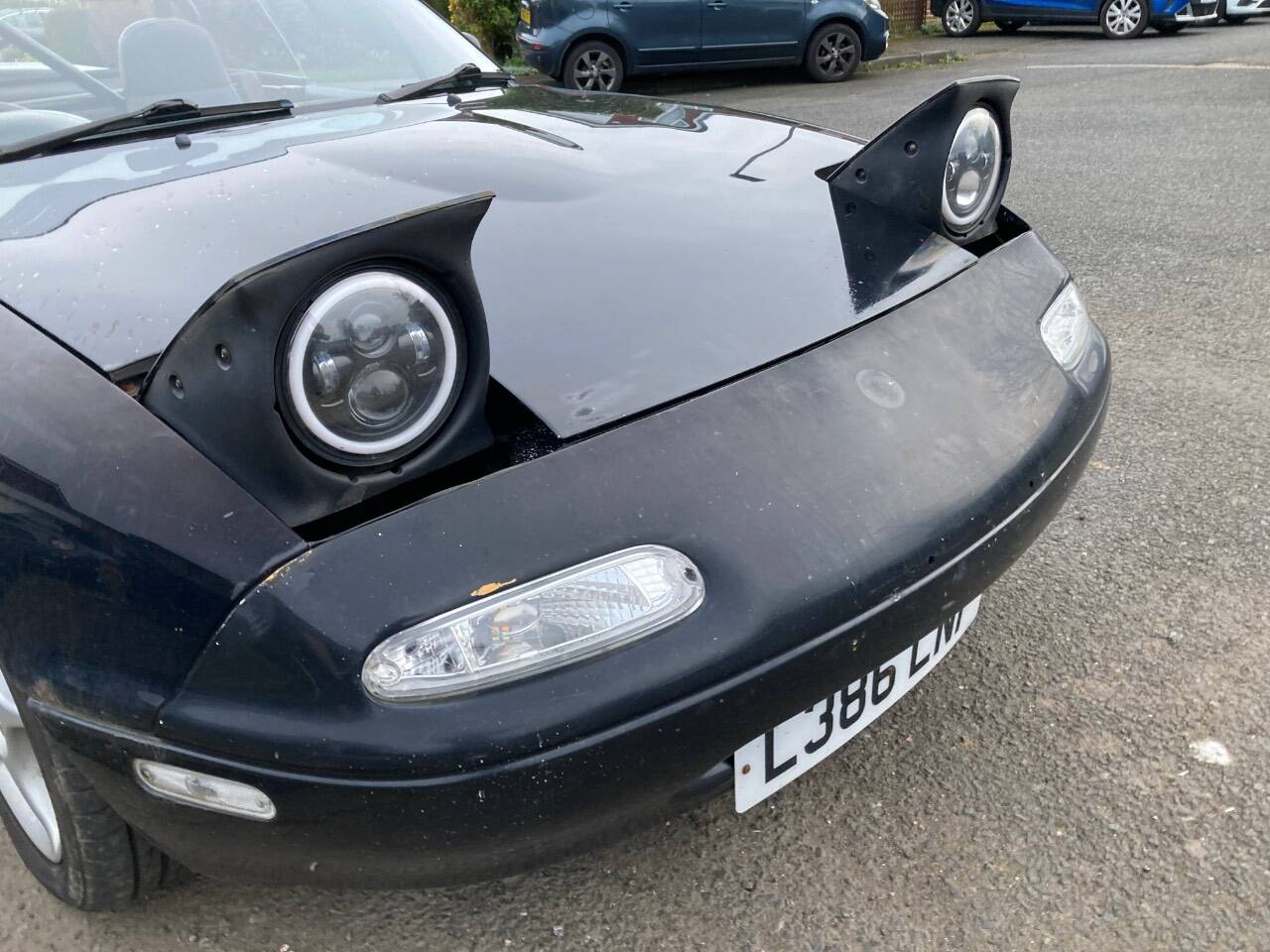

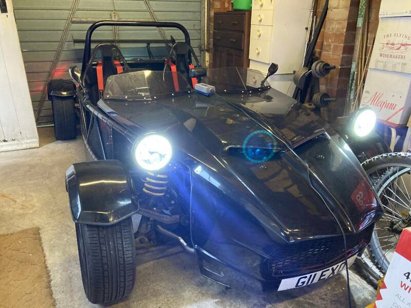

despite being marked DOT SAE my led headlights are not likely to pass an mot which is due next week
they’re nice and bright but the beam pattern is no good
so it’s back to old fashioned H4 lenses and bulbs
if that is all i had to worry about for the mot, i’d be a happy camper but there’s a patch of welding needed on the rear inner sill and a brake line needing replaced. hopefully scaryoldcortina can fit me in next week

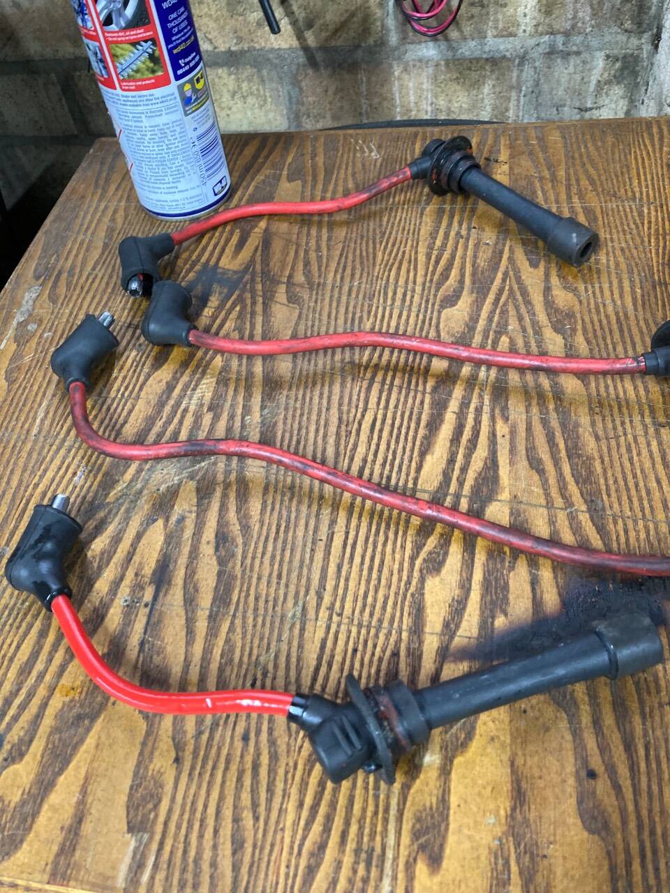

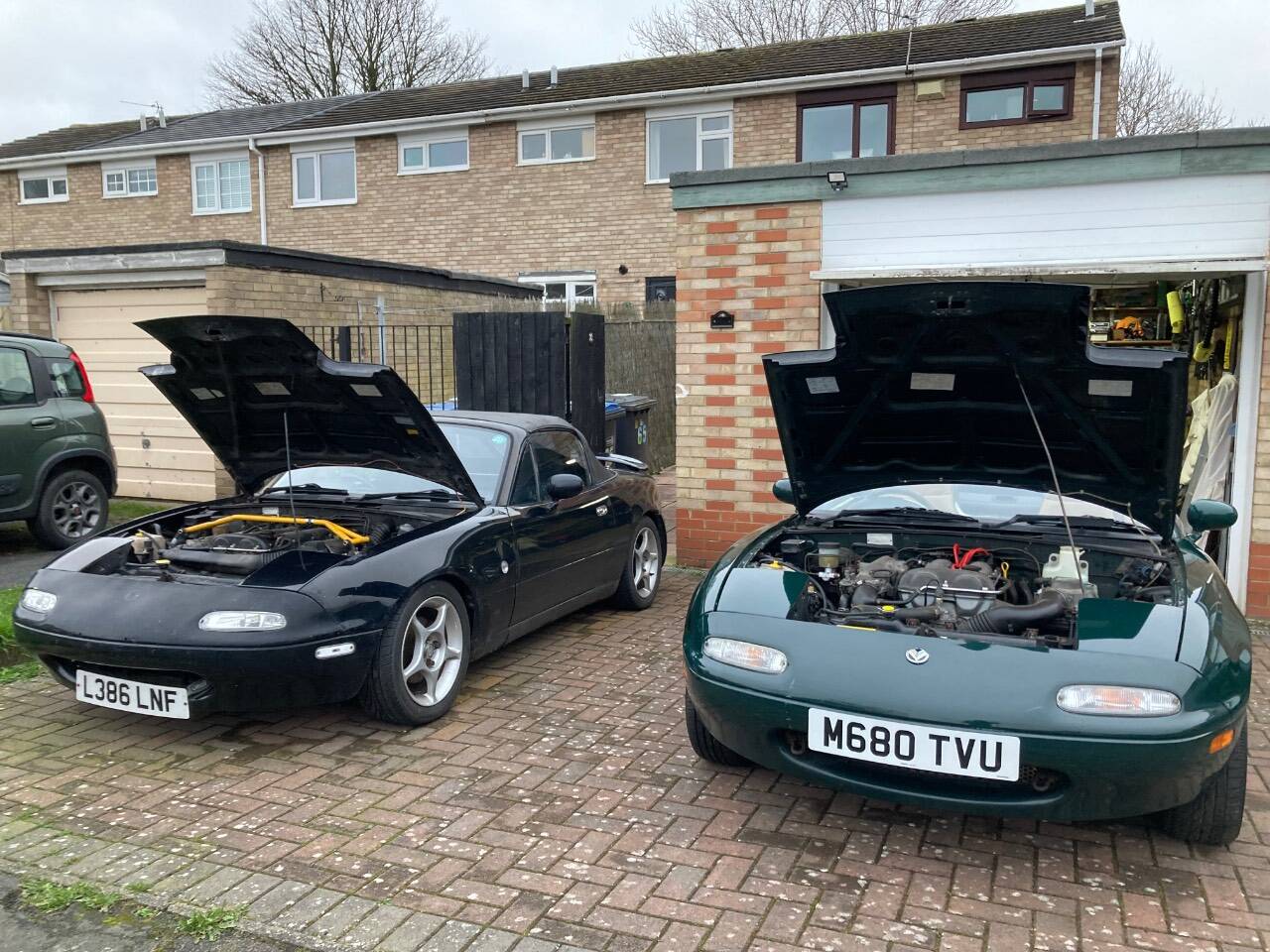

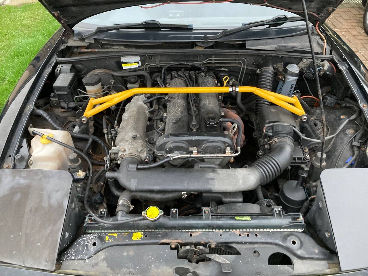

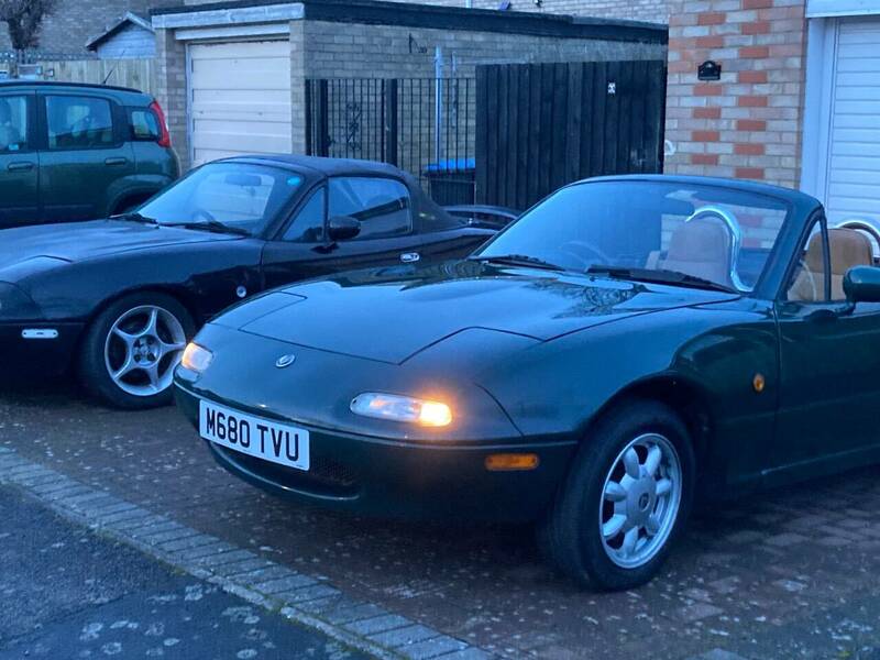

the green one was slightly hesitant at cold idle, a likely cause being the ht leads of unknown age (i’d replaced them from my stash of spares when the car first arrived)
i’ll just borrow the good ones off the black car
(note the firing order is different between the two engines)
gave them a quick rub with wd40 to clean them up
and the green one now runs perfectly
yet the black one runs just fine too (edit) like a bag of shite now :(
i’ve ordered up a new set anyway - can’t go wrong at these prices

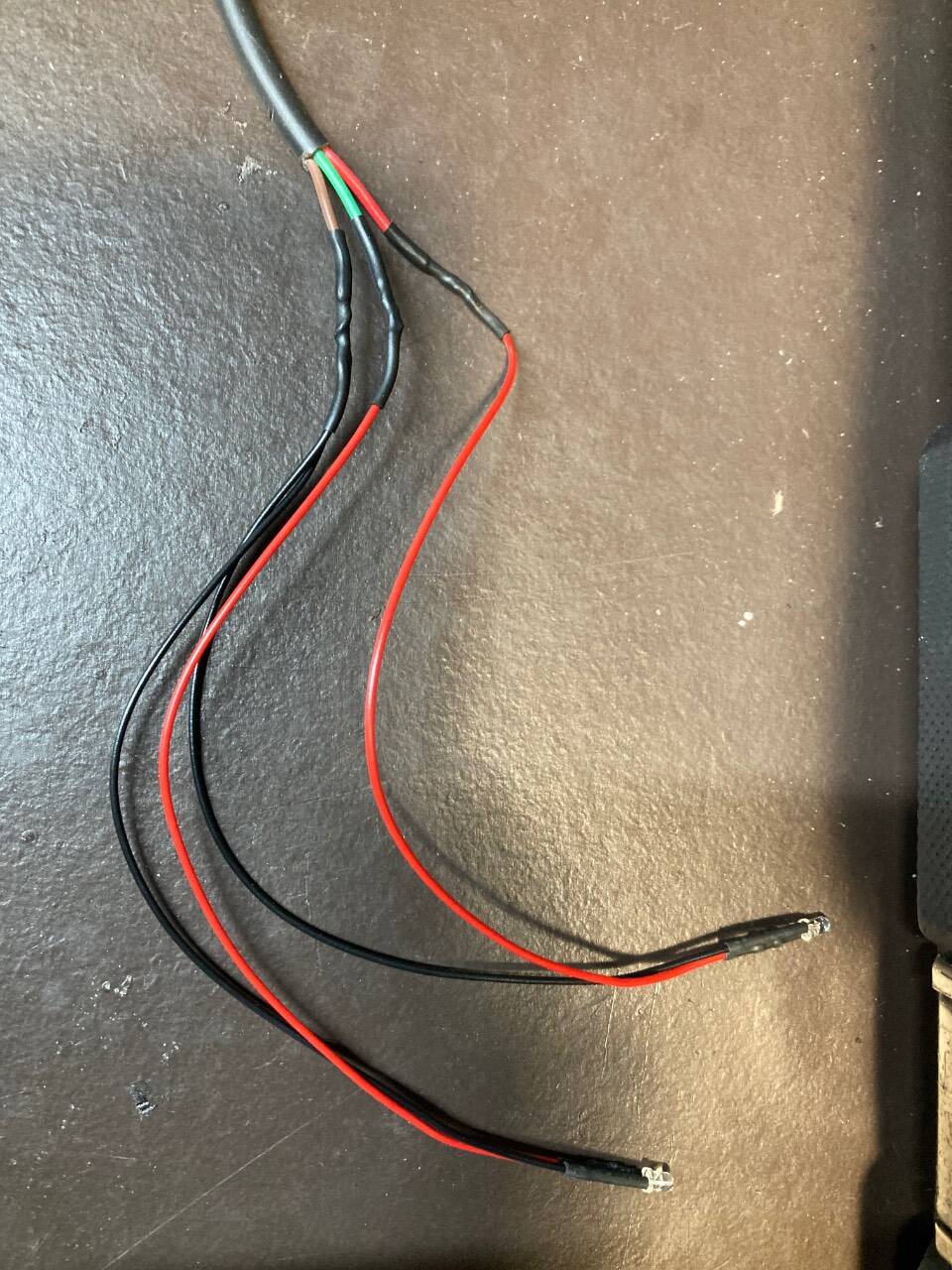

the standard steering wheel on an mx5 is about 350mm but i fitted a smaller 320mm sports! wheel. this is great but the indicators are obscured and i’ve had a couple of occasions recently when they haven’t self cancelled and i’ve not noticed :(
some ingenuity was required
no chance of not noticing these little buggers !
yes, they really are retina meltingly bright !
this is more of a prototype of something i’ve got planned for the Exo but might need to rethink it slightly :)

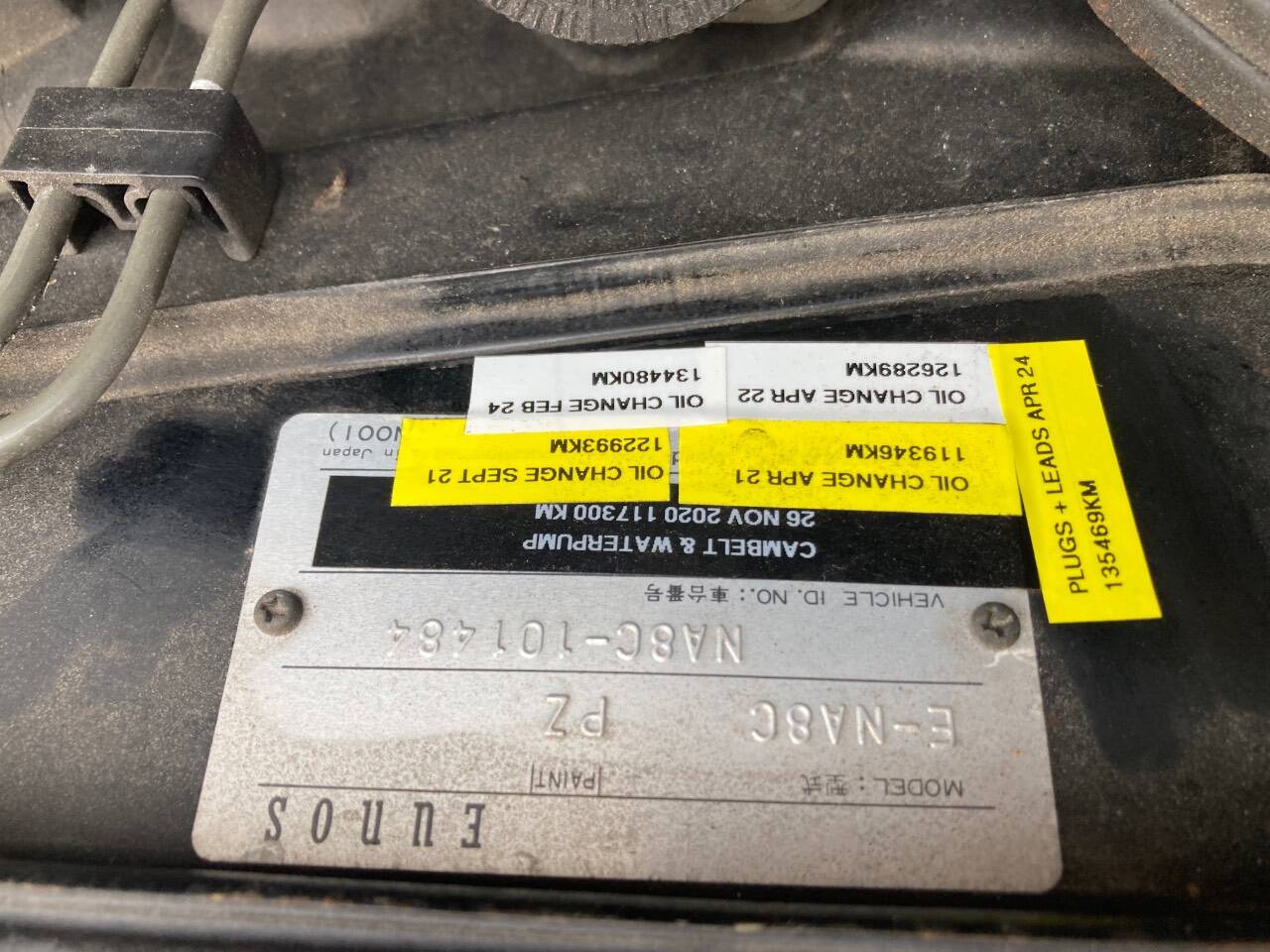

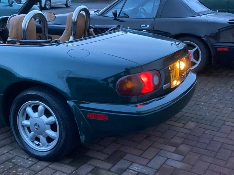

new plugs and leads on the mighty mx5, just in time to be dropped off at scaryoldcortina’s for an mot
updated the ‘service record’ and got the date right this time !

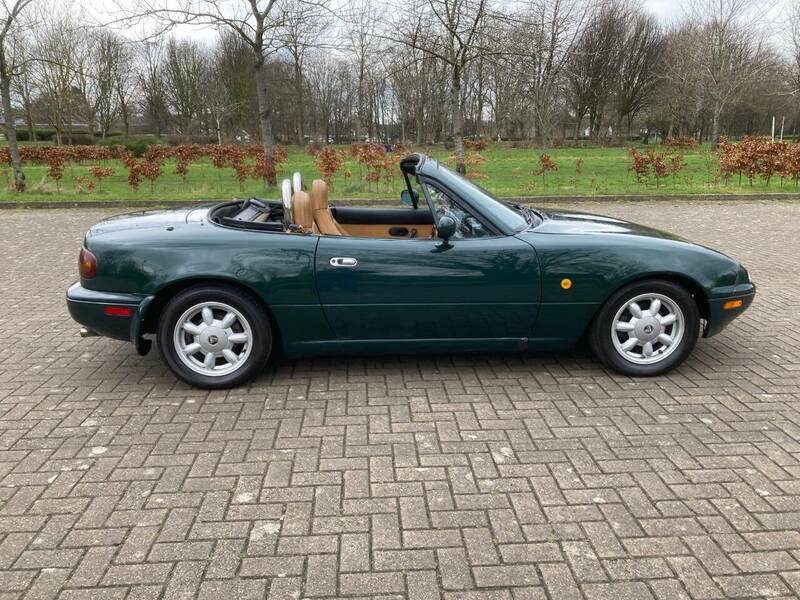

the green monster has departed to a new life with Chris in manchester
i’m sad to see it go but he was so excited when he came to collect it that i know it will be in good hands.

Do excuse the potentially stupid question, but why would the firing order be different between both MX5s ?
Not owned one of these, yet. But if they're anything like @DavidB AW11 Mr2, then I want IN.
now you mention it, it doesn’t make much sense - maybe just the way the coils are wired up ?
3 1 2 4 on the 1.6
4 1 2 3 on the 1.8

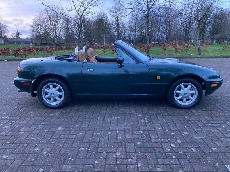

the new owner of greenie sent me this pic, he’s been out with the cleaning kit
his wife has now had a drive and loves it too :)
3 1 2 4 on the 1.6
4 1 2 3 on the 1.8
Is it a wasted spark system ? If so, the firing order could well be the same...

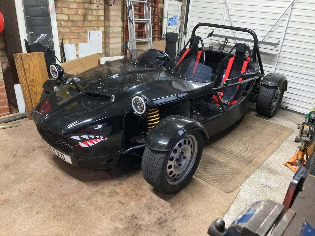

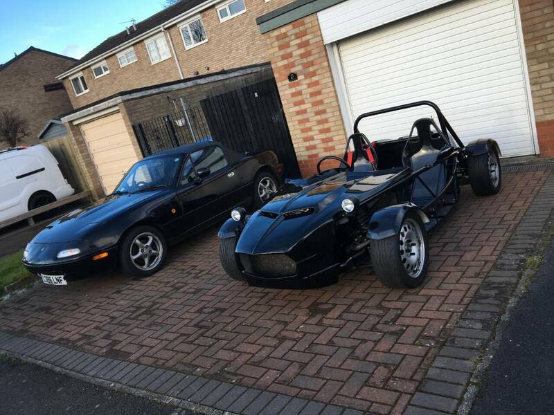

Exo has been rescued from hibernation - took a little more effort to push out of the garage for some reason
i’d suspected this might happen so had the compressor with me, a quick check of the fluids and the engine fired first time :)
a brief hoon was had but on the damp roads, the crappy chinese tyres really showed their true colours - they’ll be getting replaced asap
in the meantime i’ve refitted the steelies with semi slicks, they drive so much better than these ditchfinders

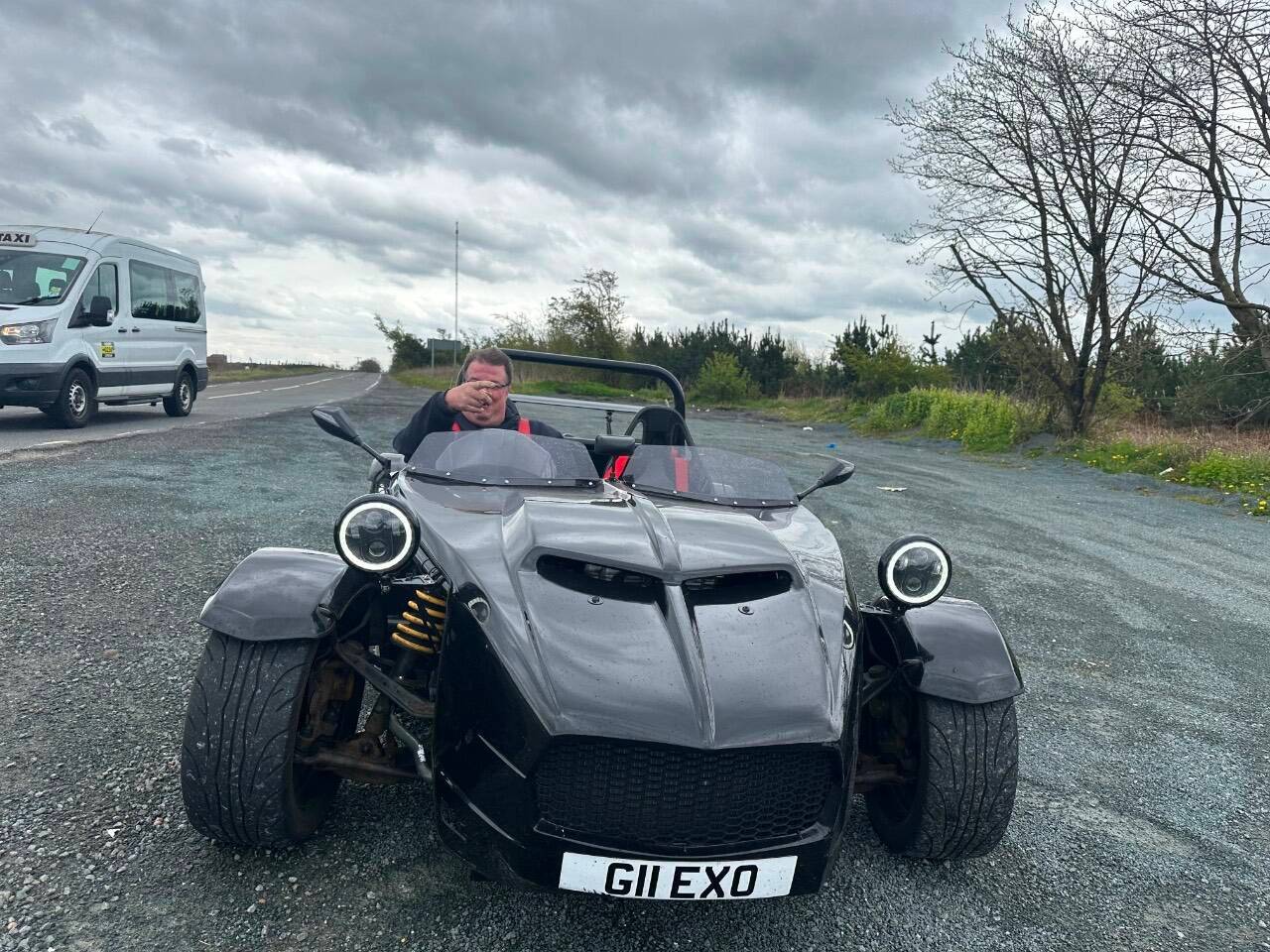

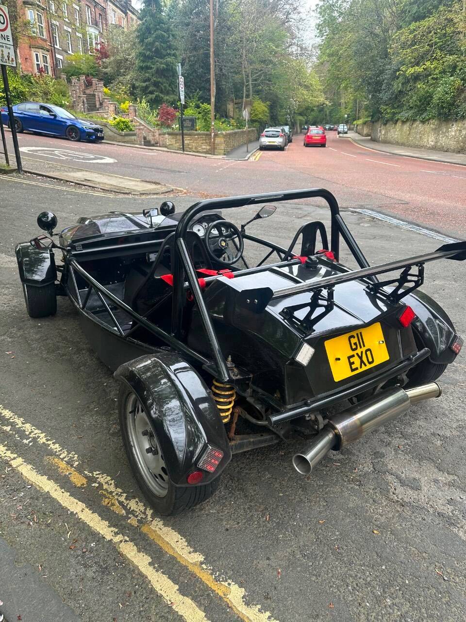

the Exo was on taxi duty yesterday collecting @NorthernMonkey from Durham station.
as i’ve not met NM before, i didn’t know who to look for - i needn’t have worried - most passengers leaving the station regarded the Exo with amusement / bemusement but when one came round the corner and exclaimed “oh fucks sake” i knew exactly who he was :)
we fannied on trying to adjust seatbelt harnesses but, as we had a bit of an audience, chose to drive down the road and pull over on a side street
harnesses adjusted, i gave it the beans ! there’s a nearby road with a hefty crest - i’m not sure but i think we may have caught some air :)
stopping at a convenient petrol station, it was time to swap seats and let NM have a go
he wasn’t in a particular hurry so i directed him onto some back roads to have some fun - i think he likes it.
some time later, we arrived at scaryoldcortina’s place for the actual collection to take place - the big blue merc in the background - must have been quite a contrast coming from the exo !

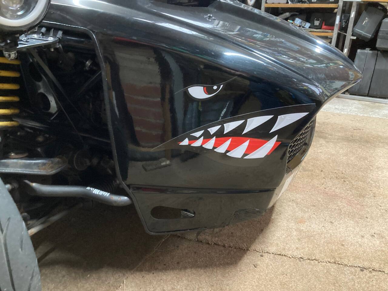

back in the garage, i found these stickers i bought a while ago
i hadn’t used them as they weren’t particularly good quality and creased from the post.
might as well try them before chucking in the bin
not as bad as i expected
they can stay on for now :)
