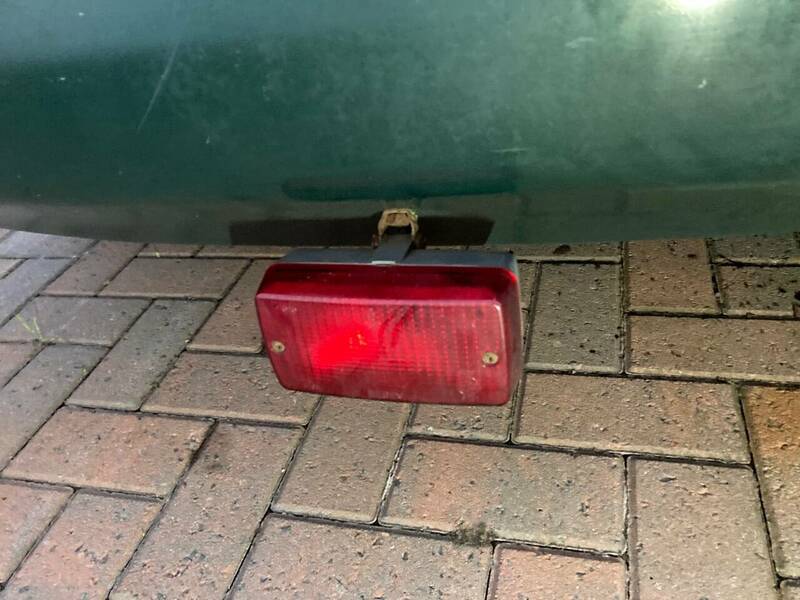

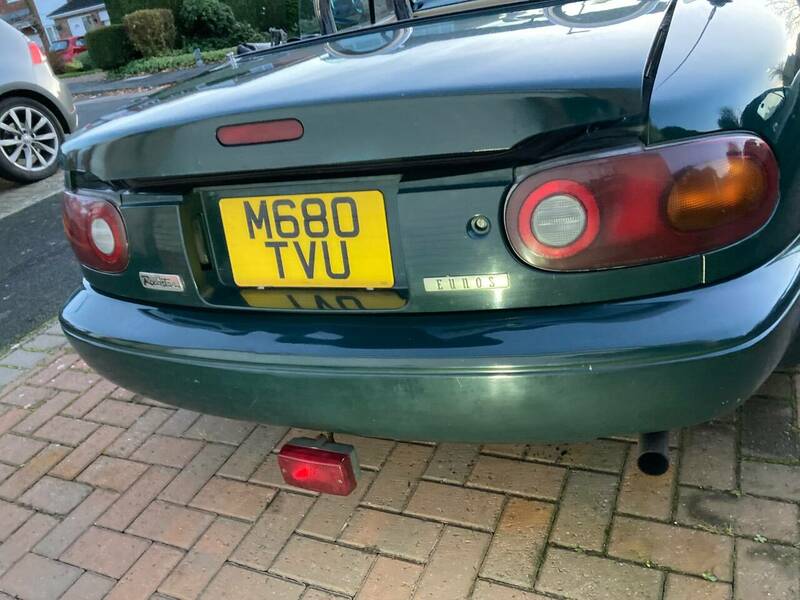

while the tools were out, i ditched the ugly aftermarket fog light
looks much neater
the wiring was rerouted to the offside reverse light
just needs a red bulb like mighty has

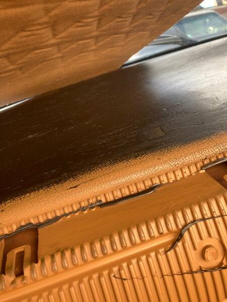

the top of the dash has been painted and was looking shabby
so i rubbed it down and gave it a quick coat of satin black.

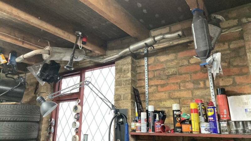

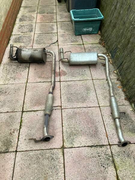

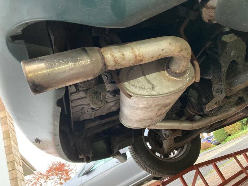

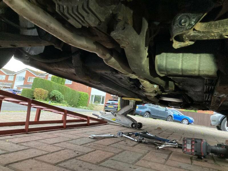

the exhaust on shitey was a bit noisey so i rolled it up on ramps and investigated
hmm, not the best
but what’s that hanging from the rafters ?
close enough (there’s a rumour that manual and auto exhausts are different, i guess that’s bollocks then)
this car is so clean underneath  :)
sounds great - not look at me mental like mighty but has a nice tone and rasp, just as you would expect

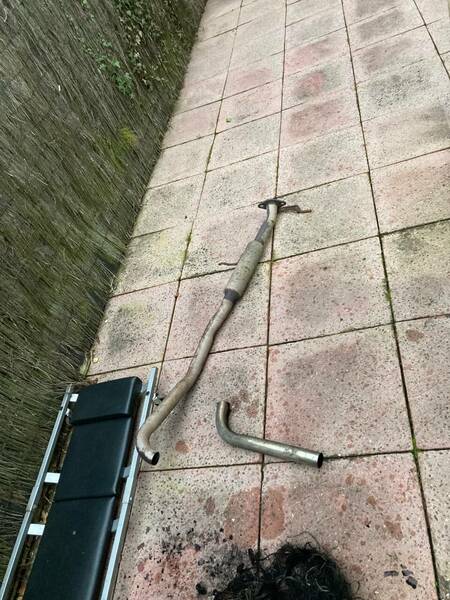

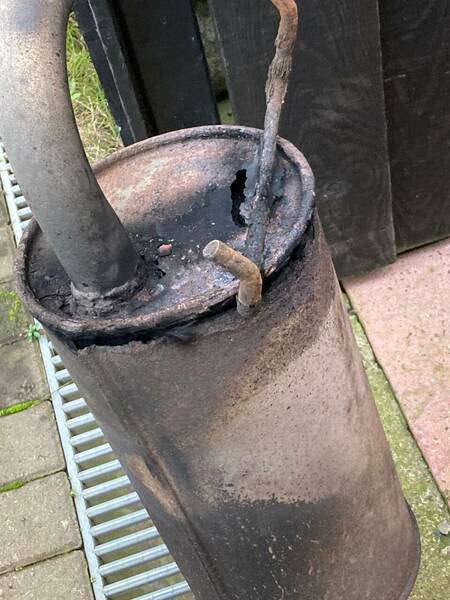

i chopped the centre section and tail pipe off for future use
and had a look at just how shagged the back box is
what a mess - i’ll drop that at the tip tomorrow

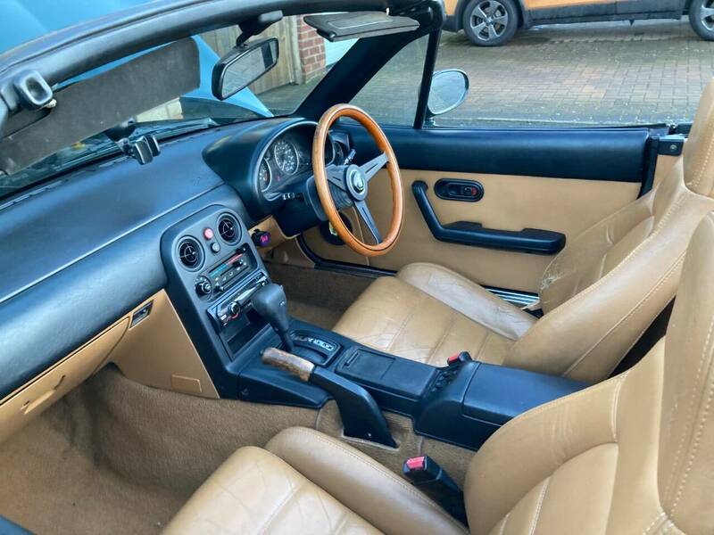

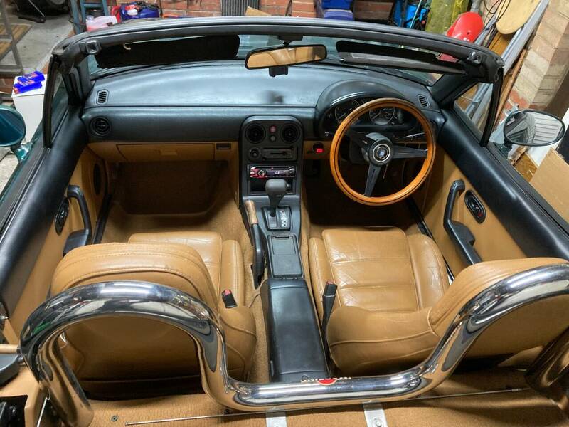

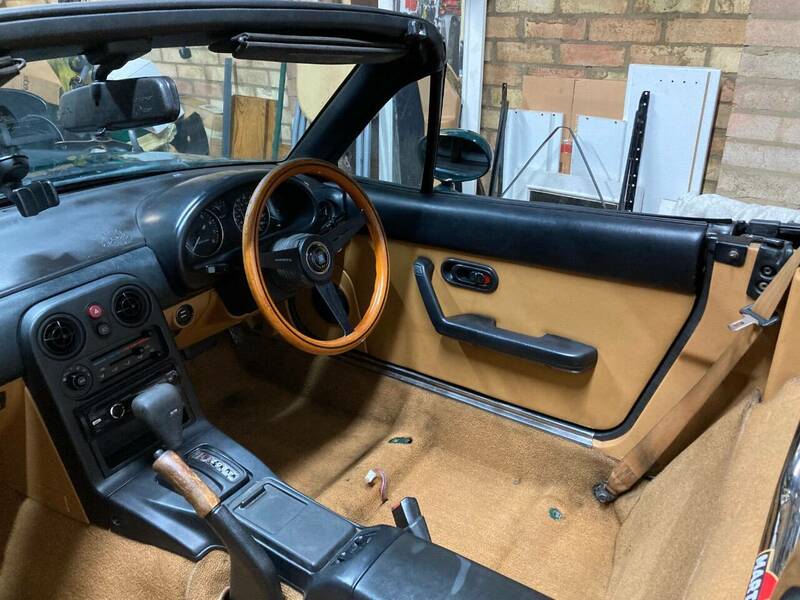

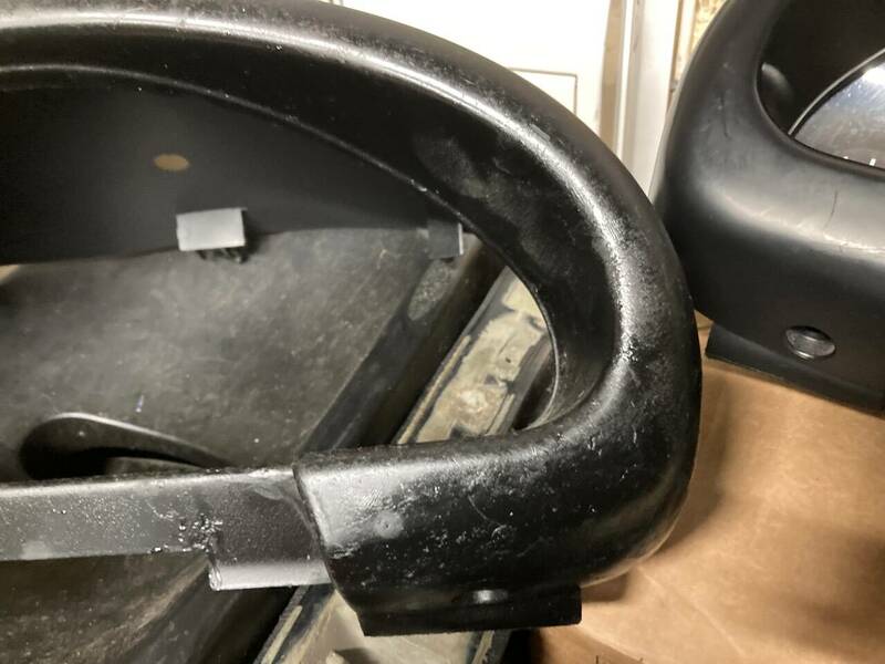

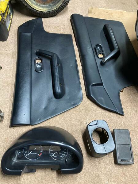

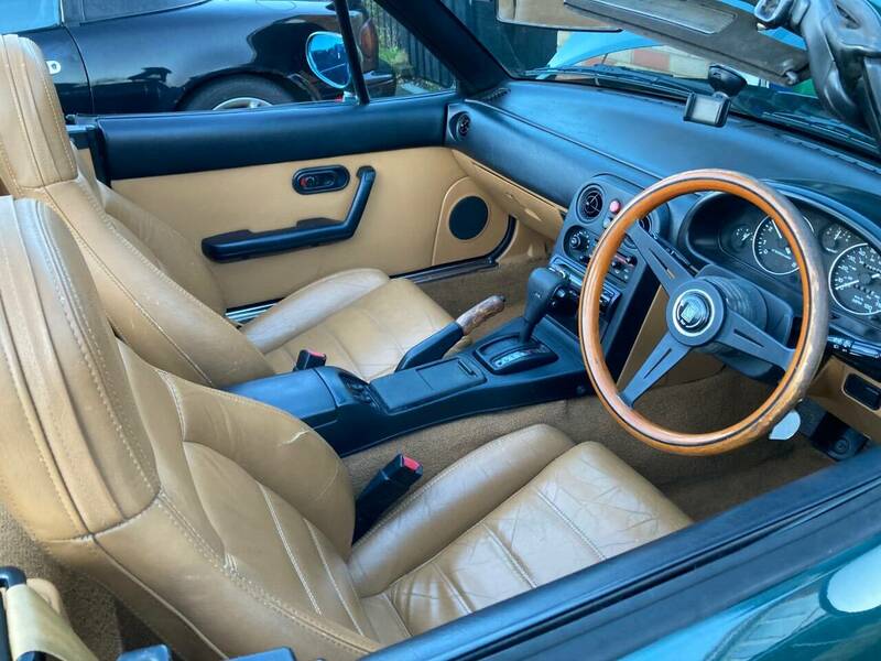

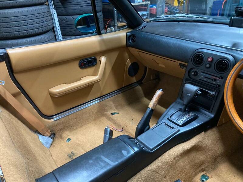

been to the local breakers and picked up some parts to tone down that tan interior
plan is to use the top section of the door cards and the handles - should look much smarter

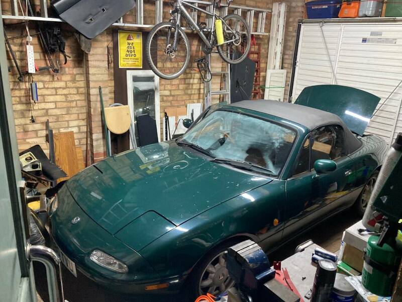

and the green machine took up residence in my own garage
takes up a lot more space than the exo :(

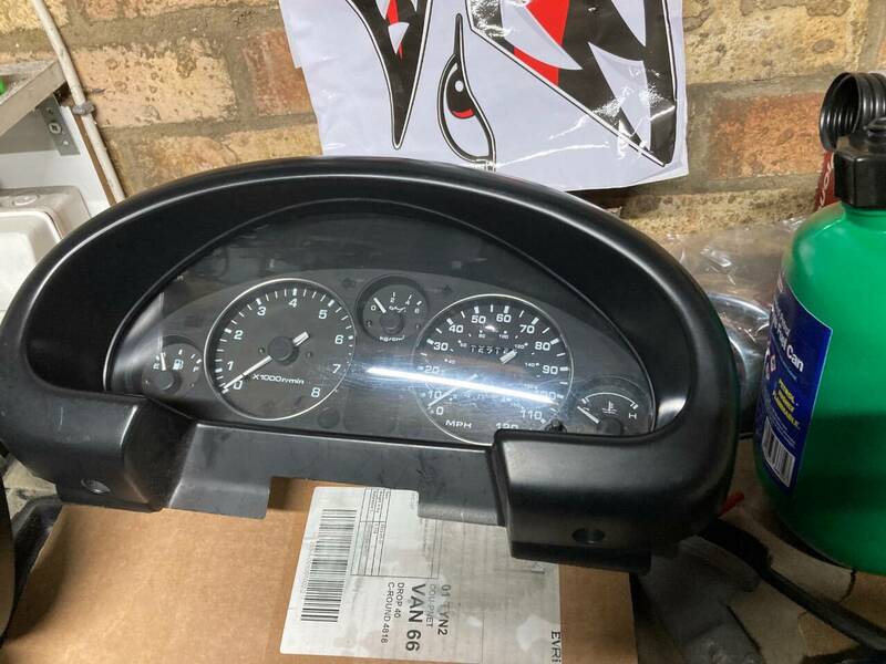

first job on green was to swap the manky  dashboard binnacle (seems to have been painted and gone sticky in the sun)
for one i picked up at the scrappies last week
time to sort out the doorcards - there really is too much beige, i used the top sections and handles to tone it down a bit
much better

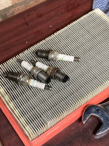

time for a quick tinker under the bonnet - new plugs and an air filter both very overdue

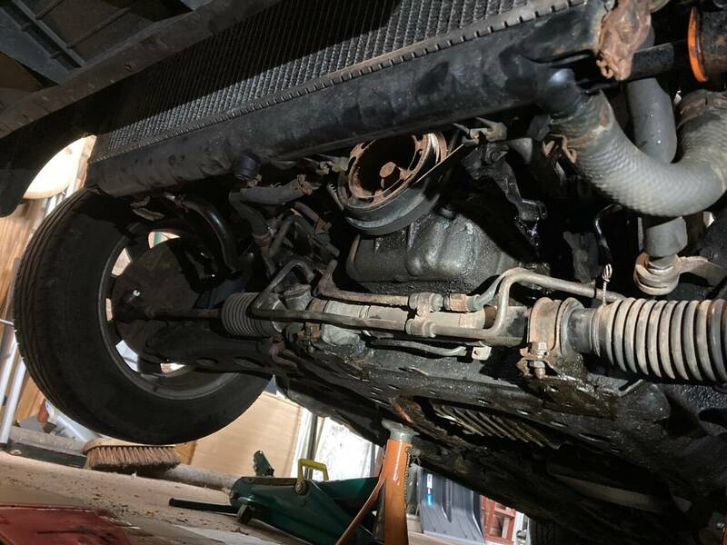

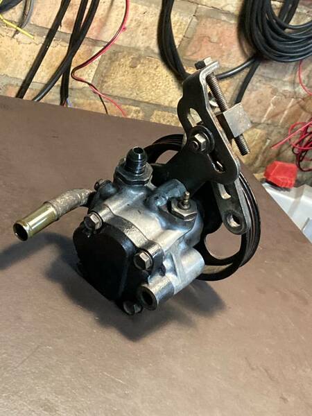

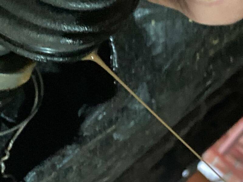

i fitted a replacement power steering pump
and jacked up the front end to turn lock to lock to bleed new fluid
bit something wasn’t quite as it should be - a sort of sloshing noise was coming from the rack :(
i pulled back the steering gaiter and got soaked in oily coffee
that’ll be where the steering fluid has all been hiding - add a replacement rack to the shopping list. at least i hadn’t just dumped a brand new bottle of fluid into it.

let’s have a look at that steering rack
yep, that’ll be humped then :(
a trip down to see the mazdadudes in darlington and £50 later, a replacement steering rack has been sourced and installed
at which point i discovered another leak in the fluid cooling pipe work :(
fortunately i had a spare from the exo donor but fitting it was a massive pain.
all done now and the power steering works perfectly

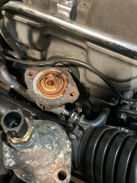

i’d drained the radiator while fixing the power steering so thought i’d give the engine a flush. this involved moving the car outside for the first time in a while

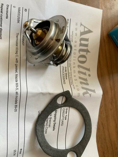

thermostat has seen better days - i’ll order a new one

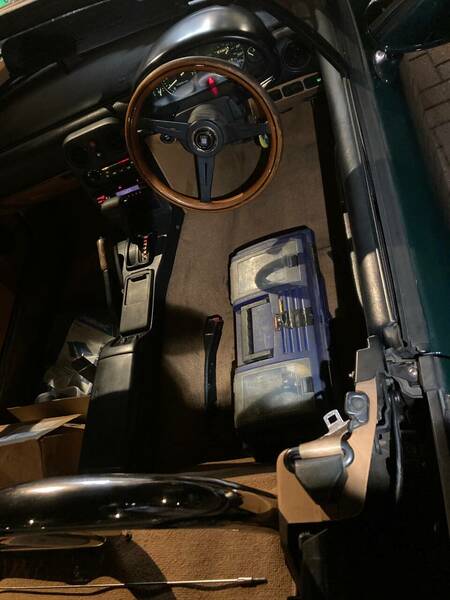

only problem, the seats are still in the house - this handy toolbox will have to do
i’d given it an oil change while it was jacked up and it’s running very nicely now, even just up and down the street, the car is lovely to drive - i’ll look forward to getting this one out on the road soon :)

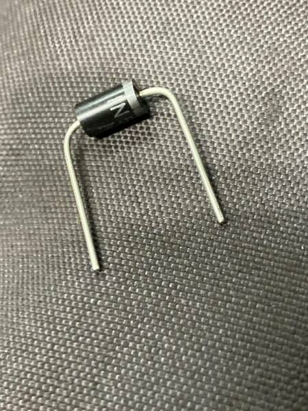

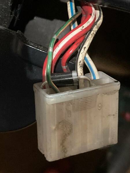

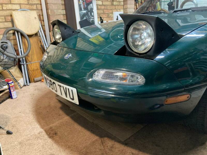

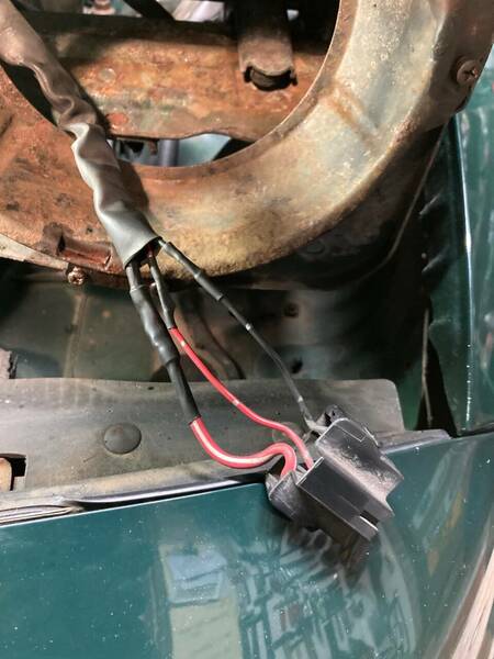

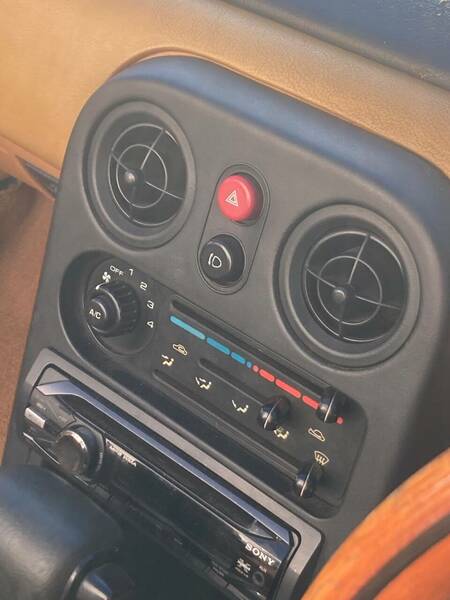

an odd quirk of imported mx5s is that when you pull the stalk to flash your headlights, they don’t automatically pop up, you need to raise them manually by pushing a button on the middle of the dash - hardly convenient.
a common solution is to fit this little guy
to the back of this connector
the red/white wire is the main beam feed, the white/black goes to the motor so when the main beam is activated, the lights will now pop up and make you smile :)
a mere 23 hours later !
mighty impressive service from Andrew at Autolink :)

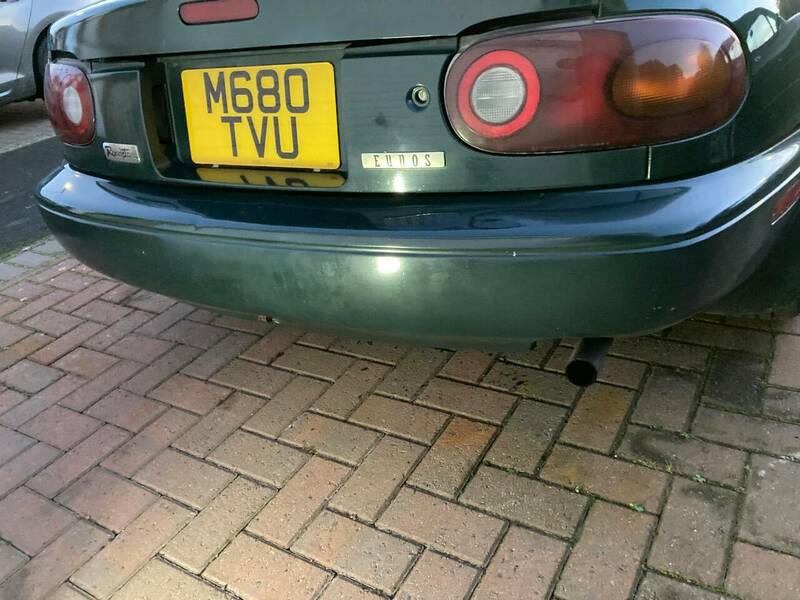

i had to enter the details manually, still not got round to sending the v5 away to get updated :)

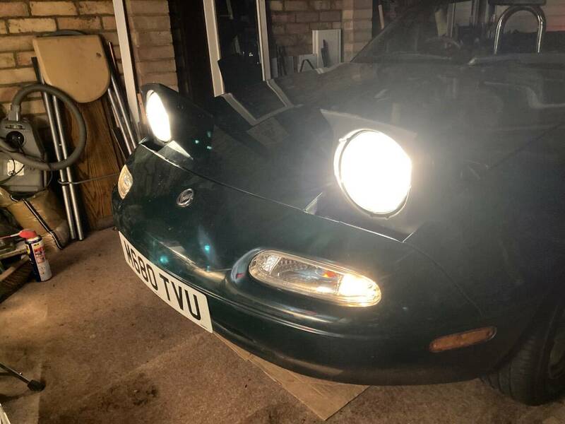

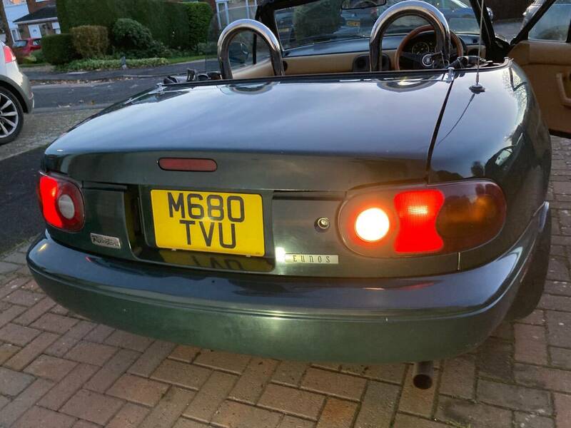

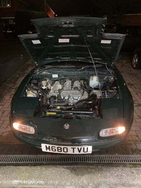

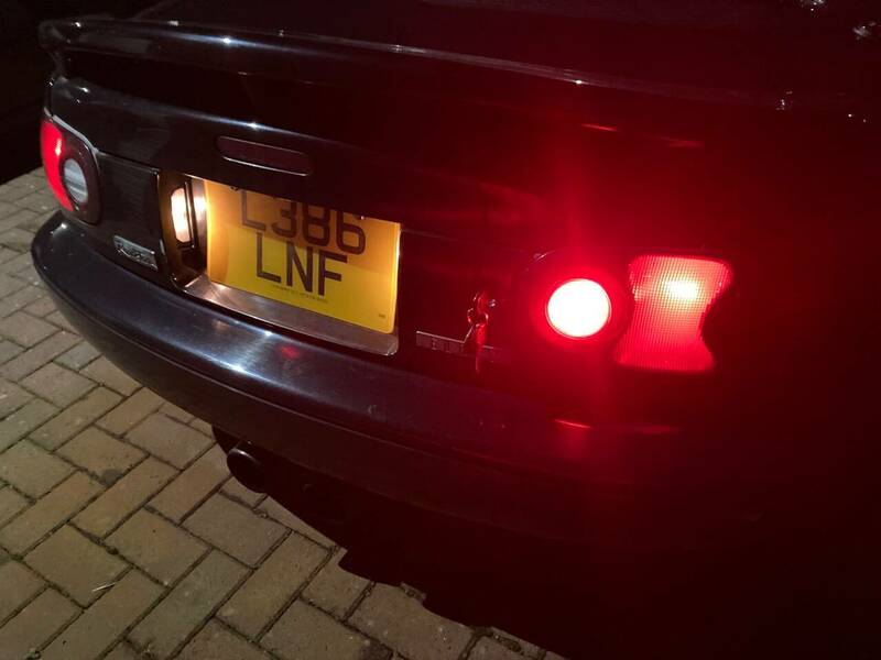

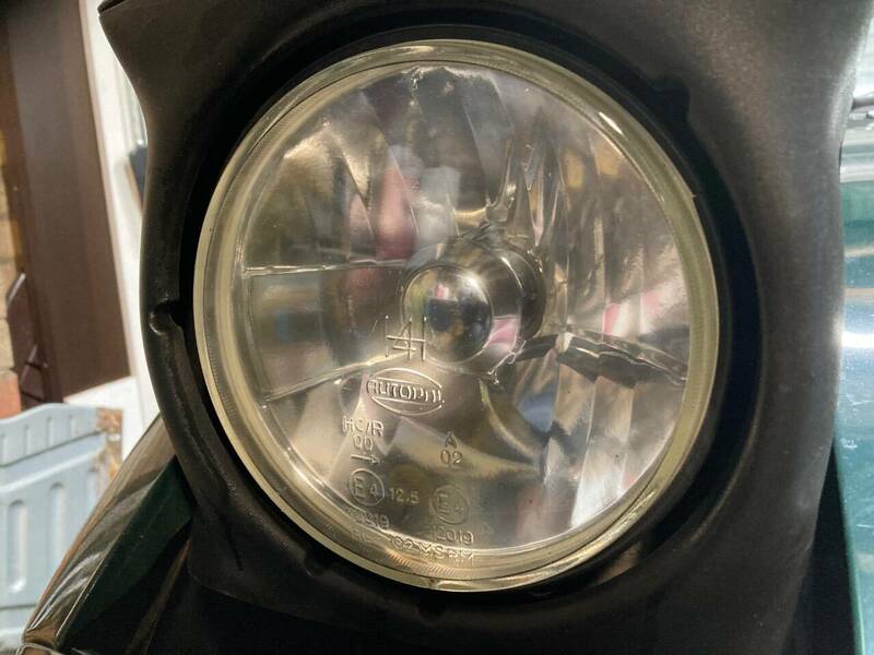

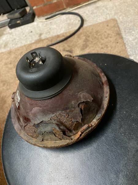

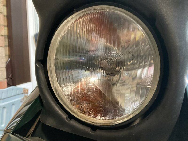

despite the thermostat arriving in world record time, i couldn’t be arsed fitting it tonight. instead, something much* more important:
oh dear, that looks just a little bit crap
yep, needs to go
the connector had slightly melted too so a spare was spliced in
that’s better
nice and bright, even with whatever cheapo bulbs were fitted
and some silliness :)
@gm Whats the number,  1N4001 ?
1N5408 Diode - Rectifier - 3A 1000V
i bought a pack of 10 off ebay
https://www.ebay.co.uk/itm/121493725507?mkcid=16&mkevt=1&mkrid=711-127632-2357-0&ssspo=9hOxI6nZQ-6&sssrc=4429486&ssuid=LKn5X0MqTxu&var=&widget_ver=artemis&media=COPY
let me know if you need one, i can bung one in the post

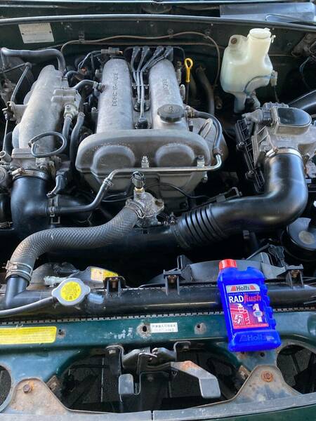

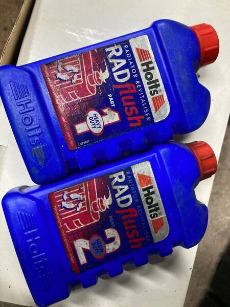

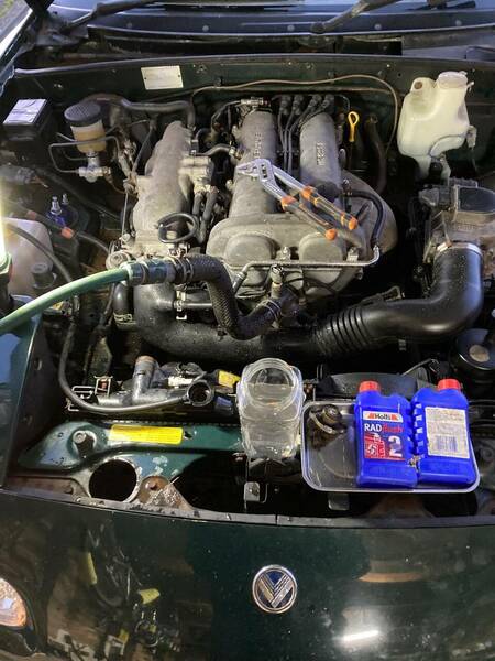

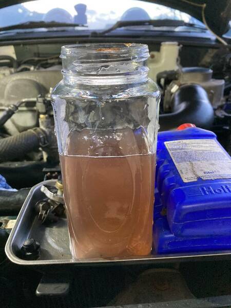

as the rain had stopped and my head was no longer thumping from too many festive pints last night with @DVee8 i had a go at doing a radiator flush on the green one
these bottles of snake oil have been on the garage shelf for quite some time, i hope they still work

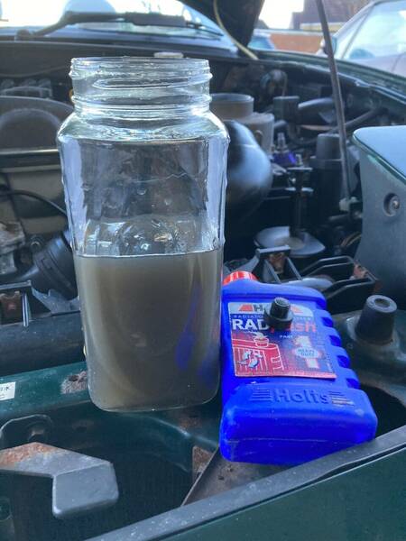

step one - empty the system and flush with water
step two - bung in bottle one and run at fast idle for 30 mins

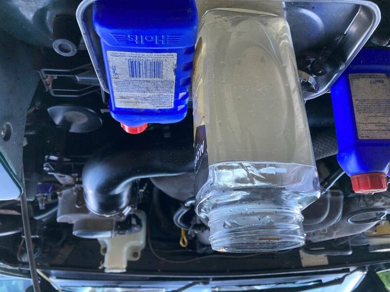

step three - empty it out and try not to scald yourself
minging !
step four - refill with fresh water and run for a further 5 mins
drain it all out again
step five - bung in bottle two and run for 15 mins then drain
step six - refill with fresh water and run for another five mins, drain then flush with the hose
step seven - drain it all again and finally fit a new thermostat and bung some coolant in.
a quick test drive up and down the street and all is well, no leaks and lovely fresh coolant in a nice clean radiator :)

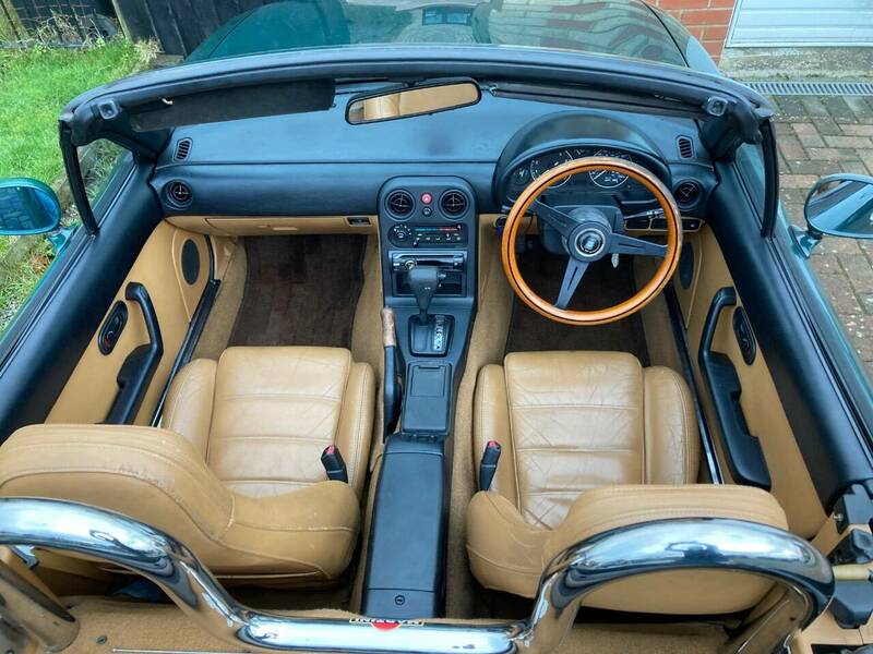

while i had a bit of spare time, i refitted the seats
that toned down interior looks great :)

great call on the interior - love how they look in half and half. people don't realise how easy it is!

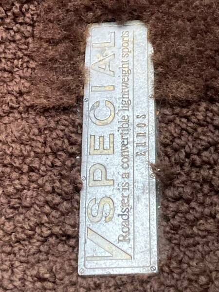

with the interior of greeny tidied up,  it needed a pair of genuine eunos v-spec floor mats
which were donated several years ago by @loserone from his old v-spec
they really do look smart
