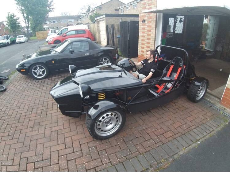

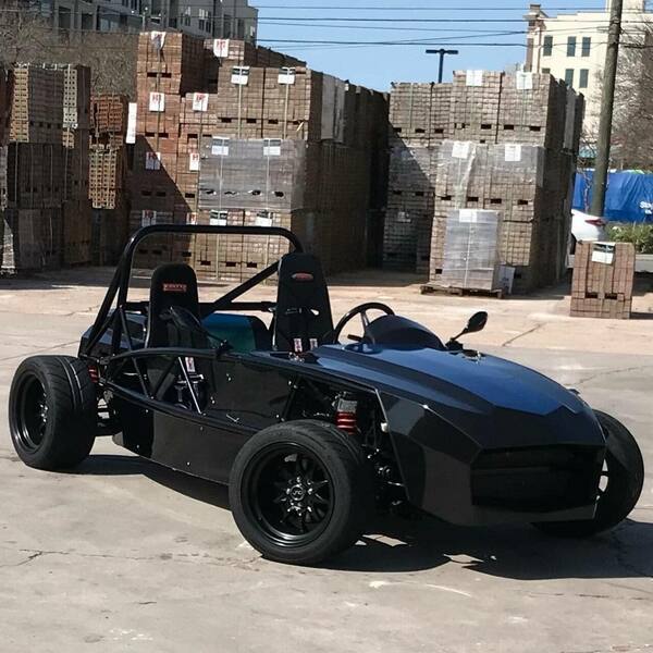

a rather smoll kit car appeared on the Exo fb group
which was modelled on this beauty

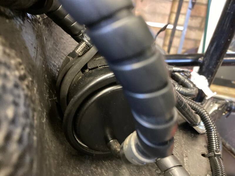

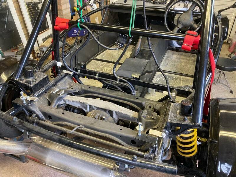

the T piece that links the rear brakes to the central line needs to have a locknut or loctite applied - sounds easy enough but it's sandwiched between the fuel tank and the differential - this is not going to be easy :(
this is the little sod
and this is what i had to do to access it
THIS DOES NOT FEEL LIKE PROGRESS :(
I applied loctite AND used a Nyloc nut - best to be sure :)

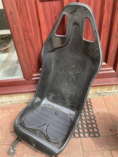

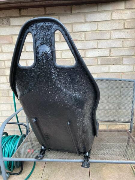

and for a nice easy job to make up for it, i gave the seats a wash
that’s better

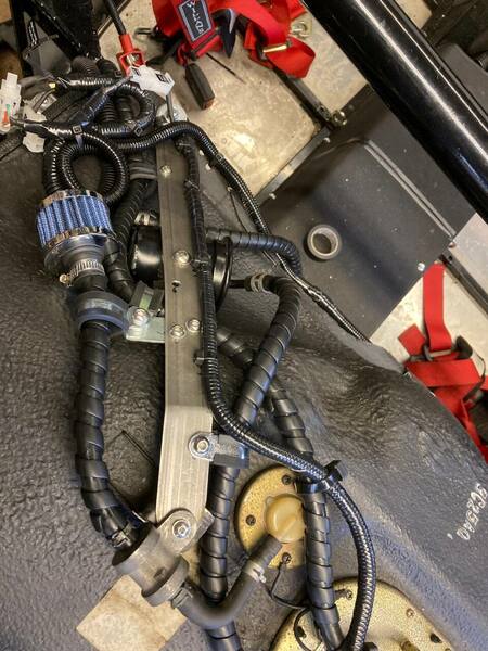

my original set up of the fuel tank had several issues that needed to be dealt with

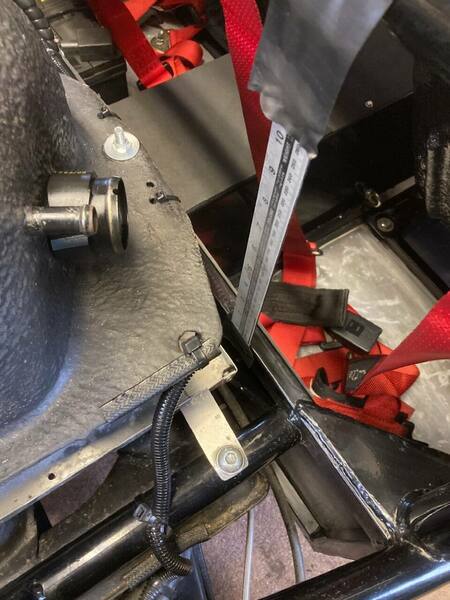

first off, i needed to make it level so the sender gave a true reading - the rear was already raised, i just did the same with the front
the tester wasn’t happy with my bare metal P clips on the fuel hose (even though it has a tough plastic wrap)

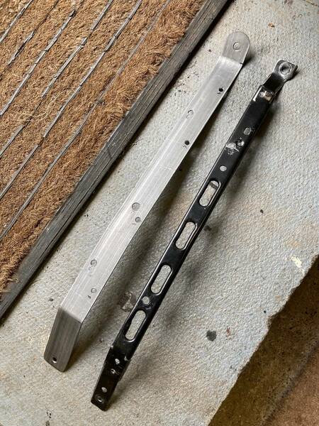

and i wasn’t happy with the bracket everything was fitted to - a suitable replacement was made
the fuel filter was held in place with a (fairly hefty) cable tie which wasn’t up to scratch, a rather large P clip was sourced and bolted in place
all of which should hopefully satisfy the man from delmonte

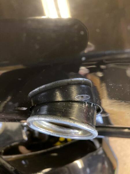

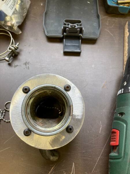

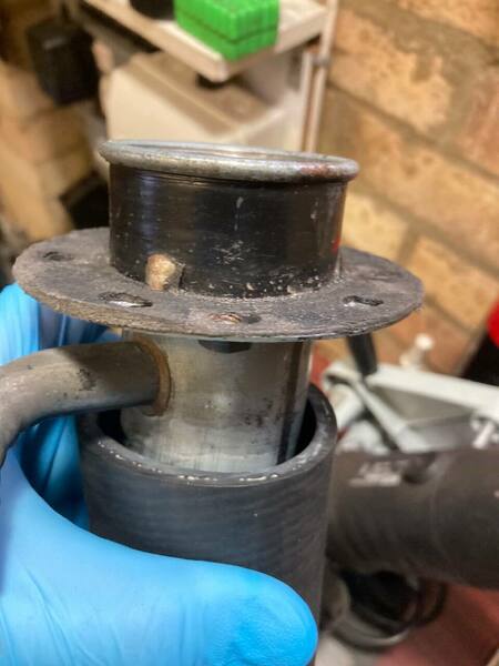

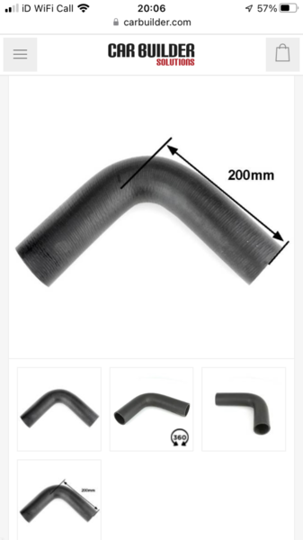

but the big problem i have is this
the fuel filler and vent hose need to make a tight 90degree bend to reach the filler neck
the flexi i had used was too flexible and ended up kinked, the original rubber pipe from the mx5 isn’t flexible enough
so what i need is something like this
which is the best part of thirty quid and not guaranteed to fit !
time to take a wander round the scrappies and see what i can find
(the internal diameter is 49mm if anyone has any suggestions ?)

hell, it's only money - I've ordered one of the above, hope it bloody fits !
I’d weld on a tubular bend to that filler neck to negate the need for such a long rubber section.

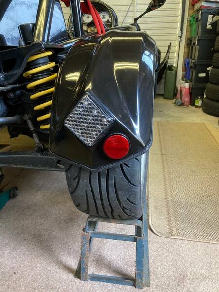

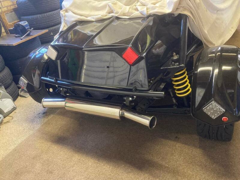

the reflectors supplied as part of the kit were deemed “too wee”
ebay to the rescue - they look shit but might accidentally fall off after the test

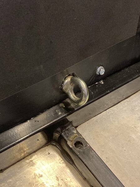

the harness bolts needed to be loctited

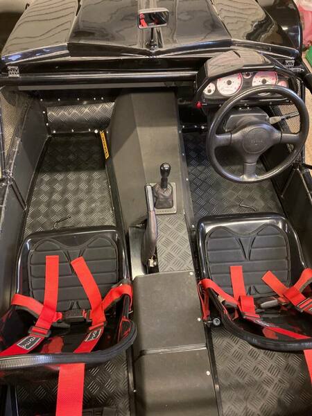

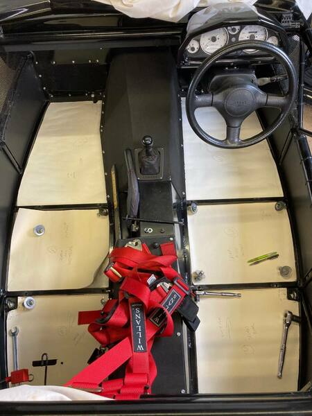

amd while the seats were out i gave the floor a wash
still pretty manky- i think i’ll order up some checker plate rubber.

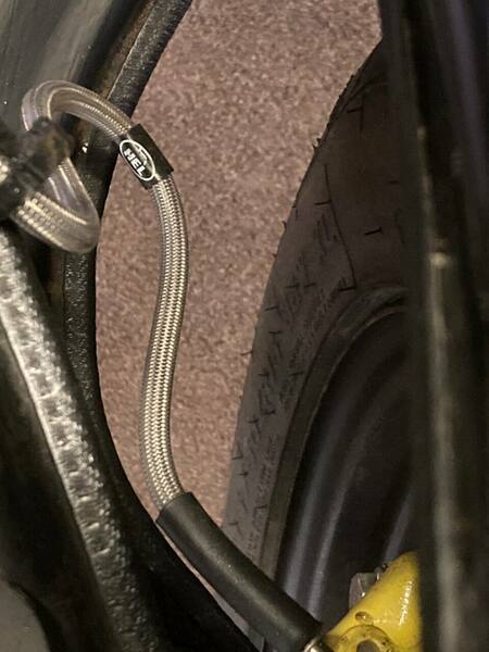

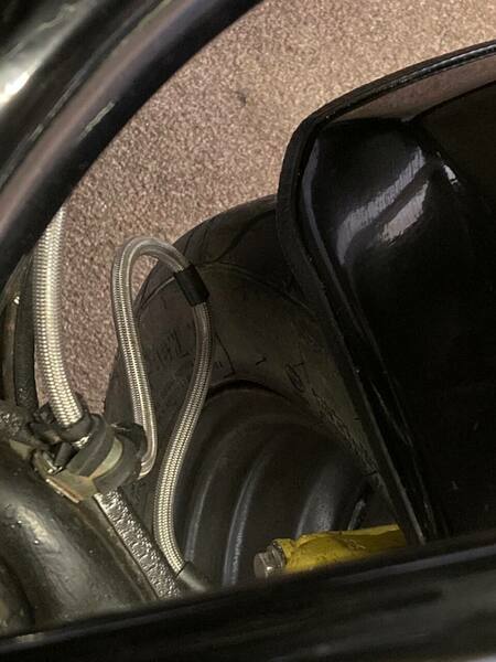

next up - this brake flexi is perilously close to the tyre on full lock
an easy enough fix

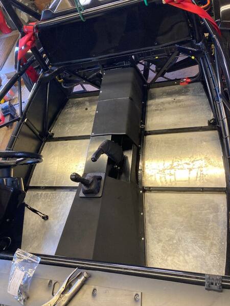

i rather liked the look of the bare aluminium floor but it got trashed by snow/slush/grit/whatever on the way to the test centre
and was slippy as a bastard when wet
i gave it a good clean up but it still looked shit

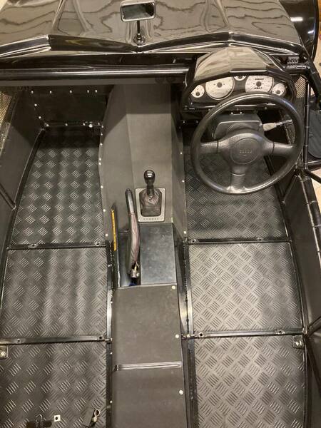

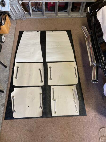

time for some “wallpaper aided design”
which took way longer than i expected
i ordered a big sheet of checker plate rubber
didn’t leave much room for error  - measure twice etc
what an improvement! looks so much better
but as that took about four hours, they can get stuck down tomorrow

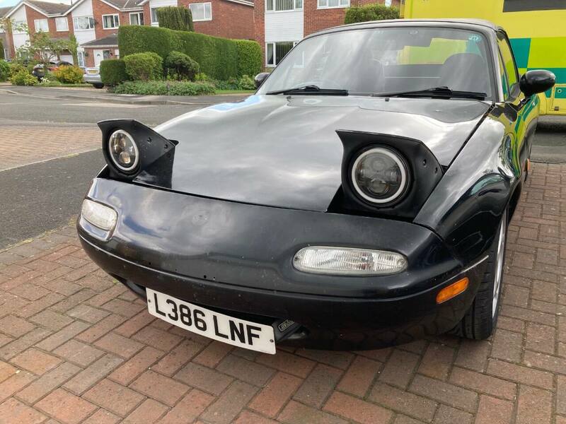

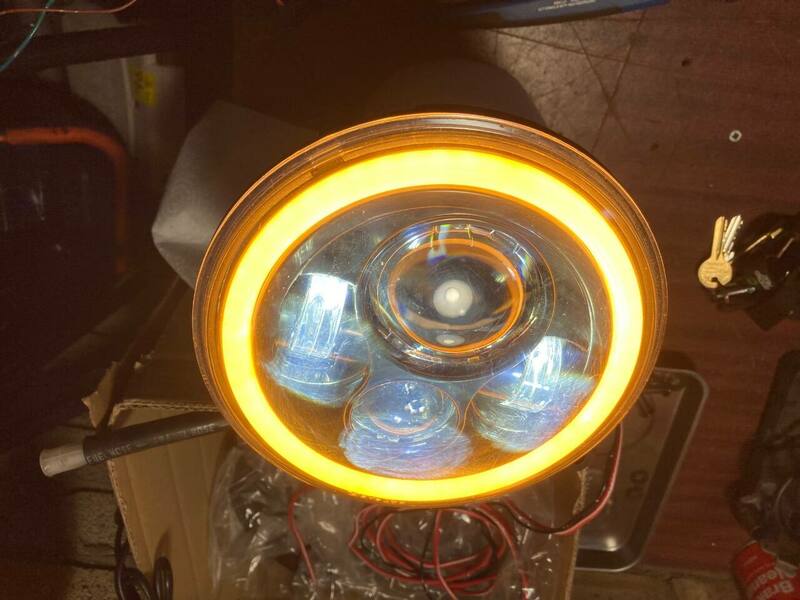

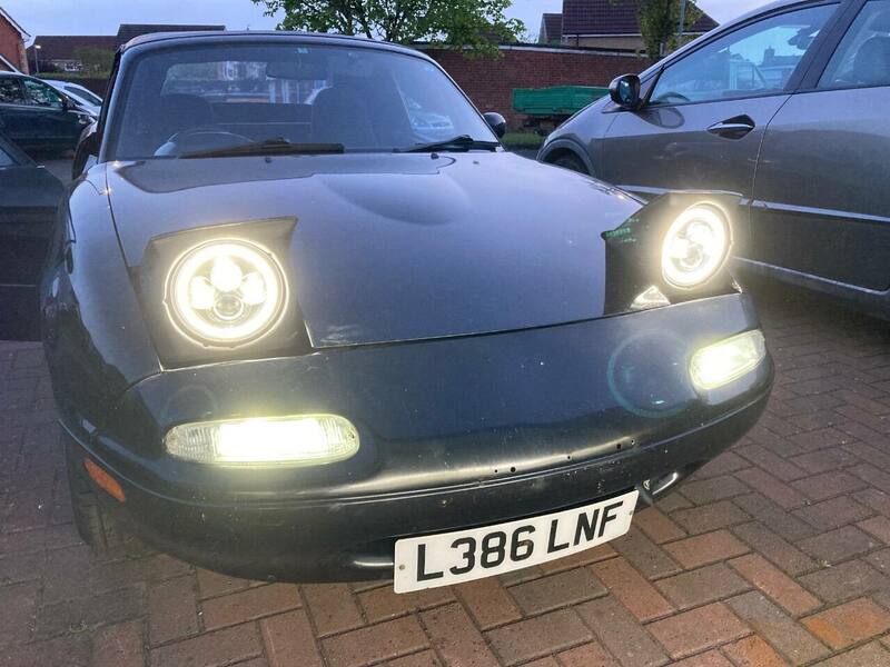

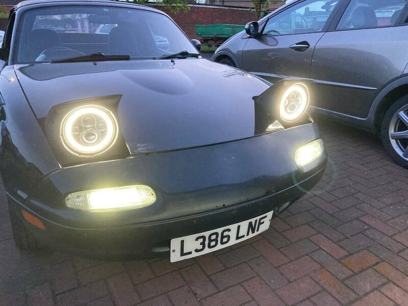

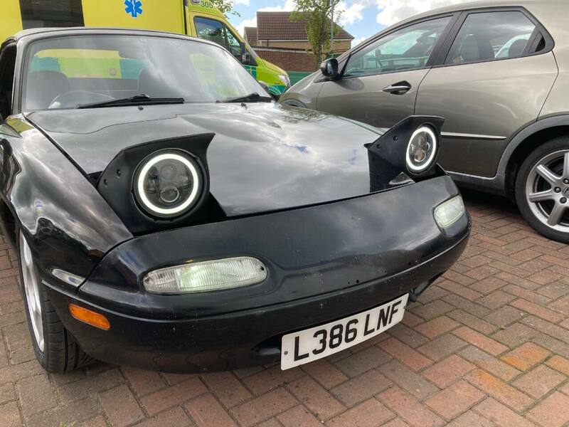

i also fitted some wanky headlights to the mx5
they’re bloody bright
even if they do look a bit wanky

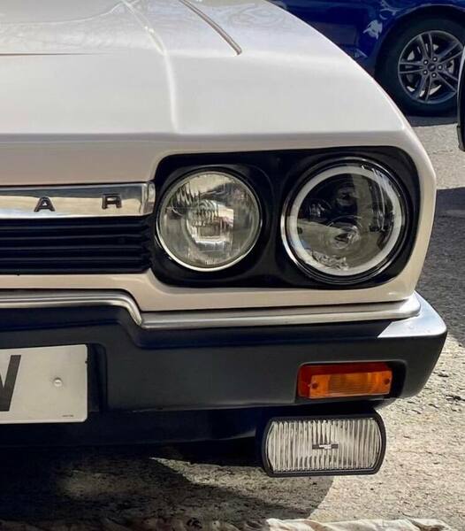

i bought them off a really nice chap who had bought them for his Scimitar. then decided they looked too wanky !
he was probably right but the rest of the car was an absolute beauty.

I like those headlights on NAs to be honest. Happy car is happy 😛
pop up headlights are the best thing in the world - i’ll never tire of seeing the reaction when kids see them for the first time, it’s hilarious :)
i spent ages wiring up the sidelight / indicator ring-piece then decided it just looked too naff so pulled the plug on the indicator bit
I just want to say that Like is for the Scarab and Pop up head lamps in general
and to make sure that no one accuses me of liking LED tat LOL
(as an aside, aside from being LED's (and yall know my thought on those are LOL) I find atheistically these particular style of 7 inch LED head lamp always look quite naff, black soulless almost, looks like your staring into dead eyes if that makes sense)
but my usual grumblings about LEDs aside its also very awesome to see progress with the Exo is happening! hopefully not long until the next visit to the Ministry man? :)
surely this is the perfect setting - no one needs to see the ugly sods during the day until they pop up at night :)
i have a spare set of pop ups that came from the Exo donor car, when i eventually get round to doing my garden /patio, they will be strategically employed as comedy security lights !

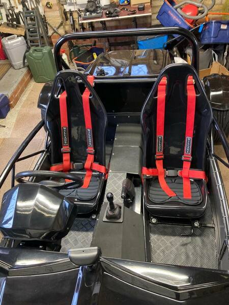

the seats are back in - what a difference that new flooring makes

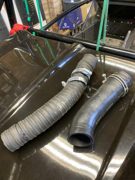

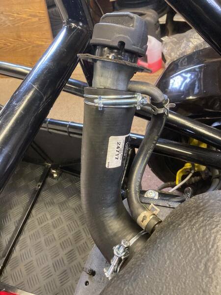

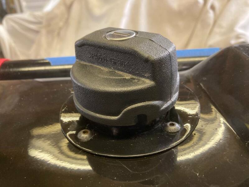

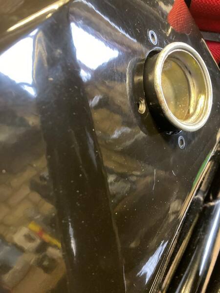

time to get that fuel filler sorted

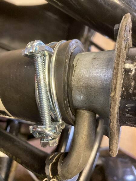

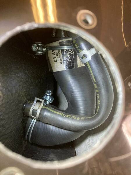

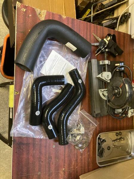

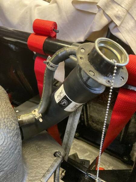

the pipe on the left was too flexible, the one on the right not flexible enough
so I splashed out on a pre bent one
the only problem being that it is too wide
but a slice off the old pipe makes for a perfect shim
sorted :)

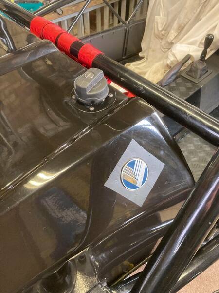

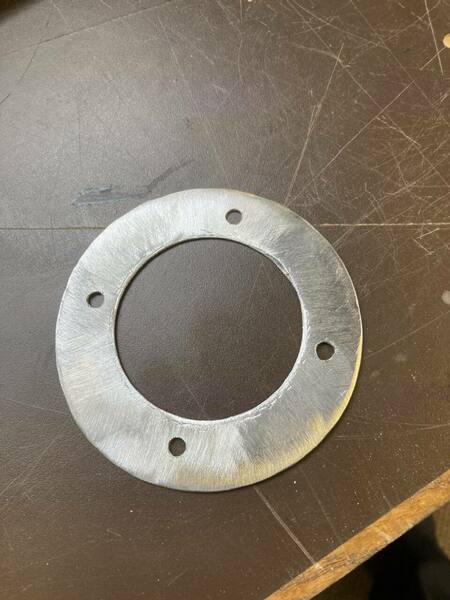

except my clamps didn't fit - a few days later, eBay came up with the goods

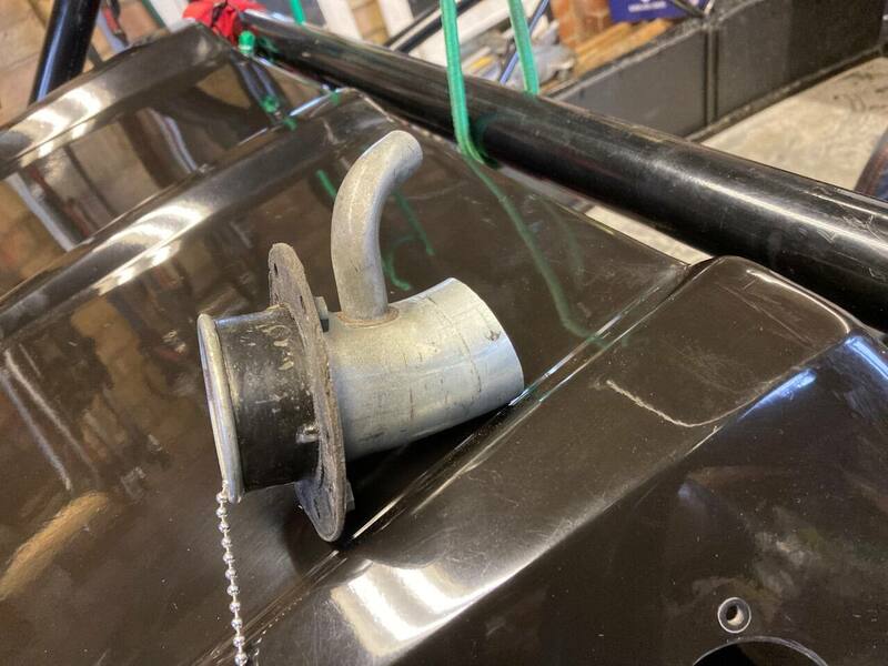

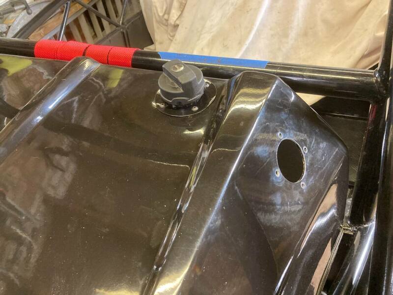

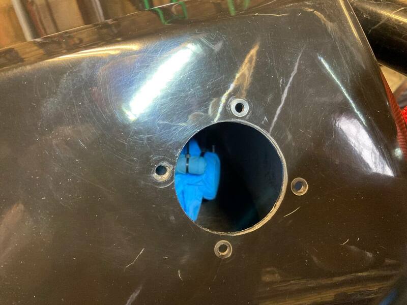

but no matter how I adjusted things, the neck would not sit flush at the cover :(
the fibreglass was threatening to crack if I screwed it tight to straighten it out so I got busy with the hole saws
and we have success !

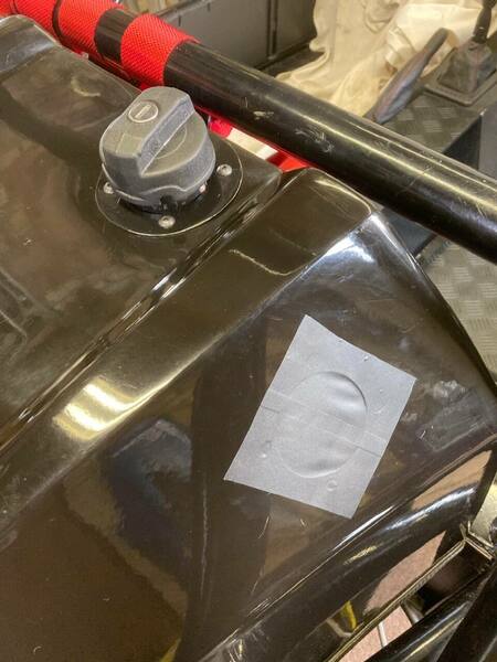

except nothing is ever that straightforward - zoom back on that image
bugger !
not ideal but it got the job done
mr iva can see the new inlet without even taking the cover off now !
I'll fix this properly* somehow but this'll do for now
stick an old Eunos badge on ? no one will ever know :)
so that's the fuel filler sorted, best tick it off the list
no, no, no, this needs a bigger tick !
I'll give it a quick test drive and see about booking the re-test

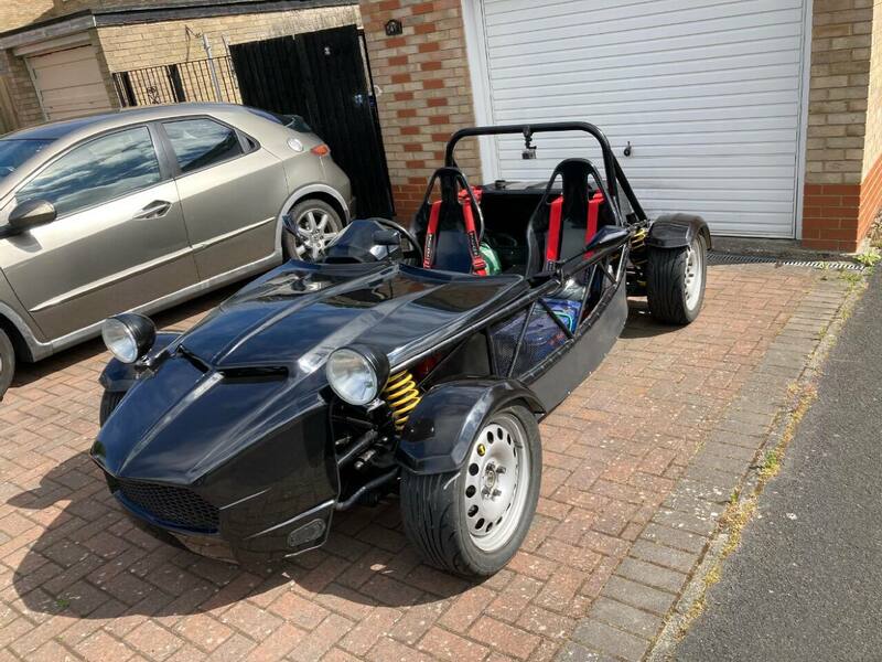

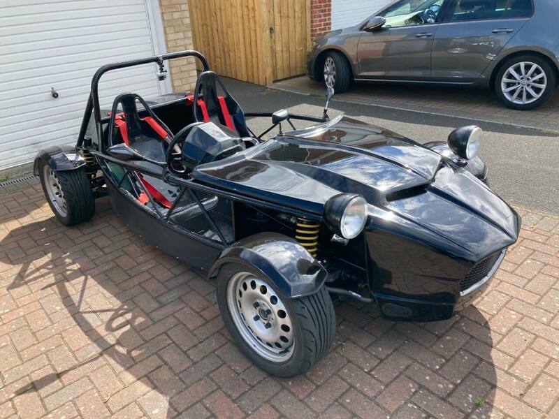

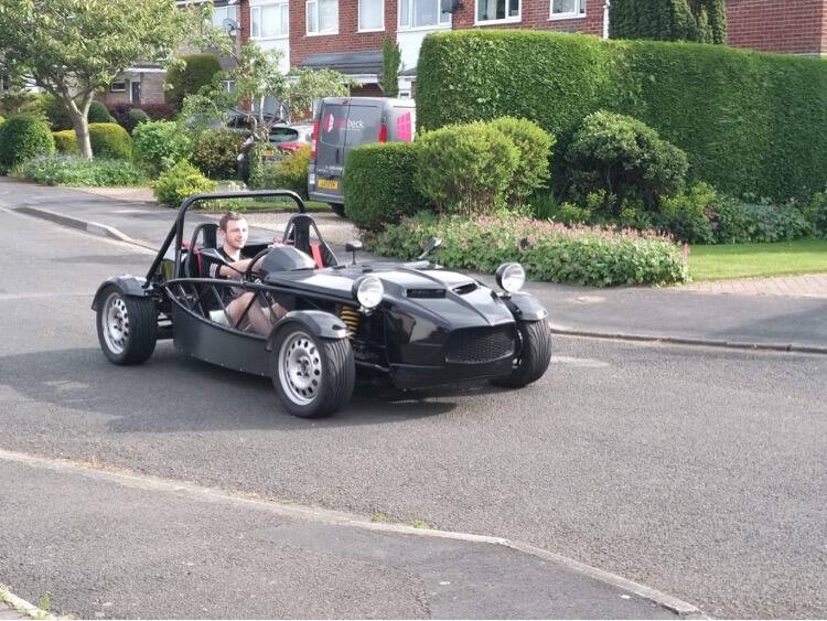

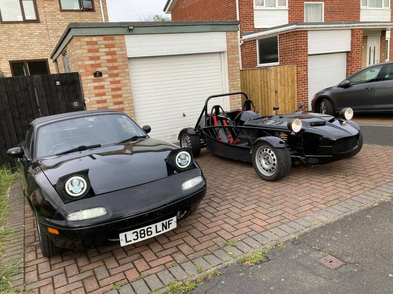

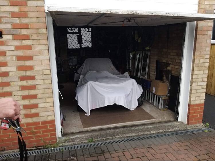

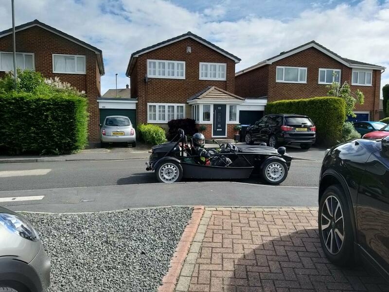

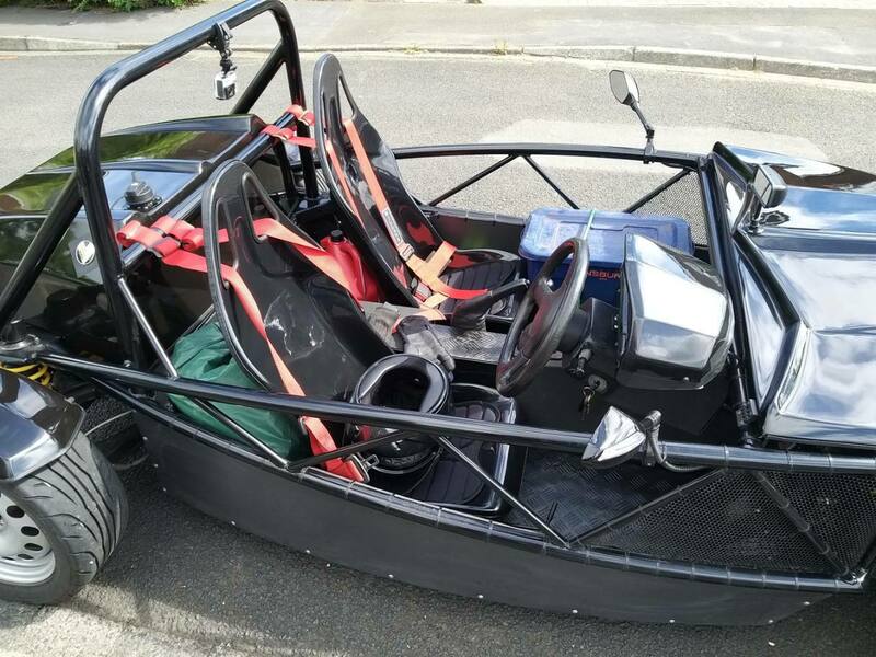

as the sun was shining, it seemed a good time to whip off the dust sheet and let the exo see what daylight looks like

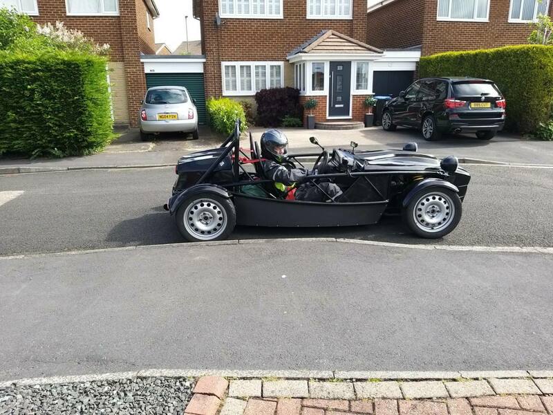

garage gm’s new apprentice (   @DVee8 junior) was employed to bring it safely onto the drive
everything was ticking over nicely so he took it for a quick run up and down the street - i think he approves :)
