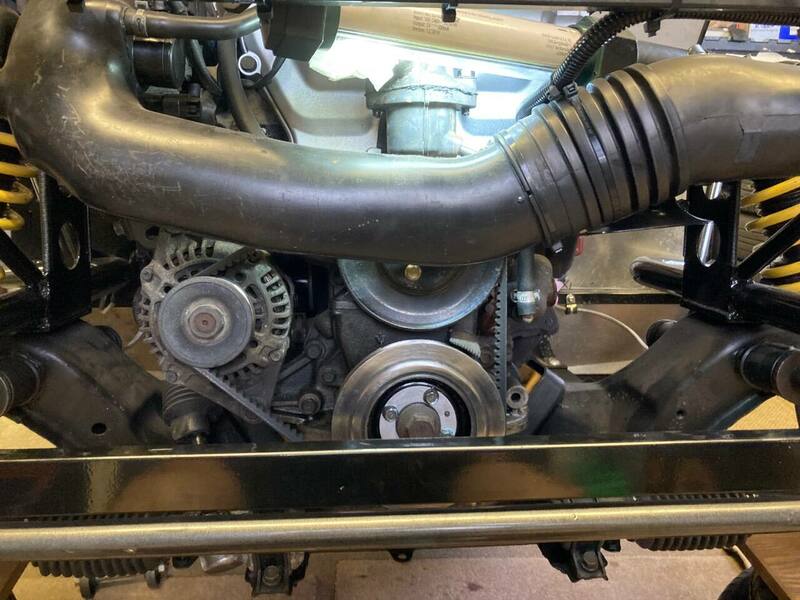

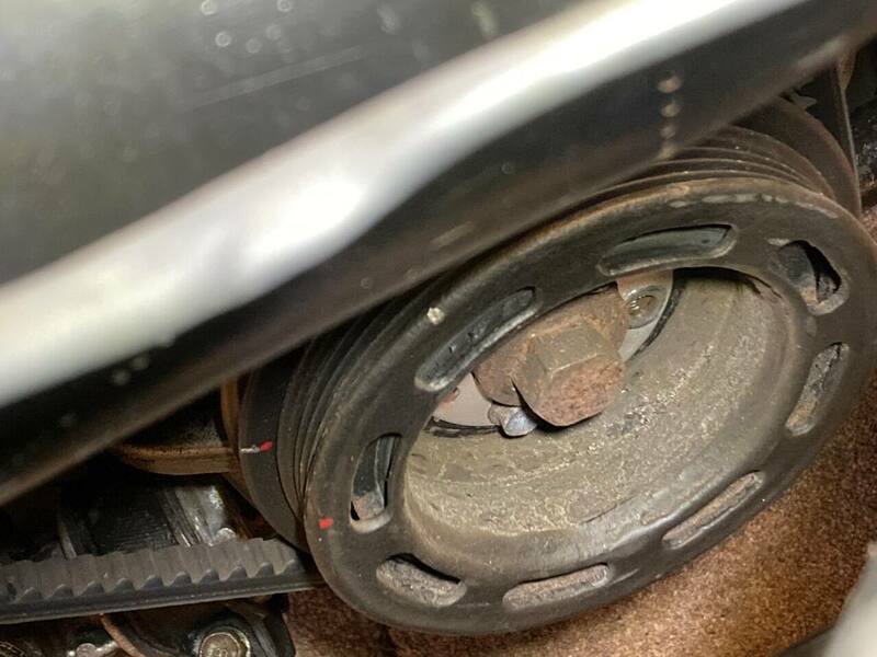

on the way home, i noticed a bit of a noise from the front of the engine - better check that out asap

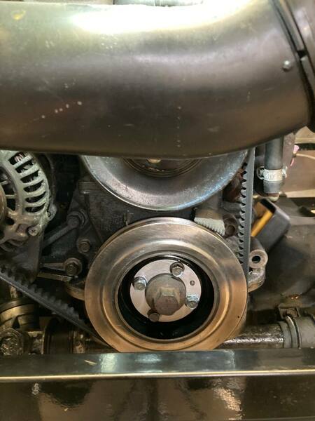

turns out that 75% of the bolts holding the crank pulley on had made a bid for freedom
lucky the last one didn’t give up out in the middle of nowhere :(

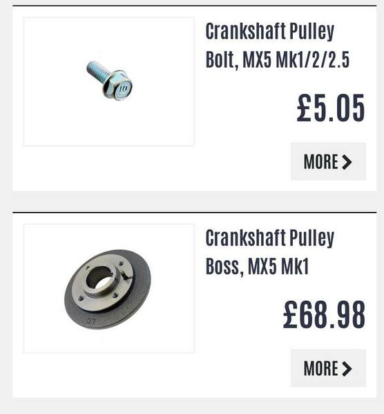

i found some in my box of spares but managed to shear one when tightening them up
time to go shopping (but not at mx5parts prices)
i’ll see what the mazdadudes down in darlington can do - they’re usually very helpful.
in the meantime, i’m hoping that the three that didn’t snap will stay put with a good dab of loctite on them

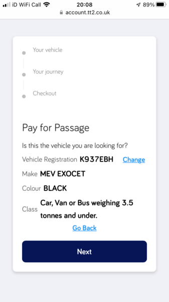

i came back via the Tyne tunnel but it was too busy for a proper hooning :(
at least the website recognised my reg number
this surprised me

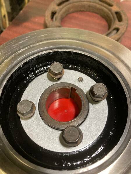

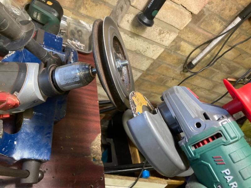

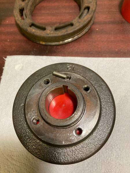

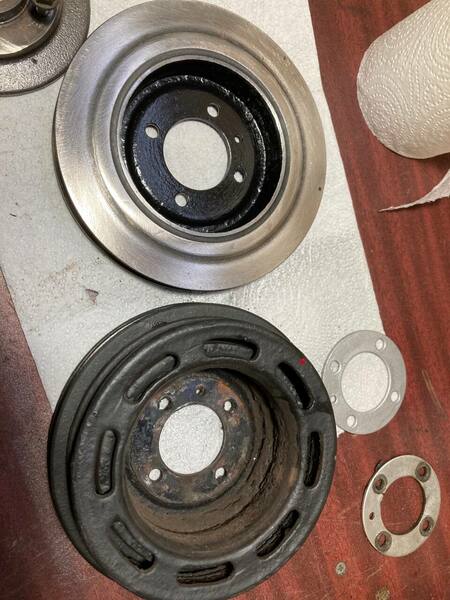

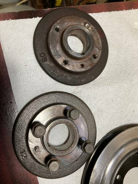

i got in touch with andy at mazdadudes and he had a pulley in stock
hmm, a bit scabby, let’s see what we can do with that
first thing is that i only need half of the double pulley - the ribbed section drives aircon and power steering on the mx5
so some careful cutting with a thin grinder disc then a particularly dodgy set up to clean up the surface
a dab of paint and it’s good as new

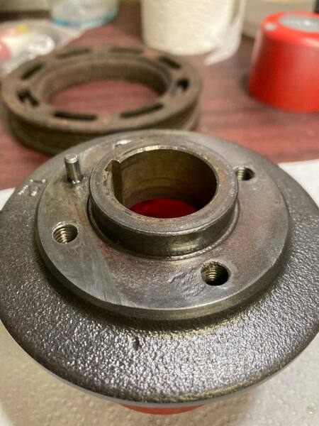

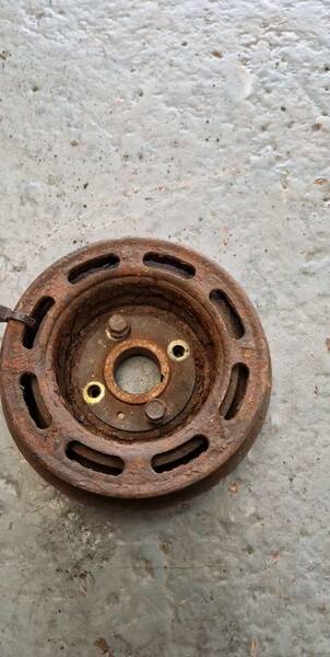

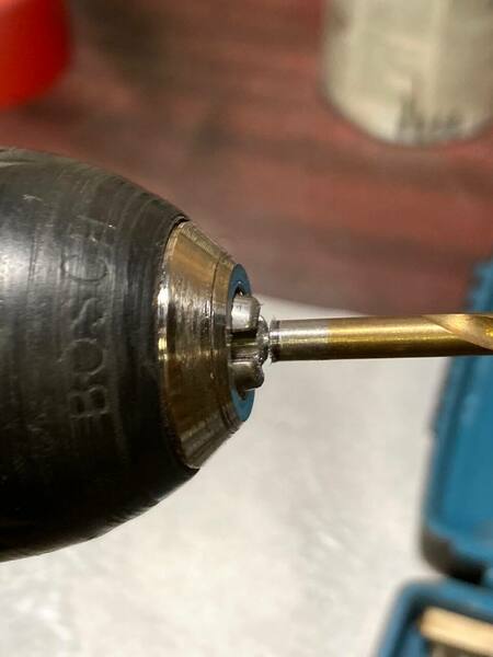

except there’s a locating pin missing from the hub
now where would i find one of them ?

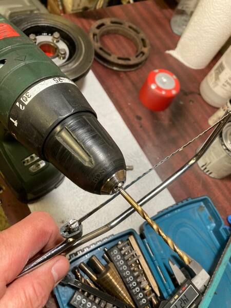

i didn’t expect this to work but
4mm pin as required
a drop of epoxy and we’re all set
all i need to do now is fit it to the car (but there’s a couple of other jobs i’ll do at the same time so will need to wait until next week)
shame no one is ever going to see it :)

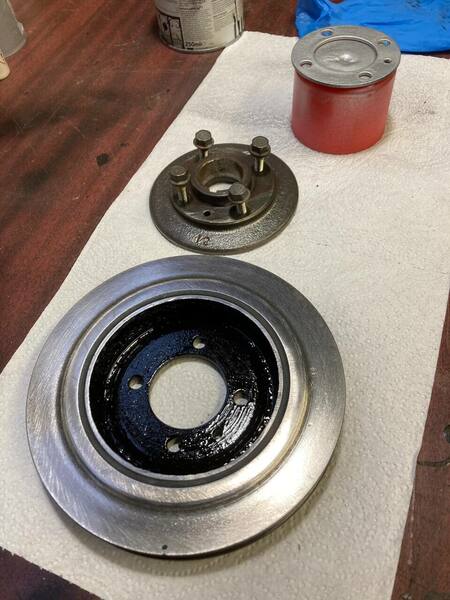

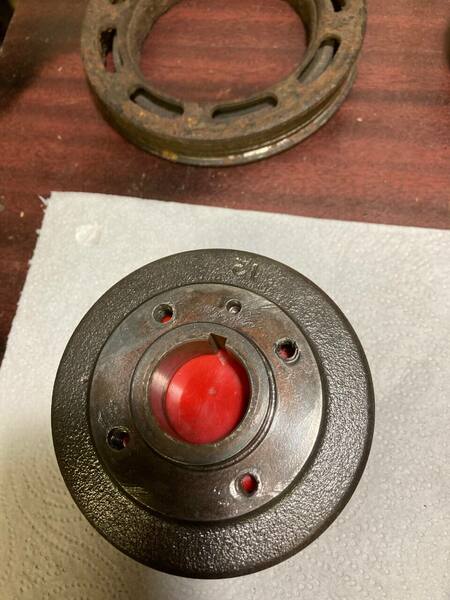

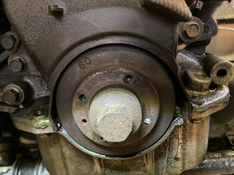

one crank pulley hub with snapped bolt
not a chance of drilling that out in situ, off it comes
no idea what the numbers signify but it looks the same to me
a fair bit of weight saved compared to the old pulley

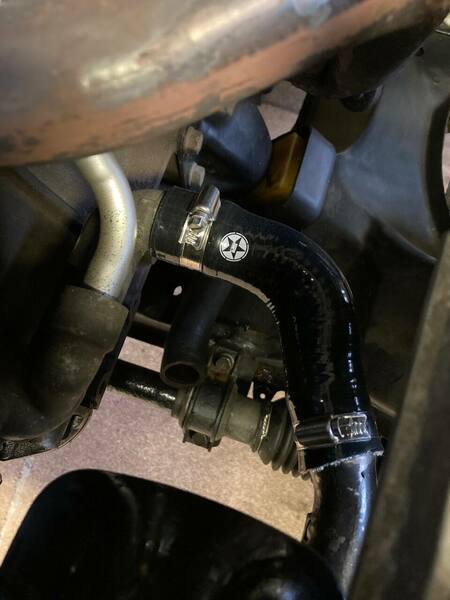

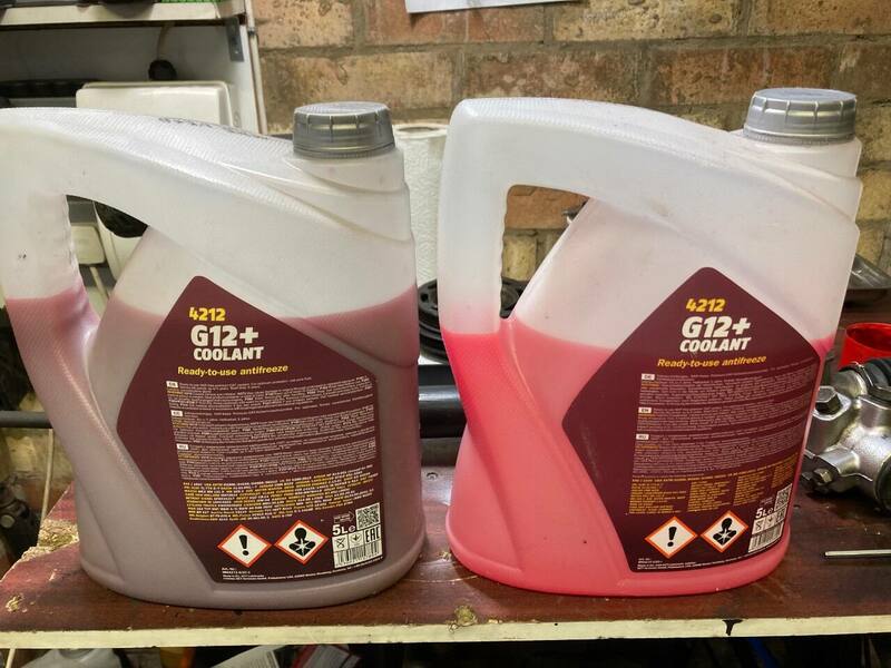

while the radiator was out, i fitted the silicon hoses i bought back in may but couldn’t be arsed to do
the coolant is only a few months old but minging
thats it all bled up with fresh stuff and the fans are kicking in when they should, just to make sure i took my neighbour liam for a quick blast - as a former mx5 owner, he’s been watching the build with interest - and was very pleased to finally get a ride in the exo :)
i’ll do an oil change at 1000km, i’ll be curious to see what that comes out like having seen what happened to the coolant.

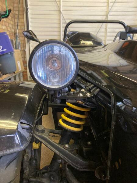

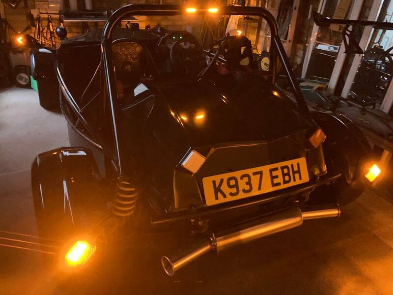

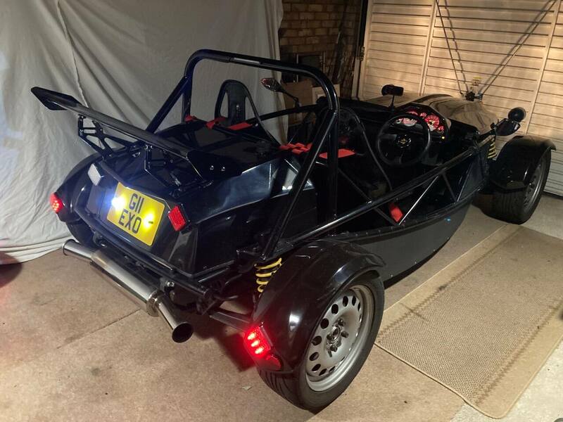

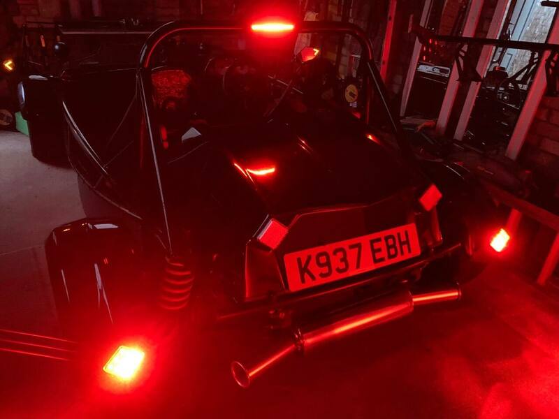

i’ve noticed a few times that when i’m signalling to turn off a roundabout that other drivers don’t appear to see or take notice of me indicating - maybe the front mirrors isn’t the best place for indicators ?
i had a look on ebay for something fairly discreet and again found myself looking at bike parts
certainly discreet once fitted
but pretty bright in use
i’m happy with that :)

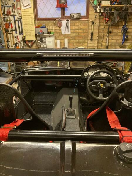

while i was messing around with wiring, i fitted a high level brake light on the roll bar
also has indicators
not much use if you brake and indicate at the same time though

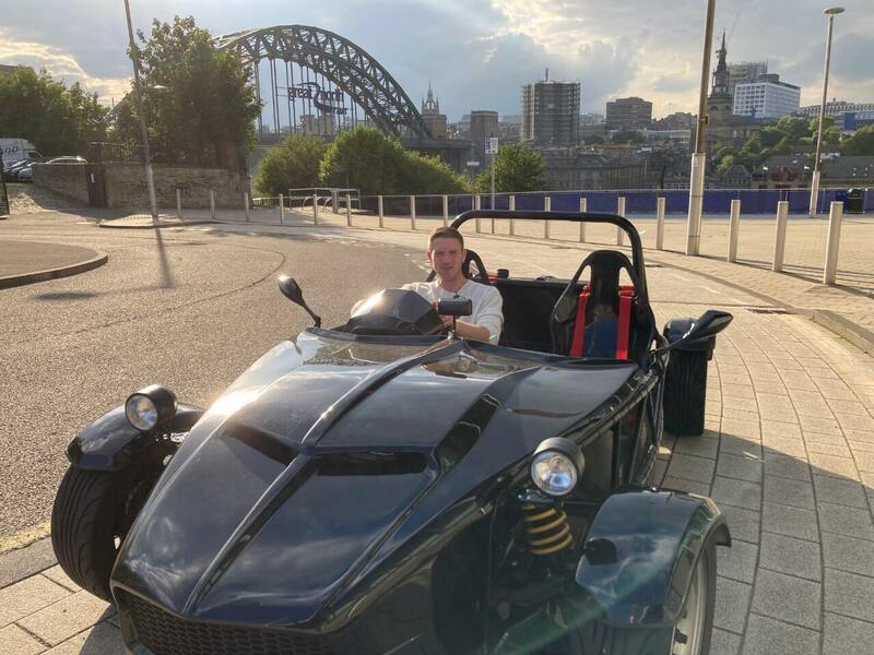

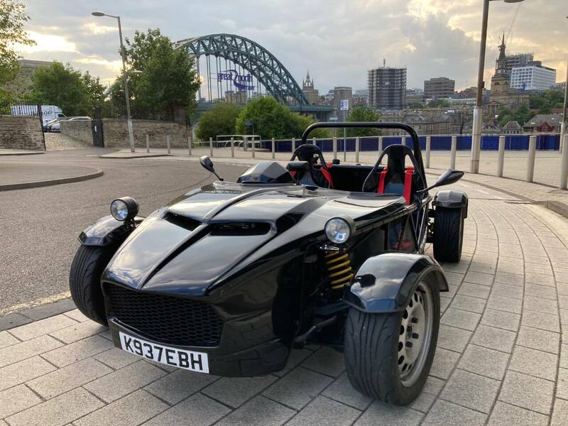

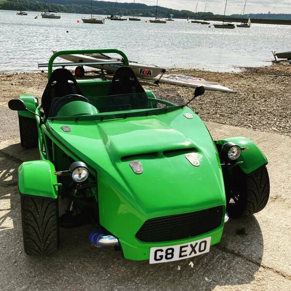

out and about in the Exo again today, i stopped for fuel and the chap at the next pump started reminiscing about his Dax Rush kit car that he built when he was younger - had a cosworth engine and could spin the tyres at 70mph !

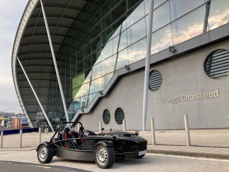

then i had a nice run along the coast and stopped at the Sage in gateshead for some pics - a bloke who was waiting for his lift came over and was very enthusiastic about the Exo, asked me if he could have a sit in it for his photo taken ! then his phone battery was flat so i had to take it with my phone and send him it :) nice bloke, although mildly pissed !
he chatted for a while then his lift arrived, and i got the pics i was wanting
Result on getting it on the road and the niggles sorted!

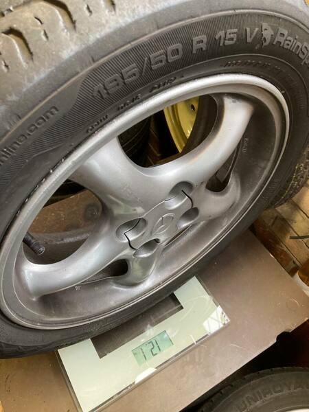

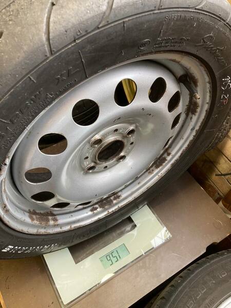

What's your wheel/tyre setup? Unusual to have gone for steelies when you're saving weight - they look the part though!
cheers. the steelies are off a Bini, 15x5.5 with 195 50 15 nankang ns2r tyres, not particularly heavy at around 15kg inc tyre, i just like the look of them. they’ve got whopping big 35mm spacers on which won’t be helping matters but it drives pretty well :) i may nick the alloys off the mx5 and see what difference it makes

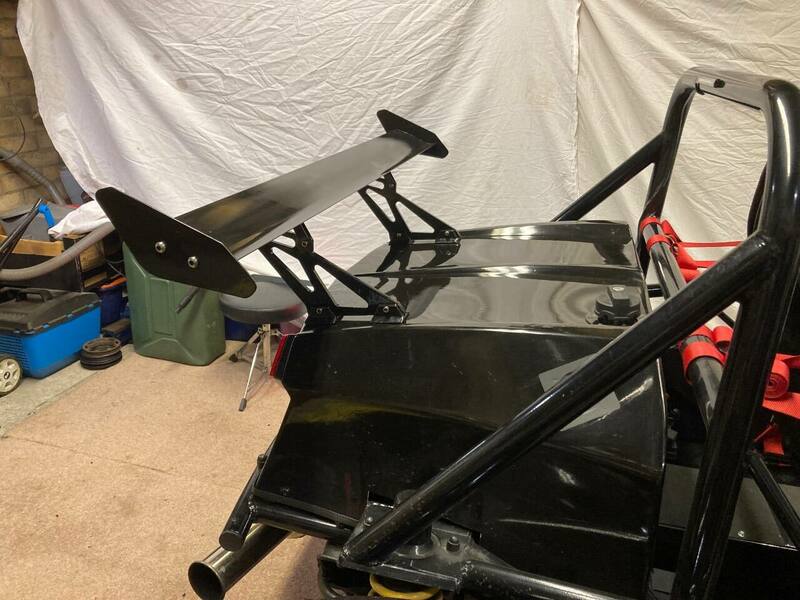

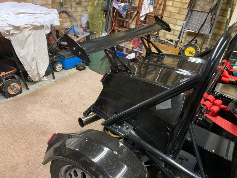

what’s going on here then ?
that silhouette looks a bit different
spoiler alert :)
there’s plenty of adjustment, i shall tit around with it for the perfect angle
i’m not sure how much downforce it will generate but (more importantly) it looks mental :)
  • gm changed the title to gm's unhealthy obsession with mx5s - the EXO is finished (spoiler alert)
Ahhhh much downforce for the back roads we have around here for MUCH hoooooooning.

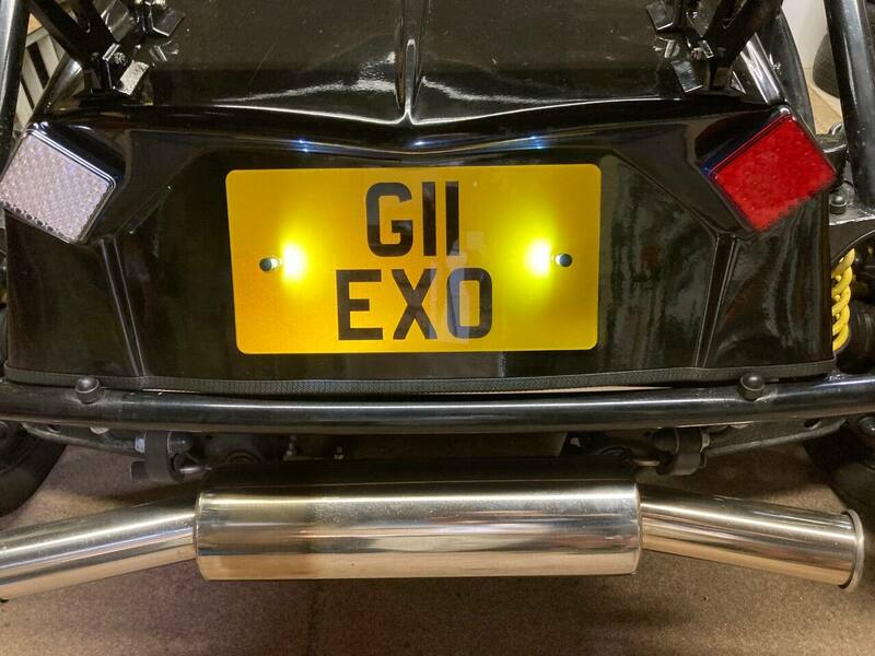

i’ve had my eye on a registration for a while now but it would appear that some chump has bought it :(
this chump !
how good is that ?
how about an illegal 3/4 size stick on plate for the front ? absolutely  :)
