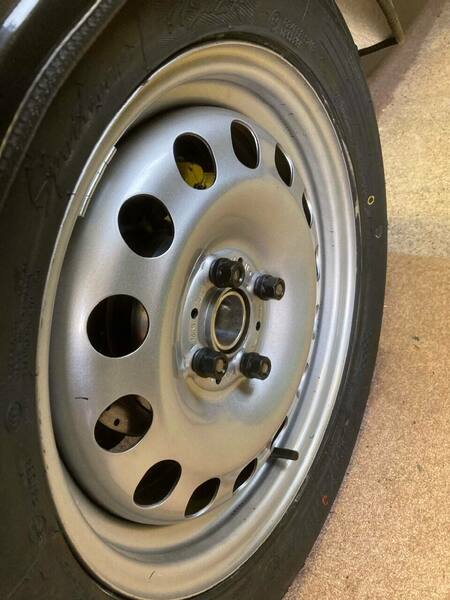

The yellow key is for a 27 year old ignition, the red for a £1.99 eBay petrol filler cap - both are about as loose as you would expect, they tested just fine :)

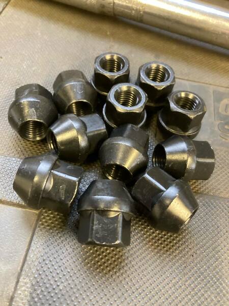

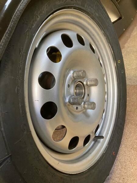

big ugly nuts
hello, ebay, please send me some tat
nice smoll nuts

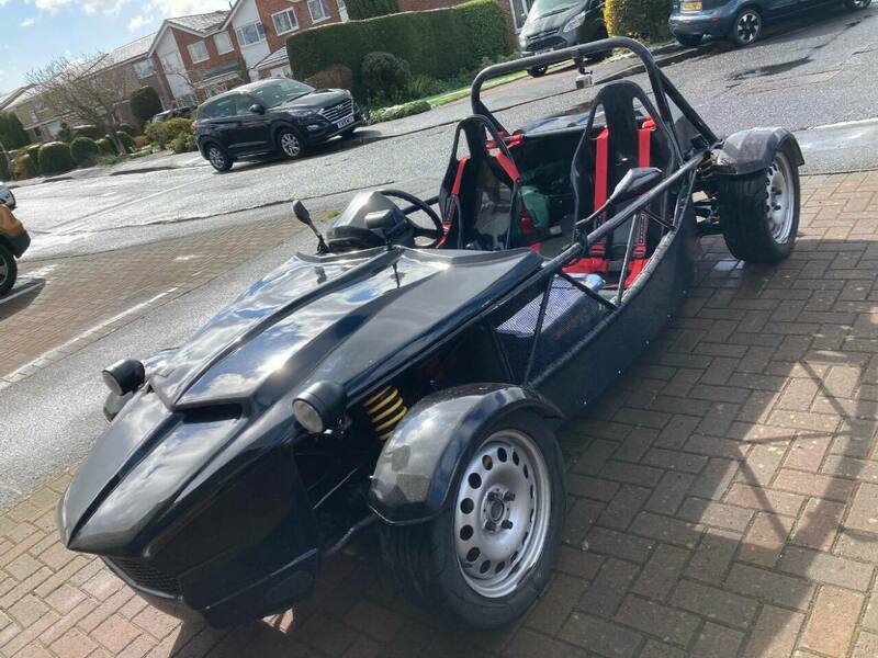

this week, I have mostly been titting about with tinting film
normal mx5
yellow tint
smoke tint

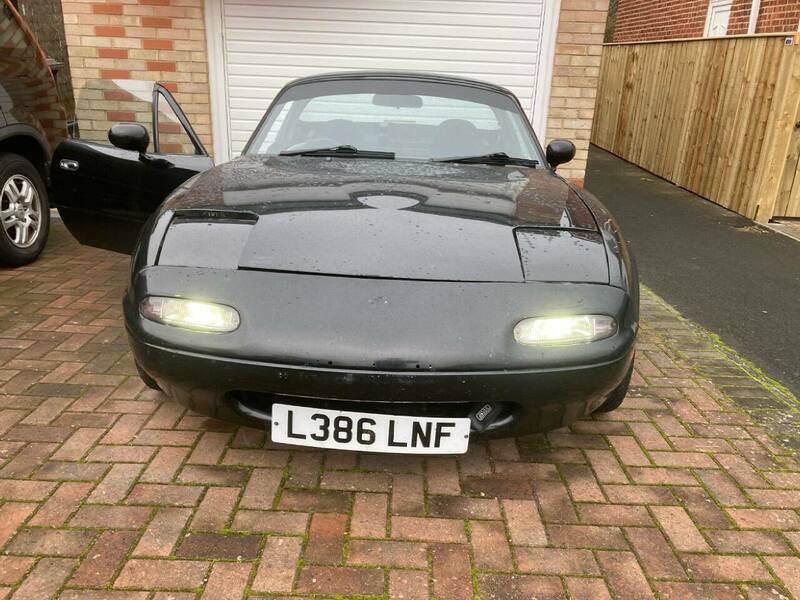

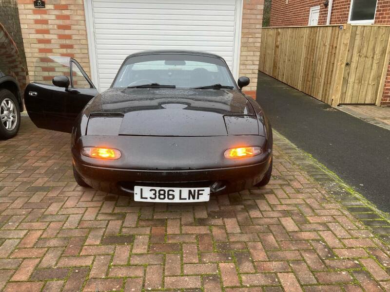

switchback drl leds fitted - these are quite clever, illuminate white but mute the white and flash orange for indicators
maybe I should straighten that wonky number plate ? its been like that since June

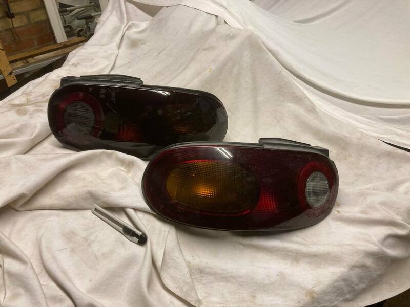

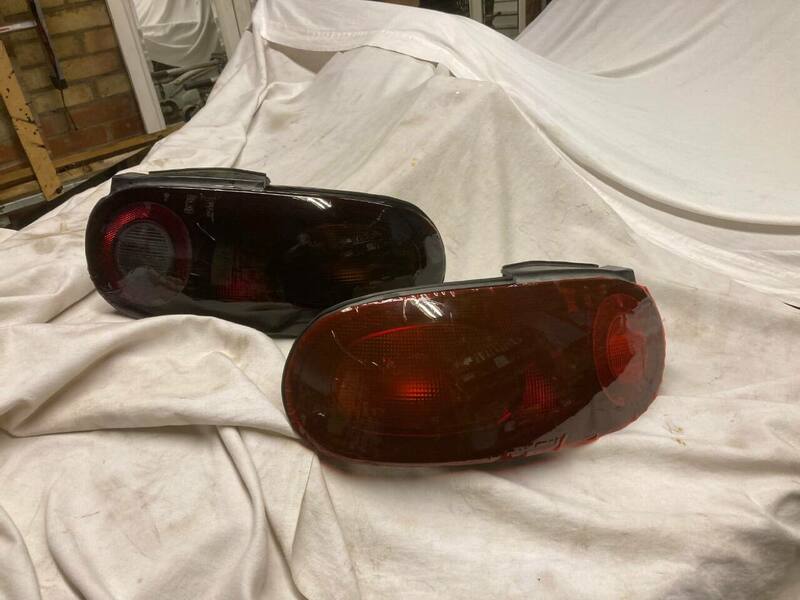

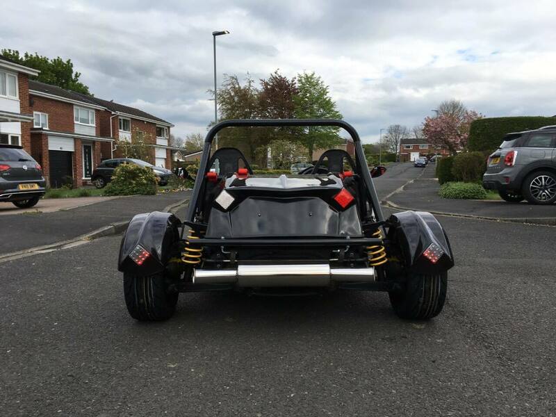

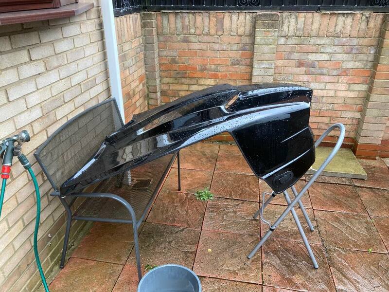

I have a spare set of rear lights so why not have a go here too ?
smoke tint looks ok
red tint looks utterly shit (and was a sod to apply)
the reason for all this titting about with tints is the back end of the Exo is a bit of a mess, lighting wise - a bit of subtly applied smoke and / or red tint should tidy this up a bit
and the headlights will be going yellow
but mostly, as I've had a buggered back, I've not been able to do any real work :)
I visited the Exo stand at the NEC classics show at the weekend and have regained my motivation - I'll get that bloody test booked...soon !
smoke tint looks ok

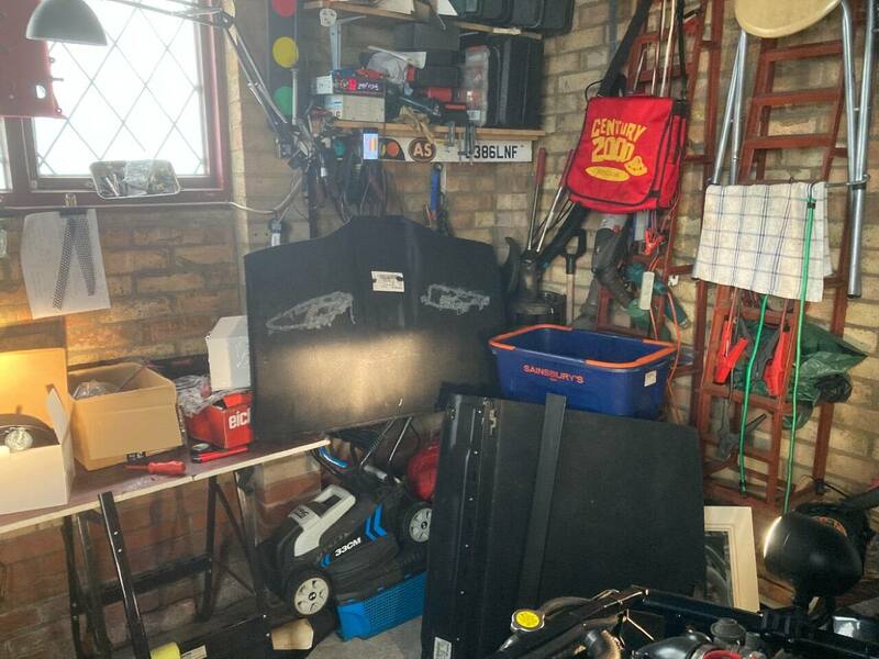

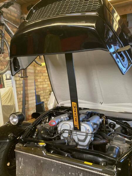

 I made a bonnet prop

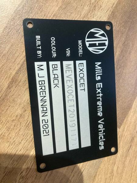

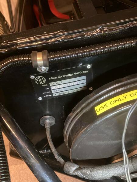

I spent twenty quid on a fancy vin plate

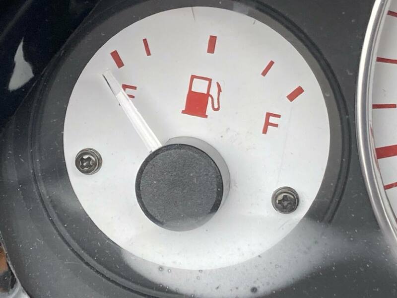

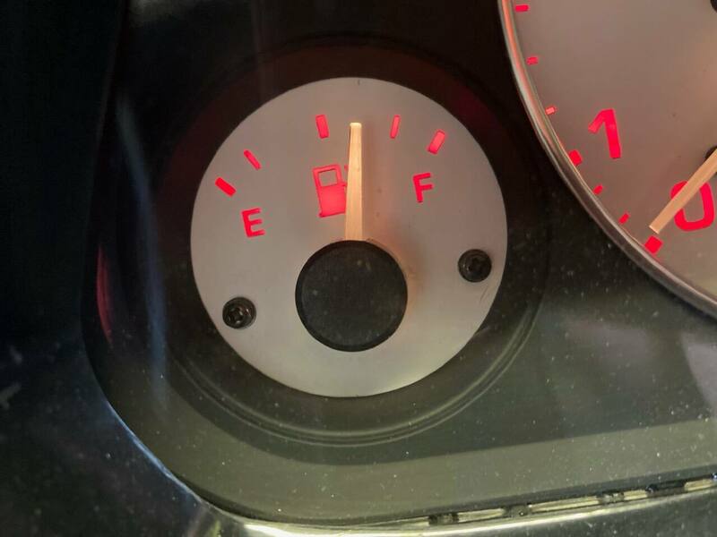

I fannied about calibrating the fuel gauge

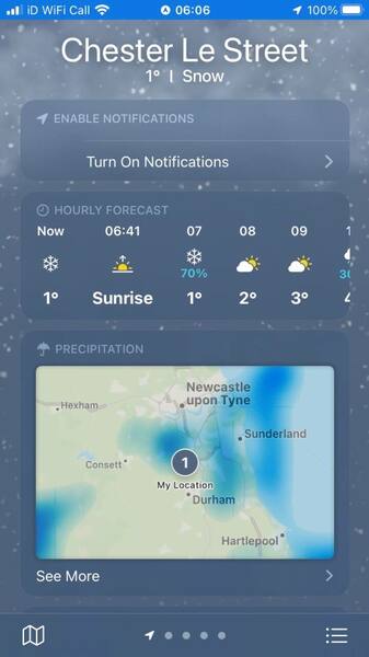

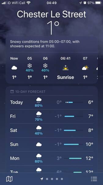

better check the weather forecast to see what I'll be up against
hmm, not so good then, is that rain or snow ?
don't worry, they're not accurate, get some sleep
aaargh ! what the fuck ? wake up you sleepy bastard !
yes, todays the day !
I dimly recall something about the weather , better check again
100% chance of snow ? I don't fucking think so !

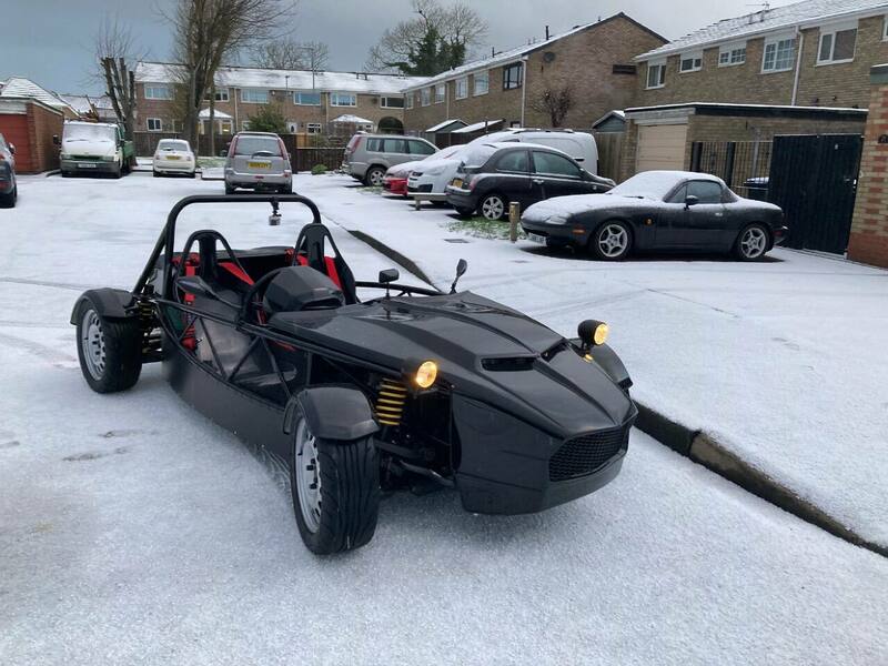

channelling the Blues Brothers "it's twenty miles to my destination, I'm on semi slick trackday tyres, I don't have doors, a roof or a windscreen, and it's fucking snowing"
big boy pants on (and many other layers)

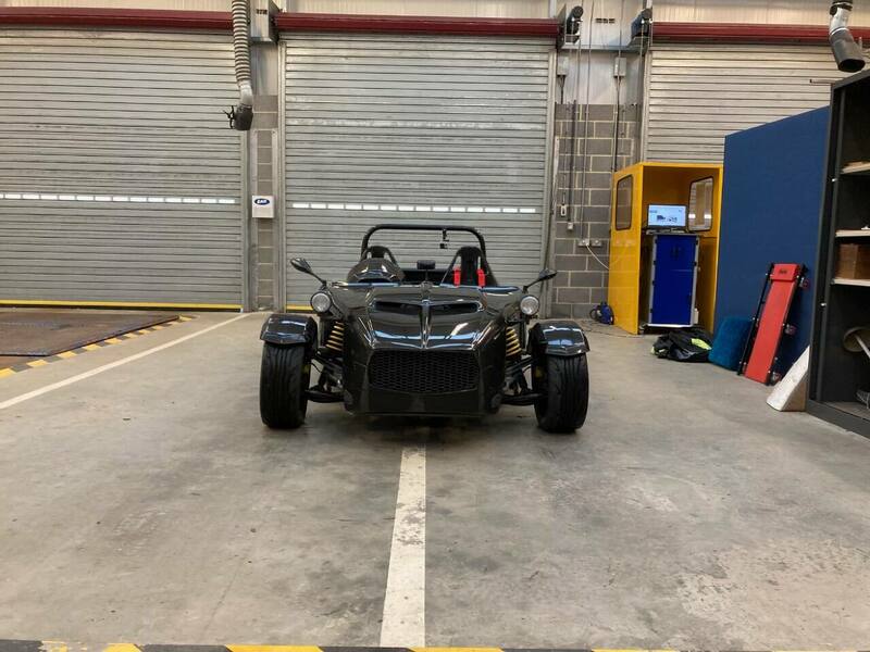

hello EXO
fuck it, what's the worst that can happen ?

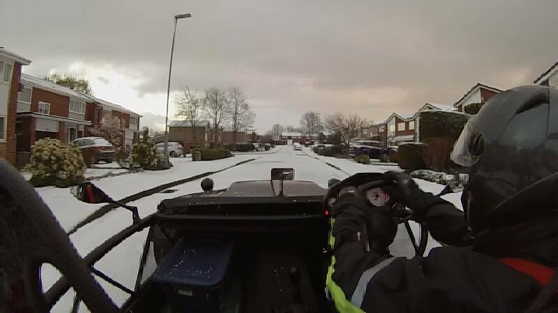

I live on a hill, we get snow when the rest of the town doesn't - all I need to do is get down from the hill and we're all sorted....
holy shit, this is so sketchy
the back end is all over the place but I've been waiting for this day for two years

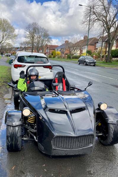

let's go !

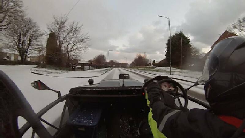

20mph, note the angle I am steering just to keep a straight line :)

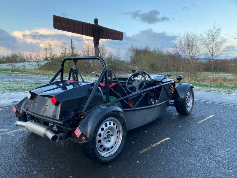

sat nat wants me to jump straight on the A1, I'm thinking that a three lane motorway might not be the best choice today
I plotted an alternative route and nervously made my way north, at around ten miles in, I found a convenient lay-by to pull over and check the car
couldn't resist a photo opportunity
'twas fucking cold
I crossed the Tyne Bridge
and made my way through Newcastle to Gosforth,
and my nemesis
Can't leave us hanging like this, bloody hell!
yes I bloody can ! :)

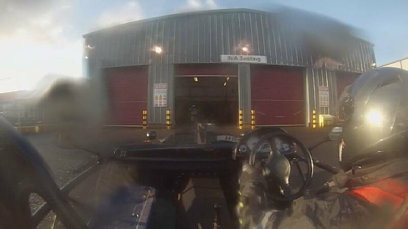

no photos in the test centre (not allowed) but I was there for four hours while the tester, who was a really sound guy, had a jolly good poke around my little EXO
within five minutes, he'd found a problem :(
loose wiring in the engine bay, a quick cable tie and we're good to go
a brake flexi rubbing on the chassis, no problem, a bit of fuel hose can protect that

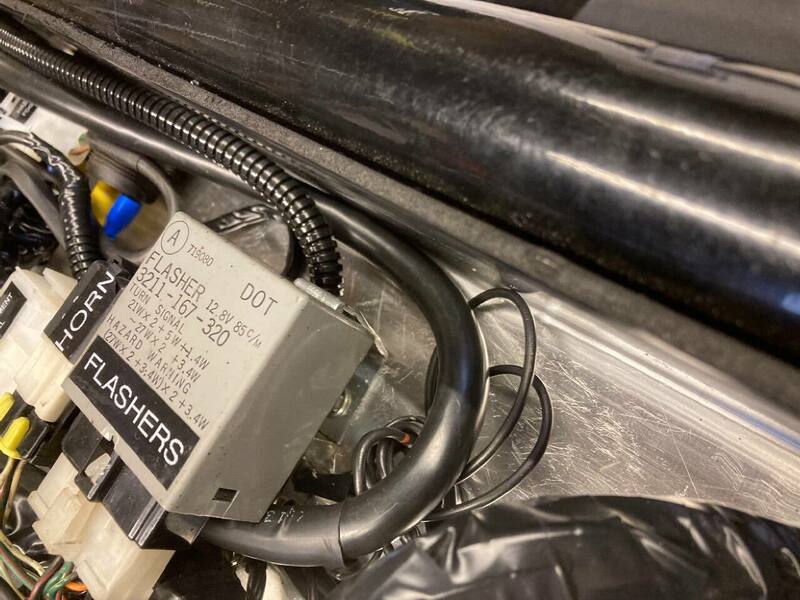

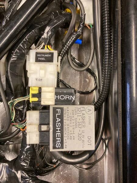

pop the wiring tray open and let's see what's going on here

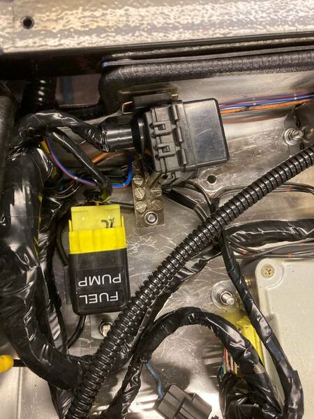

hmm, all those relays need to be fixed in place by brackets, cable ties are just no good :(

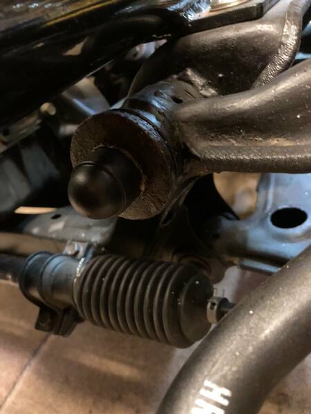

how about those steering rack bolts ? are they loctited ?
and the engine mounts ? loctited ?
and the seat mounts ?
and the harness mounts ?
and the calliper mounts ?
and everything fucking else ?
ok, not looking much like a pass today
I'd been concerned about things I couldn't test at home so was pleased when the brake test went well, noise was passed at only 90dB, emissions should pass as long as I can prove the age of the engine (the v5 has it as 1999, the date of import, but the donor was built in 1992), headlight aim and beam pattern was a joke which really pissed me off as the lights are supplied as part of the kit, alternative plans are afoot.
the tester took it outside and had a wee drive around, officially testing the steering but I think he just wanted to have a blast around the car park :)
so the official verdict was a "not a pass"
disappointing, but not many kit cars do pass first time. I've got a list of remedial which wont take long and a retest will be booked
but, getting a fail didn't make the day a disaster - far from it, I learned a lot and had the chance to DRIVE FORTY MILES IN A CAR I'D BUILT MYSELF IN MY BLOODY GARAGE !

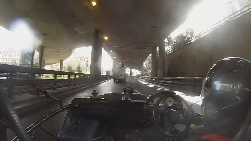

I came back through the "Oggy Oggy Oggy" tunnels
and made a vido (four minutes of Bambi on ice then proper roads on the way back, a moderate quantity of beans were given)

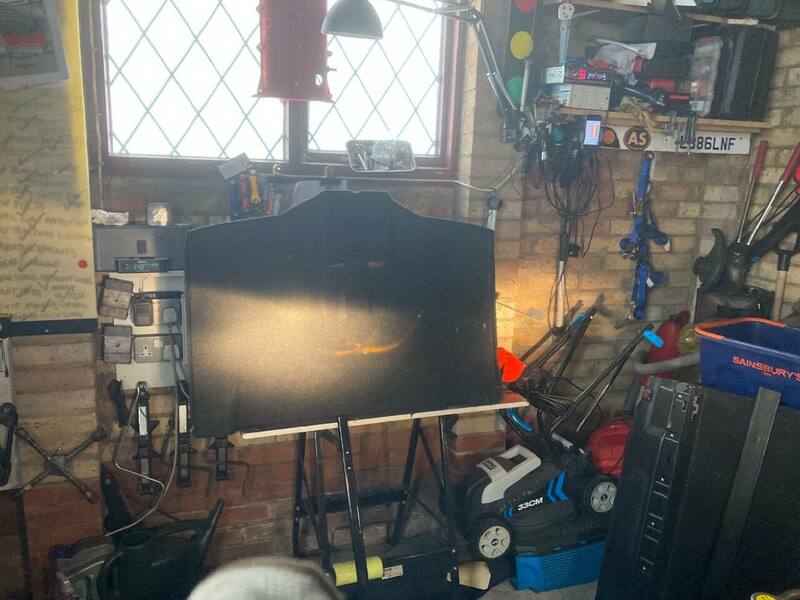

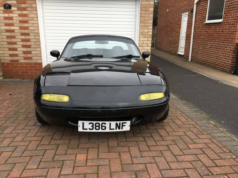

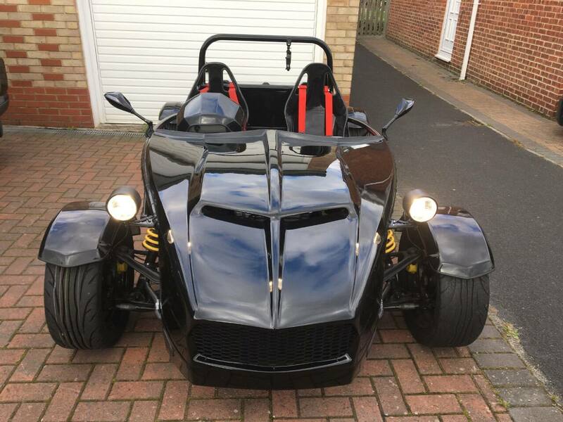

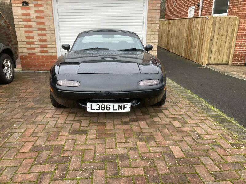

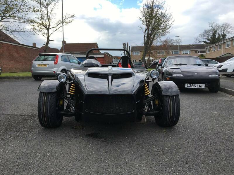

the headlights provided with the kit are notoriously poor so I wasn't particularly surprised that I had problems with them
they do look a bit goofy too

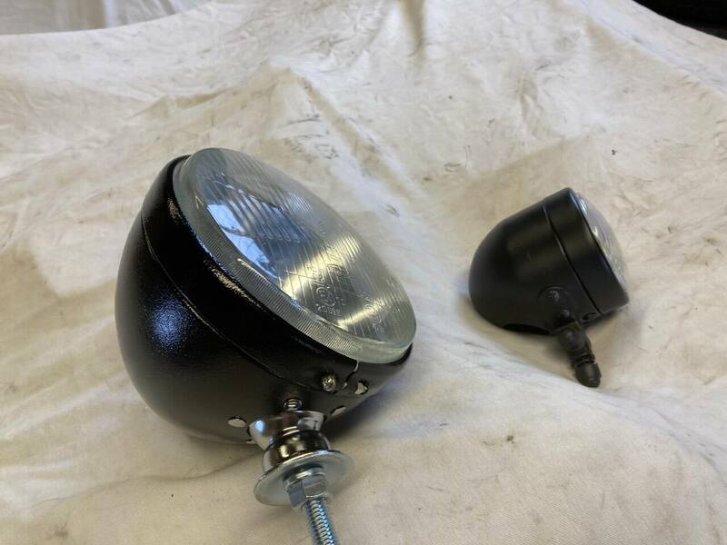

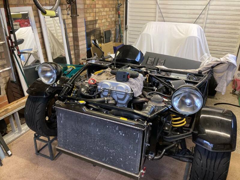

looking around for a solution that was not hideously expensive (most of them are) I remembered that I still had the 7" headlights form the donor mx5
dodgy beam from the Exo headlights (this is the better of the two , the other side was just a fuzzy blob :( )
much better beam from the mx5 headlights
a bit of ebaying and a cheap set of bowls arrived

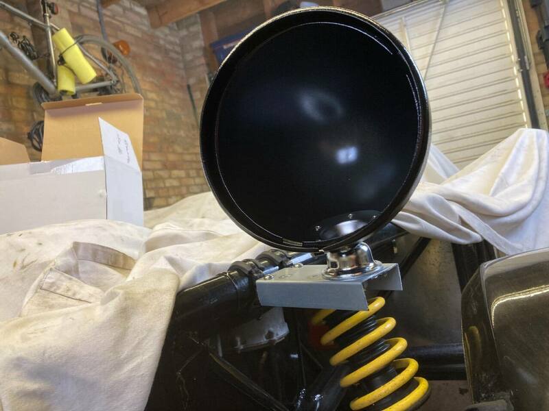

hells bells, they're massive !
I fixed one in place
and gave it a wee tweak to adjust the alignment
bugger !
ok, not to worry, I need longer backets anyway as the bonnet wouldn't fit with the larger units there
chop, bend, weld, drill,  etc
sturdy enough, just needs tidying
so now I have a matching pair of even goofier headlights

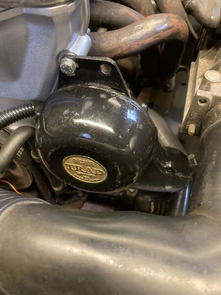

the tester did comment about how feeble my horn was (?) not a fail point but an excuse to upgrade

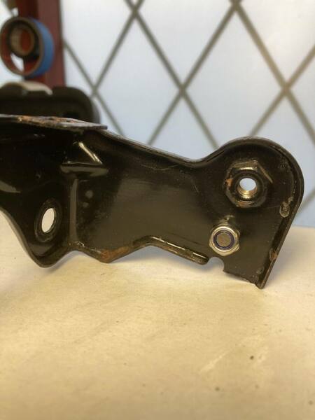

he wasn't happy with loose relays in the wiring tray - brackets were made and fitted

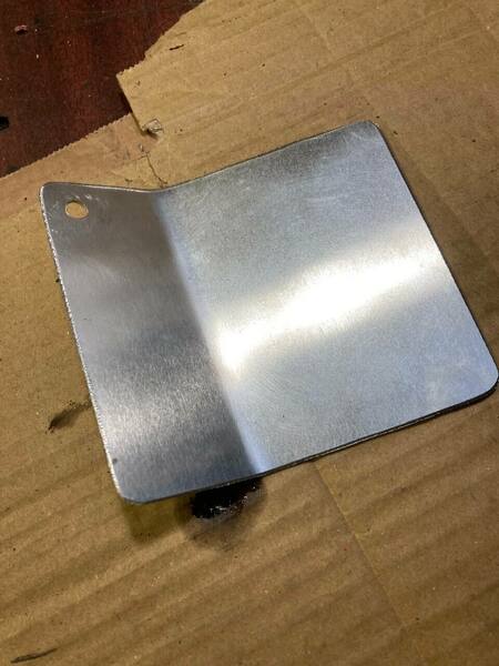

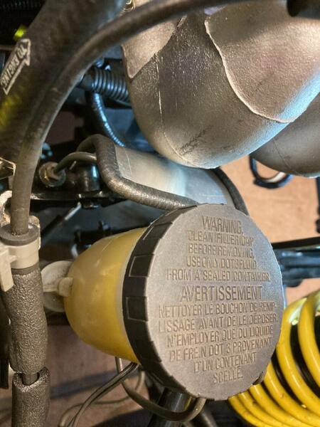

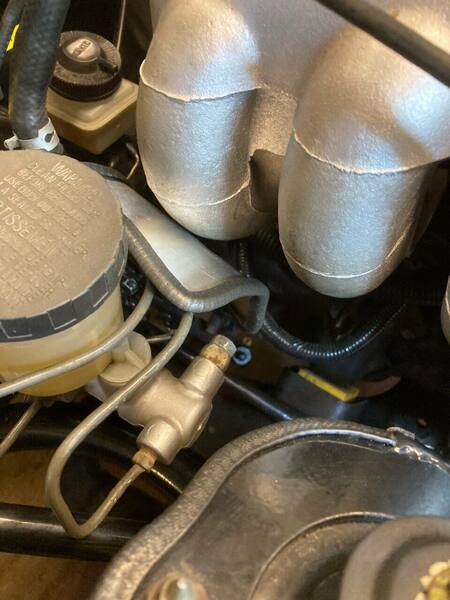

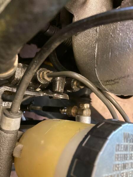

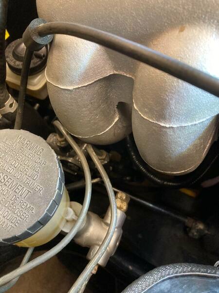

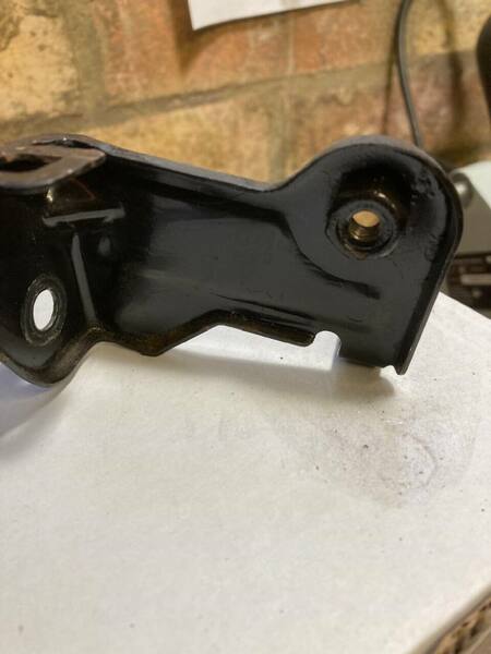

the intake manifold is touching the brake lines at the master cylinder - not good
solution - remove the bracket
drill a wee hole
and move the proportioning valve down.

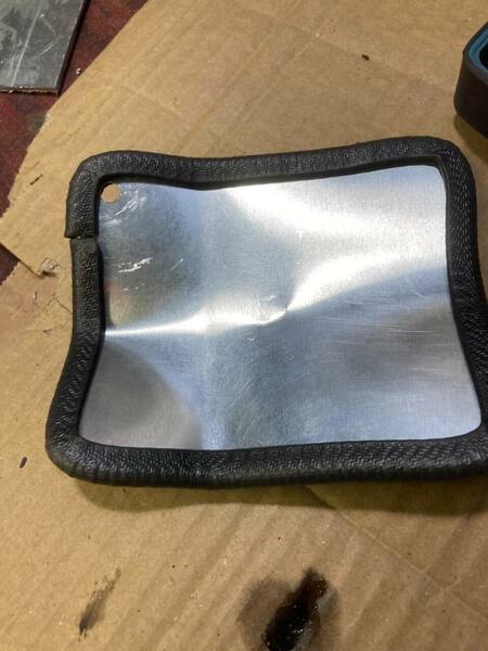

for good measure, I knocked up a heatshield

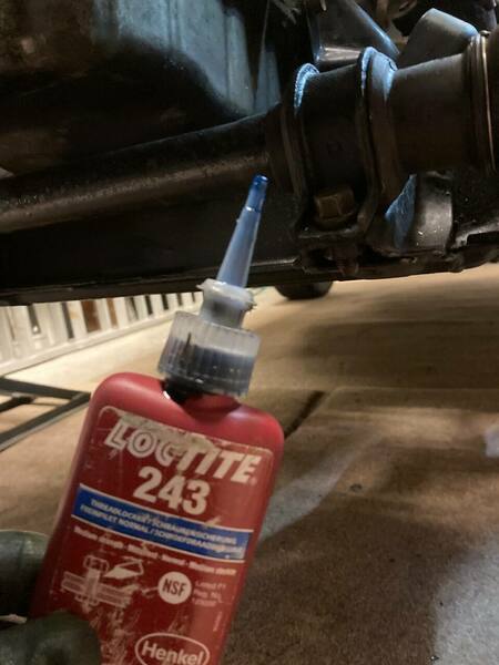

I covered up a LETHAL looking bolt on the front wishbone mount
@DVee8 kindly dropped off a giant bottle of loctite which I applied to various nuts and bolts

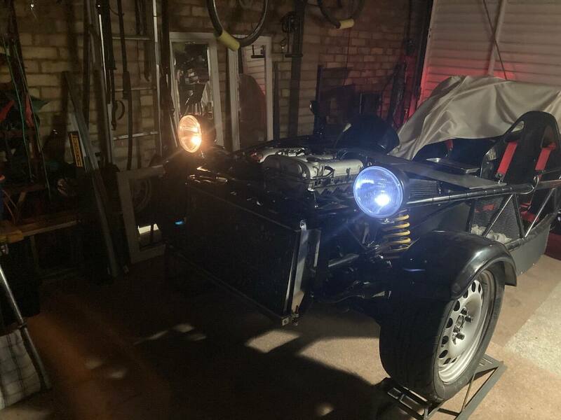

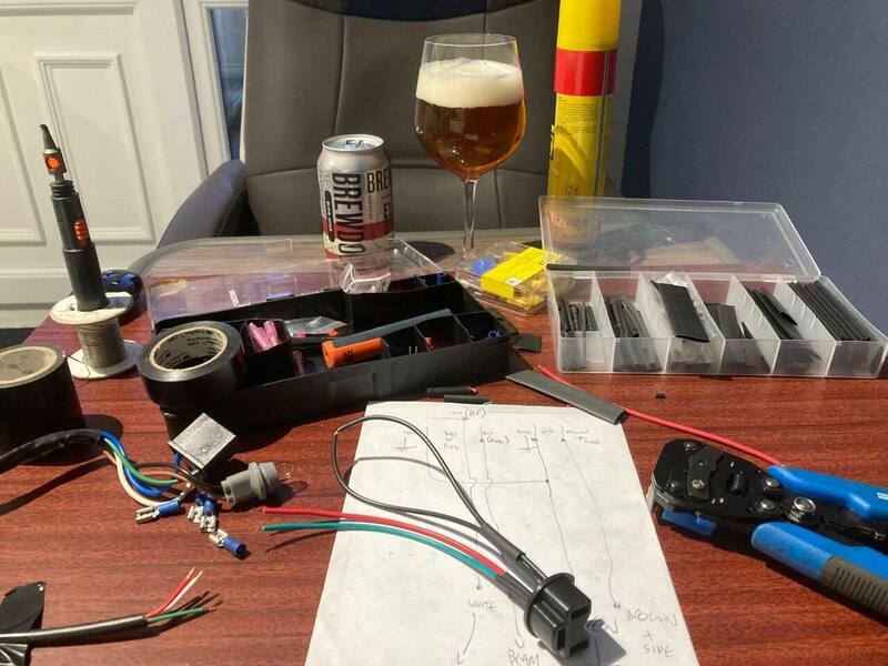

headlight wiring the other night
done under the influence of Elvis Juice - i hope they work :)
turns out i didn’t have a pair of matching sidelight bulbs
yes, definitely goofy
but should pass the test easily

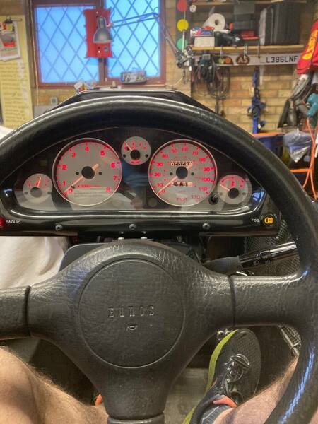

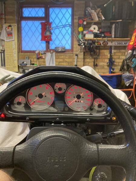

the tester wasn’t happy that the top of the speedo was obscured by the steering wheel
so the instrument cluster had to be lowered by a couple of cm
much better (although completely pointless if the driver happens to be taller than me)
anyway, another tick on the list

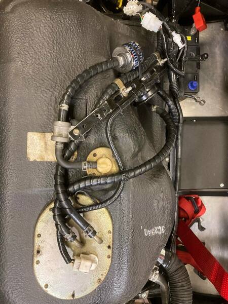

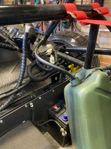

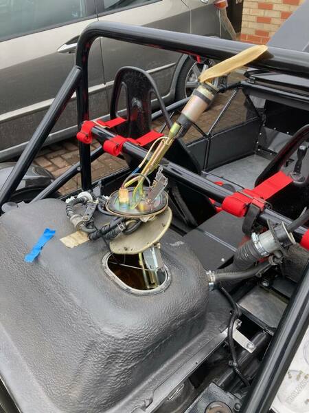

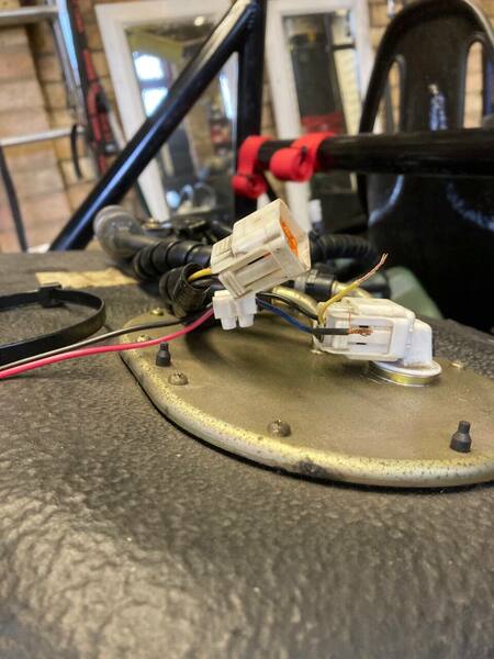

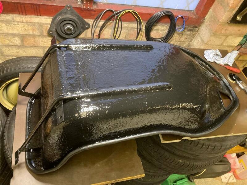

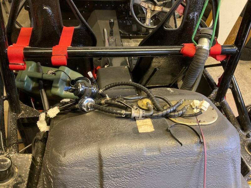

and employed some very dubious methods to drain the tank
fuel pump powered up from the 12v supply for my garage radio
car battery disconnected for 'safety'
managed to squeeze about 25 litros out of it which i dumped into the mx5, now i can crack on with sorting the fuel filler that the iva man didn’t like (it's that flexible pipe in the second pic that is the problem, sold as iva compatible but apparently I have a picky tester :( )
