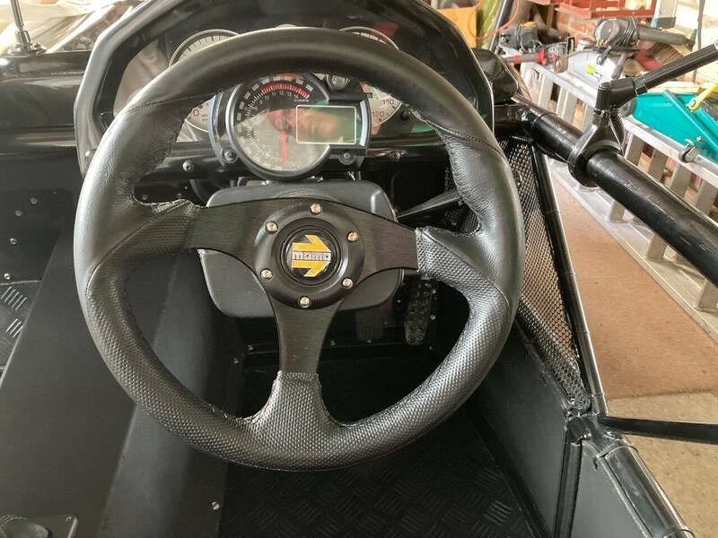

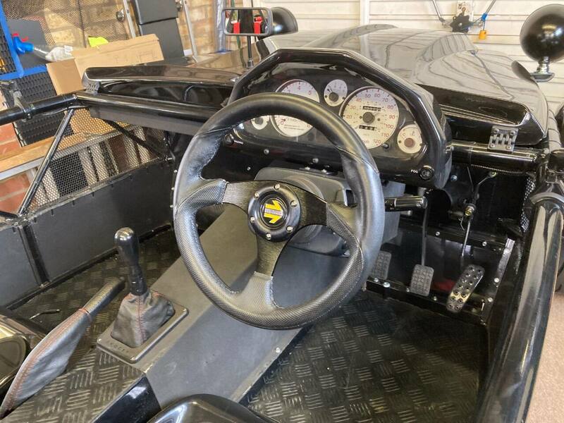

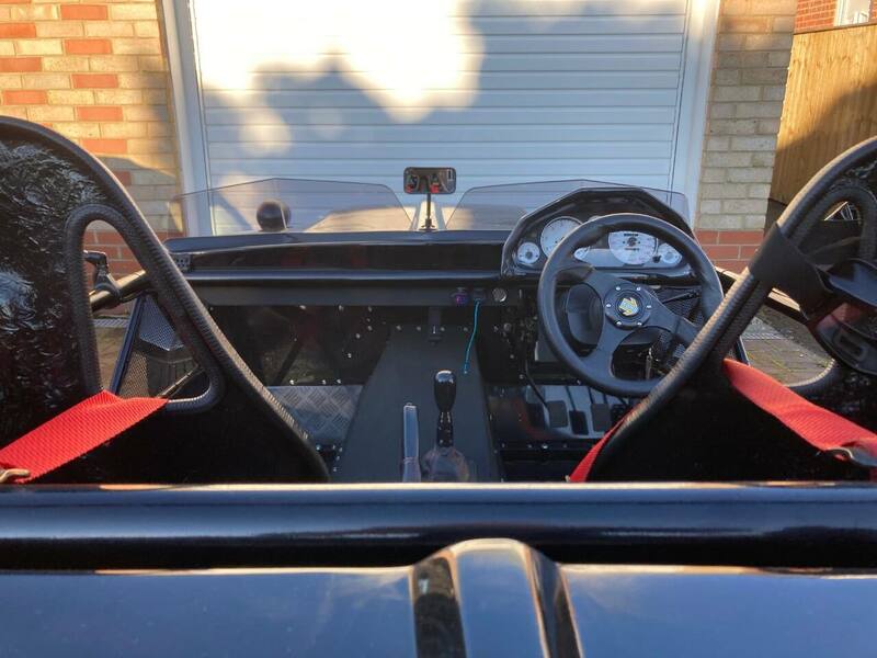

it might not be immediately obvious from the photo but with the smaller steering wheel fitted, the speedometer is quite badly obscured :(
not a major problem as i’ve been using a gps speedo in my phone but a better solution is needed.

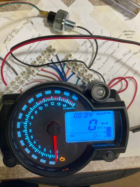

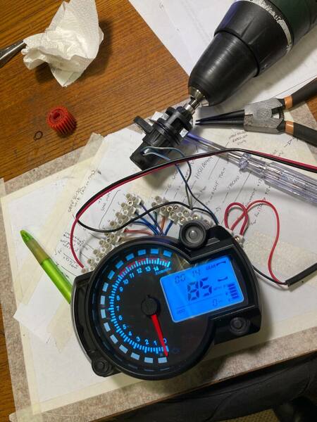

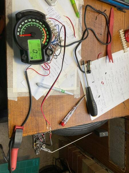

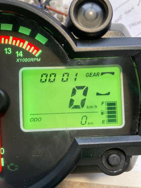

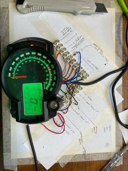

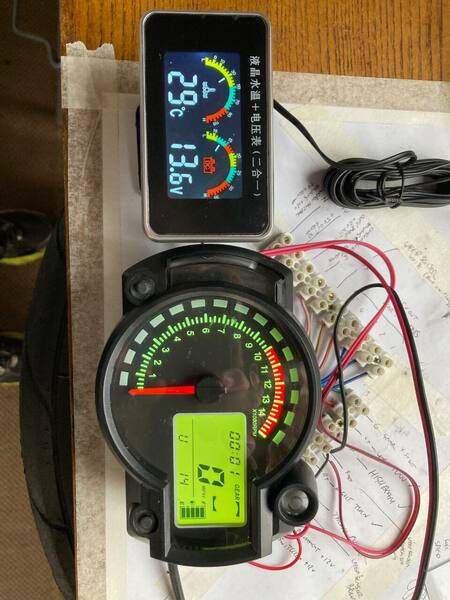

a bit of googling had me the wiring for a genuine Koso unit, unfortunately, as this is as genuine as a £3 note, that didn’t help :(
trial / error / educated guesswork got me a few clues but i was struggling.

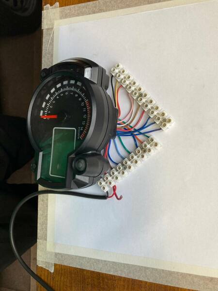

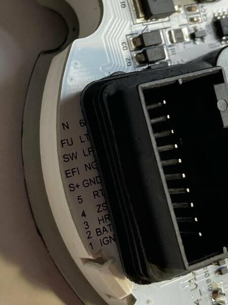

maybe there will be a model number somewhere inside ?
ooh, we have a bingo !
this made me very happy

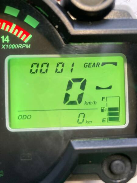

i hooked up the speed sensor and wiggled the magnet in its face and it responded (no pic as not enough hands)
then i remembered a spare fuel sender from when the fuel pump died

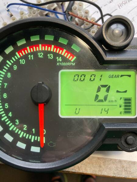

but the big question was how in the hell to program the thing ?

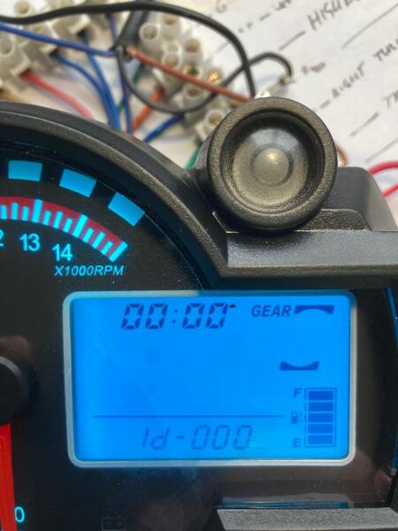

nothing i could find on the web would work, i eventually stumbled upon this
some sort of pin code ? ok, this may take a while
except it didn’t, i started with 111, then 222, turns out that 888 is my lucky number :)
that is 14volts btw
so we’ve got speed and fuel sorted, let’s have a go for revs

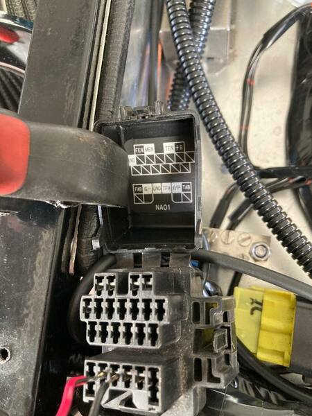

the mk1 mx5 has a very handy ignition pulse in the diagnostic connector, i pinged (pung?) open the Exo’s wiring tray and got hooked up
ok, fire it up
not sure about that very digital needle movement but for a tenner each (yes, the other one works too) i’m pretty pleased with that.
should make a big difference once fitted
then i can get the windscreens on
just call me the King of Speedos !
just not like this guy

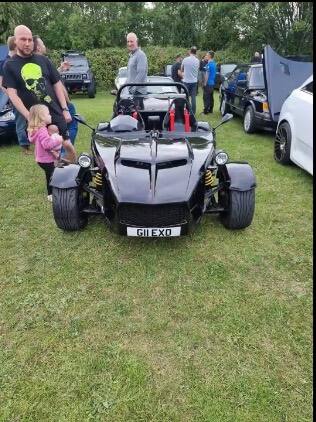

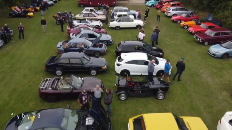

Exo also attended its first car meet at the North East Restoration Club, held in Washington, Tyne and Wear, first wednesday of the month.
this gives a good idea of the variety of cars there and a really friendly bunch of folks

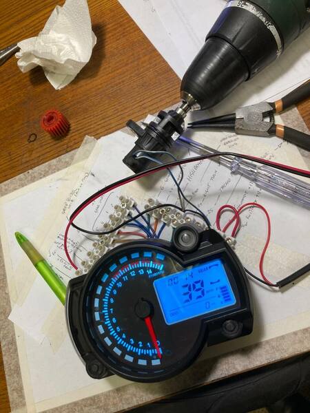

next up is the speed drive - my mk1 gearbox has a mechanical drive but i’m told a mk2 electrical drive will swap right in
best test it first - fetch the drill (yes, that drill ) and give it a spin
more beans
maximum beans
excellent, it bloody works !
calibration might be a challenge but i figured out the sender gives 8 pulses per revolution, somehow i need to translate that into rotations of the wheels

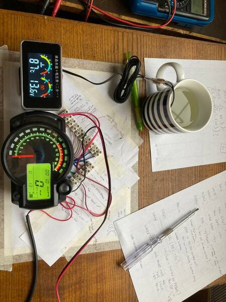

so i’ve got most dashboard functions accounted for, just temperature and volts to go and i can have a go at installing the damn thing :)

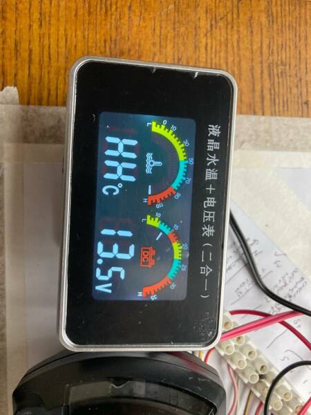

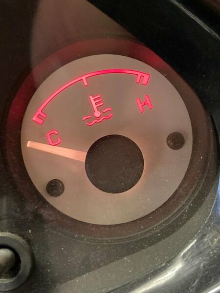

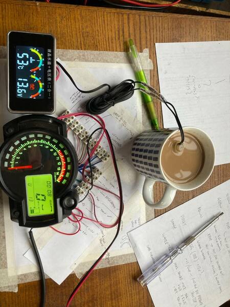

more tat essential components arrived this morning

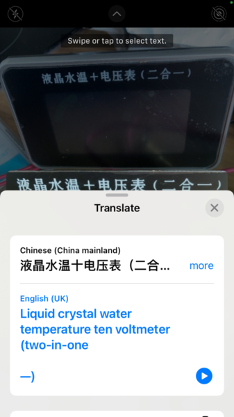

it’s a neat little gauge but i wasn’t expecting the message printed on the top of the screen - i wonder what it says ?
no chance of confusion there then
let’s get it wired in and see how it looks
not too bad, it is pretty warm in the garage today
coffee 53oC seems about right
freshly boiled water 87oC is maybe a tad low but in the right ballpark
fire up the heat gun and test the alarm
it starts flashing and beeping over 95oC although seeing as i can’t hear the exhaust for wind noise, the beeper might struggle :)
only a few more bits needed and i can look at installation

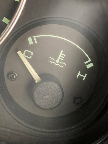

Good work! I'd be tempted to wire the oil pressure light to a separate (red!) light elsewhere as, because you're used to Japanese vehicles, you'll be well used to the orange glow of an EML so may well miss the engine shitting itself assuming it's just because the lambda sensor woke up grumpy. Again.

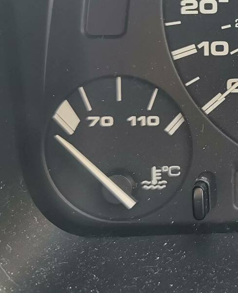

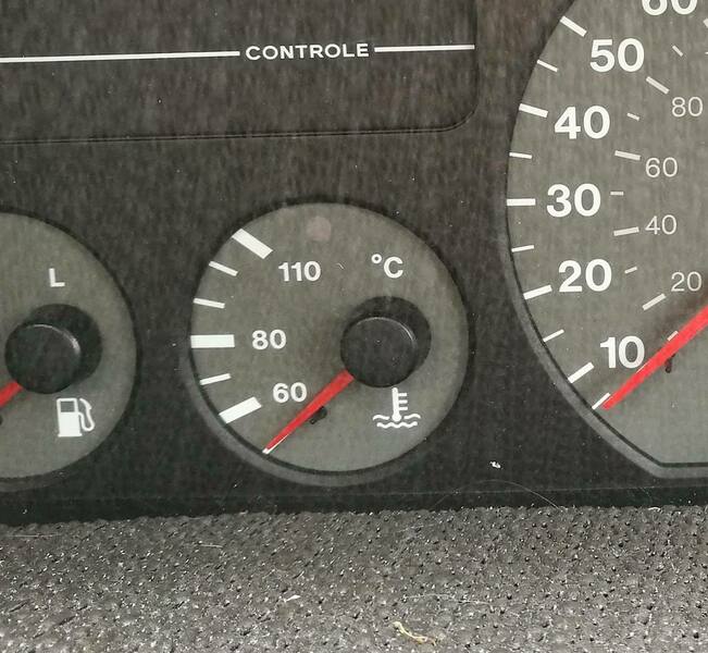

Have you a link for that temperature guage? My van is minge spec and doesn't have one. I bought one from ebay which did inside and outside temperature but it was a total pile of shite and not fit for purpose.
Bit of an odd range on the temp gauge.  Looking at the two I can remember off the top of my head which show numbers, there's the one in the Caddy which reads 50-130C (about 1/2 a needle's width below 90C being normal running), and in the Xantia which read 50-110C, normal on that being around 70C l, though the cooling fans didn't kick in until around 90 in traffic.
Will still work obviously but could cause a little undue alarm given how close to the red bit you're always going to be.
the mx5 gauges don’t have a scale, but tend to hover in the middle unless things are going particularly wrong
the only time i’ve seen this one move from its central position was moments before this happened
maybe a little more warning would have been handy :)
i’ll see how this one works out, nothing is exactly permanent where the Exo is concerned so, if it’s a pain, i’ll find a plan B

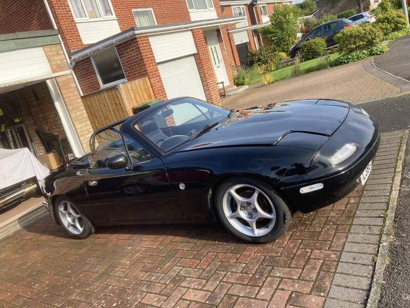

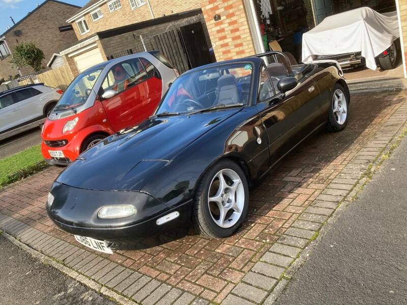

the mx5 got its annual bath
scrubs up pretty well
then me and @DVee8 convoyed to a local car meet
where they both attracted a good bit of attention
me and dvee8 jr got papped on the way in

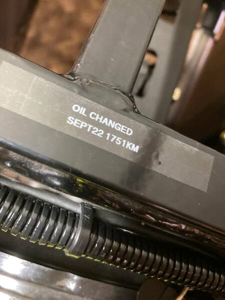

the exos odometer is showing 1751km so i’ve racked up just over 1000 miles in its first two months on the road - time for an oil change
access is certainly a lot easier :)
service history updated

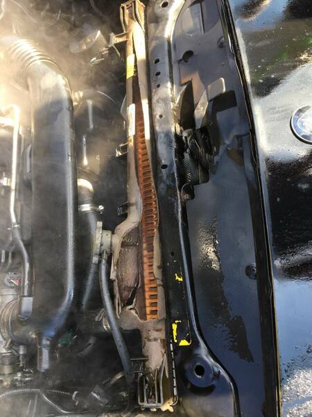

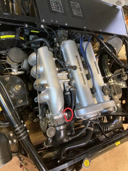

and i gave the engine a quick clean - shines up a treat
the two month old oil was pretty dark, glad i didn’t leave it any longer. i’ll maybe do it again before it comes off the road for winter.

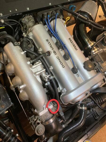

I'm trying to work out why you've circled the throttle body with a red marker.
i really should sort out that little bodge - it’s just unused two vacuum ports that need capping off - a short length of tube is ideal :)

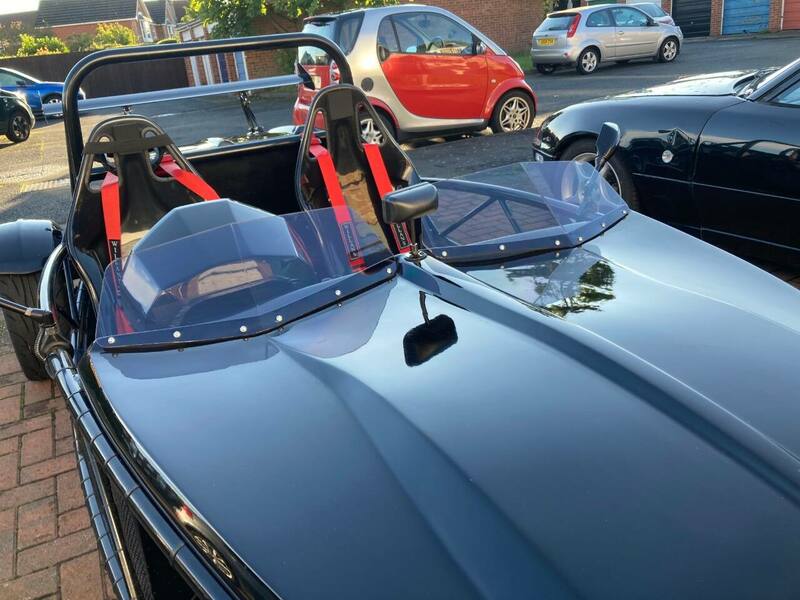

i’d booked the day off for a trackday but seeing as it was chucking it down, i spent the afternoon in the garage instead.

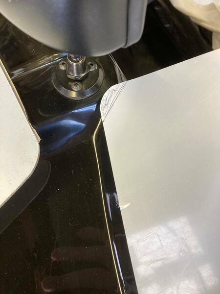

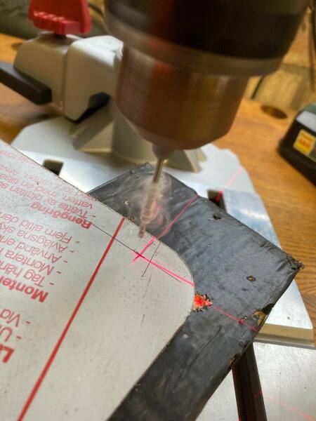

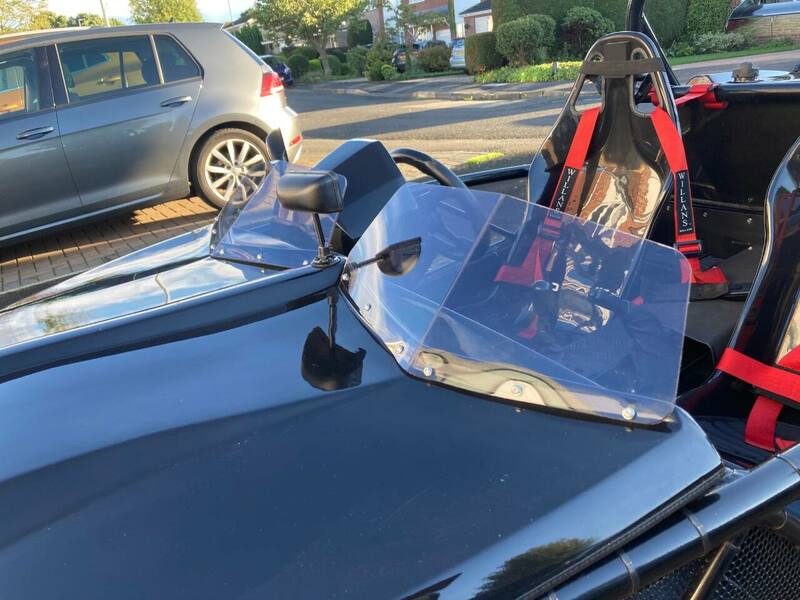

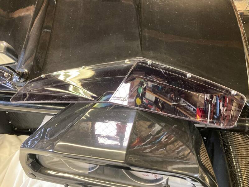

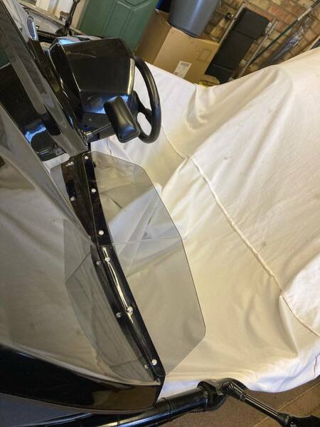

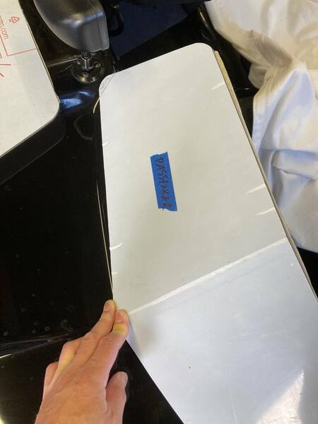

let’s have a go on these “windscreens” then
needed a corner chopping off for a good fit
holes drilled with laser precision ! and no injuries
passenger side fitted
same again for the drivers side but hit upon a minor problem
the bonnet won’t open anymore :(
i knew this would happen but will be solved when i fit the digidash
looks pretty good though
and the big question - do they make a sod of difference ?
a quick test hoon was deemed necessary, and the verdict is a thumbs up 👍 there is a noticeable drop in wind noise and it’s not quite* as cold :)
passengers should feel the most benefit, i shall locate a volunteer and report back in due course

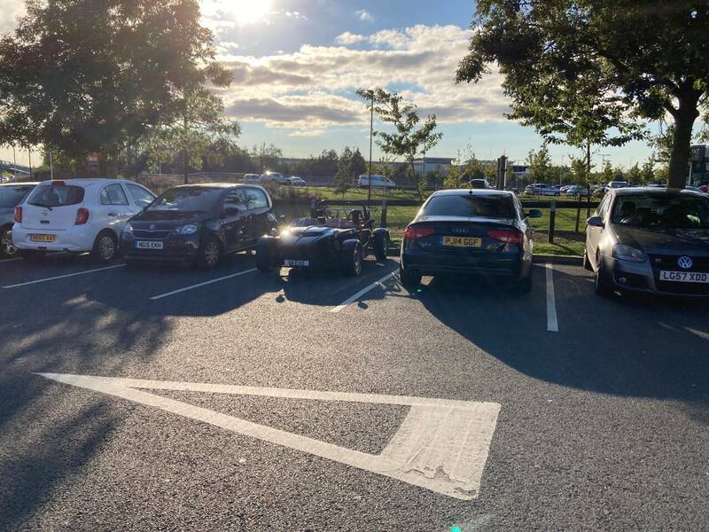

it crossed my mind that i should check my tyre pressures on the exo - 24.5psi on the front and 24.0 on the rear were both a tad low (and probably contributed to my heavy steering feel) so knocked them up to 28 all round and went for a drive. the difference was immediately obvious, the steering felt much better but the back end was much looser than previous, i’ll probably drop them to 26 and see how it goes.
the sun was out so i headed for the coast and had a pleasant drive along the sea front from sunderland up south shields, through the tunnel then rejoined the coast from tynemouth through whitley bay and on to blyth
had a chat with a bloke who had “always wanted to build a kit car”, the dirty looks his wife was giving him across the car park perhaps explained why he had not achieved his ambition !
stopped for a mcpiss in the way home :)

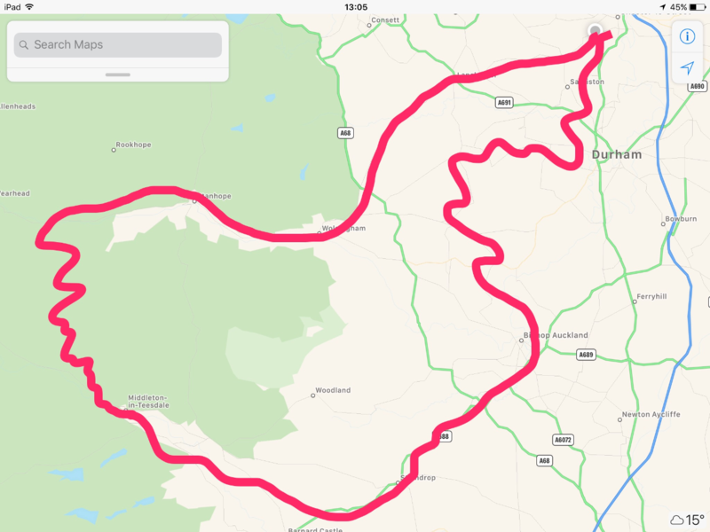

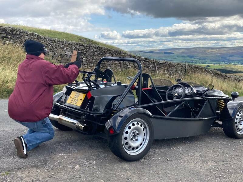

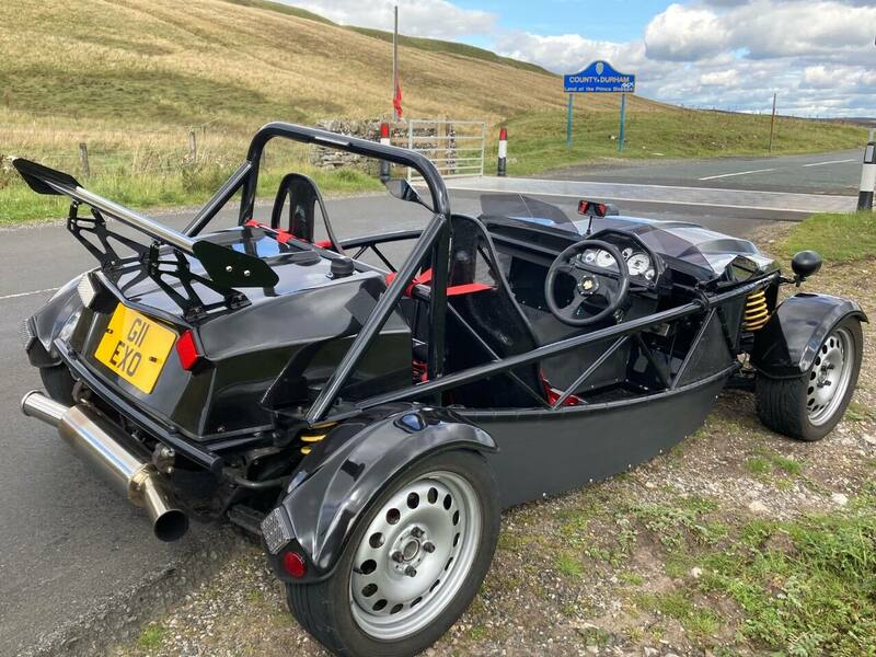

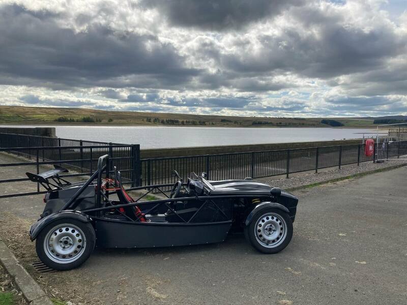

As the sun was shining yesterday, me and @DVee8 took the Exo out for a blast
the route was something like this, I'm not exactly sure as I was following dvee8s excellent directions, but involved some of the finest driving roads the region has to offer :)
we stopped for pics several times, much to the amusement of a couple in a campervan who we kept overtaking
Cumbria
County Durham
looking down into the valley near Brough
amazing clouds today
ace photographer at work

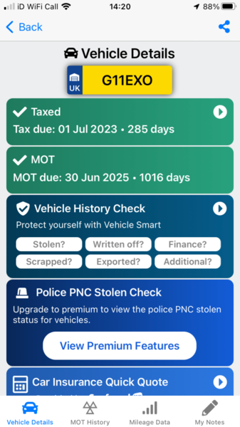

On 9/16/2022 at 5:38 PM, gm said:
doesn’t need an mot until  june 2025 !
why dis m9?
4 minutes ago, hairnet said:
why dis m9?
 it is registered as a new car so the first mot is after three years - by which point it will barely resemble the car which passed the iva !
