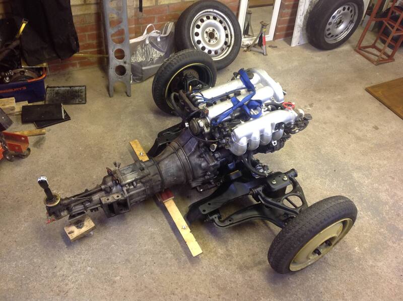

front subframe lifted down from the workbench and positioned atop a spare steelie
wheels fitted, removed again, brake discs fitted then wheels refitted as studs were too long for wheelnuts
I'm not sure this will be much of a problem just yet !
engine swingy time (thanks again to @garbaldy for the loan of his engine crane)
the engine mounts sit in little protective boxes which need held in place whilst fitting
target acquired
incoming
wheels off again so I can raise the subframe another wheel height (too heavy to lift)
and quite a bit of pushing and shoving and we have consummation
Wheels back on and we have a problem - with no shocks fitted, the wishbones just flex upwards and the subframe hits the deck :(
but remember these ?
boom ! I am a problem solving god ! (or have at least read the build guide)
why are they covered in tape ? Just so they don't look shit :)
so we have an engine / subframe assembly that (in theory) is capable of standing on its own two wheels and being rolled around the garage
and it's only taken three months to get here !

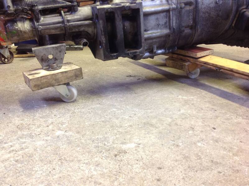

a bit more 'woodworking'
@loserone 's bed slats coming in handy again
and it's mobile ( I wonder how hilariously bad it would handle running on a full set of spacesavers ? might have to find out - I only need one more :) )

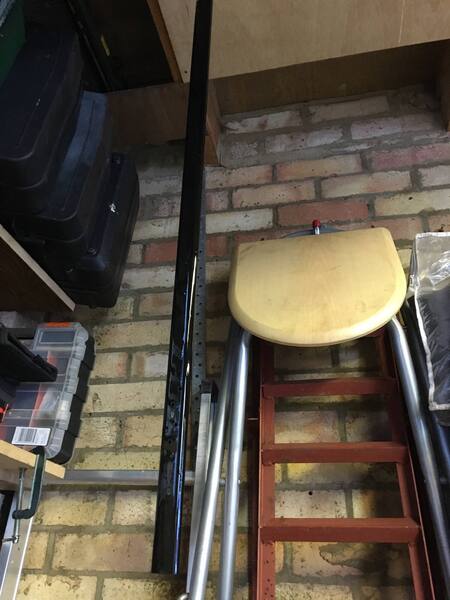

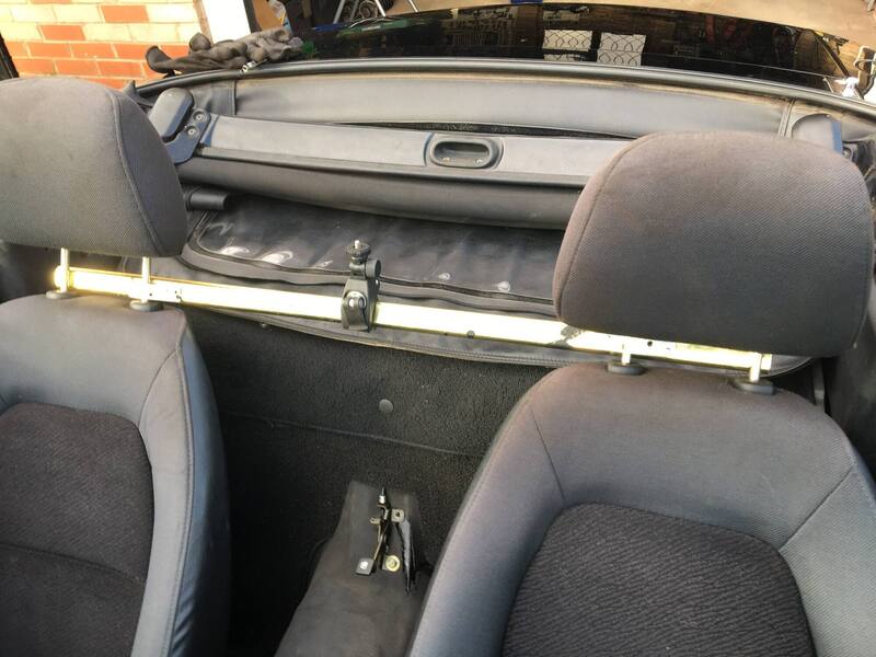

When I removed the roll bar, I hadn't considered where to mount the GoPro to record Mondays track nonsense
so a solution was engineered
an old wardrobe rail and a couple of brackets and we're all set
a quick coat of Lidl valu paint and call it a proper job :)
