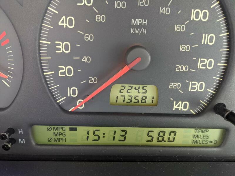

Lacquer Peel Posted September 20, 2020 Author Posted September 20, 2020 How does one improve faded 23 year old black metallic paint? In other news I replaced a <10k mile wheel bearing because it was getting noisy. The hub nut was ridiculously tight after I paid a garage to do the CV boot, did that kill it? I did a gentle tank and it managed 54MPG brim to brim calculated (the readout is close). Not bad for rattly old relatively heavy diesel car. juular, Split_Pin, Shirley Knott and 4 others 7

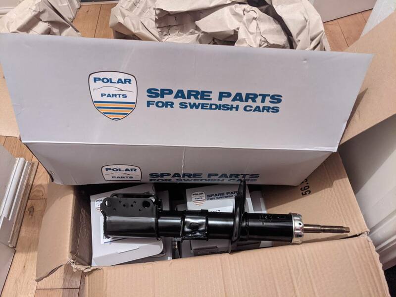

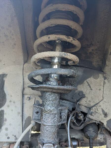

Lacquer Peel Posted October 11, 2020 Author Posted October 11, 2020 The van engine belgian/swedish banger has misbehaved. Its nearside shock absorber lost all of its oil and became quite unsettling to drive, shuddering and shaking over every bump. @sdkrc kindly offered his Car of the Future as a loaner while I sorted it out. @juular helped to remove the bad strut and kindly lent tools. Once the strut was off it was clear to see it was fucked, big time. I wonder how long it's been ropey because driving around roundabouts it kind of felt like the front wheels were shifting about. It's almost back together now but I had to sacrifice the anti roll bar drop links in the process so I'm waiting for them. Jim Bell, RayMK, The Moog and 5 others 8

reb Posted October 11, 2020 Posted October 11, 2020 What else have you got in that box of goodies? I renewed the front suspension on my 850 with bits from Polar Parts last year, they seem decent quality and very reasonable prices! Lacquer Peel 1
Lacquer Peel Posted October 11, 2020 Author Posted October 11, 2020 15 minutes ago, reb said: What else have you got in that box of goodies? I renewed the front suspension on my 850 with bits from Polar Parts last year, they seem decent quality and very reasonable prices! It's good to hear the parts are okay, after I bought them I found mixed reviews. The big box of goodies contained two shock absorbers, bump stops (for an Opel, old ones reused), gaiters, spring mounts and top mounts. Jim Bell 1

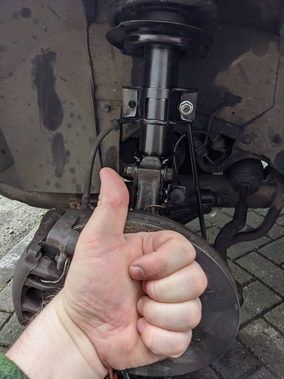

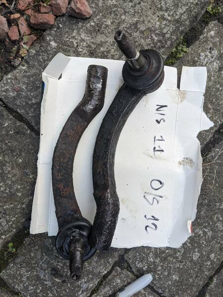

Lacquer Peel Posted October 16, 2020 Author Posted October 16, 2020 The new struts are in but I had to sacrifice the anti roll bar drop links. The new ones took ages to arrive. All good with the struts. Not good with the track rod ends. Hopefully two of ECP's finest* track rod ends will be fitted tomorrow.. Dave_Q, HMC, privatewire and 6 others 9

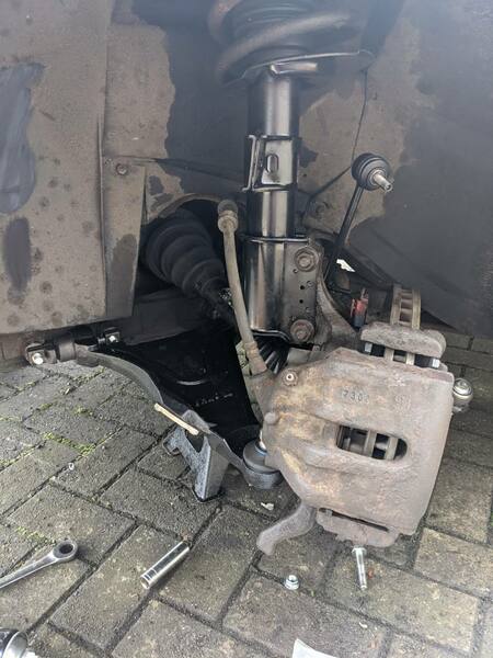

Lacquer Peel Posted October 21, 2020 Author Posted October 21, 2020 It lives! Two struts, a wishbone (cursed balljoint that is integral with the wishbone), track rod ends and anti roll bar links later I drove it into a kerb earlier this year in the snow, I didn't think it did much damage... Changing the wishbone is a right pain in the arse, it's the four bolt type with bolts running through the subframe to threads in the bushes, you have to loosen engine/gearbox mounts and jack up the engine to access the rear two bolts, and also move the hub out of the way so you can line those threads up with the bolts. It's a three handed job. I took the scenic route north to test it and it drives so much better now, the steering is more responsive and smooth, it doesn't wallow and wobble over bumps, just a much more stable and comfortable car. However it feels like there's a bit of bump steer, could that be caused by the tracking which is a bit off? I also fitted a Rovelo tyre in haste and it seems to be made from teflon. Twiggy, sdkrc, Shirley Knott and 10 others 13

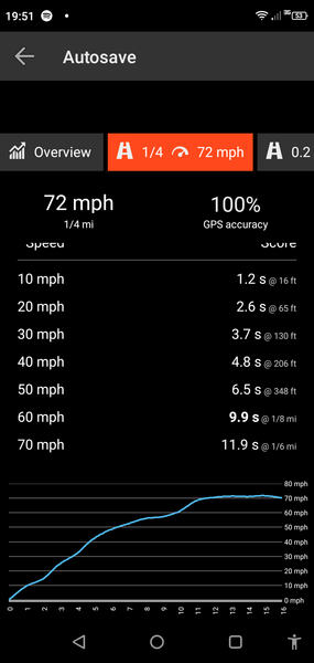

Zelandeth Posted October 21, 2020 Posted October 21, 2020 On 8/7/2020 at 8:06 AM, Lacquer Peel said: Frankly I'm a bit of a car luddite but I don't suppose it can go on forever. I like the comfort of the Volvo and its mostly mechanical engine that I can fix myself. Aye it has dynamic pump timing, I am not sure mine is 100% right as I don't think most garages have the Volvo software but it goes well enough and the MPG readout is almost bob on unlike the VAG ones which tell you you're covering 15 more MPG than reality. The 0-60 time below is only .3s off the Parkers figure. What software is that you're using?
Lacquer Peel Posted October 21, 2020 Author Posted October 21, 2020 5 hours ago, Zelandeth said: What software is that you're using? Drag Racer. Zelandeth and Stanky 1 1

Lacquer Peel Posted February 26, 2021 Author Posted February 26, 2021 This car has been going well, except for a ball joint that showed lots of play only a few months after being fitted. Unfortunately it's integral with the control arm and these "4 bolt" control arms are a pain in the arse to remove, you have to jack the engine up to allow just enough access. Full refund for the faulty part though, fair play. I drove it for a lockdown compliant trip to see my family and it averaged 58MPG. I was taking it pretty easy but going quicker than the lorries. The readout is very accurate unlike VAG ones. It was also quite good in the cold weather, with its heated velour. I did reduce the tyre pressures to help it through the deep snow we saw here. I treated it to a tuning box and the results are quite impressive. Initially it was slower with the box fitted but playing with the settings resulted in a 0-60mph time of 7.8s down from between 9.1s and 9.6s as standard. I could make it go quicker but this seems fine to me - minimal visible smoke, and it feels much punchier overall. Shirley Knott, scdan4, gm and 13 others 16
