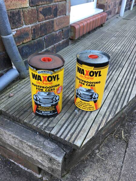

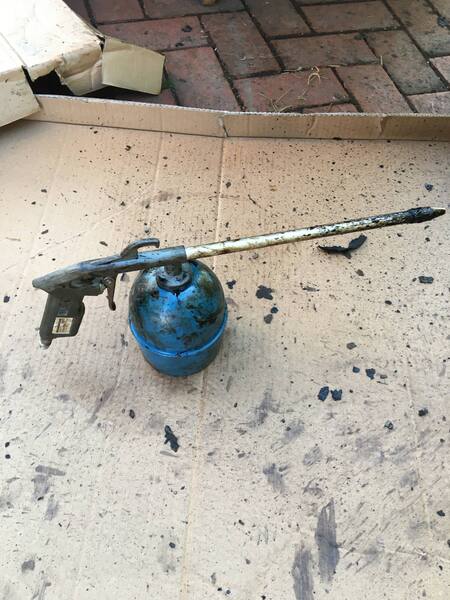

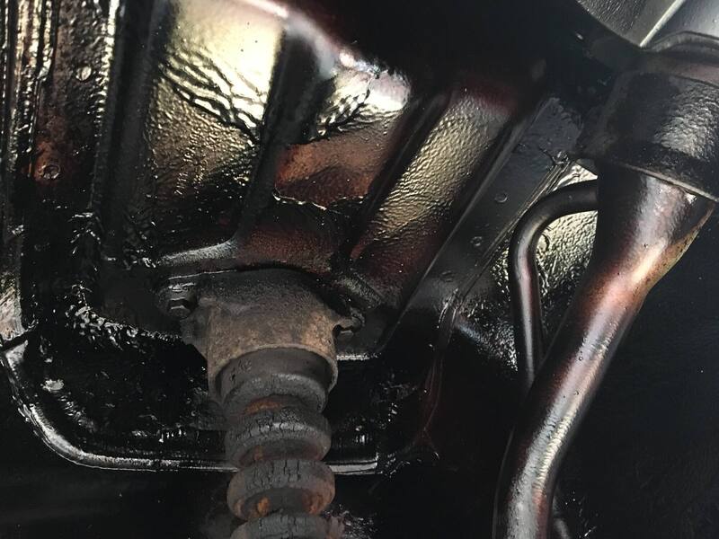

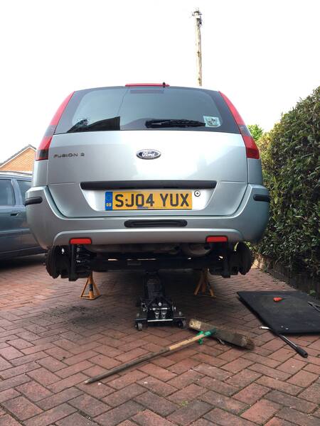

Lankytim Posted May 9, 2020 Share Posted May 9, 2020 The wife’s Fusion had an advisory on rust near the rear suspension mounts for its last MOT, as I didn’t have much to do yesterday I thought I’d have a go at treating it. I had a can of Waxoyl dating from the early 2000s so I fired up the compressor, found the oil gun attachment thing (Aldi special) and gave the whole rear end a thorough dousing after thinning it out with petrol, I used the long lance to get inside hollow sections the best I could and it seemed to cover really well. I’ve got another can of Waxoyl and may do the front end when I can be bothered, although this time it’s clear rather than black. The result looks quite nice, and should bring a tear to the MOT testers eye- best of all it wasn’t nearly as messy as I though it would be. It gave me an idea of using this oil gun more often and maybe experimenting with other rust proofers. Wax oil is the old favourite but apparently isn’t rated by many in the old clunker world. Do any shiters have a favourite? I’ve used Dinitrol before but it was very messy, do people still recycle sump oil and spray it around the underside of their cars or is that something from a bygone era? The Old Bloke Next Door, paulplom, spartacus and 7 others 10 Link to comment Share on other sites More sharing options...

TrabbieRonnie Posted May 9, 2020 Share Posted May 9, 2020 Looks like a good job there, I think waxoyl's ok if you haven't much rust to start with. I would never use it again, as on my old shite it has only ever served to trap water against the metal when it ineveitably dries out, making it rust worse rather than preventing it (see my poor old jeep). I did see it applied to a pal's pickup truck, we warmed the stuff up thoroughly first, and the thing was clean as a whistle to start with. It did the job fine then, and looked perfect even a couple of years later. Rustoleum, and good thick grease applied with a brush is my chosen method now, a pain in the arse to do though. Link to comment Share on other sites More sharing options...
