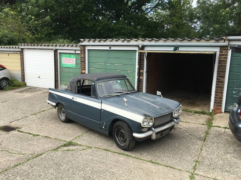

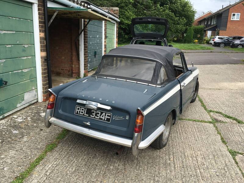

Dick Cheeseburger Posted June 16, 2020 Posted June 16, 2020 2 hours ago, Three Speed said: I mentioned my old Vitesse in another thread and was asked to show a picture of it. I got it from a friend in the '90s. He had bought it from a friend of a friend of mine. It had been in a shunt, having been squashed between a bus and a bollard. We swapped the rear body tub for a less squashed but more rusty one. When I got it I had the rear wings and doorskins replaced and had it sprayed in gunmetal which was the original colour of the original car. This was all around 1993. I fitted the hood myself (which its why it's a bit wonky) and all was well. I must have sold my 1966 Triumph 2000 to make way for it and it was my daily driver for a few years. We took it on a very wet Practical Classics Treasure Hunt in France once. Despite arriving late because we missed the ferry we won. It's a 2 Litre Mk1 which means it has the swing axle rear suspension and not quite as much power as the Mk2. Lovely smooth engine though. I do have an overdrive gearbox for it but never got around to fitting it. These pictures were taken just before I sold it to my brother last year. I wasn't using it much and it was just sitting in a lock up festering. My bro didn't like the wheels so it now has Mk4 Spitfire rims and these 5.5Js are now on my Herald. He says it drives better on the thinner tyres. I don't seem to have any photos to hand with the roof down but that is the way to drive them. Great to see the photos of it! Interesting back story too - glad you managed to keep it in the family after all this time. As for the 5.5J rims, your brother missed a trick- they look so good on both Vitesses and GT6s. At least they've beefed up your Herald a bit in the meantime!

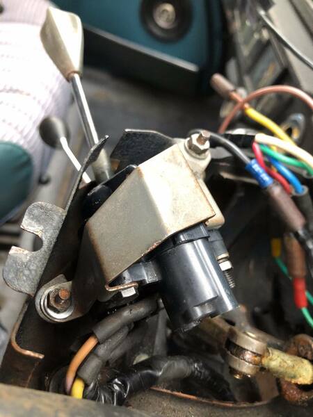

Three Speed Posted June 21, 2020 Author Posted June 21, 2020 A run out in the DS today confirmed the fix to the voltage regulator has worked and the ignition light stays off at idle. I imagine it was cleaning up the earth that did it rather than painting it. The rev counter is now very stable and consistently reading much too low. Beforehand it was erratically bouncing between right and low. It has a 123 distributor which reportedly does not agree with a Jaeger rev counter. There used to be a box you could get to make them work together but last time I checked it was no longer available. If it works right when the regulator is poorly earthed maybe I just need to stick a resistor somewhere. Significant odometer reading. Life begins at 40k. Jim Bell, Coprolalia, LightBulbFun and 2 others 5

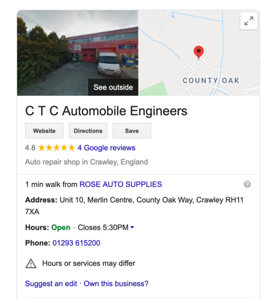

barrett Posted July 6, 2020 Posted July 6, 2020 Okay, here's the details. Speak to Guy - tell him I'm Gary's mate as I don't think he'll remember my name!

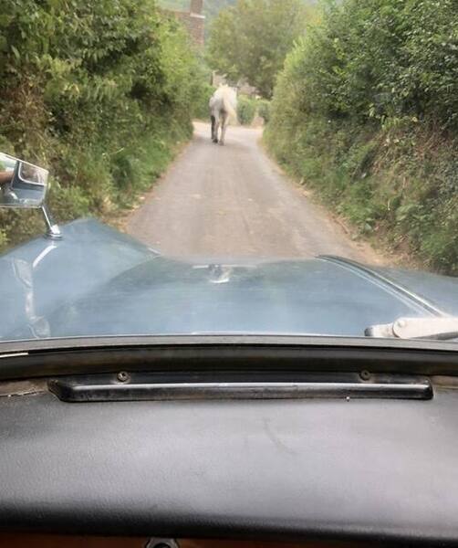

Three Speed Posted August 15, 2020 Author Posted August 15, 2020 We came across two things that are quite typical of Devon roads. A camper van and a horse. spike60 and Jim Bell 2
