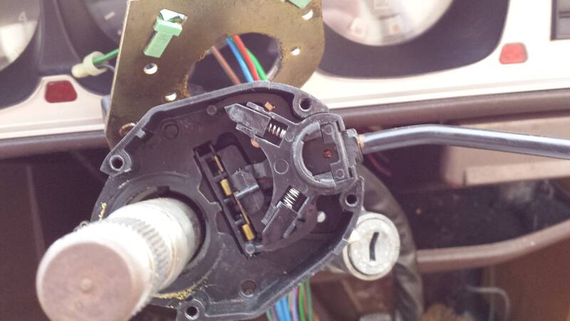

I took the indicator switch off tonight and hussah, problem found.
Those three copper contacts and the spring that contacts them were very dirty, gave them all a clean with some fine sandpaper until they shone and tested to make sure I had power on one of them, then held the switch in place to test - I've never been so pleased to have working indicators.  I'd previously refitted the crusty old relay Noel mentioned above while trying to troubleshoot the issue and it does still work, however it's very quiet and doesn't sound right.  I fitted the new relay @vulgalour recommended which has a much better click to it.
14 hours ago, philibusmo said:
Taking it apart also releases a jack in the box of small springs all over the place, so look forward to that.
Sigh.  I can't say I wasn't warned, I managed to find all the bits but I ran out of time and patience for getting it to all stay in place for more than two milliseconds.   Also one tiny spring then quietly vanished into thin air while I was trying to reassemble the mechanism but I managed to replace it with a shortened spring out of a clicky pen.  It actually works perfectly and I have spares now for when the other one inevitably pings off into some dusty corner of the cabin.

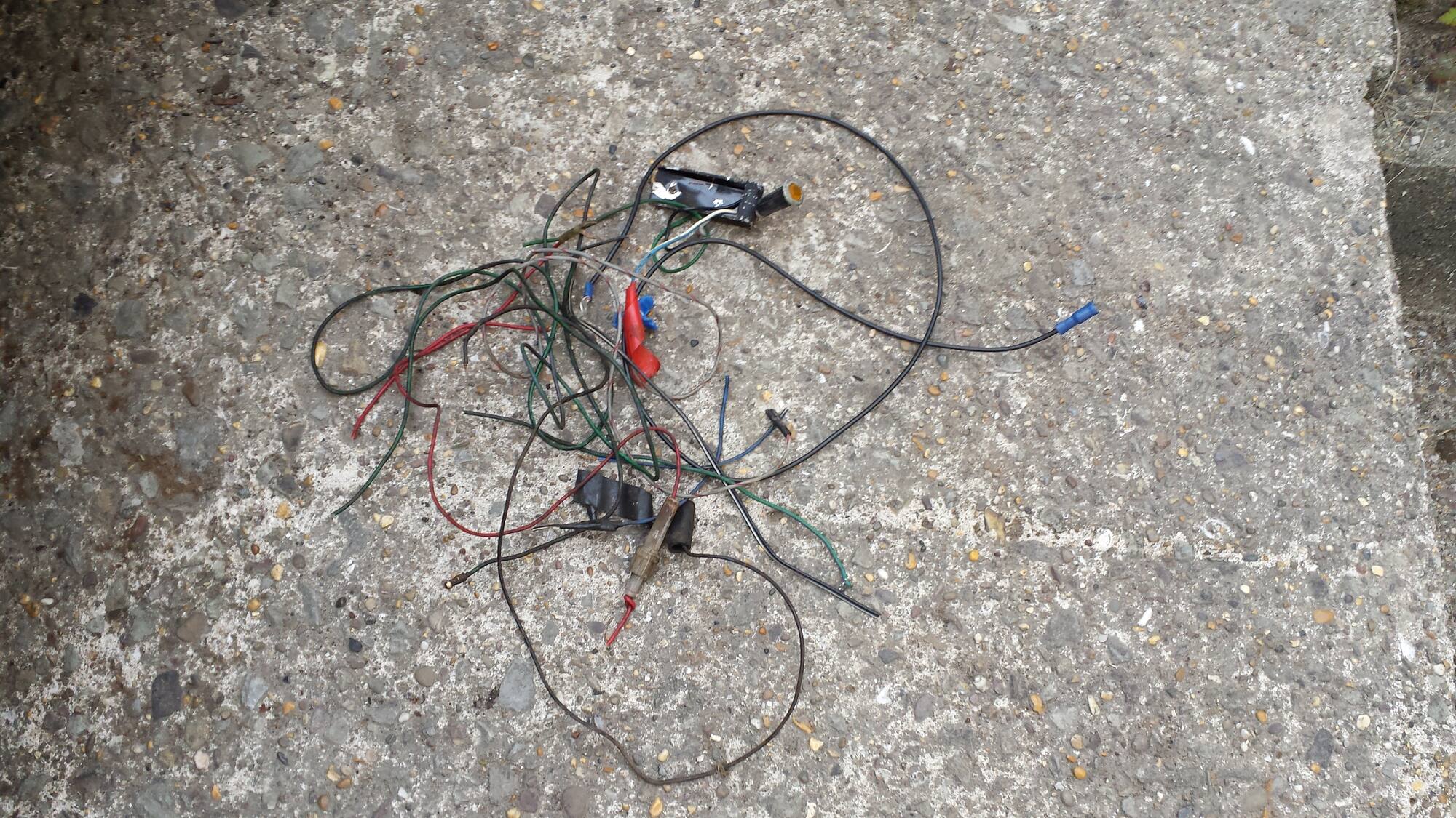

I'll have another crack at cramming the bits back together when I get time.  While I was under the dash I continued to extract the aftermarketing wiring.  This is quite satisfying work, I'm getting quite a collection of horrible old bits of wire now.
