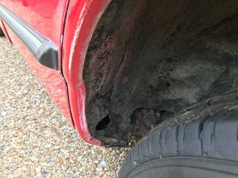

There’s not much more procrastination to do on the Sierra, I really should just stick it in for MOT and see what happens…
…probably fail on this rust.
It passes the poke test, but hey, if it needs it it needs it.
