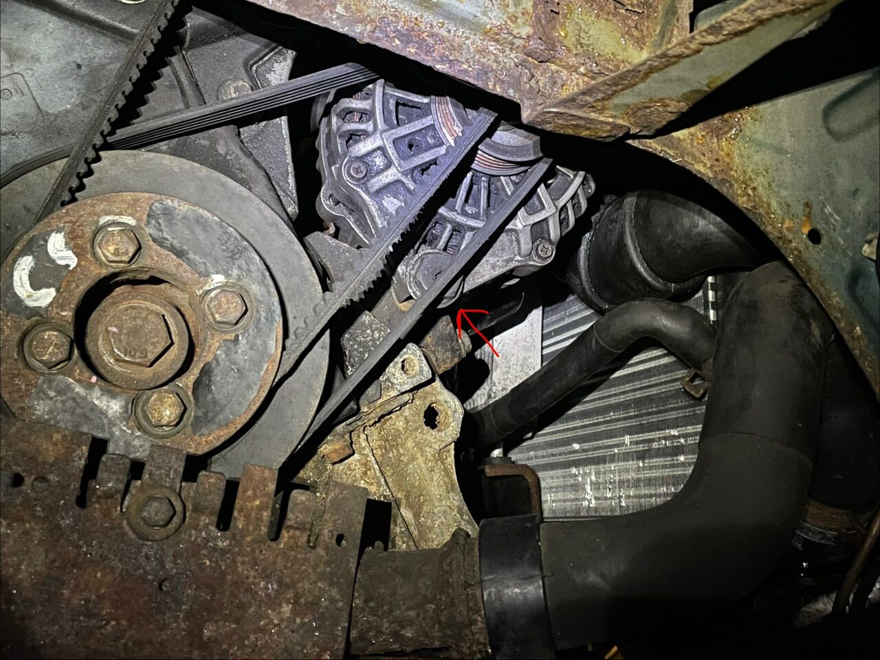

With the Volvo back on frontline duties I’ve been cracking on with the XM.
@Rust Collector  kindly sent a spare alternator of unknown health from his spares. The going theory, because #oldcars, was that the “new” alternator would be broken… but in a different and frustrating way and wouldn’t charge - as the old alternator seemed to be overcharging. This then leaving me with two duds of the one fitment type that is supposedly not DIY serviceable.
Because of the LHM pump the alternator had to come out downwards out of the wheel arch area. Not too much to remove other than the wheel (natch), arch liner and a subframe brace. If the car had an AC compressor I think this route would be impossible. It only took one session to get the old one undone, tapped off its bracket and manipulated out of the gap. Getting the replacement one in was a real pig! Try as I might, I could not get it to sit on its bracket without performing near Rubix Cube levels of logic movements, all holding an alternator in the air at arms length, round a corner, blind.

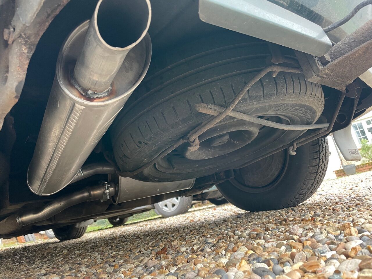

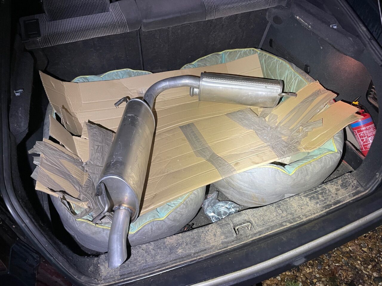

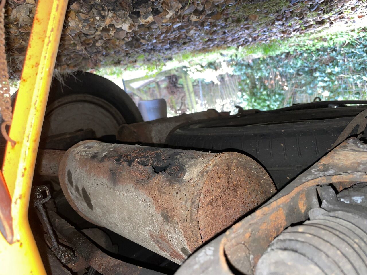

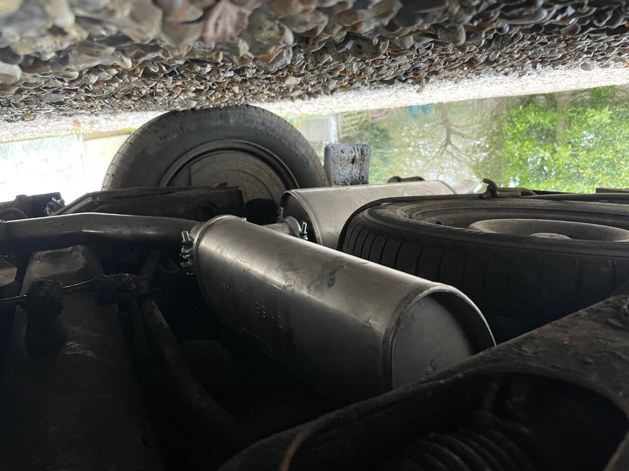

I’ve thought some more about the exhaust. This XM could do with a new middle (of three!) mufflers.
(will rotate this photo one day**
**probably won’t rotate)

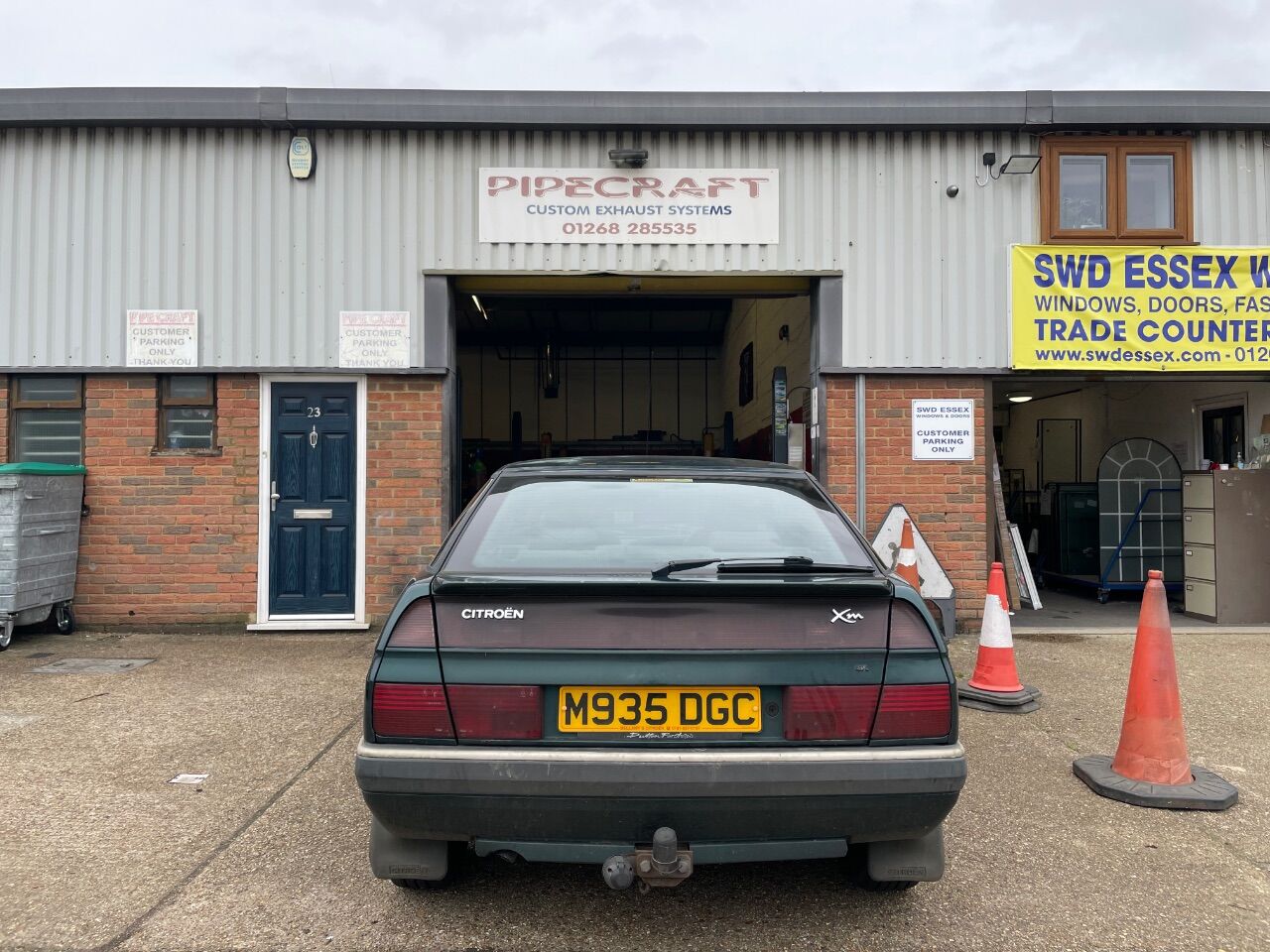

Since acquiring the XM I’ve been casually looking for an exhaust and I really think they’re not obtainable. Plenty for the 2.0L pez/2.1D, which I think are common and the same routing as what I need, but the turbo diesel I think I’ve read has bigger diameter pipes. I’ve bitten the bullet and have knowingly ordered the wrong exhaust from AutoDoc (so I may never get it or it’ll arrive way after the car has expired anyway) and the current plan is to take it to PipeCraft with a pack of biscuits, money and hope and ask that they can adapt it to fit.

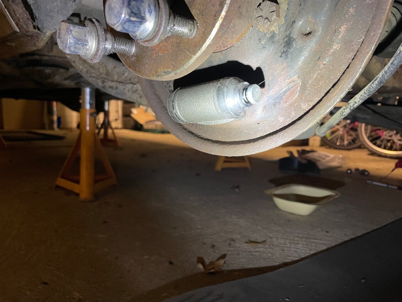

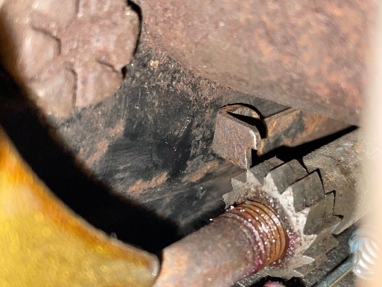

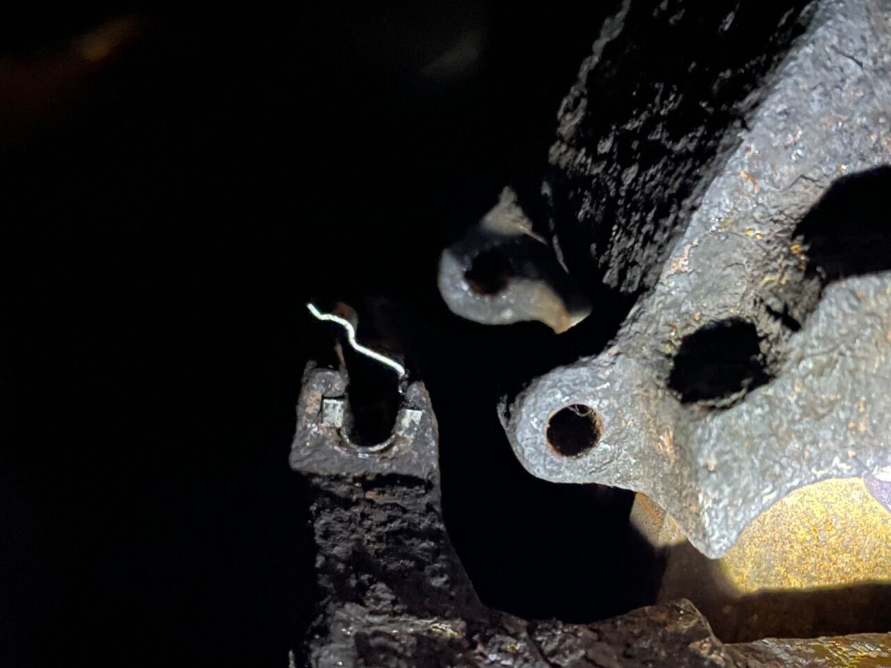

First of all I had to finish off the stuck calliper. I took it all apart, cleaned up the sliders with an oily rag and my kids toothbrush and put some raspberry coulis on the moving parts.
It was still, however, stuck as a stuck thing, that seemed to be the pin at the bottom.
(…The next series of pics are all upside down)

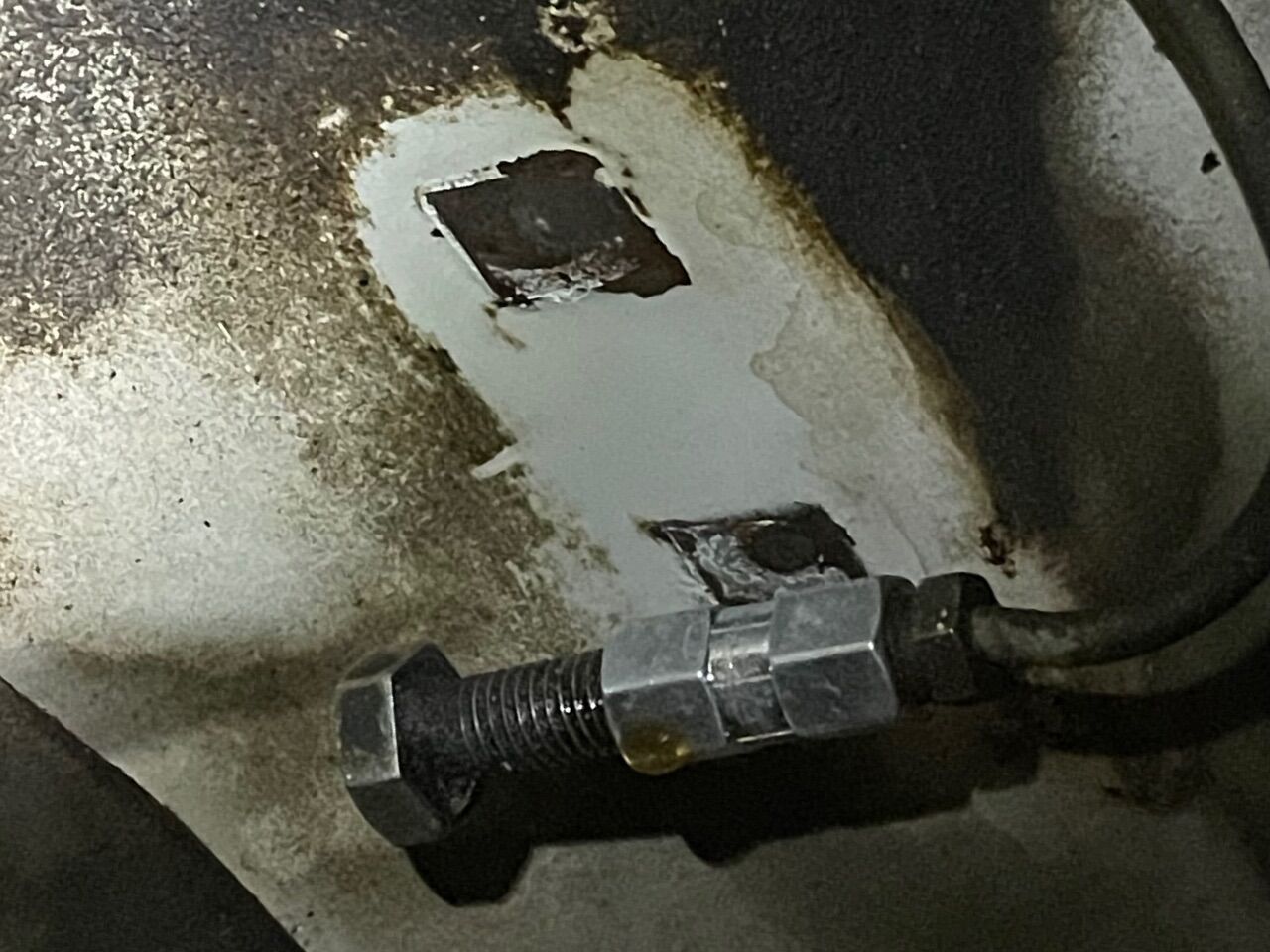

The pin goes through these holes and this stainless steel channel, but the pin itself didn’t fit!
I slid out the stainless insert and knocked out some rust flakes and filed down some of the swelling from the corrosion.
With the insert back in the pin fits the channel. Once re-assembled you can move the carrier in and out with just your little finger. Satisfaction.
