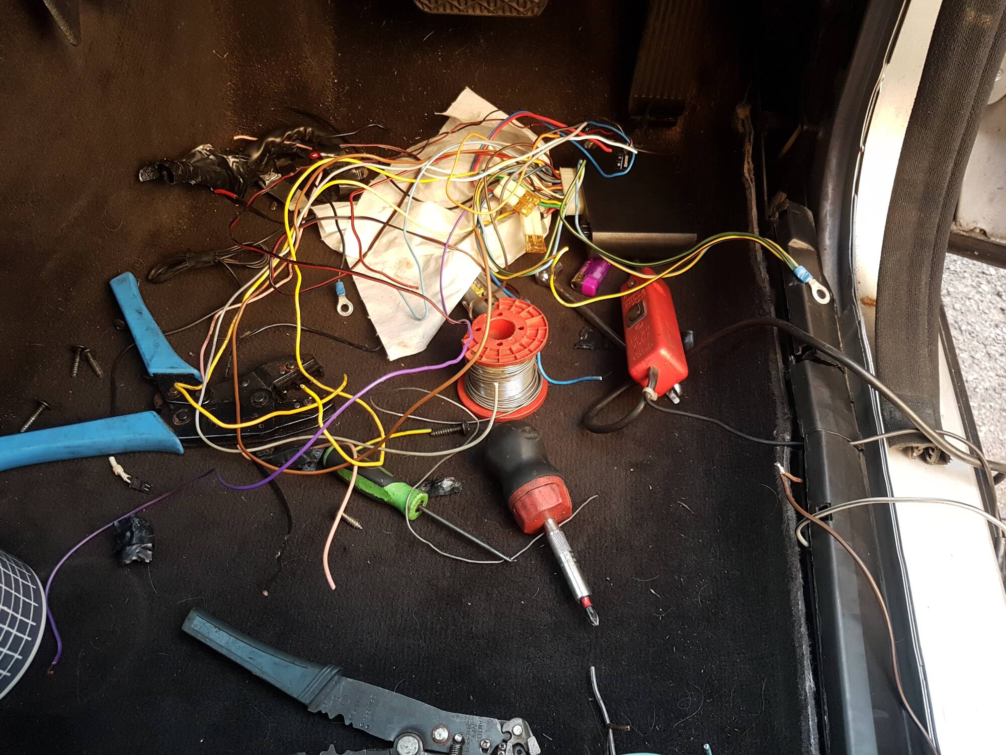

Today I actually did something to C280,  the last week and days have all just blended in to one another, I've found myself just sitting and relaxing, listening to the Bird song which is unusual for us having Heathrow airport, the M3, M25 in earshot, the sun was out for more than a couple of days  and  i have sat in the garden pondering life, it's been nice and all but the car has been waiting patiently since it arrived here, so this morning i got out and took a look at the first job needing doing,  the central locking was not working from the keys i have when I tried them in the door, I'm not convinced that the two front locks are from this car as they don't slide in as well as the other locks on the car, further investigation is required for the door locks but at another time, it looks like the car had been fitted with a Laserline alarm when new,  but no fobs came with the car so hunting the control box out was my next move, the lower cover driver's side came of easily exposing the alarms hiding place,  the alarm had been fitted almost perfectly with out the use of scotchlocks,  removed the fuse box cover in the engine bay and started taking out the fuse board's and relay holder thing, this gave me loads of access to the wiring harness,  lots of chopping off wire's and a little time later I had a pile of scrap
alarms come with many wire's mostly they are in one area but some go to do other stuff, this old Laserline alarm had a master key hidden in the back off the glove box,  so that lot came out too, the glove box lid and lock have been broken in a car break in before my ownership,  so I can see if I can at least repair it so it closes,  the previous owner just applied another piece of Gaffer/Tank/Race/whatever you call it tape when the old bit gave up, will be nice to have a fully operational glove box lid
With that lot removed it was on to fitting a remote central locking kit that has been sitting around since 2017 and I don't even remember what I bought it for originally?

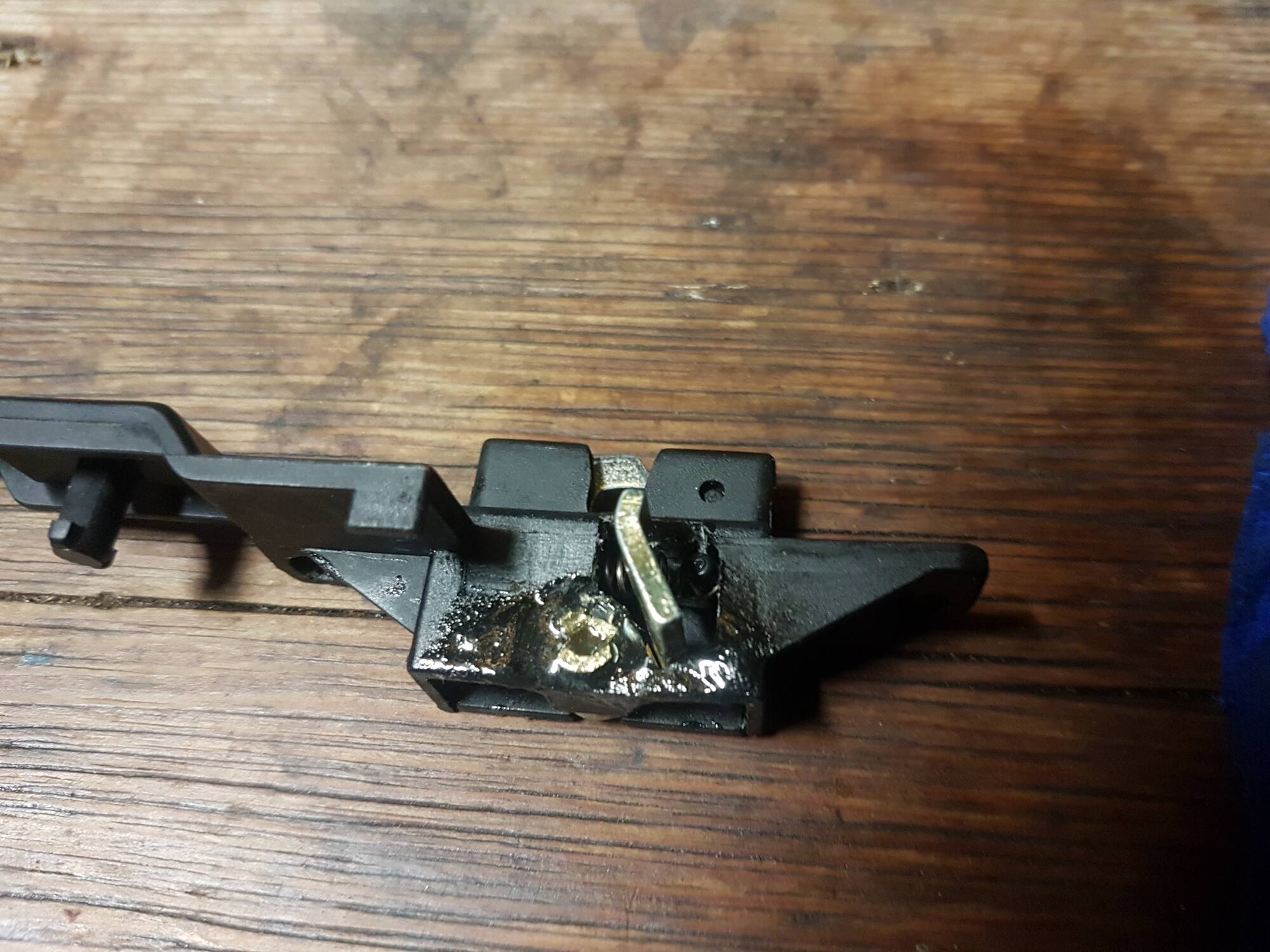

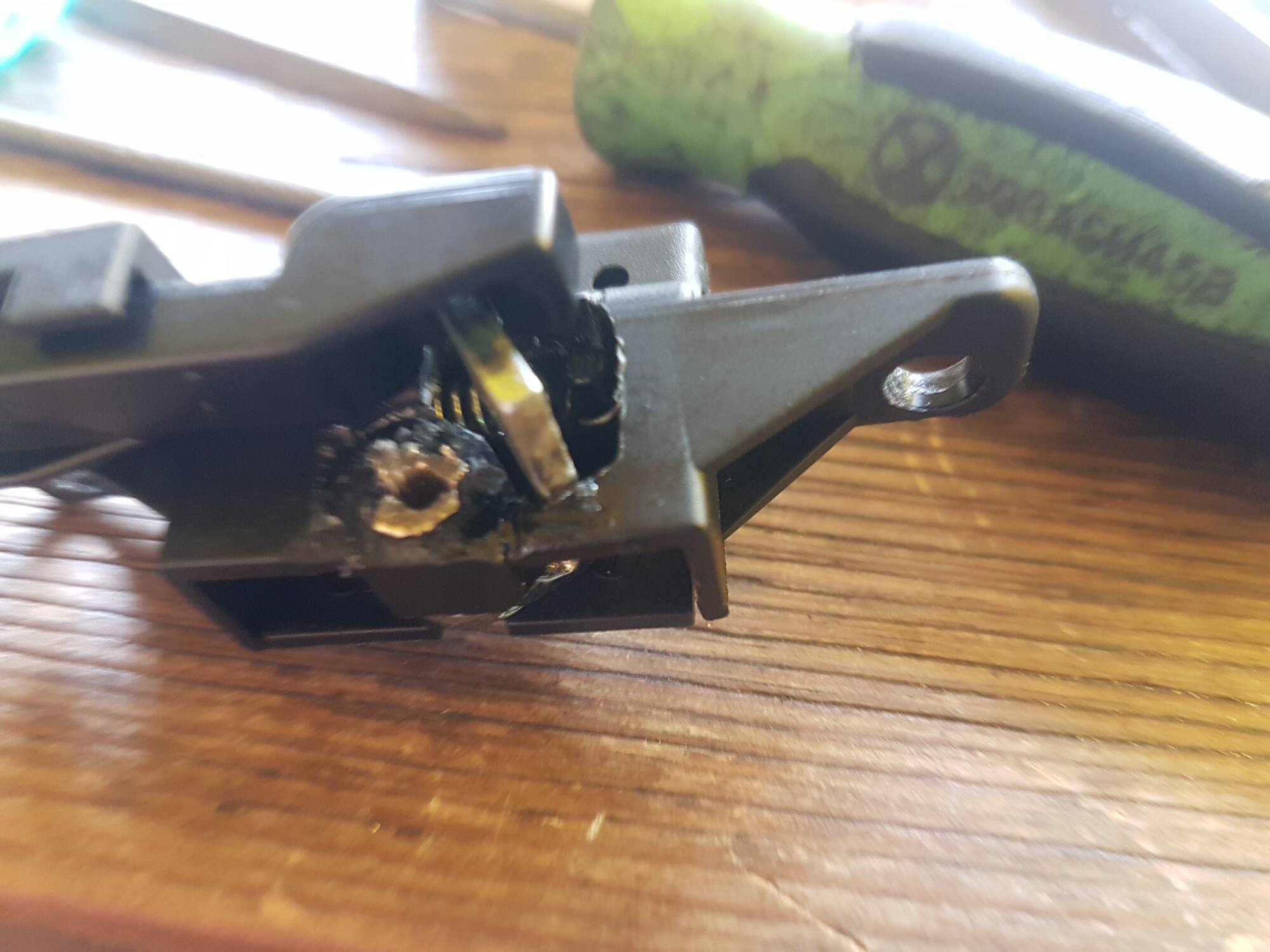

Yesterday's C280's fixing of various bits, the glove box lid that  was broken prior to me owning the car was my focus,
The tiny plastic catch in my hand above was truly knackered but luckily all the parts were still present,  I made myself comfortable at the table with a large Latte and began working out how to put it all back together, the metal hook/catch was rather bent but with some careful manipulation I had it back to its old shape, the casing around the hook was in 3 bits and the small brass pin that holds the whole lot together was badly bent, I removed the pin and managed to get it back to an acceptable standard by sliding a small pop rivet trough the centre and popping it in the vice, the small tappy stick was then introduced,
The pin itself was swaged both ends when made so I had to re swage one end once I had got the catch back together,  Heath Robinson was called on so a large nail with the tip filed to a better finish was used for this,
20200403_150256.thumb.jpg.4da5df769ca486418690eba71f359ac1.jpg20200403_150457.thumb.jpg.4332f55a4f6ba2eda8f4857f03979876.jpg
I ended up with this
Some two part gorilla glue was next to put some strength back into the repaired catch
20200403_202256.thumb.jpg.091c8aa6c02aad3d526731caba8fe506.jpg20200403_202248.thumb.jpg.76c7cec2dc86ae7a219e6d08ce973533.jpg
This was then put aside while the glue hardened and hopefully to be fitted tomorrow, next on the list was the boot lock due to its reluctance to lock and unlock from the central locking,  the central locking works on a vacuum system,  each lock has a small bellow with a rod to operate the locks but on the boot it just wasn't working so out came the boot lock to have a closer look,

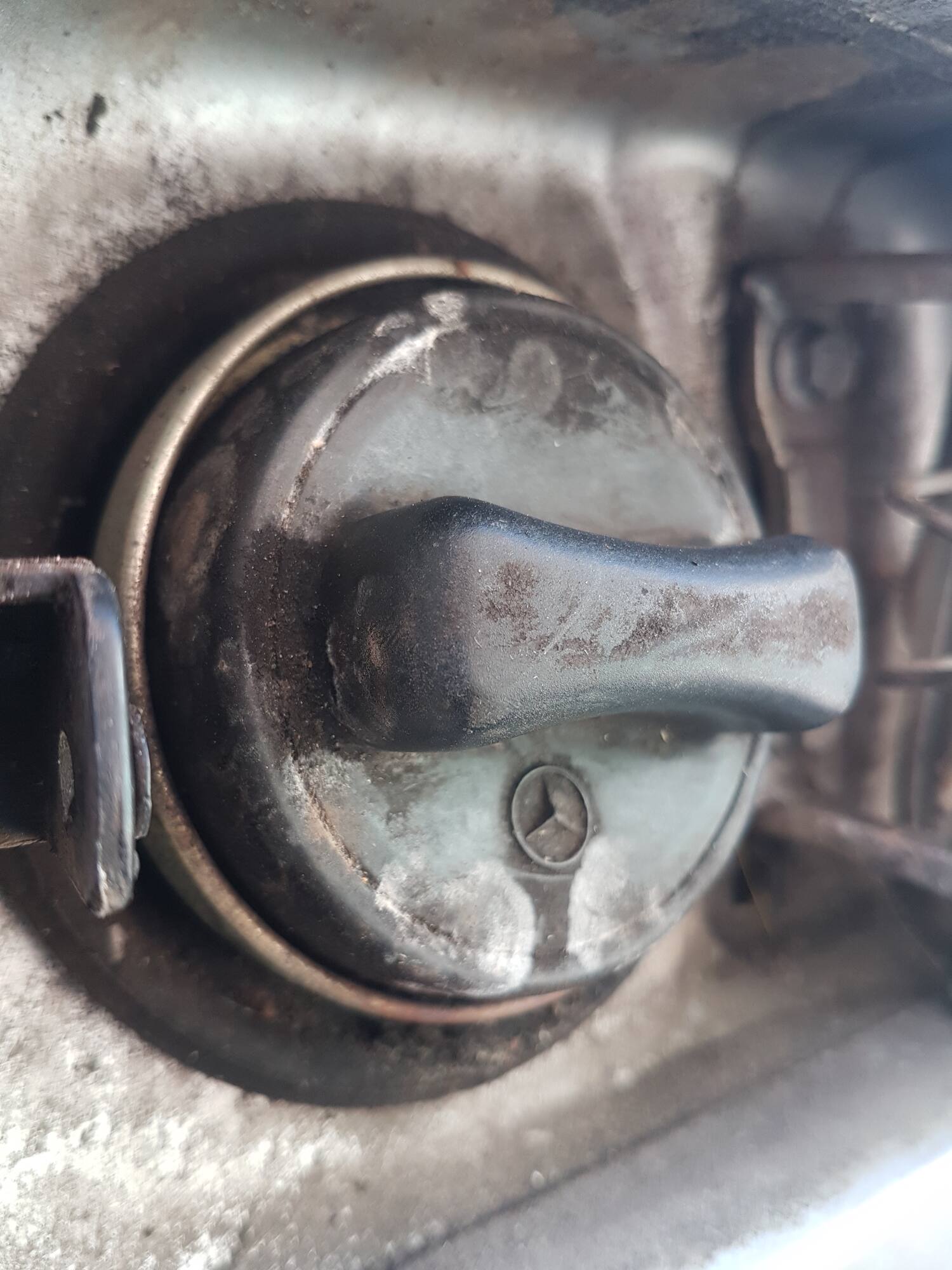

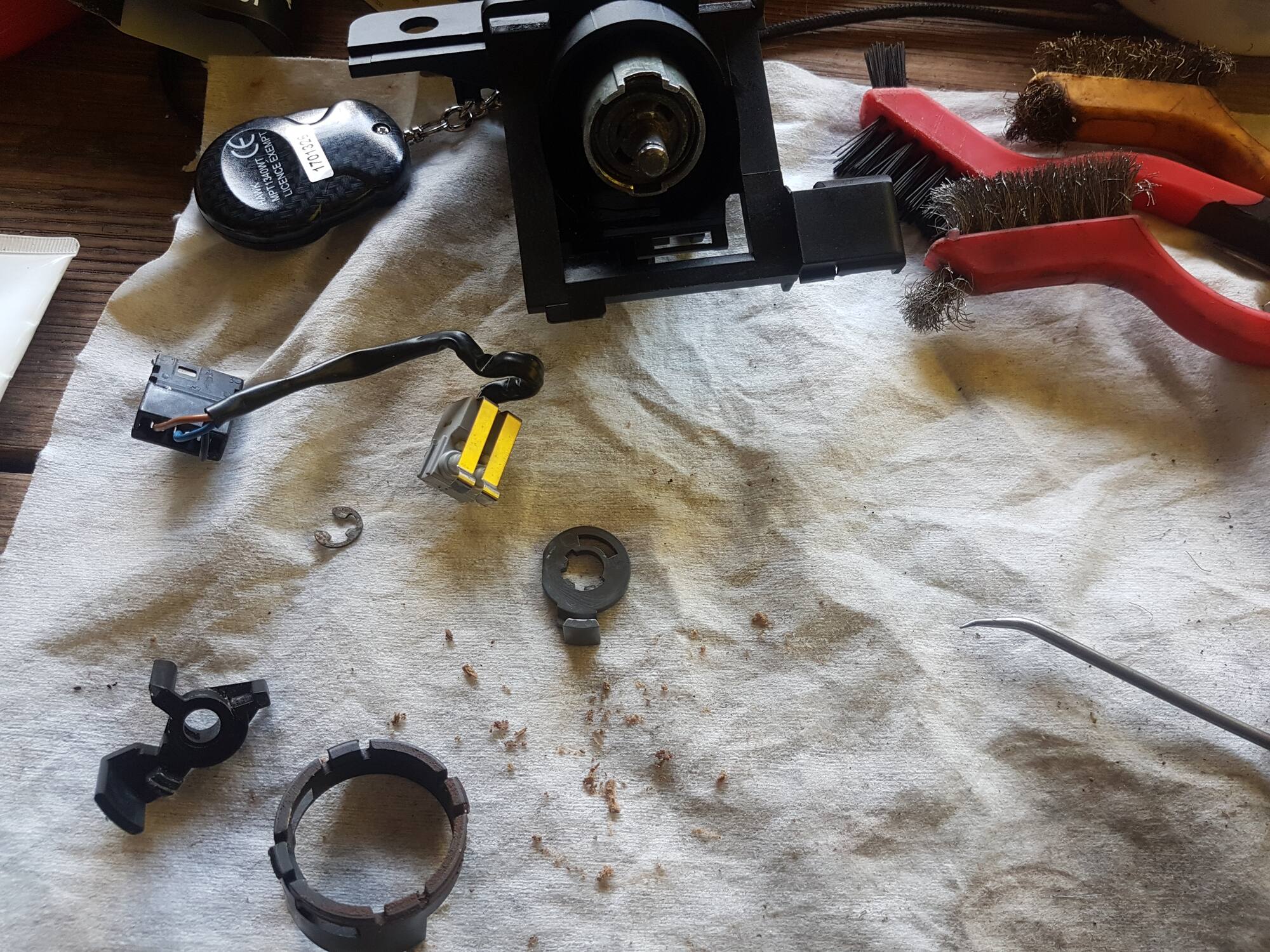

Hmm a bit of corrosion on the rear, stop it at the back !

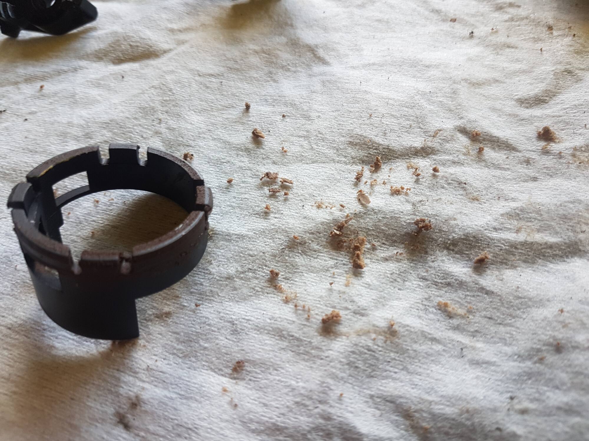

The brown stuff was everywhere and was not allowing free movement of lock parts so a thorough clean was called for, a stainless steel brush, craft knife, WD40 and carburetor cleaner were used to clean up the rear of the lock, the merde that came of and out of the lock was thick and crunchy,
Everything was gummed up including this ring that should turn easily to operate the two micro switches on the lock,
Unfortunately I could not get the barrel out of the lock as even with the spring clip removed it didn't want to fully come apart,  so I washed it through best I could with carb cleaner and then filled it with oil, the lock is now fully functioning and works perfectly with the rest of the system,
I reffitted the lock last night because Security,
Later today I will be putting the glove box mechanism back in the lid and then putting the whole lot back in the car, I will of course follow up later with pictures
So the glove box lid and mechanism have been repaired and it all work's!

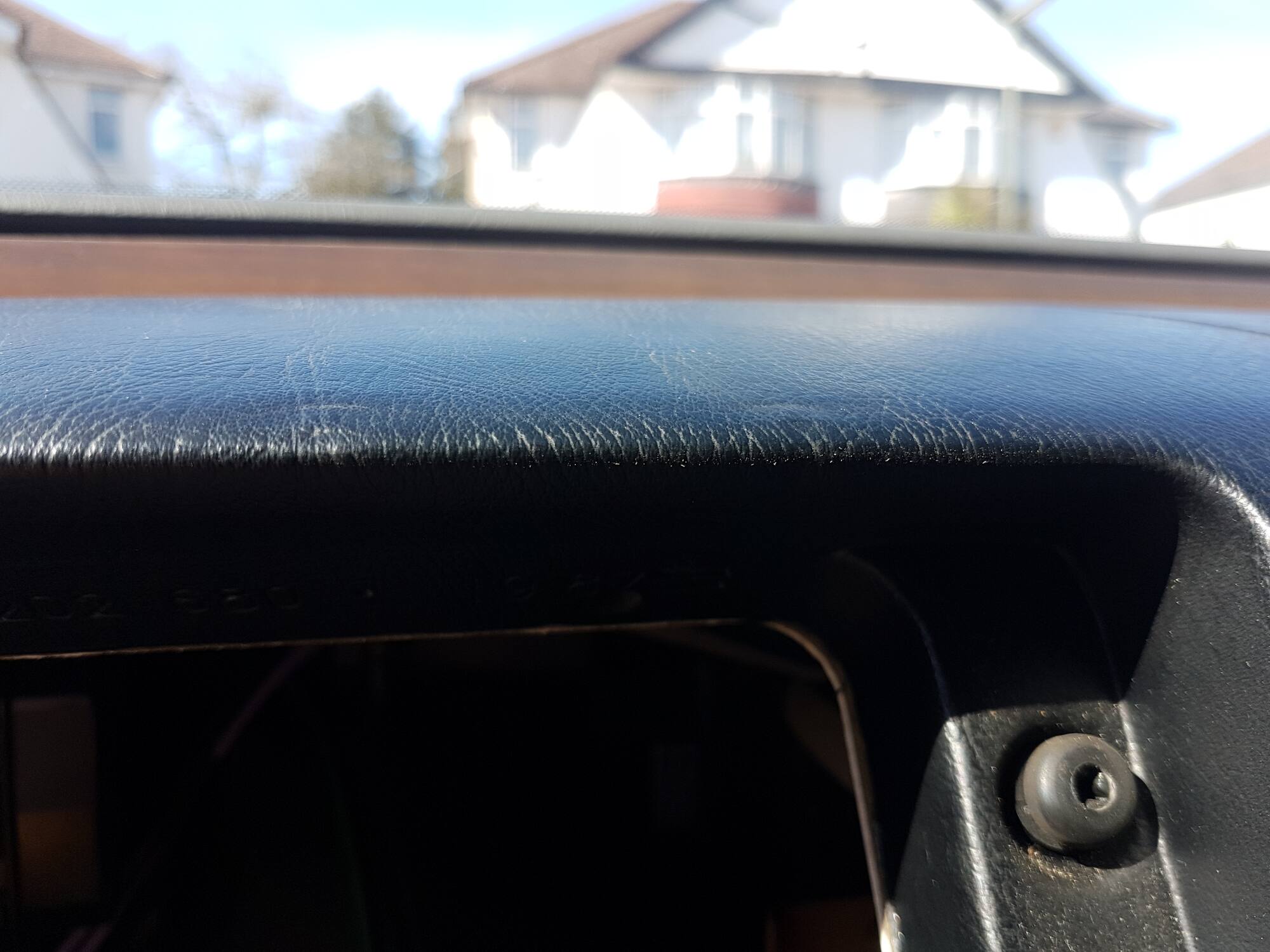

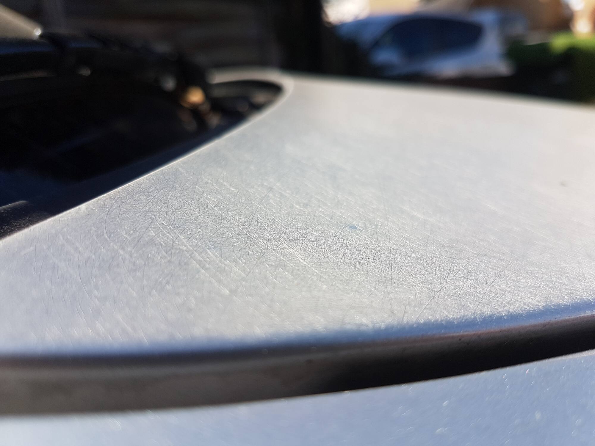

The dash had two screwdriver marks that I gently warmed up with the hot air gun, took some time to get the dents out but I'm happy with the results even if it's not perfect,
Before

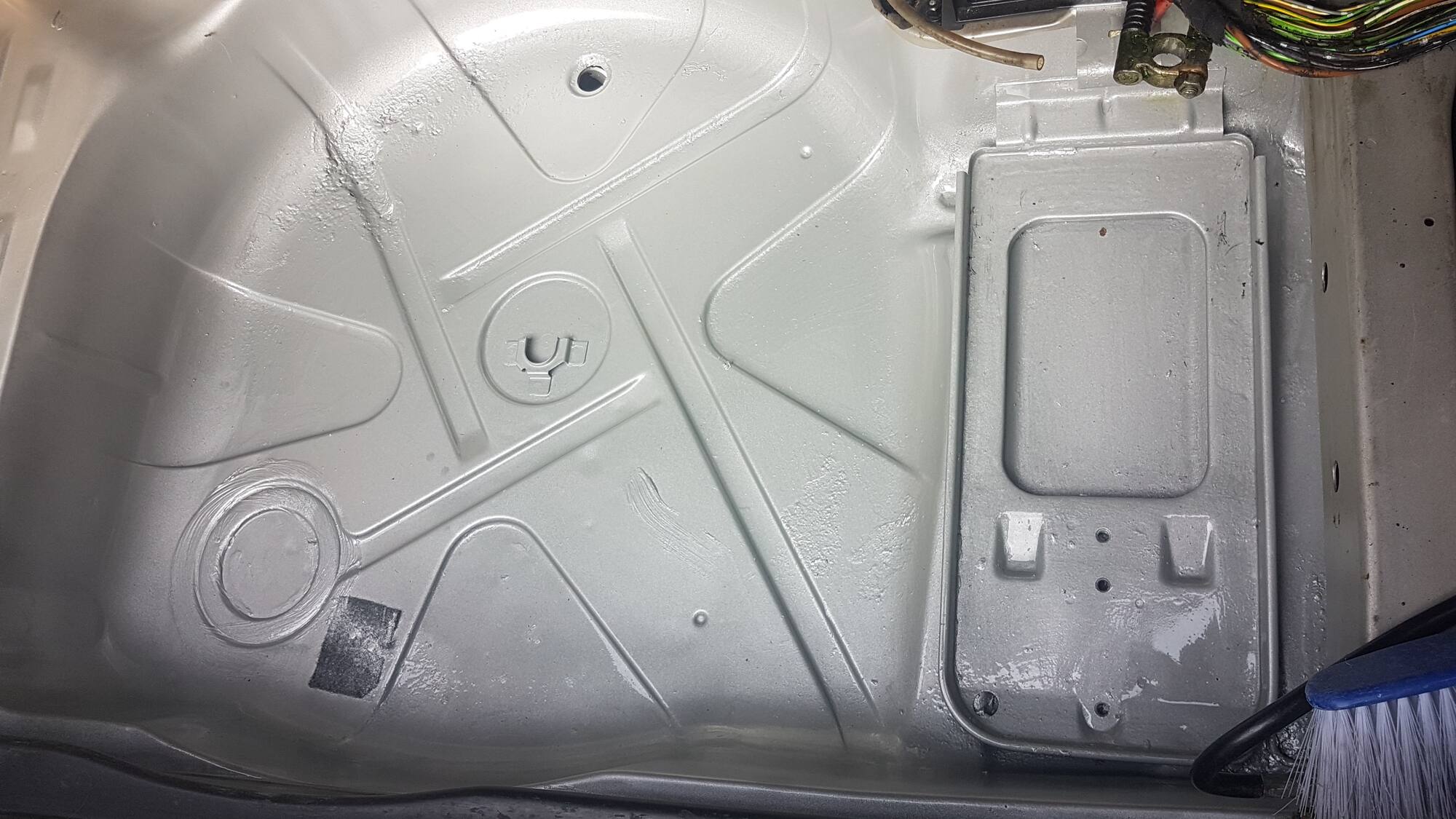

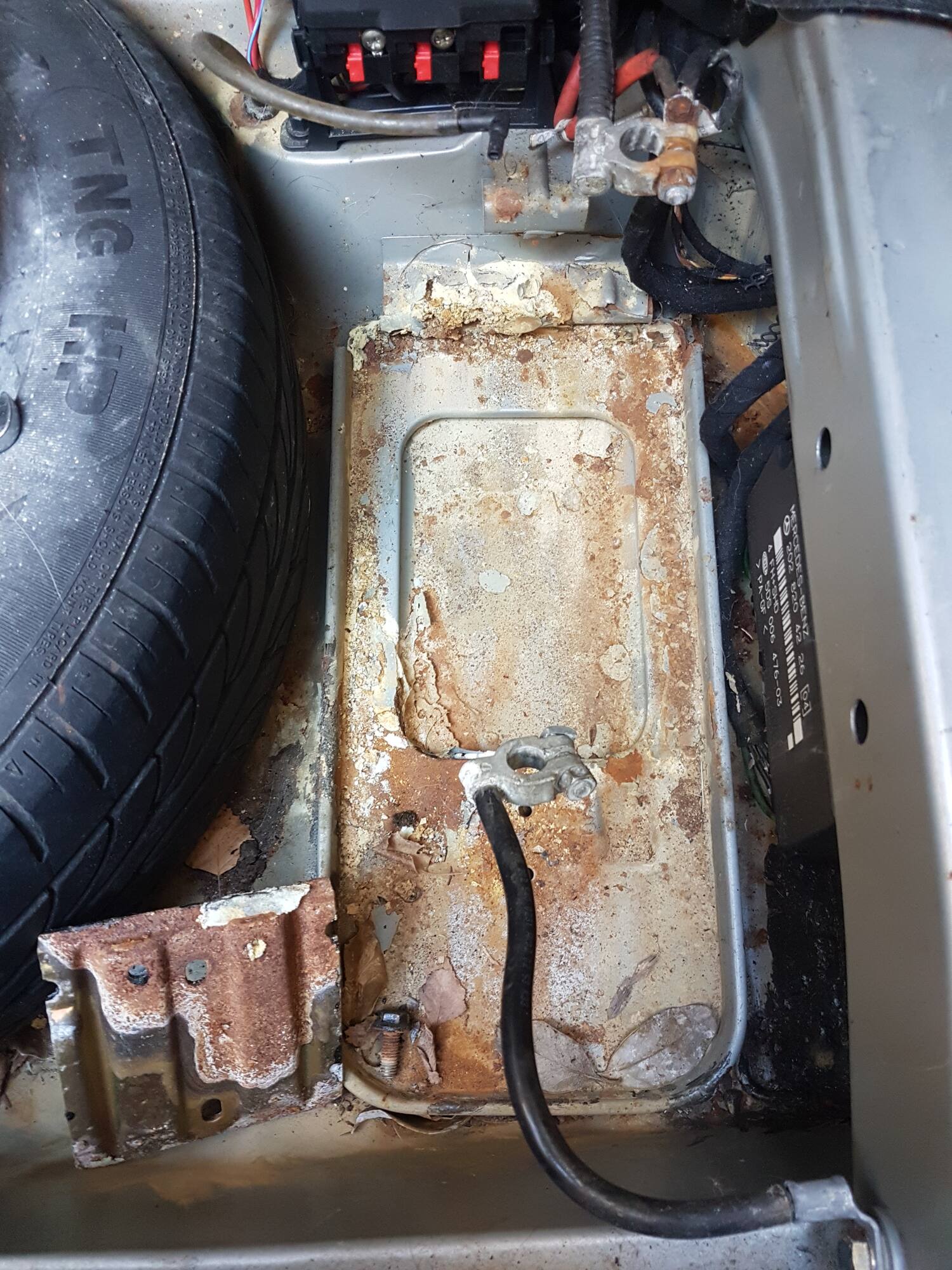

My attention was then to JUST fit my spare battery as I had run the original one down by leaving the interior light on over night, taking the battery out soon showed up some other stuff to be making good due to battery acid corrosion stuff !
The battery tray and clamp looked pretty grim
But old Mercedes metal is far thicker and rust resistant than I first thought
I think I've been lucky with this !
Vactan was brought out of the shed and applied to all of the rusty bits, I took out the spare wheel as some surface rust was underneath it,  I think it might have had water getting in the boot from the dodgy antenna rubber
This doesn't seem to be leaking anymore as it did rain last night and the boot was dry this morning , but it has evidently caused the boot floor to rust through the metal but the underseal is very thick and has no visible issues from underneath, this will get welded up in time but for now I'm just treating it with Vactan,
The battery clamp was also crusty, so wire wheel in the drill, place drill in vice, then masking tape the trigger on (health and safety look away now) lol,
Thorough rust removal and paint with my favourite paint Rustolium Hard Hat, came out ok I think,
The rust is not the end of the world and I'm sure will be reasonably easy to fix with my sparkly stick machine, in other Rust related news I need to have a look at both sills, the drivers side sill has a patch that i was aware of when i made the offer to buy the car, it's gone past the scrape and apply Vactan stage,  it's rather ripe and crunchy/crusty further investigation is required, some of the other rubber grommets have bubbling around them but no way near as bad as this one
That's it for now, updates will follow

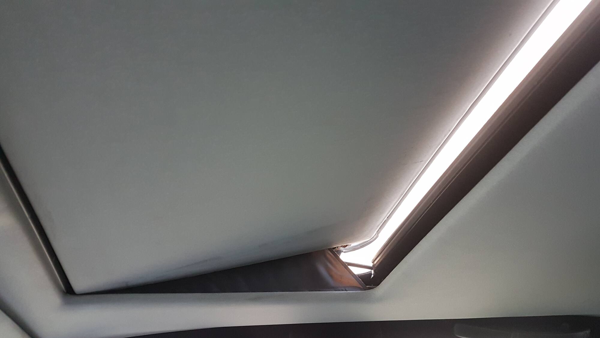

The sunroof work's but is a little bit slow when closing fully from the slide function, I think a strip down of the sunroof is needed to assess the issue,  the grease can become thicker sometimes hard slowing down the worms in the tubes, looking at the edge  sunroof panel shows the filth and dirt, this can have a negative effect on the smooth operation of the sunroof,

The Rustolium Hard Hat drys sort of Satin finish which is fine for the boot but I had the lacquer and it was dry and sunny in a lockdown so this happened
20200410_102646.thumb.jpg.784be5e65c56972f7bbbecddb877abff.jpg20200410_102642.thumb.jpg.0edea9bc956bdd6f6442cf5a576f2e52.jpg
another couple of baking had the lacquer dry enough to start cleaning everything up that had to go back into the boot
You might note that the left hand side has not been sprayed yet, that part will get done when I remove the inner panel to access the Hirschmann electric antenna that needs removing due to the weathered rubber grommet,  I think that is why the boot has rust,
Quite a contrast to the grim mess the battery area was before, this has tidied it up just lovely

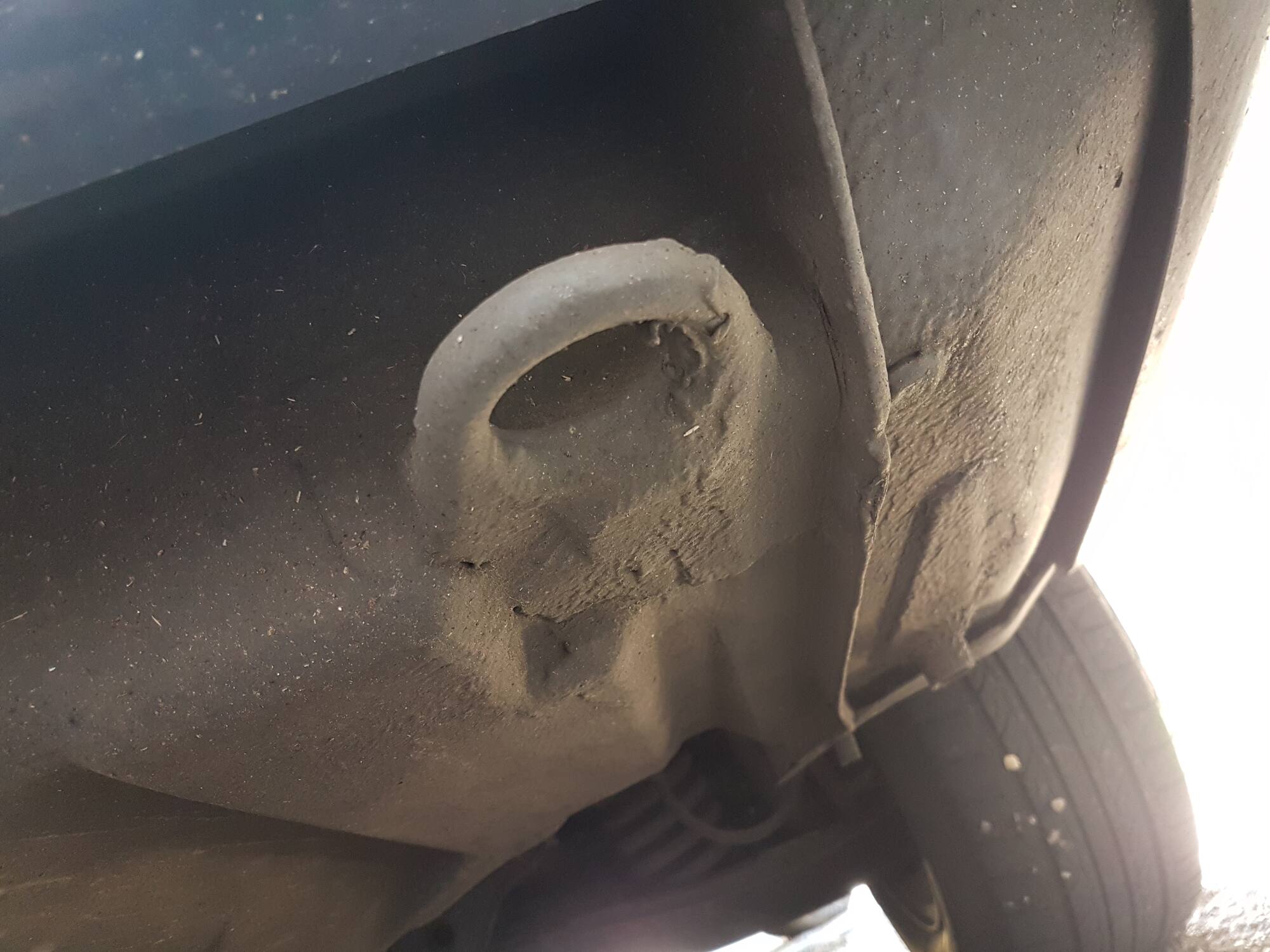

You need to watch here for rot ... Very specific place. Just behind the rear passenger inner arch in the boot .... It gets hidden by the heat shield for the rear silencer. I presume it's some kind of dirt trap that isn't accessible to clean? You also can't usually see it with the side carpet panel in place in the boot area.

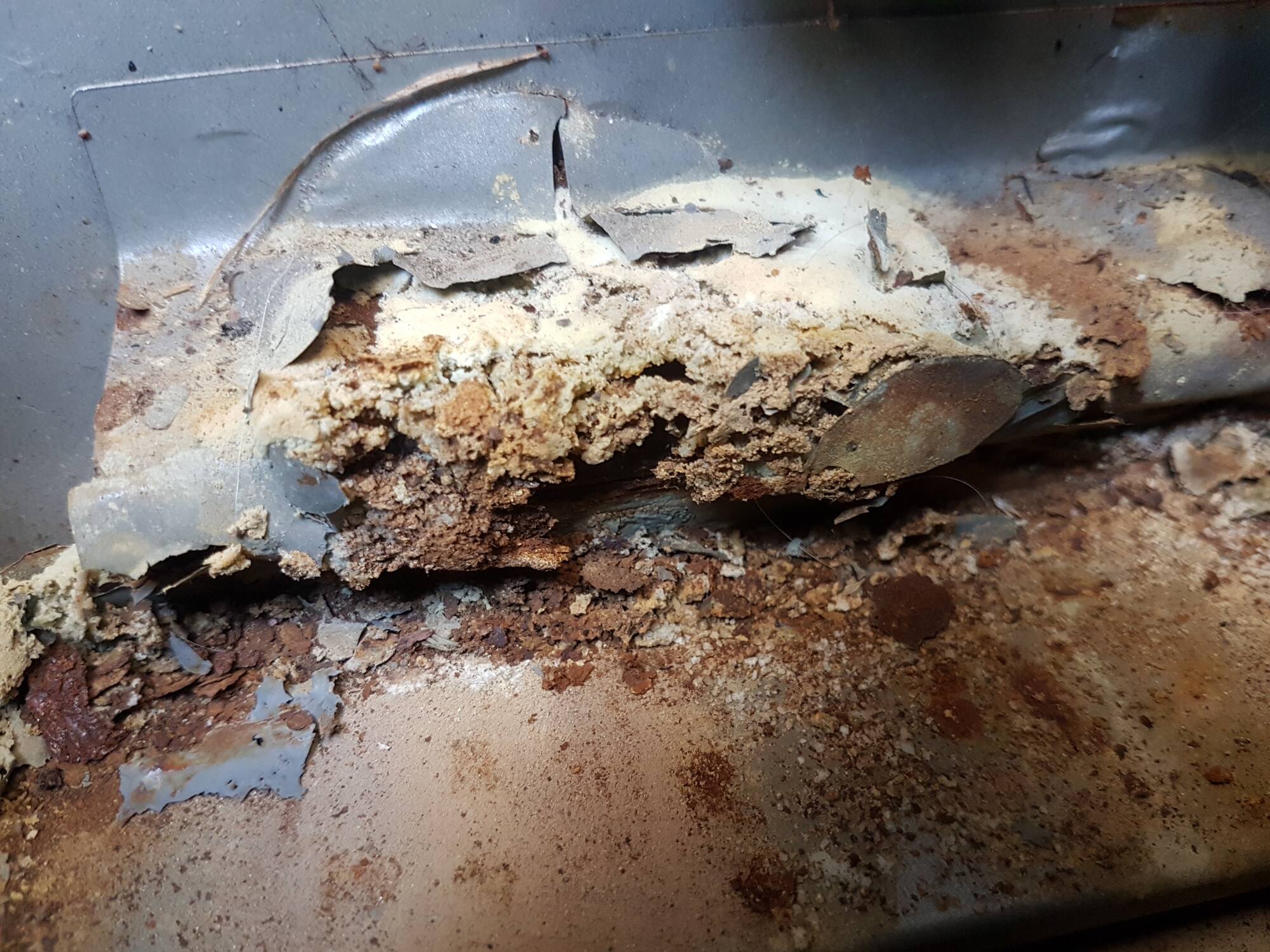

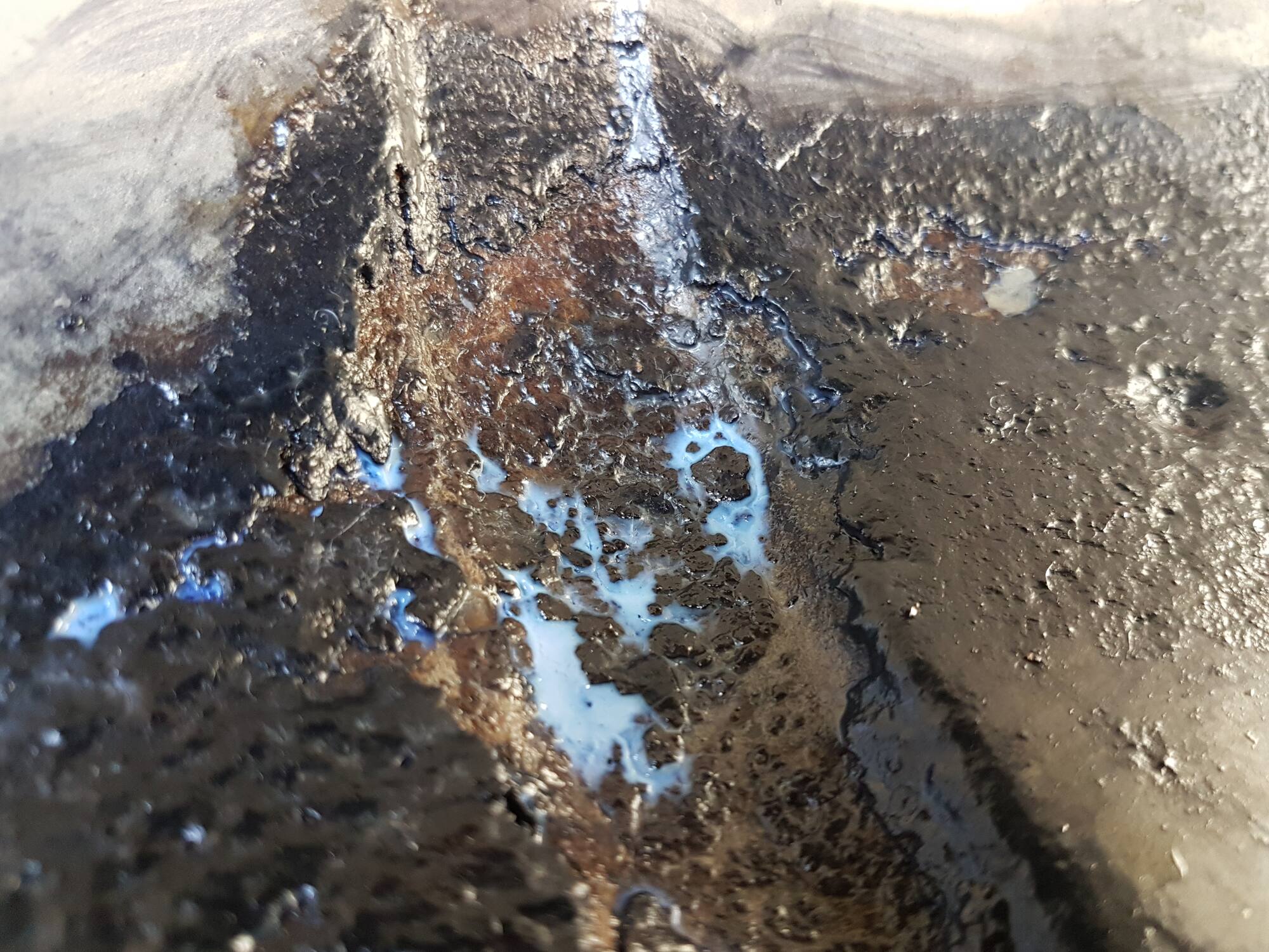

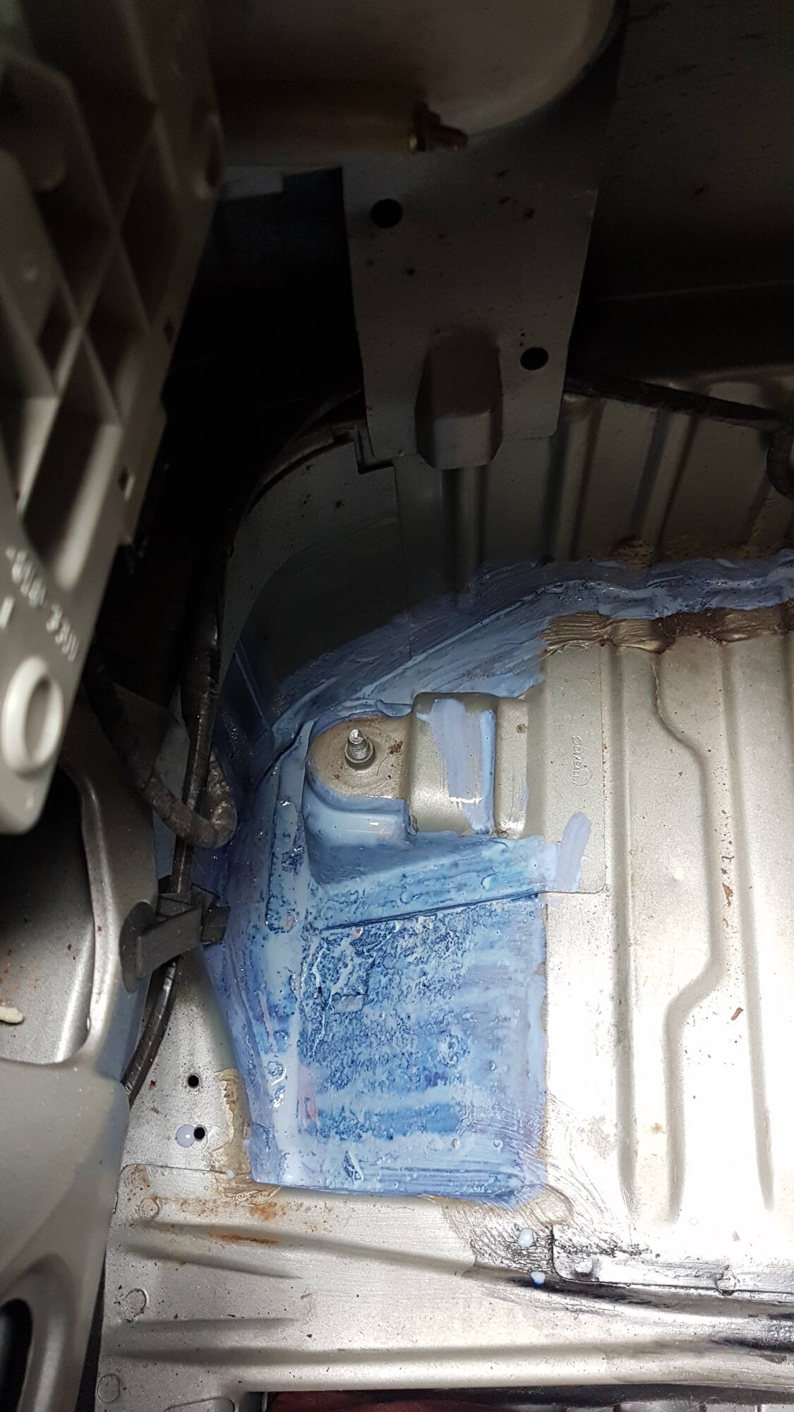

Armed with your possible rusty Information I could not wait to pop the inner trim away this morning,
I think I may have gotten away with that !
The same can't be said for the area to the left of the picture,  this was probably caused by a mix of heat cycles and the water leak from the antenna rubber grommet,  it has gone through so it's going to get the same treatment as the boot floor,  remove loose rust with some 80 grit and Vactan,  once this has dried I will be using some windscreen sealer to keep any nasty gases out of the car until I have enough time to tackle the rust, it's a common area for rust because of the heat cycling and close proximity of the heat shield under the car, it's a tricky area to repair due to the tight location, I think I will wait until I have a chance to get it up on one of my mates 2 post lift,
I won't paint this area until it has been fully welded,
