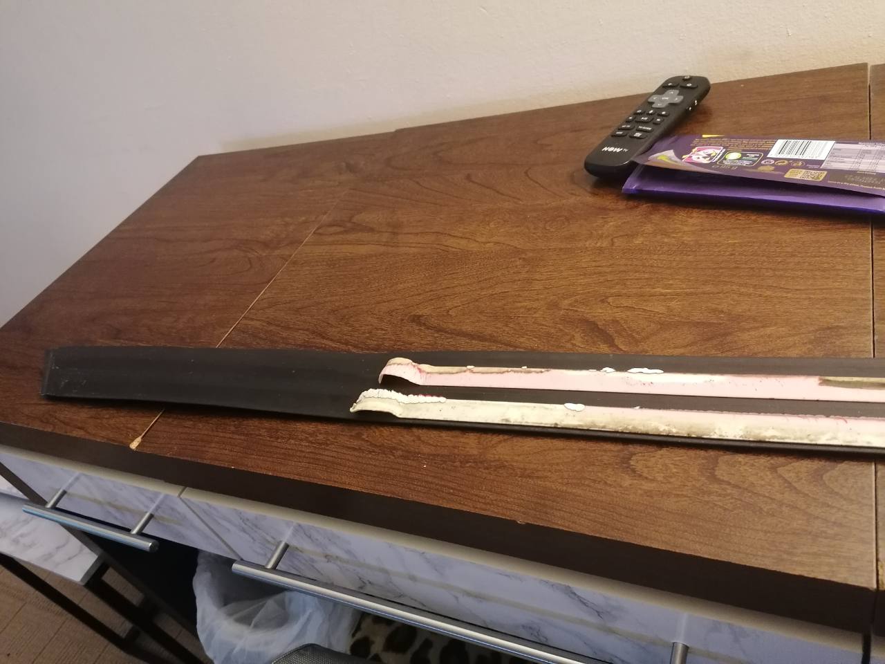

This is taking flipping ages. Trying to remove the sticky strip from the trim
i used a heat gun on low and a scraper when removing trim tape
4 hours ago, bunglebus said:
One of these may help
https://www.machinemart.co.uk/p/power-tec-stripe-off-disc-with-shank/
However they're meant for getting sticky stuff off of paint, so could melt the plastic trim. Might be ok if you keep the drill speed down.
Other alternatives are heat to make peeling them off easier (hairdryer) or meths which melts the glue but generally leaves plastics alone
I've got a toffee wheel, that's how I got it off the car.
I'm worried about warping the plastics even more tbh
Hmm. This one is never going to be straight again...
Put it on a windowsill near a radiator, pile loads of books etc. on it to weigh it down, leave it for about a week.  It might go less wibbly enough that once taped to a door it's straight enough.

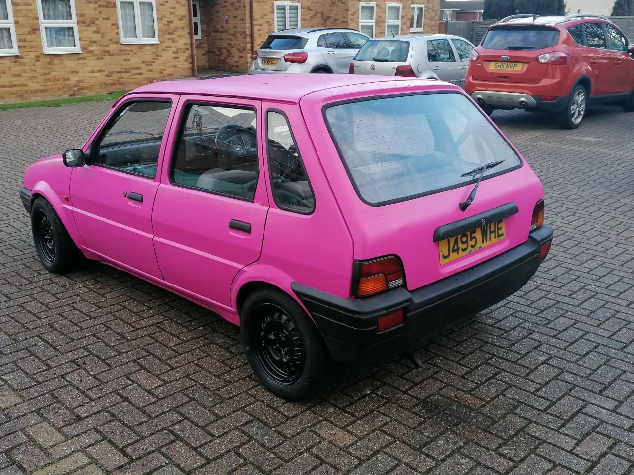

Yeah, personally I think they're one detail too many.  I've always liked the look of plain black wheels against a bright coloured body on a car though.
I really like it with trim rings
The biggest problem I'm having with the trim rings is they are trying to spring off, and don't sit straight. That's what I get for buying plastic ones I suppose
  • DoctorRetro changed the title to The Doctor's travels through time - New wheels /Tyres
Trim rings? No
Black Spitfire steels on a pink Metro? Strangely, yes.
Are they the wide 5.5" GT6 steels?
Love it, but a no to the trim rings. The plain black rims look fab with the rest of the black trim.
I know it's already been discussed, but in my insignificant opinion, Metro sills should be black, the cars look somehow 'unfinished' to me with body colour sills...
3 minutes ago, Dick Longbridge said:
Trim rings? No
I don't think so, just the standard ones
