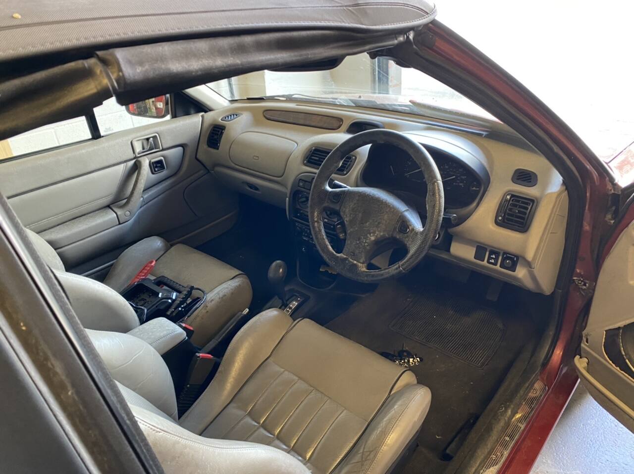

Kiltox Posted April 1, 2020 Author Posted April 1, 2020 There's no way I'm even going to think about sorting out the OMGHGF on this before it's at least clean enough to be habitable. Time for the mountain of mould to do one! Dan302, Aston Martin, rantingYoof and 3 others 6
