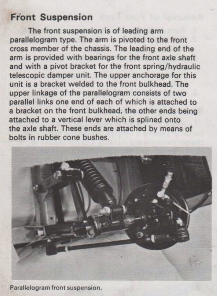

im curious what is the front suspension setup on a Reliant?
on other *cough* 3 wheelers that I know of, its either C tube suspension pre mid 1969, and and parallelogram front suspension post Mid 1969
and its made me wonder what did reliant use?
Lbf,theres an a frame mounted on flexible rubber on bottom front chassis rail with a shocker and spring mounted diagonally from top chassis rail to a frame to allow a frame to rise up and fall. The wheel is bolted to the drum which in turn us mounted to a kingpin on the a frame to allow left and right. On the cars they have steering wheel to steering box linked to front wheel,on my trike I have a solid rod with a track rod at the front wheel with a track rod mounted under handlebars. I'll get a picture tomorrow as I've no bodywork in the way.

Yep. Reliant owners refer to it as the 'A frame.'   It is in fact a leading arm, so in theory it has anti dive properties when braking.  My 1961 MKVI Regal saloon has pretty much the same configuration but for a 13 inch wheel. The parts are not interchangeable with later Robins or Rialtos.

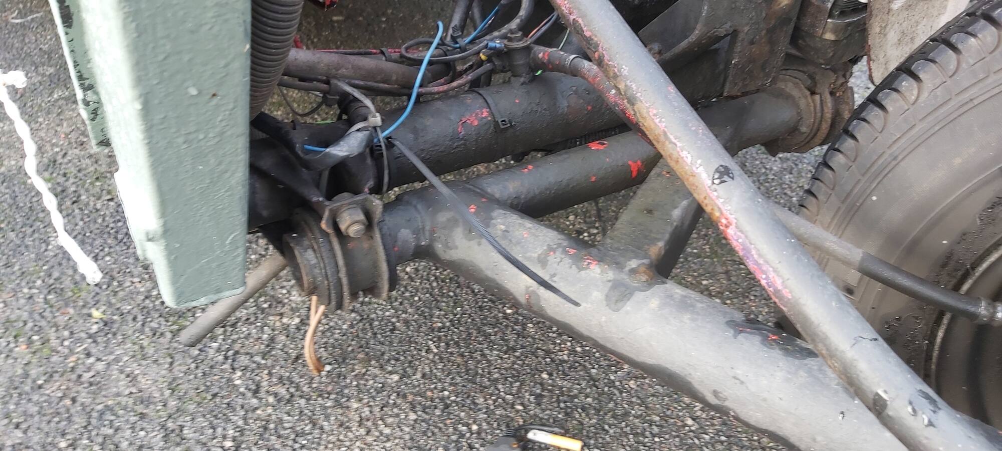

Excuse the fairy lights. That's the front end setup on the reliant. Mine is exactly same as the bodied version bar the steering link because my trike has a non modified reliant chassis so uses reliant running gear,brakes,engine etc
found some pics of my mates robin on an old phone, ill upload later... why he still has it i dont know.
ohh very interesting :) Thank you for grabbing photos its much appreciated!
looks quite similar to the other 3 wheeler im comparing it to
but not quite the same, the other 3 wheeler has an extra bar of sorts next to the coilover (as well as the steering bar at the bottom of course)
