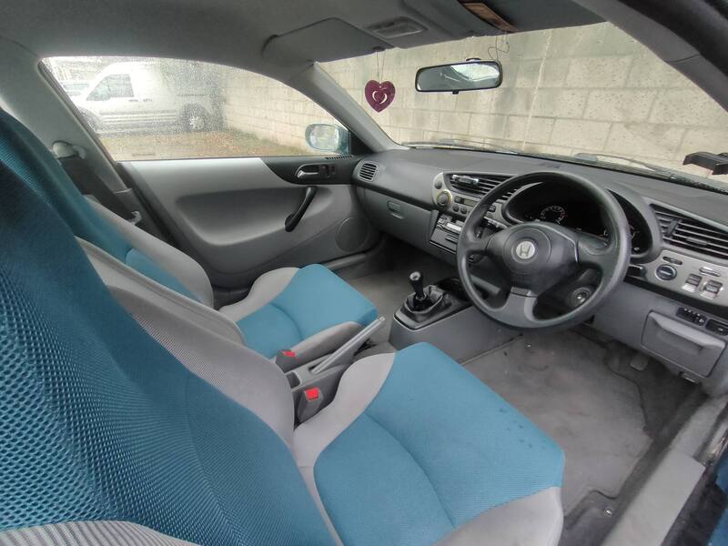

Modern, airy, TARDIS-like. I'm 6'1" and 19 stone. I didn't fit properly in an MG ZT but this allows me to fully extend my legs and I feel well supported. I managed to sleep in it as I found myself locked out of the flat at 2:30am

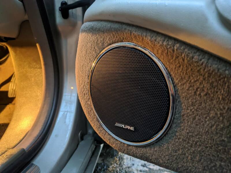

Stereo:
A bit shit. Fair enough.

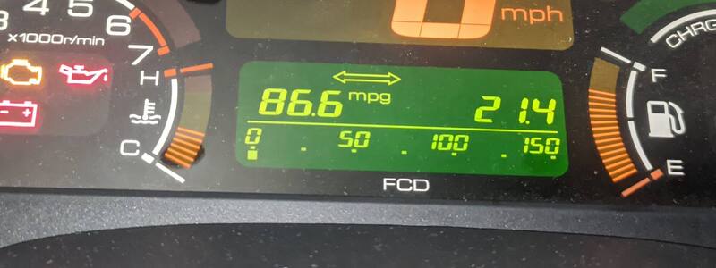

It needs the battery drained, recharged, drained and then recharged again if I've done my research right. Just need to wait for a parking spot within reach of my window.
I averaged 70mpg on the 170miles home.
I managed 86mpg on the way back from Stirling with a little effort and no assist. I reckon 100mpg is possible on a long night run.
Glad you're enjoying it man. 100mg is easy to achieve over a short distance, just reset the trip meter and immediately coast down a big hill in neutral. If you can beat my 92mpg over 100 miles, I'll buy you a fine new hat.

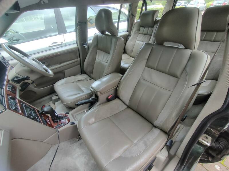

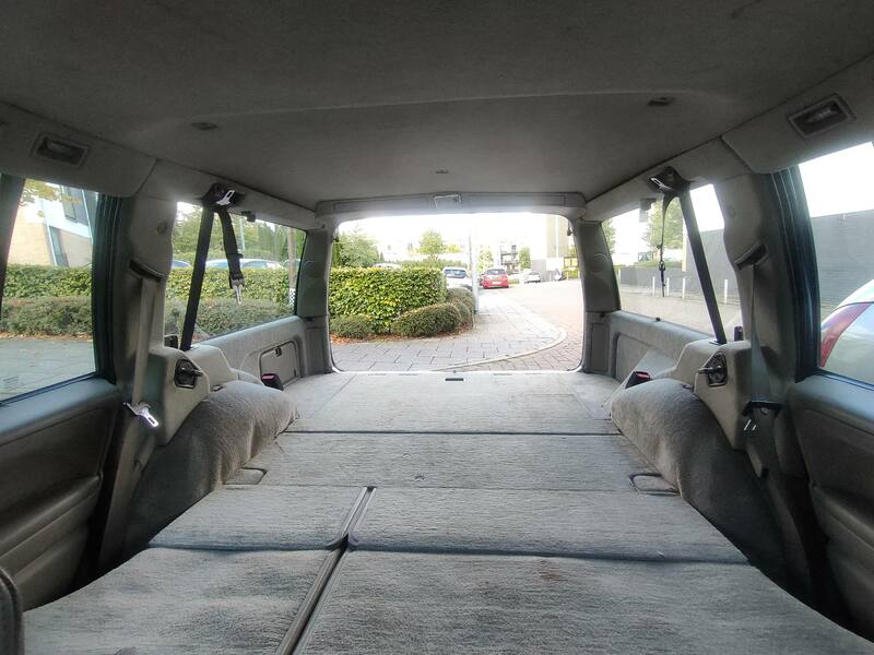

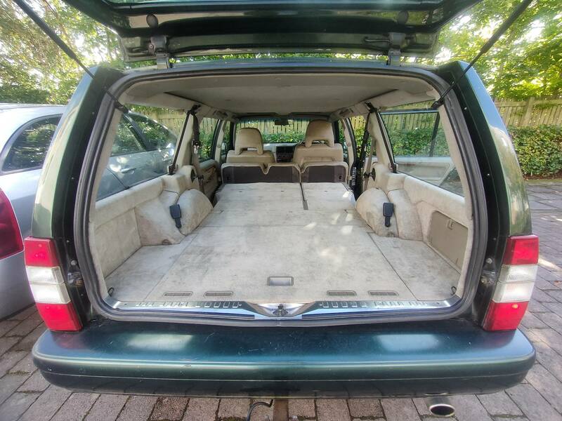

The interior is really well thought out and planned. It feels like they cared about longevity. Everything in this Volvo seems to be designed to work for years, to be easily maintained/replaced and to be simple. It's such a damned nice car.

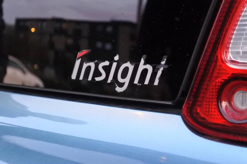

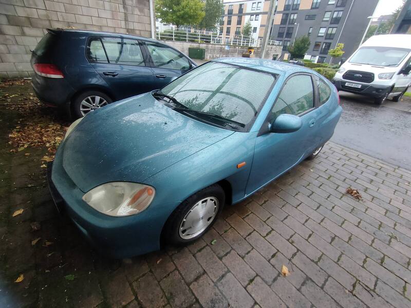

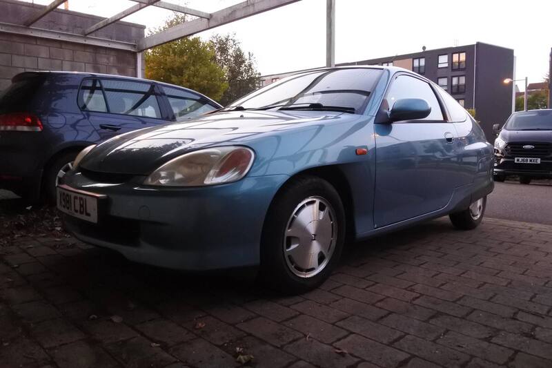

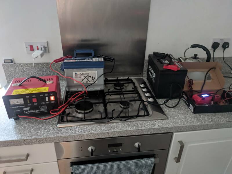

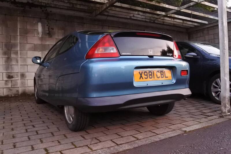

The morning after picking her up (170 flawless miles) I got a dashboard of error codes. IMA and EML. Balls. A 5min Google suggested that my battery was weak and I'd need to go through a discharge/charge cycle or two.  Because it's a series of batteries that are daisy-chained, the whole unit is only as good as the weakest cell.
I spent 1hr on the web trying to figure out how electricity works, bought a multimeter and then spent 3hrs down a rabbit hole of insight forums, mpg mods and Peter Perkins writings.
I finally build up the confidence to even go near the IMA battery and everything's completely flat. 0 volts, NADA. Turns out I'd left the headlights on overnight and emptied the 12v. I recharge and plop it back in, no warning lights or error codes and the boost/charge are both working normally. Sweet.
Took it out to Paisley to pick up a car with my dad. 170miles at 86mpg. I absolutely love this thing. Hope to keep it very, very long term.

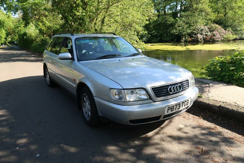

A cheap 2.5l A6 C4.
Interior is clean with a very faint whiff of dug.
Clutch and gearbox are perfect. The nicest biting point of anything I've ever tried. Tyres are good, suspension looks ok and the engine sounded/felt OK. Discs and pads have enough life in them.
It smokes under full throttle but we believe this is fuel injection pump timing. This would also explain why it feels marginally down on power.
When it got back home there was some pressure in the coolant expansion tank.
Trying to figure out whether it's the head gasket on its way out but there are very few signs to figure this out without a compression test or the ability to take it out on the road.
No milky oil cap
If there is white smoke from the exhaust it's extremely faint.
Engine temp didn't do anything crazy on the 15mile drive home.
Coolant colour / consistency is fine.
If it is HGF, this is probably a nice enough car to save. It really is well built and a pleasant place to be.

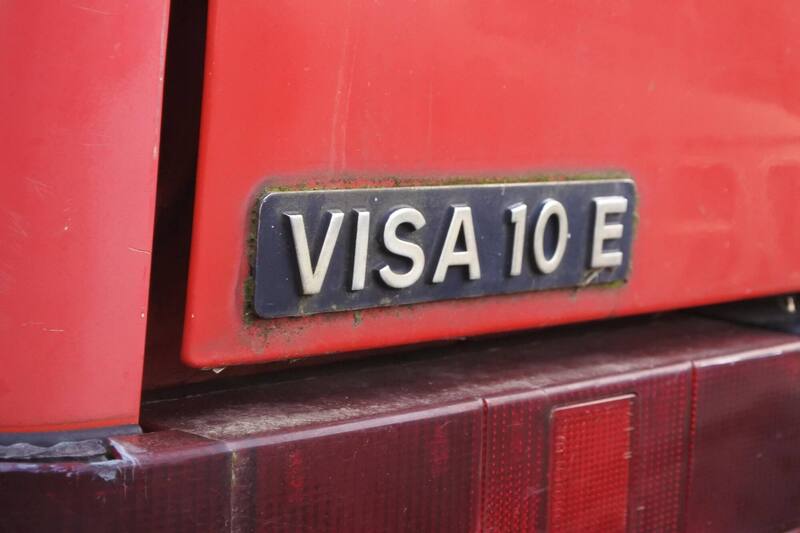

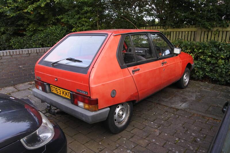

Visa'n'Galaxie:

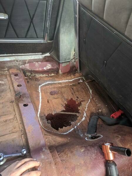

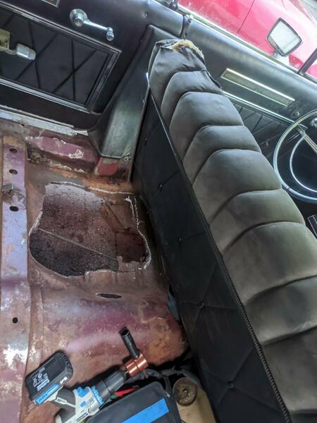

Welding. Both need some welding. I've been talking to a guy about space in a unit so I can learn this indoors but he's been very slow to get the ball rolling. Looks like amateur street welding is on the cards (fun fact: the sport of amateur street welding was popularised by @captain_70s when he was repairing *insert any car owned by the captain*)
1.2mm sheets arrived.
Metal nibbler from Amazon arrived.
I'm also off work for the next few days. The stars are aligning.

Visa'n'Galaxie:
You're welcome to come to my unit and try welding indoors.
  • Thanks 2
That's dead sound, thanks. I may take you up on the offer eventually. Need to 1. Learn the basics first & 2. Get the car roadworthy again so I can actually get it to Fife

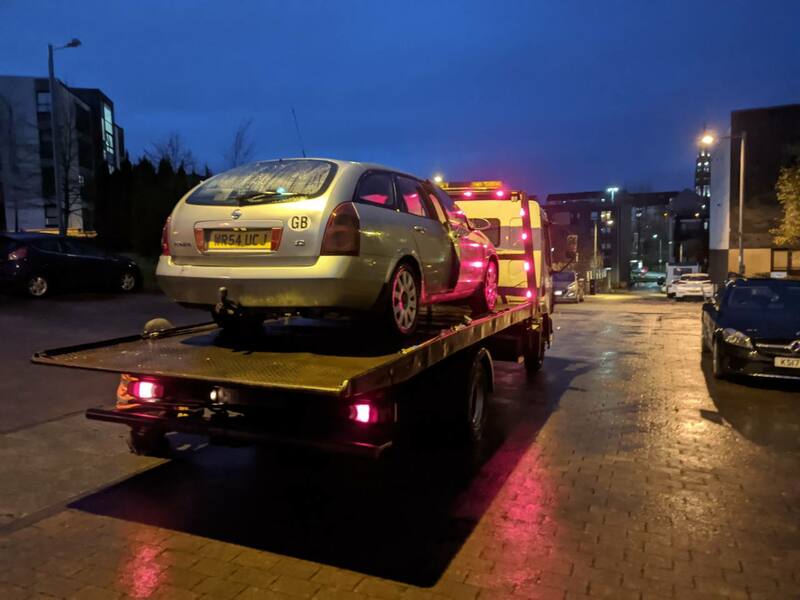

1. Nissan brakes. I'm new to the wonderful world of caliper wind backs bit it seems the Primera has some proprietary version which ever so subtly didn't match mine.
No dice. 60mins in the rain trying to figure out a way around it with limited tools. Wheel now back on sans disk/pads/some brake fluid. Borrowing a set later and will take a look again.
2. Galaxie. Metal nibbling
This thing needs torque. Took me 20mins of struggling to realise this was the key. Now it's VERY FEST, MUCH SPED. Cut myself quite badly before removing the final piece. More rust than I'd anticipated but c'est la vie.

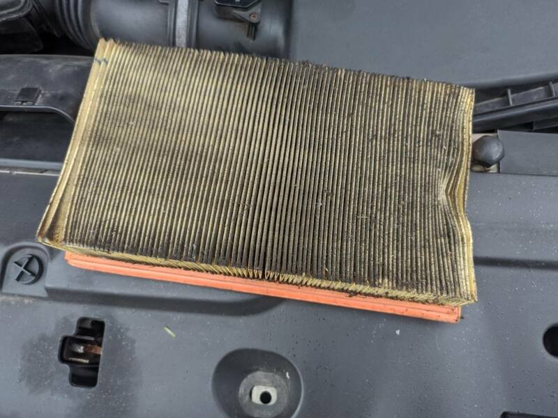

This has been my daily for several months. I thought there was some potential HGF at play when I woke up one morning to a low coolant light and an increasing amount of white smoke from the exhaust. No real oil cap cream cheese however.
Took it for a long drive within 5 miles of home and with an eye on the temp gauge which sat just above centre.
Stopped and checked the coolant by intelligently* taking the cap off on a warm engine. Coolant bubbled over almost immediately. I've taken the cap off on warm engines before and I've not seen it do this.
I'm now fairly certain it's not HGF but a series of other things which add up to similar symptoms. Coolant hasn't dropped at all since, zero bubbles in the coolant when idling, no milky cap etc.
Current prognosis: heating fan not starting, fuel system running very rich, too many short journeys without long ones in between. She's now off getting some remedial work done with the aim of passing an MOT.

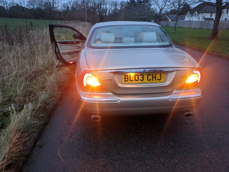

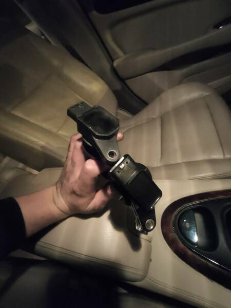

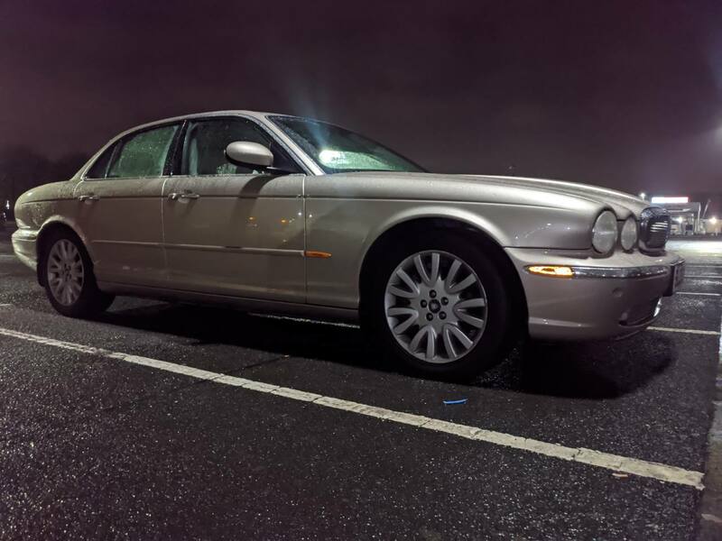

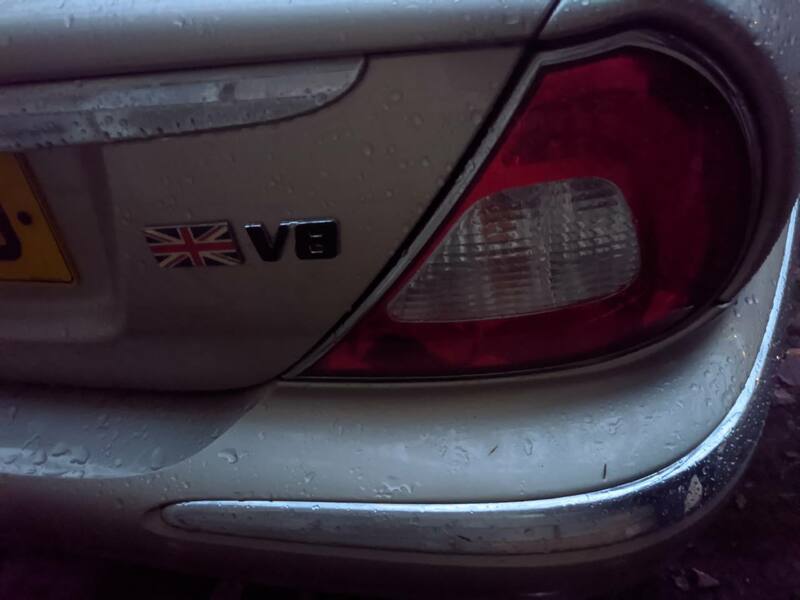

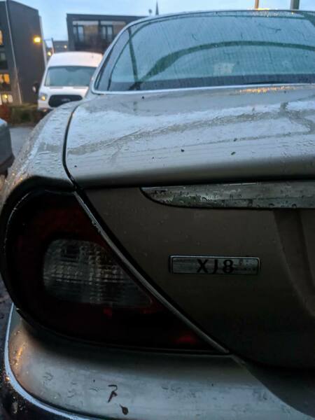

Here she is in all her low cost, high liability glory misfiring, juddering and throwing an EML  10mins after a completely faultless test drive.
The impression we got from the viewing was that it had been mostly loved for 150k and the last owner hadn't really bothered. Tyres are mismatched, cracked, mystery brands from Ali express. Headlights are mega faded and there's little in the way of recent bills.
Exterior is spotless, gearbox seems to behave and the engine ran perfectly for the 7min test drive.

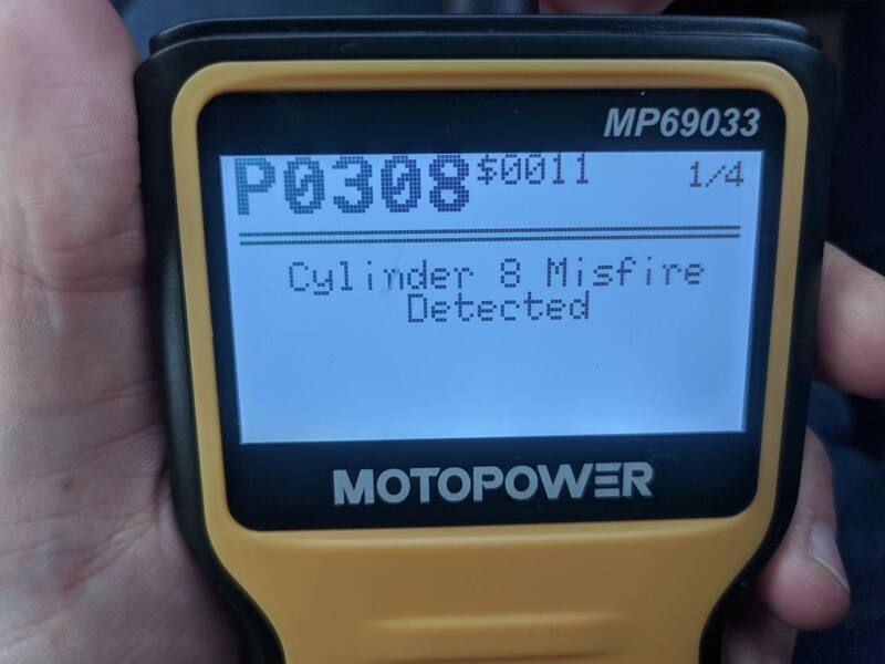

Got home and had a quick check through, no OBD2 readers were working so I ordered one off Amazon.
A misfire on a single cylinder doesn't look too bad. Switching that coil pack around and checking the engine code confirmed it was just the 1. Coil packs were mismatched and the failing one appears to be original...170k miles in
Scrap coil packs ordered in the meantime. Brand name set probably going to get ordered in January
