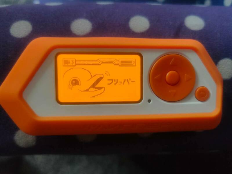

sdkrc Posted August 29, 2022 Author Posted August 29, 2022 The crown estate is alright but just doesn't adequately rustle my jimmies In unrelated news, someone I know has been buying parts for cars he doesn't have. Is anyone looking to buy an MGB roadster roof? And I also bought this, it's called a Flipper Zero. It can capture and emulate sub-ghz radio frequencies. This means in theory I can copy old car key fobs and barrier key fobs but it's taking some fiddling and research to understand. Dick Cheeseburger, Jim Bell, SiC and 2 others 5

SiC Posted August 29, 2022 Posted August 29, 2022 2 minutes ago, somewhatfoolish said: Look more midget than B; @SiC may be interested? Hard top looks MGB Roadster going what my Midget hard top looks like but wing looks MG Midget. Tbh I'm more interested in the Flipper Zero. I'm having a poke through the firmware and schematic atm, distracting me from the welding I should be doing. Jim Bell, somewhatfoolish and sdkrc 3

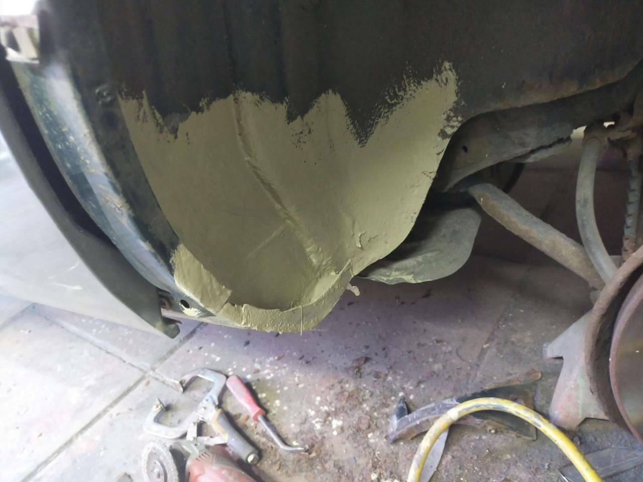

sdkrc Posted August 30, 2022 Author Posted August 30, 2022 Lexus is in for some welding. It's got some previously unknown frilly bits but it's nowhere near Rustang/Galaxie bad. I'm fairly certain @DoctorRetro 's new Lexus has similar rust spots so will be interesting to compare notes. I also think my dream of an LS400 estate will have to wait until funds have been built up. Some fleet movement expected in the next month juular, Dyslexic Viking, JMotor and 6 others 9

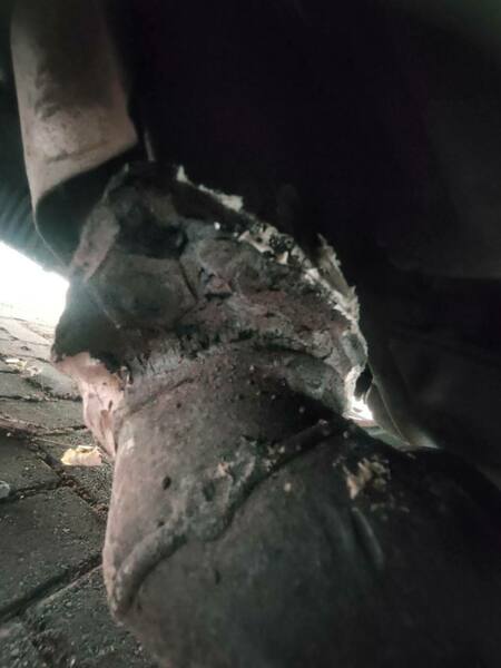

sdkrc Posted September 3, 2022 Author Posted September 3, 2022 Weldy bits done, not by me. Hat tip to Mr Nuttz. Sills were slightly problematic around the ends. There are some traps for dirt/moisture and shite from the factory. I strongly suspect all UK LS400s will have similar problems Exhaust/cats are proving problematic as access is pants and bolts/02 sensors are rusted. I need to find an exhaust place near Glasgow if anyone knows a decent one? The flanges around the cats are guffed (tadts) and I've got an EML/limp mode/gas leak Coprolalia, Split_Pin, juular and 3 others 6
SiC Posted September 3, 2022 Posted September 3, 2022 Are the cats worth mega money on these? Older (iirc pre 2001) can legally have non type approved cats. sdkrc 1
sdkrc Posted September 3, 2022 Author Posted September 3, 2022 I think they're £1k-ish from memory. Current sensible suggestion from @juular who spent an inordinate amount of time with Mrs Juular's Lexus zorst take an angle grinder to the end of the cats and just join them back up to the Y section with a length of steel. Split_Pin, juular and Coprolalia 3

juular Posted September 3, 2022 Posted September 3, 2022 To get the O2 sensors off, I had to put a spanner on, then jack the car up on the spanner. One side I had to leave overnight in this state. Jap fittings are ridiculous for rusting together. Lacquer Peel and sdkrc 2
juular Posted September 3, 2022 Posted September 3, 2022 1 hour ago, sdkrc said: I think they're £1k-ish from memory. Current sensible suggestion from @juular who spent an inordinate amount of time with Mrs Juular's Lexus zorst take an angle grinder to the end of the cats and just join them back up to the Y section with a length of steel. If the piece of new pipe is cut in half along its length, the top part (nearest to the floor) can be welded on from below. Then the other half welded on to close it off. That way the exhaust doesn't even need to be lowered. sdkrc 1

GingerNuttz Posted September 3, 2022 Posted September 3, 2022 The flanges can be welded but I just didn't want to be the guy who breaks £££ parts to get em off 😂 I put the impact on one of the bolts at 170psi and the bolt just laughed at me. I pity the fool who has to remove em. Anyways give me a week to sort out this funeral mess and that and I'll just cut the fuckers off. Split_Pin, sdkrc, Coprolalia and 1 other 3 1
GingerNuttz Posted September 9, 2022 Posted September 9, 2022 Never again 😂 What was left of old flange New one, both sides are the same. Absolute bitch of a job to do with the cats not able to come off, burnt to shit too 😂 sdkrc, Matty, CreepingJesus and 4 others 4 2 1
