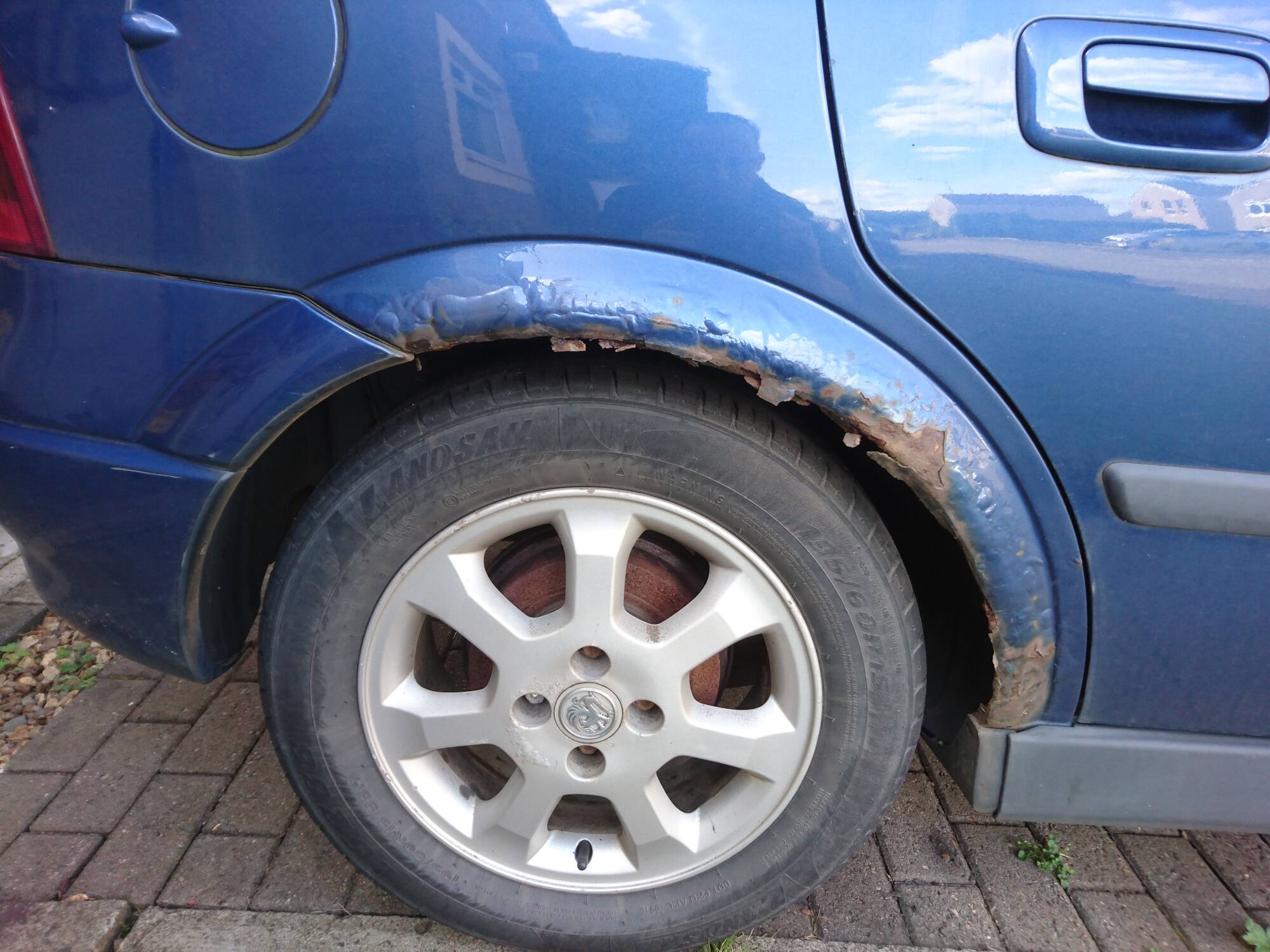

After a bit of prodding.......
And after the angle grinder was let loose surprisingly it was only the return lip that was rotten so the welder was broken out to lash on some roughly cut fresh metal.
Linished off filled, sanded and primed. Note the use of a farmfoods brochure pulled out the bin being used as masking paper for extra shite points.

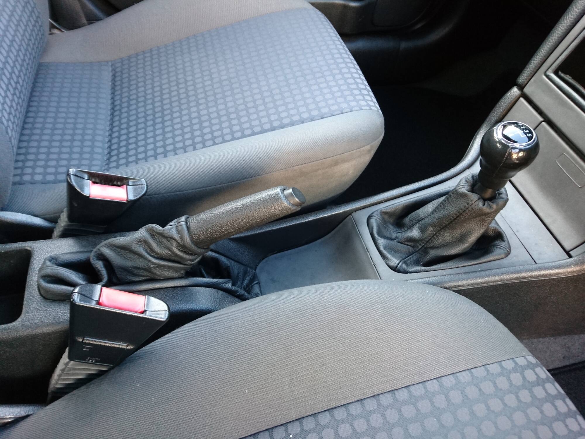

... lever and handbrake gaiters. £10 and and half an hour to fit both. These and the £12 set of tailored mats have really transformed the interior into a nice place to be.

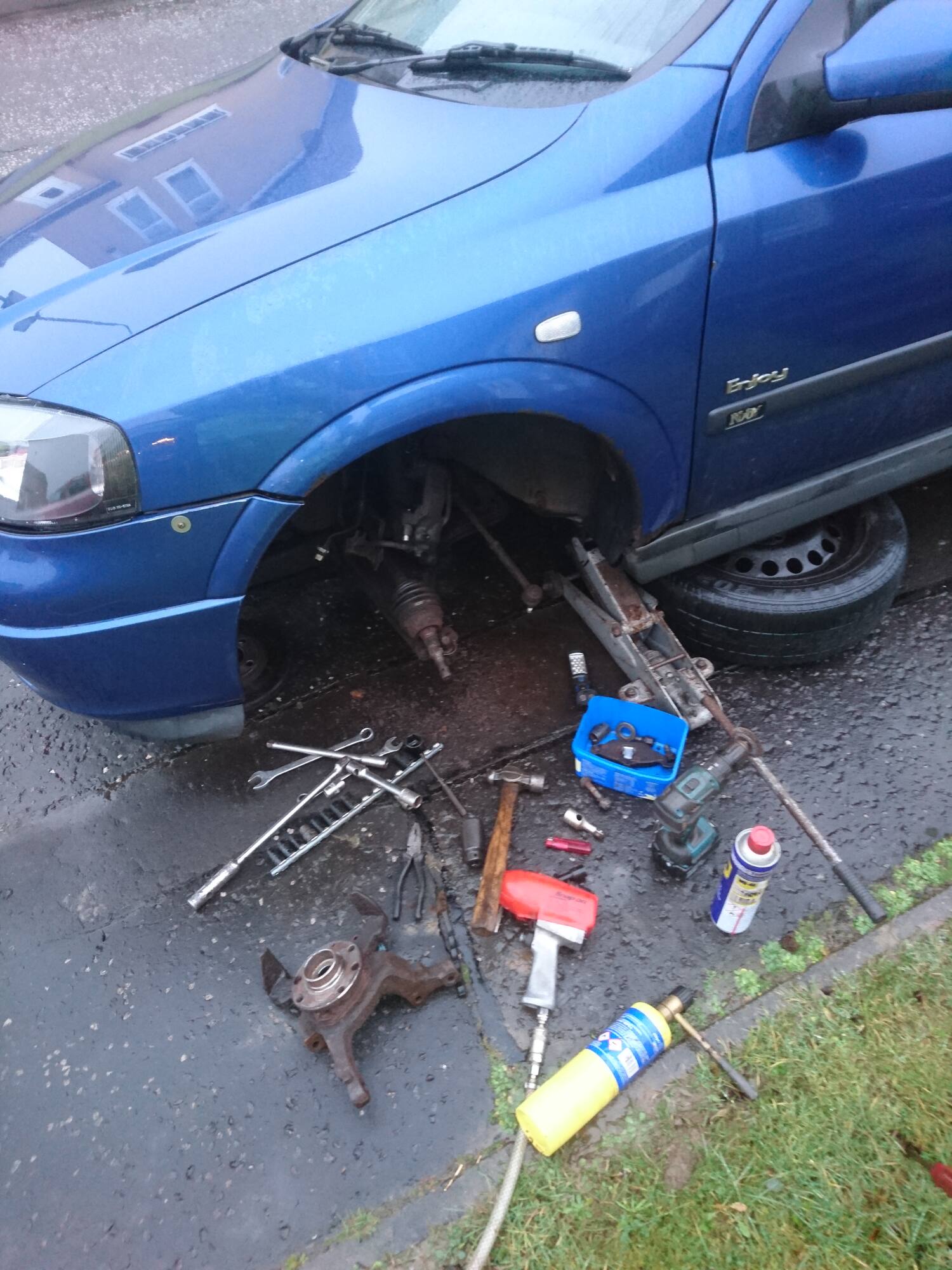

The weather was cold and wet but at least the morning snow had stopped so I donned overalls and waterproofs and set to work.
Nothing that heat hammers and a pneumatic impact gun couldn't sort out. Quite surprised how easily some of it came apart given that everything looks like it's just been dredged out the canal.
After cleaning off the scale on the knuckle with a grinder and wire wheel the new hub was bolted in and torqued up using the factory approved(*) three stage torquing sequence. 1. Six dugga dugga's on the impact on the long hose. 2. Ten dugga dugga's on the impact connected to the short hose right off the compressor and the air wound up to 150psi. 3. Clamp hub in vice and give it one final horse up with the breaker bar.
After that it was plain sailing with the re-assembly. The impact really comes into it's own putting old tie rods back on. If you tried to re-install the rusty old nyloc with a spanner you'd get the nut half on/half off and refusing to go in either direction with the taper merrily spinning away refusing to bite. Using the impact just zips the nut straight back on without any fuss.
No more photo's I'm afraid as the rest of the assembly was done in the dark with a head torch. Test drive revealed that noise levels were back down to normal diesel Astra levels.

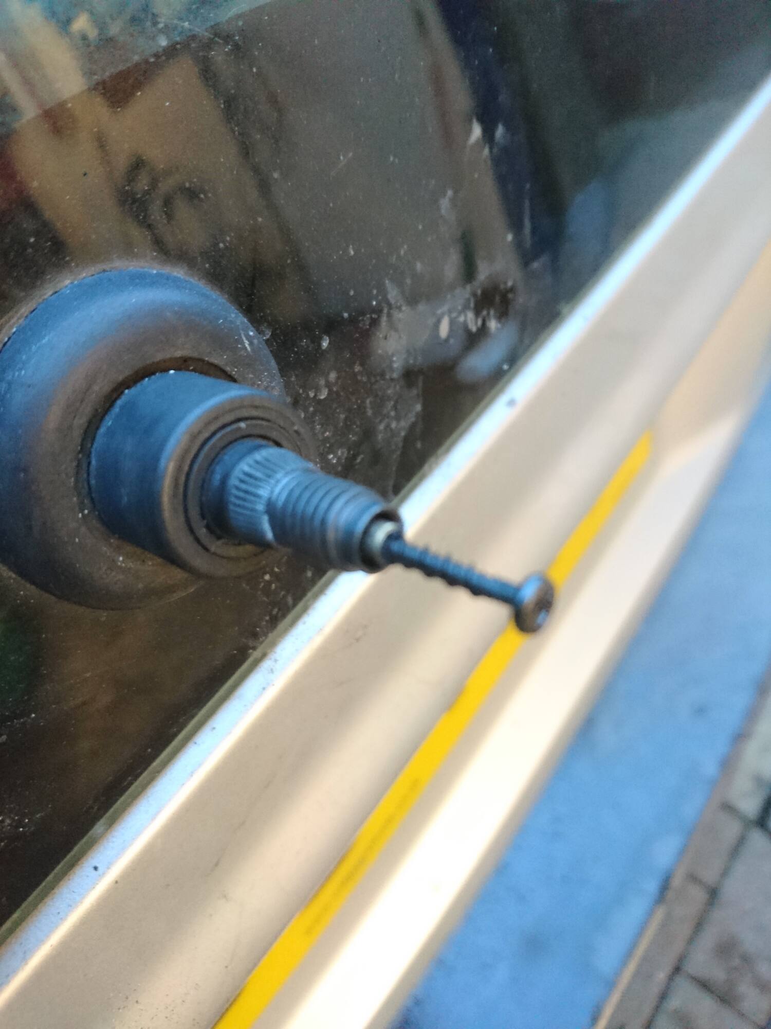

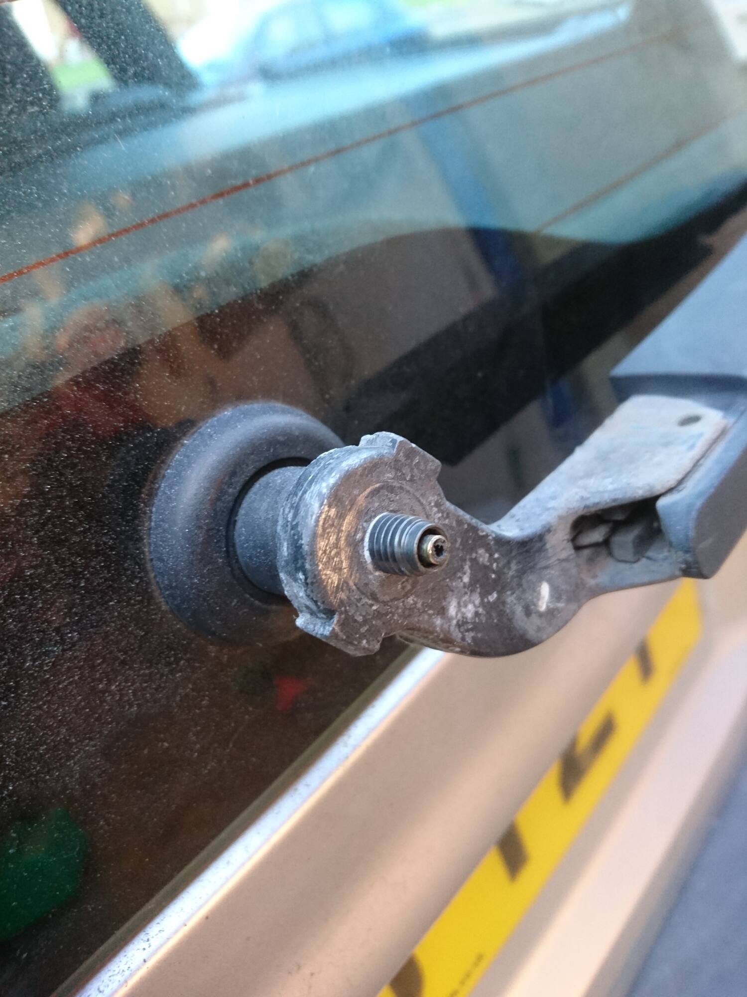

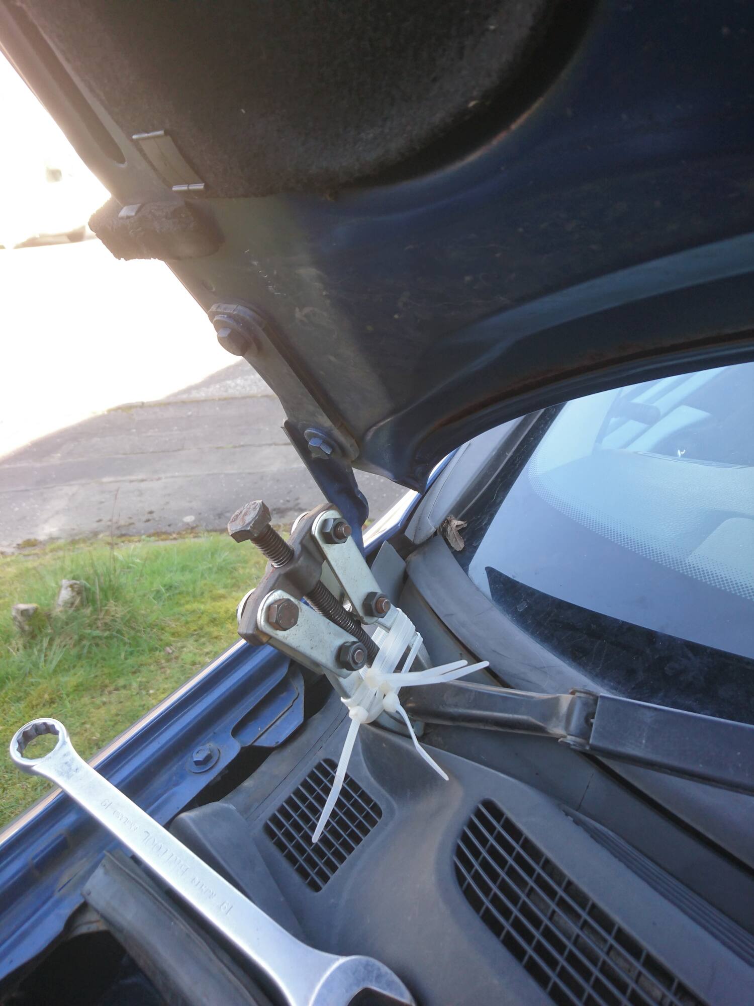

Next on the "make it last another year" agenda was to check the wiper linkage. A mate of mine who's worked on dozens of Astra vans over the years told me that the wiper linkage is prone to seizing up and trashing itself. As it's NLA from Vauxhall he advised checking/cleaning/lubing if my wipers were juddering. As they are a bit juddery when parking on a dry screen I thought it best to investigate. First up was to improvise a puller to remove the arms.
With the linkage removed it was clear that the issue was the exact opposite of seizing, one of the spindle bushes has massive amounts of wear but looks to be happy to wobble along for a long time yet. Mind set at ease I cleaned out the scuttle and refitted the wiper assembly with a generous dose of spray grease to all the moving parts. In the long term I'll probably pick up another linkage from a scrappy. I'll leave that till the yards are open again as  I could do with finding a few bits of trim in better nick than what's on the the car and bulk buying in person is going to be a lot cheaper that one part at a time from ebay.
