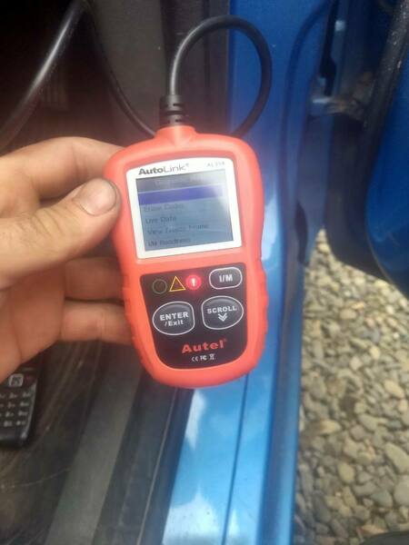

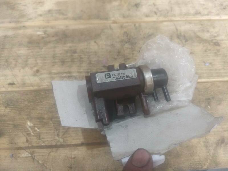

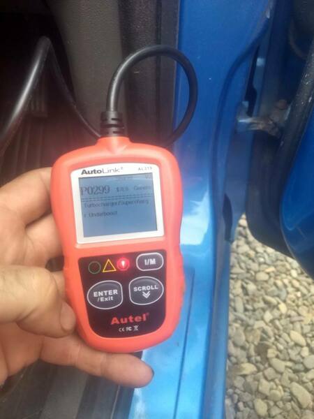

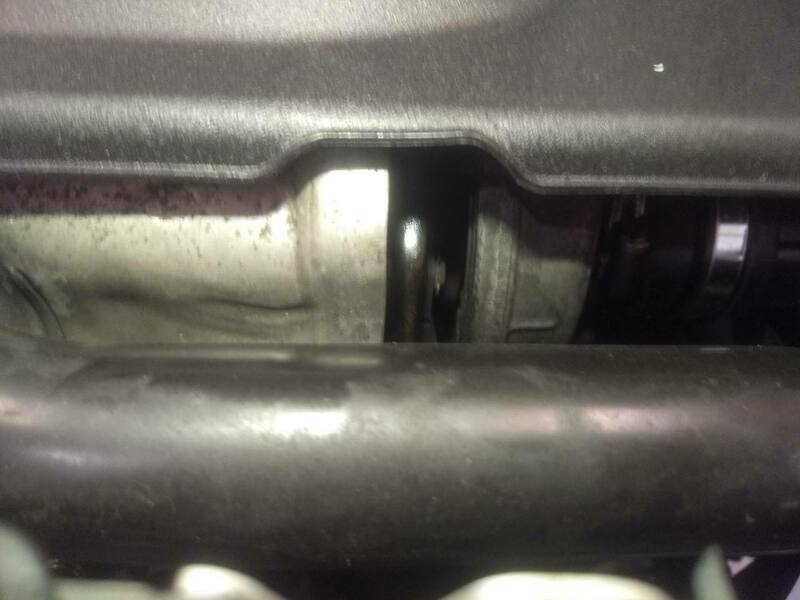

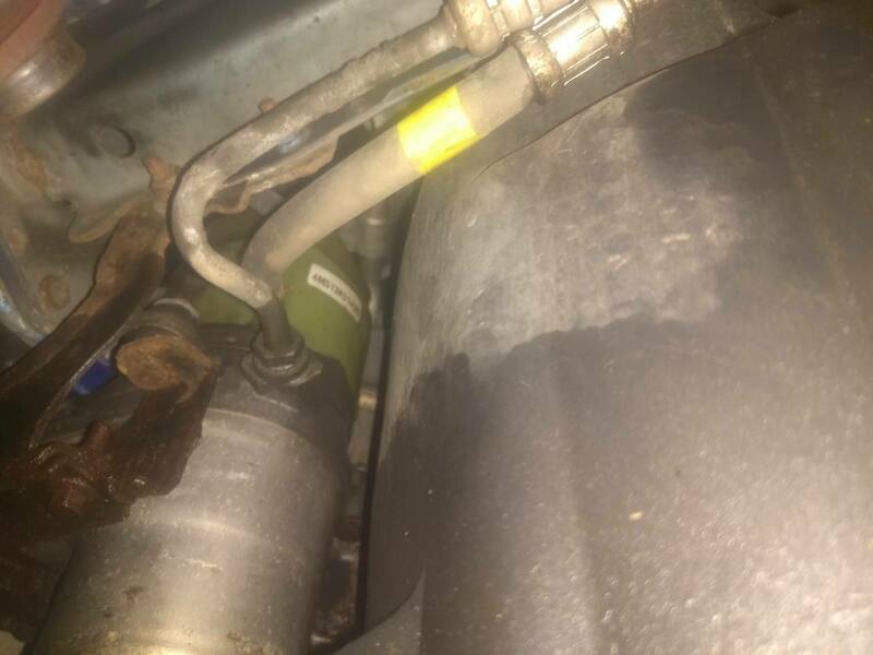

I'd like to have spent today fixing one of the older cars but getting anything done was a bonus.  The Focus has been poorly for a bit, I thought I'd fixed it with a new boost hose but the test thrash up the hill put the engine light on.
This was helpful as we'd erased the codes before so actually googled it this time and found a thread on Passion Ford.  A chap kindly wrote about his battle to sort out his car and said the cause was this thing.
It's a turbo pressure solenoid valve and apparently the cause of a vacuum leak which would make this actuator arm.
Dip up and down as the engine tops up the vacuum every 10 seconds.

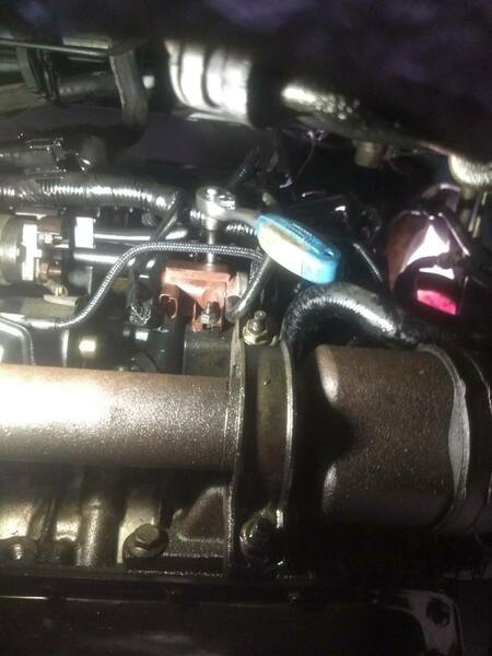

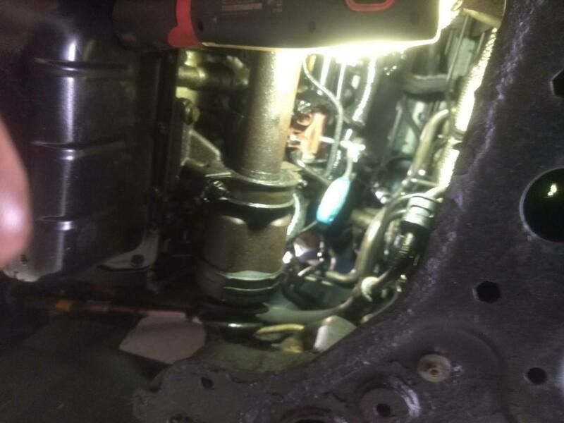

It was a wonderfully easy repair as my boss let me use this.
Which is our new toy at work.  Buzzed it up, whipped the undertray off and found this

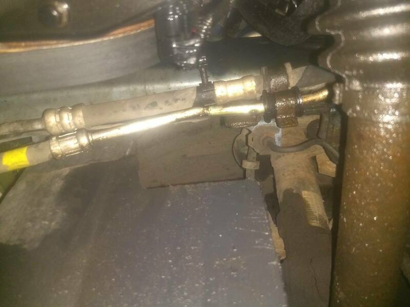

Loosen one nut and remove another, swap over 1 wiring connector and 3 hoses then put it back on and test.  All seemed well so once I'd had a quick look at the power steering leak (middle of a pipe where the pipe clip has been rubbing) it was time to put the undertray back on and fetch it down.
IMG_20220714_164425451_HDR.thumb.jpg.eed533f87ec1ec0c5ab119d4f6aefb61.jpgIMG_20220714_164417278_HDR.thumb.jpg.651e36252049f82079083b373d192b36.jpg
Clear the P0299 code and she's good to go.
That same part was responsible for the problems on my V50 but it didn't throw any codes. In my case the car had power when cold but then lost probably 50% of it when warmed up, took me ages to find it and minutes to fix it!
