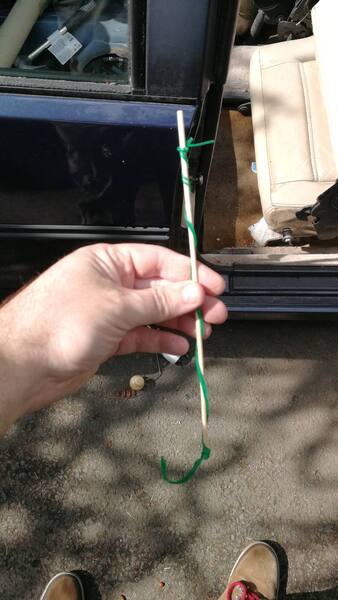

Then I got in touch with my Inuit side, using brand new* magnets to undertake "tank shite" fishing

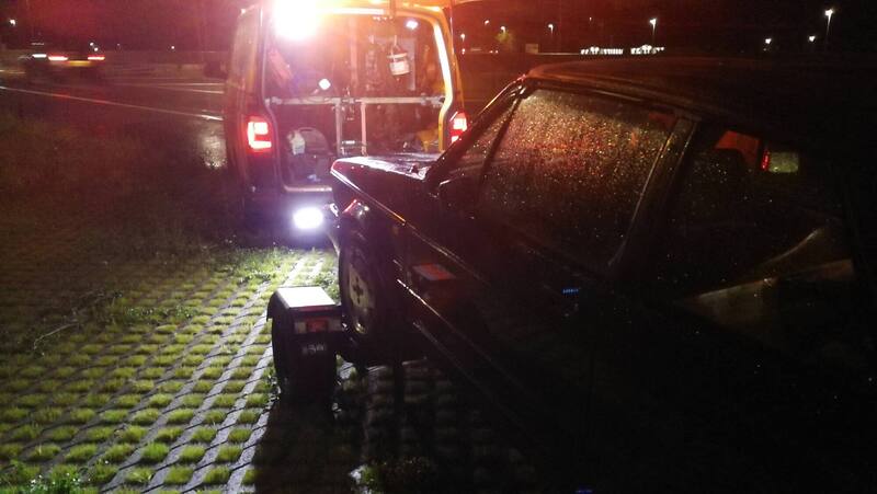

Upon getting just past Tebay, it started running rough - nicking into Todhills rest area and luzzing in 10L of fuel had it running bang on for the next 70miles before it died.
This was the final scene on the way home.
I got to bed at 00:45, and left it to sit until today.

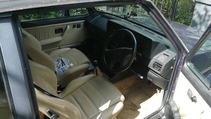

I opened the door and marvelled at the aroma - old convertible with a hint of damp and petrol.
IMG_20190817_121614.thumb.jpg.35827686fb423c6ab77d9a60a65e288b.jpgIMG_20190817_121837.thumb.jpg.4cfaf6acb4da8e6f9d9f045e8f68282a.jpg
these Rivage editions are an odd spec-
Hydraulic roof
1.8 GTi engine
Full leather interior Inc GTi dials/MFA
heated seats
Electric front windows
15" alloys
But no power steering or central locking.
Despite appearances, it's a lovely place to sit, and should respond well to some cleaning.

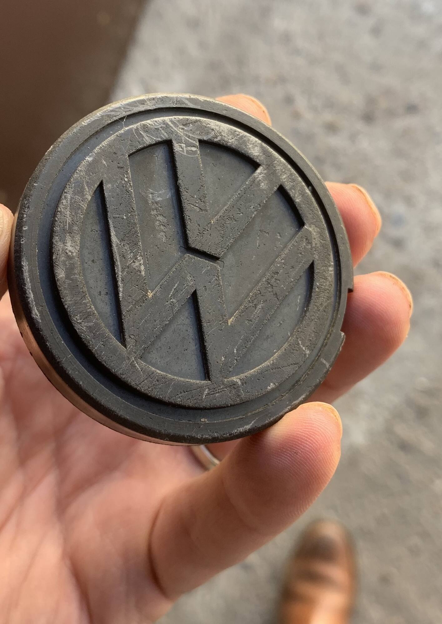

Oh by the way, I found the missing wheel centre cap.  It had rolled under the Victor.
I’ll chuck it in the post to you in the week.
