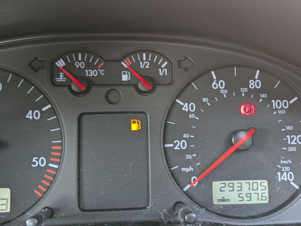

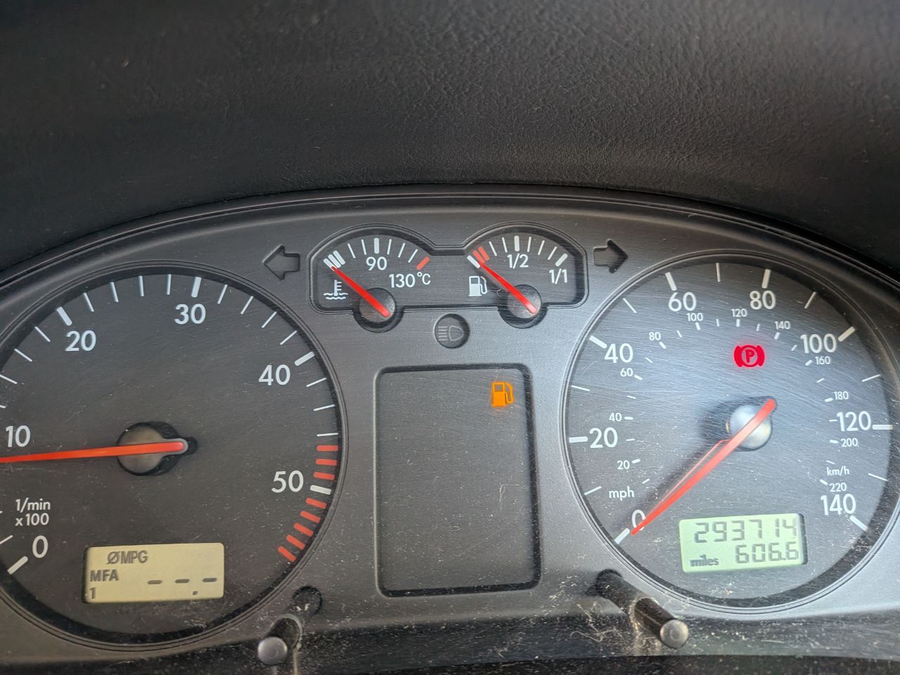

When I parked at work on Wednesday afternoon, it was above the red and I intended to fill up tomorrow as I've been driving a van instead. Got in it tonight and it beeped and showed completely empty, which was rather concerning. Put £7 at the expense local station and it hasn't changed, I think the sender has failed. Fun...

OK this is bee zar. Stuck a full 5l can in - no difference

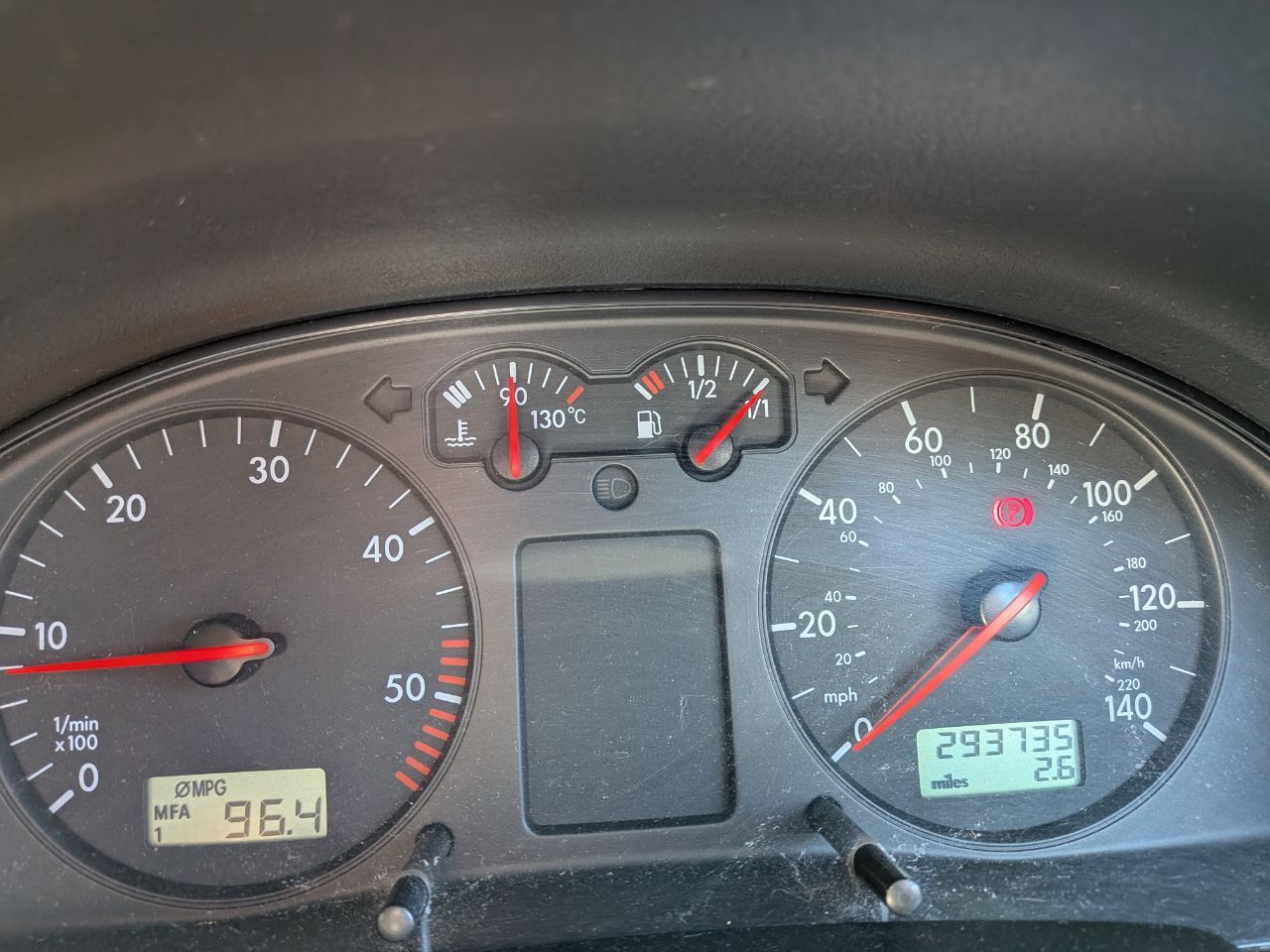

Filled it to the top, got this
2 miles down the road and it's slowly crept to display full. WTF
Slightly sticky or scratchy potentiometer on the sender.
The gauge isn't tied directly to it but is controlled by one of the ECUs which damps it out.  It will also tend to be heavily pessimistic (as the opposite is more likely to leave you stranded) so wouldn't show a higher reading until it was confident that it was seeing an accurate reading.
So most likely the potentiometer is a bit noisy at the extreme ends of the travel of the float.
