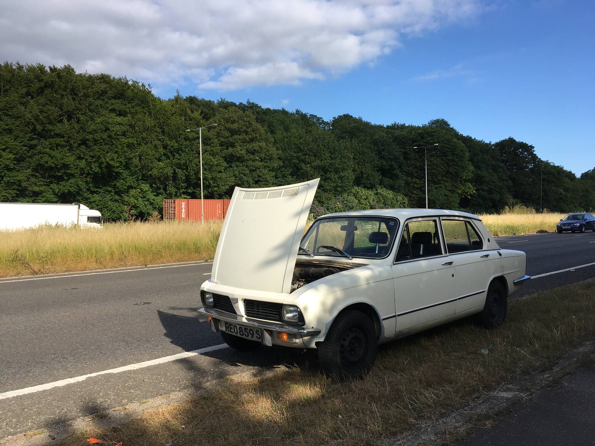

So, we’ve now changed all of the above plus the condenser, rotor arm and plugs.
Seemed like it was working but has got as far as Cuckfield (from Hayward’s Heath) and has died again. Exactly the same problem.
It’s now being towed home by a friendly man who was passing on a tractor.
AAARGH!!
