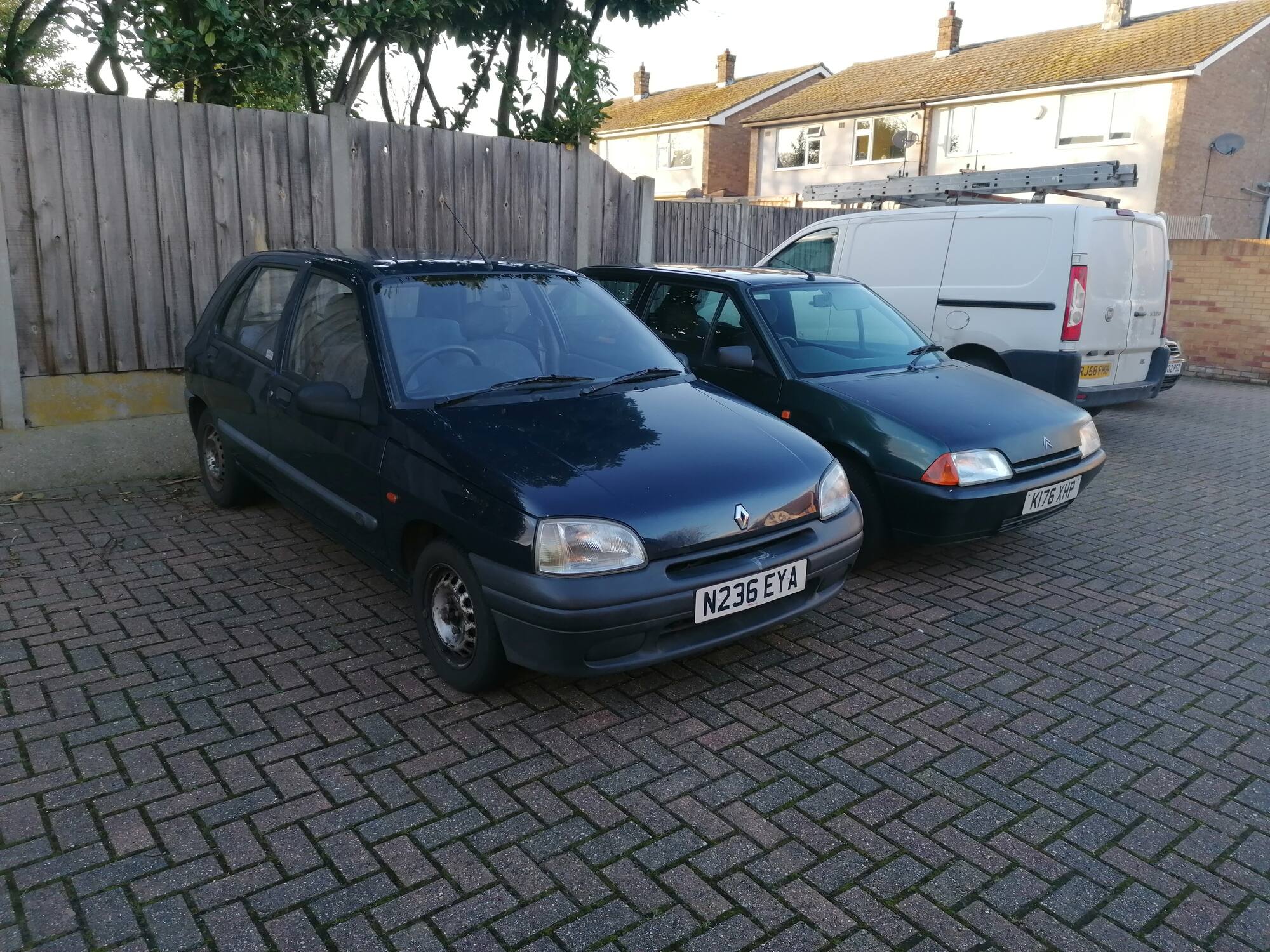

Funny moment this evening. Picked my girlfriend up from work and hadn't told her about the Clio. She had got in, we had pulled away and it wasn't until she went to adjust the radio that she said 'What the.....!' She hadn't even realised she had got into a different car...

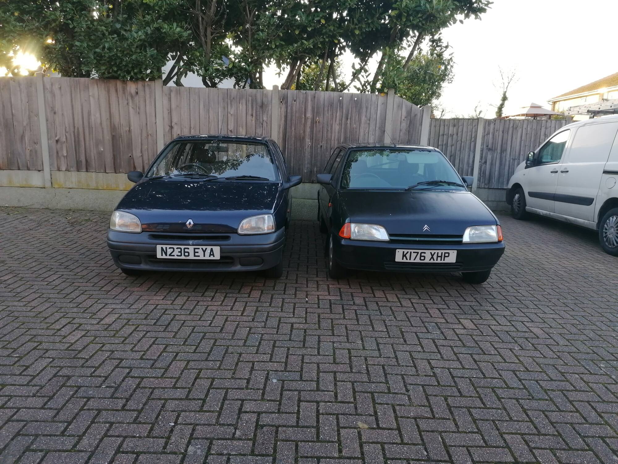

Talk about mingebag motoring, the Clio is more economical than the AX, and is less to insure!
Winning.
Parts on order for the AX, will be able to potter along and sort it in my spare time.

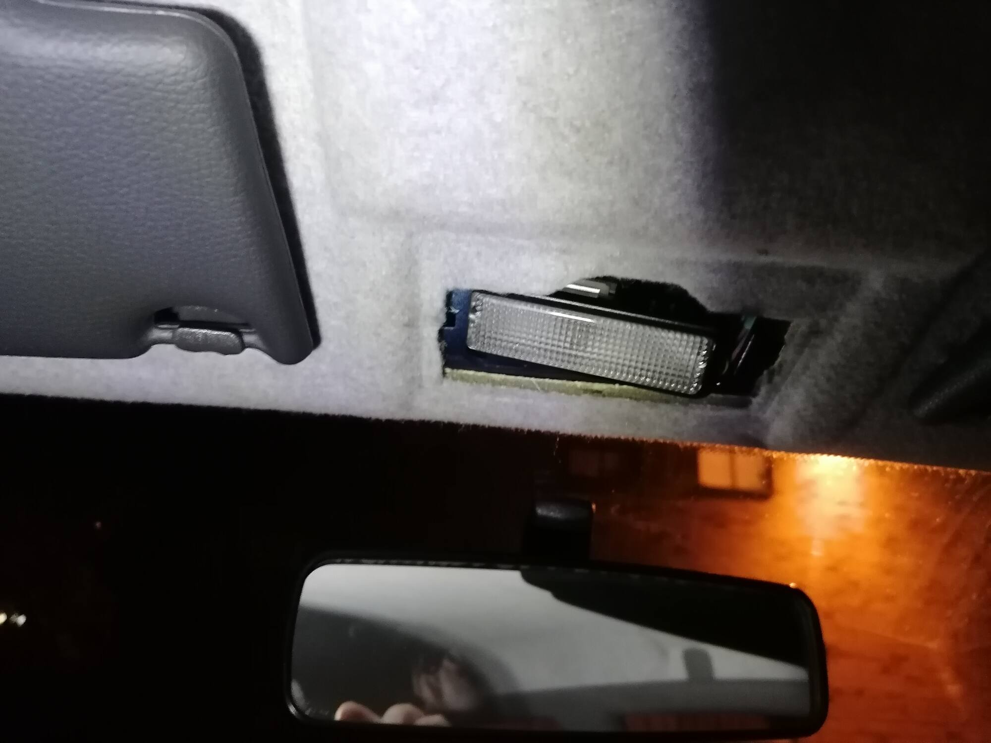

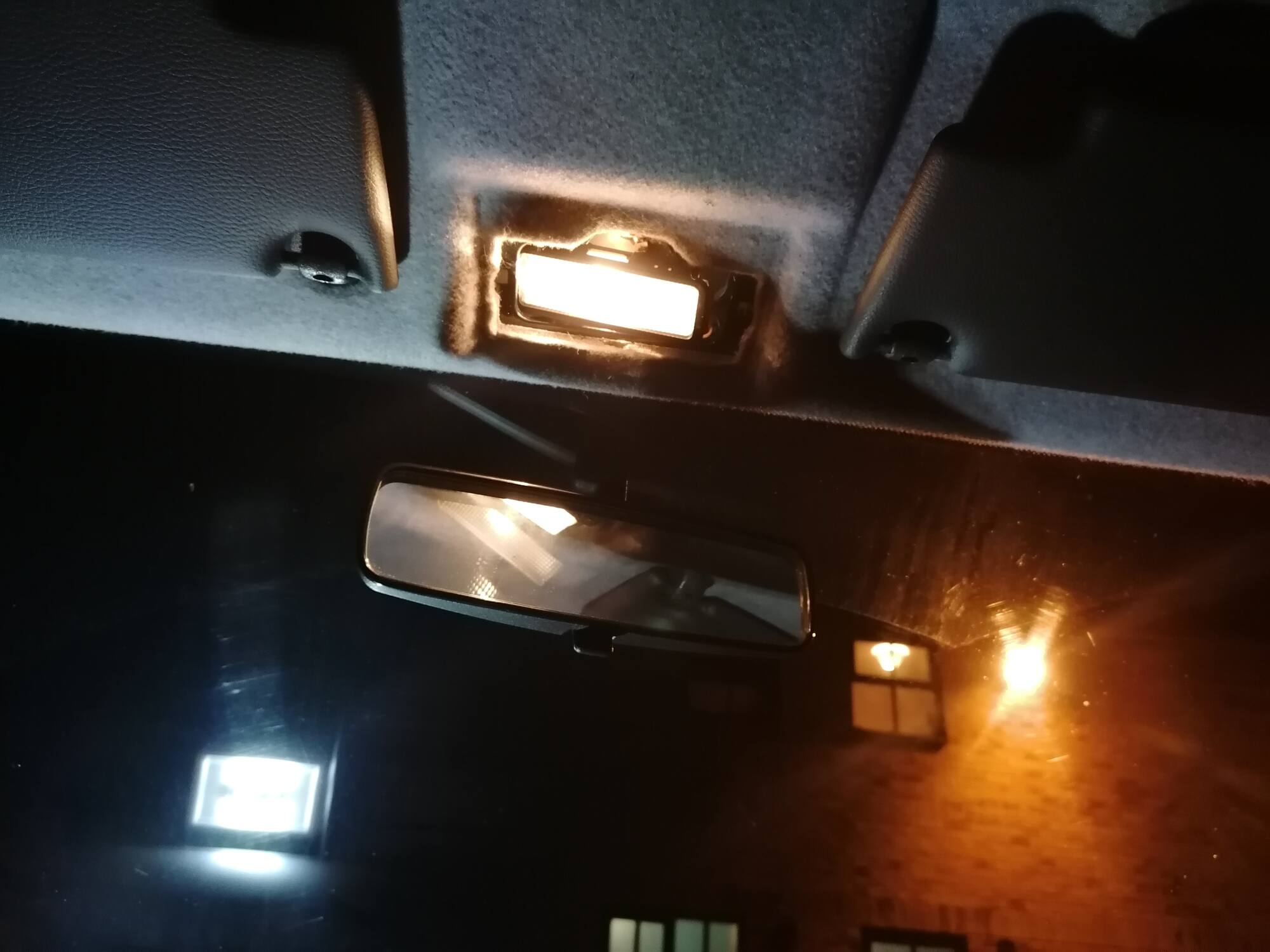

Remember the interior light on the Clio? Or rather the lack of one? Turns out the AX light has the same connections.
It fits* well*

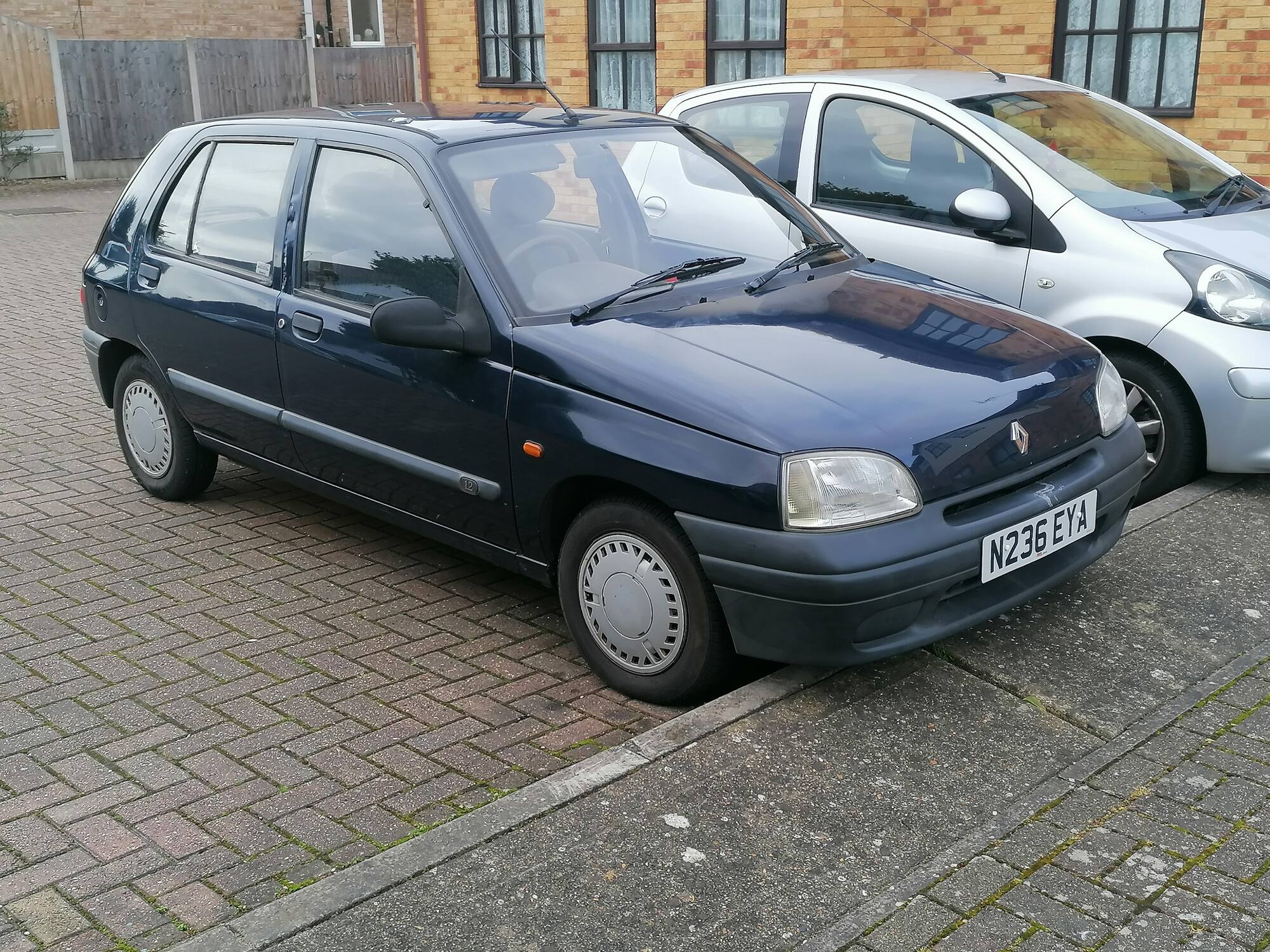

As I've mentioned in other threads, I'm slowly bonding with the little Clio, in spite of the odd driving position. Still plenty of jobs need doing on it, but nothing too scary.
In other news, it looks like I can only really keep one small French car going forward, so I'm offering the AX up for sale/roffle. If nothing comes of that, I'll maybe reconsider and roffle the Clio off for silly money, say 2.50 a ticket or something.

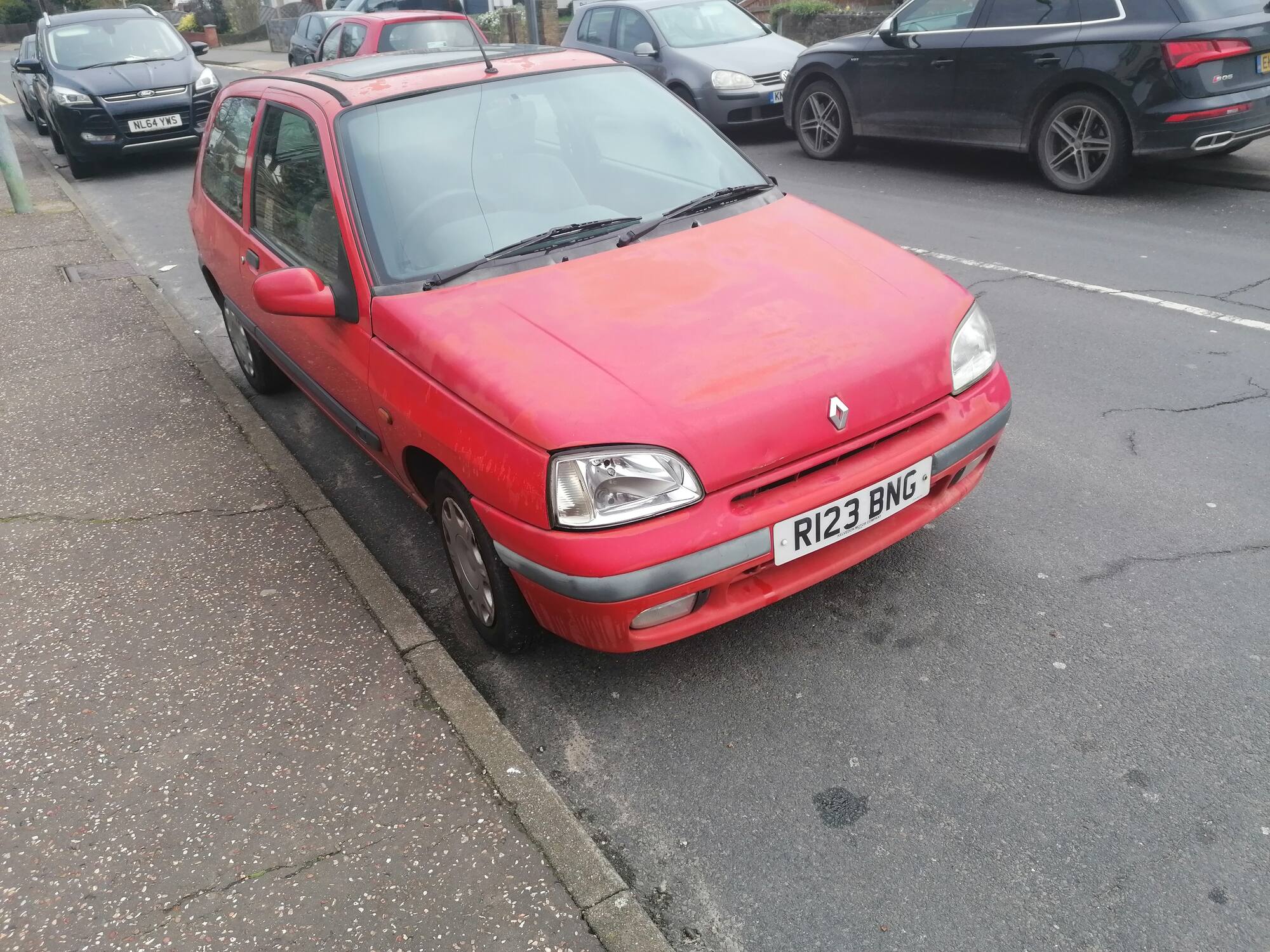

Local cousin looking worse for wear...
Did these suffer the most pointless facelift? Or we the original mk1 blasé by then? I just know the prefacelift was a sharp looking thing that has aged really well.
They do seem prone to shedding their headlight lenses! I just bought a replacement headlight from eBay for £20 delivered. Haynes said you have to remove the bumper and bonnet. I couldn’t see why and managed to do it without removing either. It probably helped that the front bumper doesn’t fit very well...
